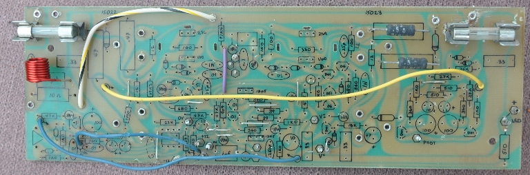

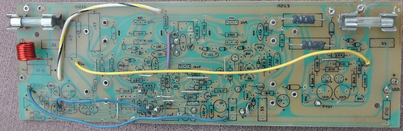

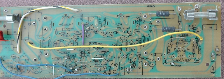

Guys finally got 1 amp board cleaned. Im going to start the build soon, I have to get my parts order all finished.
Im going to build one board at a time using the other as a reference.
Im thinking also relocate the jumper wires to the foil side of the boards, makes fo less clutter.

i'd keep the wires on top of the board. it reduces clutter on the solder side, and the top side is already "cluttered" so a couple of jumpers don't matter much. besides one of those jumpers is the feedback to the inverting input of the diff amp. better to keep it as far away as possible from the power supply rail wires, to keep magnetically induced distortion down. you really don't want PVC insulated wire jumpers on the solder side. if you ever have to desolder anything along their paths, they'll get in the way, and are prone to getting the insulation melted off if you slip with the soldering iron.
