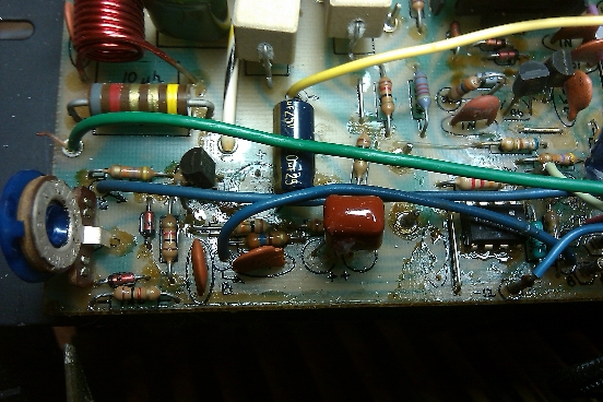

Jed, A few board fotos of the APT 1 board.

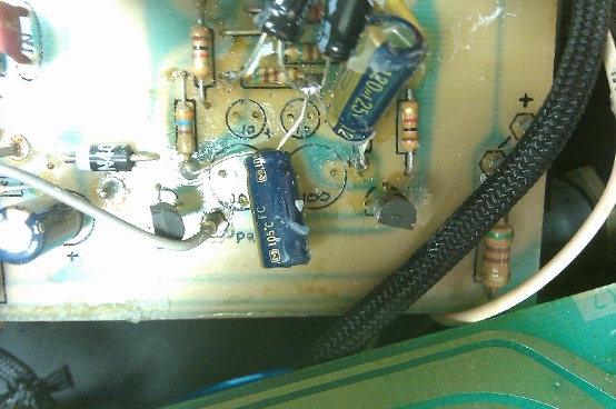

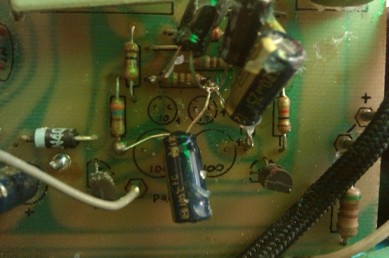

Got a few photos up of one of the boards, can anyone tell me if these were a factory tweek or someones sloppy work. You cant imagine all the silicon goop on these boards. It looks to me that caps were snipped off and new just tacked to resistors or what ever the could.
Im going to clean the both boards up and replace the caps.

looks like somebody didn't want to properly disassemble the amp module to work on it. very sloppy work. at least it looks like the traces underneath are intact. if i had gotten this board at the factory, i would have rebuilt it. i would have literally stripped the board down bare, clean off all the goop and repopulate it. somebody was in an awful hurry. one of the things that was found out about leaving long leads on electrolytics was that it made the amp susceptible to RFI in the 25-30Mhz range. we had a company literally next door that grew silicon ingots for making transistors and diodes, and the 25Mhz radiation from their induction furnace was a real problem, but it allowed us to find out real quick how good a particular revision of board or assembly method would stand up in high RF environments.
btw looks like about a rev 4 or so. rev 2 and 3 had a lot of hookup wire jumpers that were color coded by length.

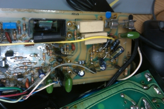

Im thinking about completley rebuiding the boards myself. After looking close up how sloppy the work was done. The more I look at this board, I know it has to be done. The traces look good but the slop and the amount of crud has to go. I have a question for ya, on this board whomever cut the 2 leads to the moxie, any idea what number it is ? Im figuring if I clean up this mess im gonna hoe to the end of the row.
Taking out the second board tommorow, but from the looks of it, it's the same.

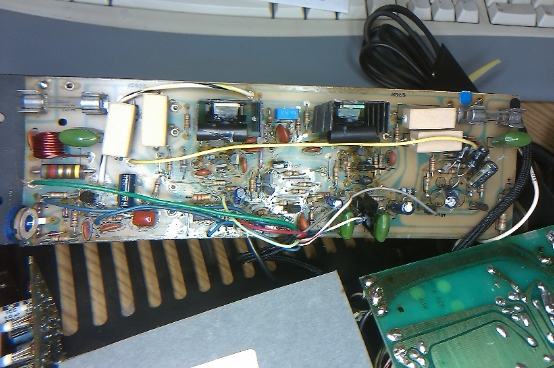

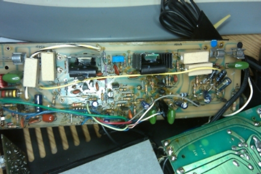

Im starting on the APT, I have the boards out and will be working on them soon.
Here is a link to my pbase photo site if you all would like to have a look.
If you look closely you will see differences in the attached components on the boards. They are marked revision 3. the boards are otherwise identical.

I have alot of work ahead of me on this one, taking your advice and rebuilding the boards.
