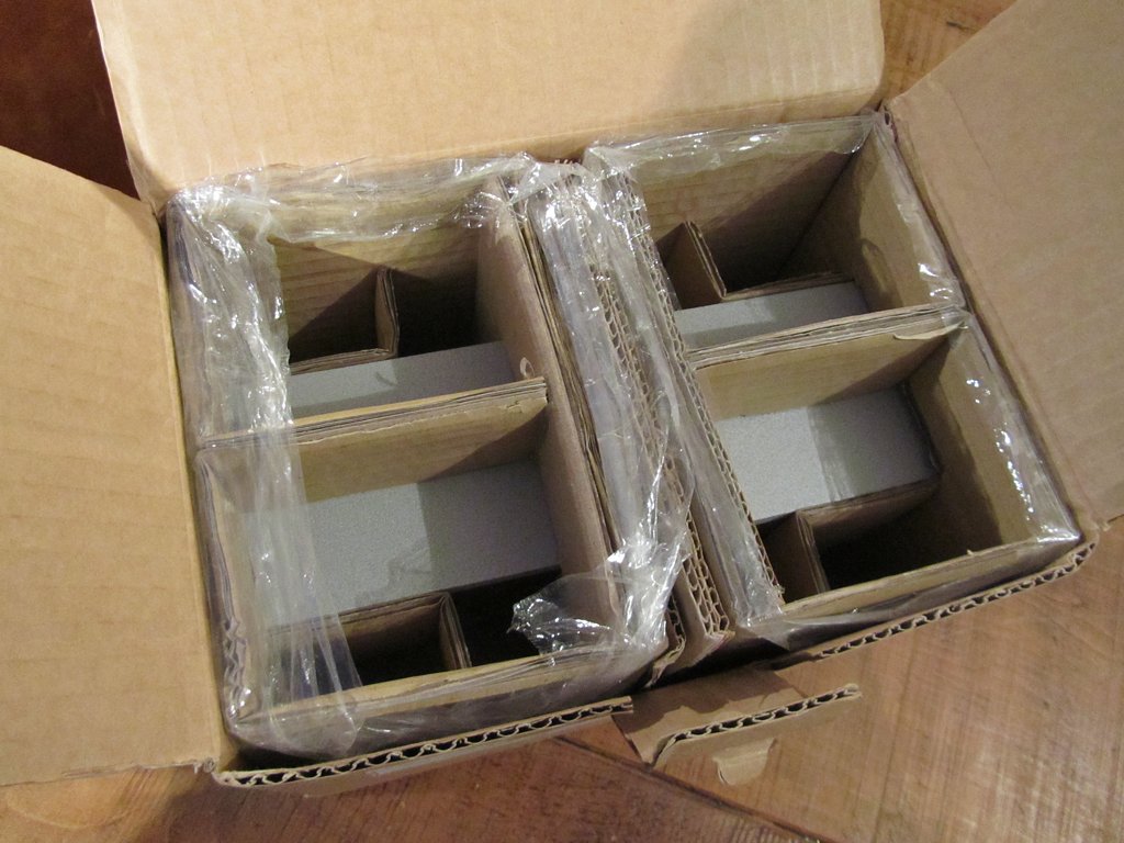

Box ornaments, these will be all the rage eventually just you see.

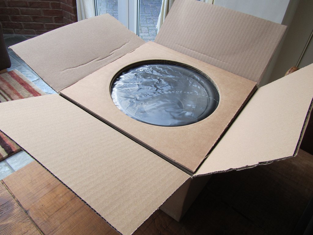

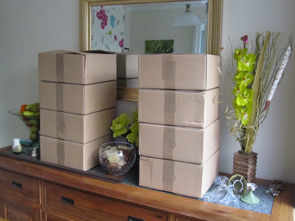

Nicely packaged and very heavy for a 10". I knew something was up when the 8 drivers arrived on a small pallet.

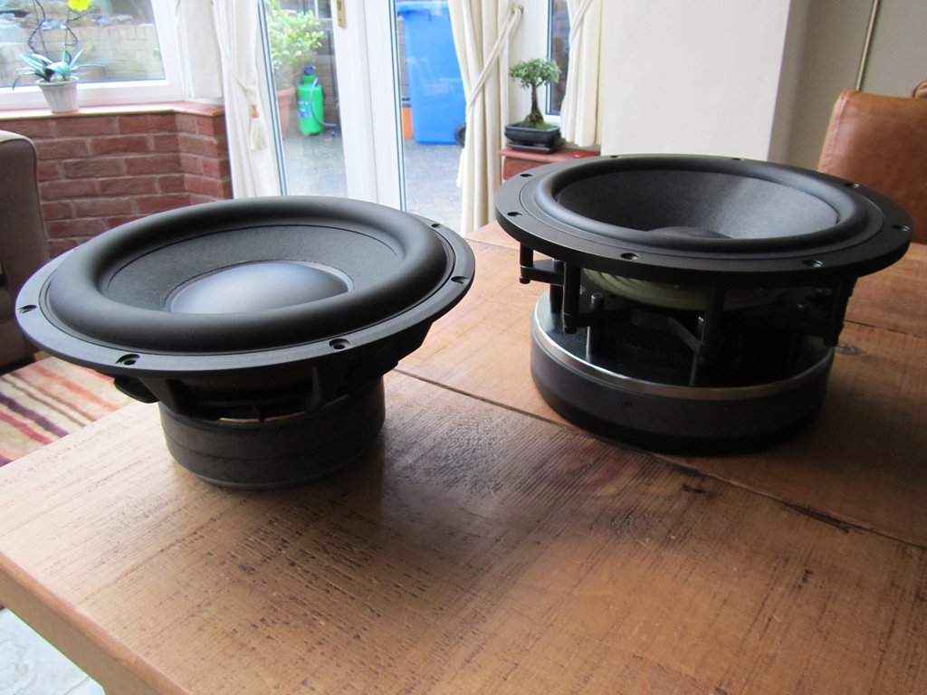

And holy... look at the motor on that. Besides the AT 10" is a Peerless XLS10 and it looks puny which is no mean feat because the XLS10 is a well built and beefy driver.

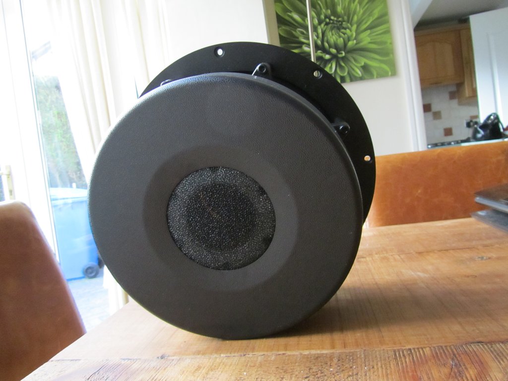

Can't get over how large the motor is. This shows the nice venting of the VC gap and pole piece.

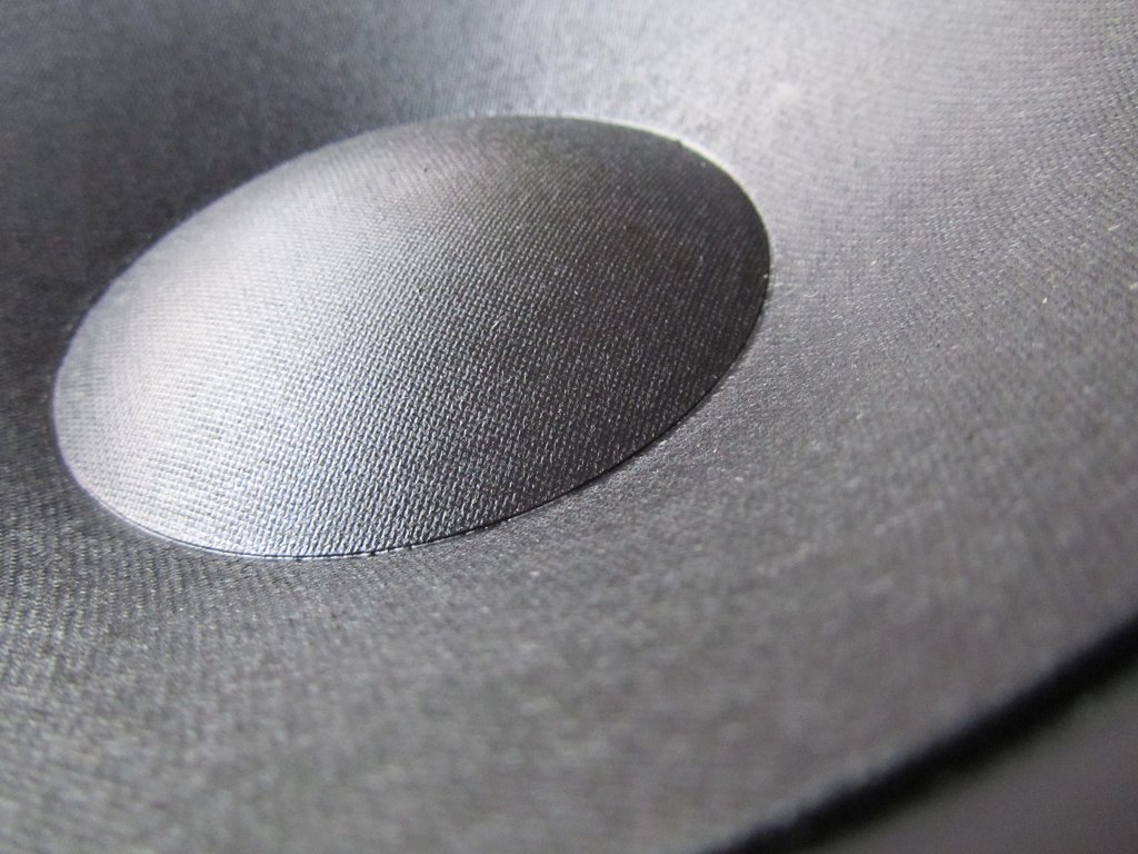

Close up of the sandwich cone.

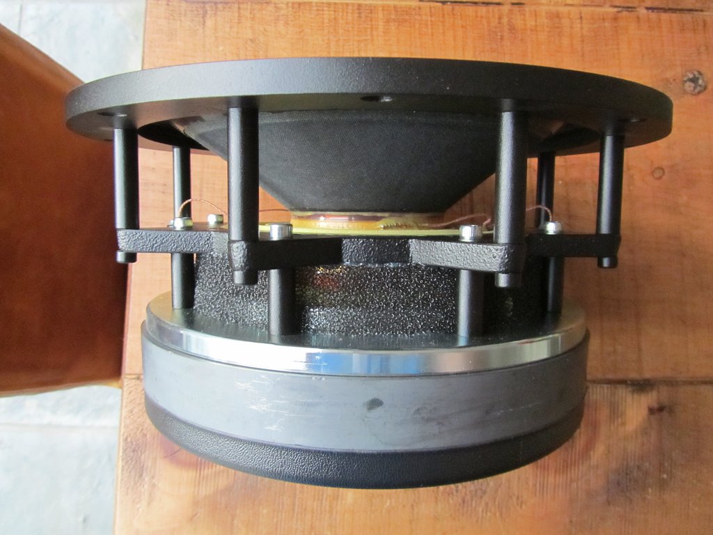

And a shot from the side to finish things off.

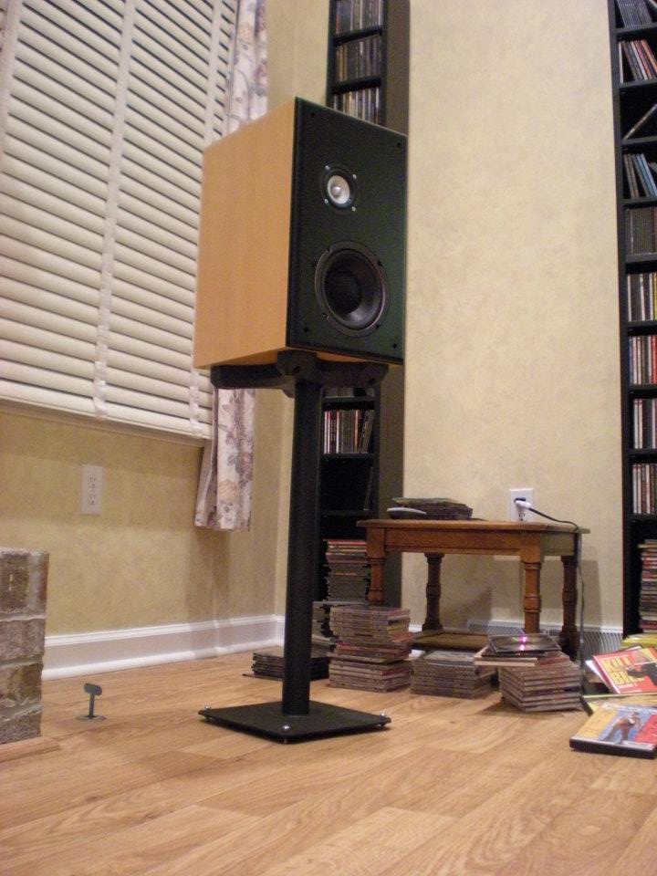

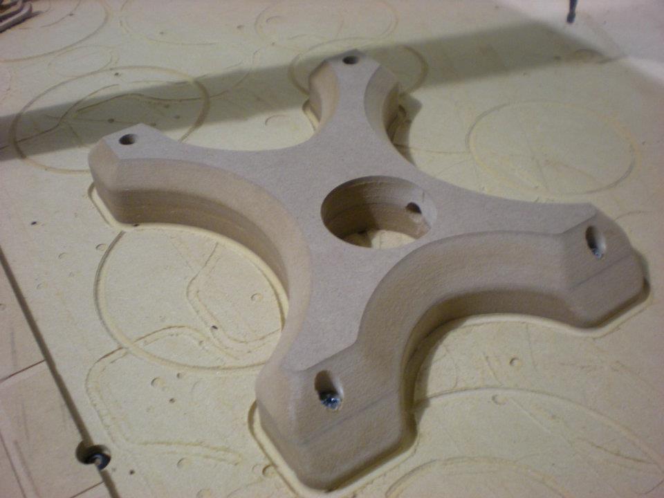

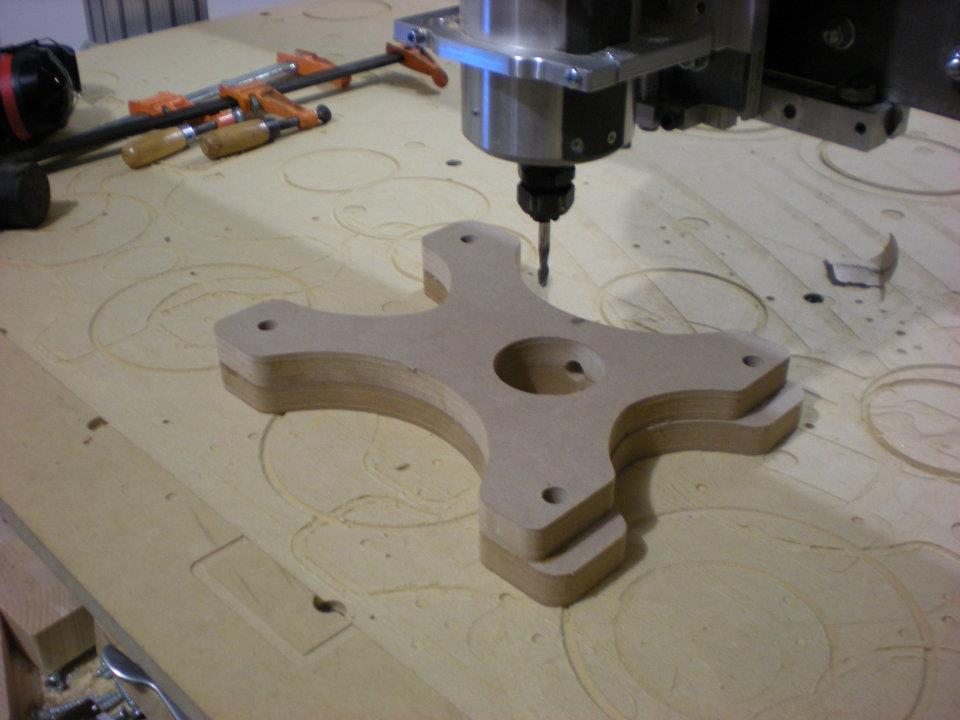

Your baffle looks somewhat similar to some stand parts I recently made on my router. Cutting parts like this is a lot of fun. The only trick is if the parts are tall, you need to make sure you have enough z clearance for a long bit and that your spindle has low enough runout to be able to run a long bit. I have some 6" long endmills but am afraid to run them in my router. I've got a 3 phase 5hp water cooled spindle that I need to get mounted and try them in though.
Nice work on the speaker stands.
The machine has 200mm of z travel and the maximum part depth I plan to machine is 84mm. Obviously I'll need a cutter length of slightly more than that and then factor the collet depth and work piece clearance. Its do-able but sometimes I wonder if I should have taken the 300mm option but the price keeps on going up...
