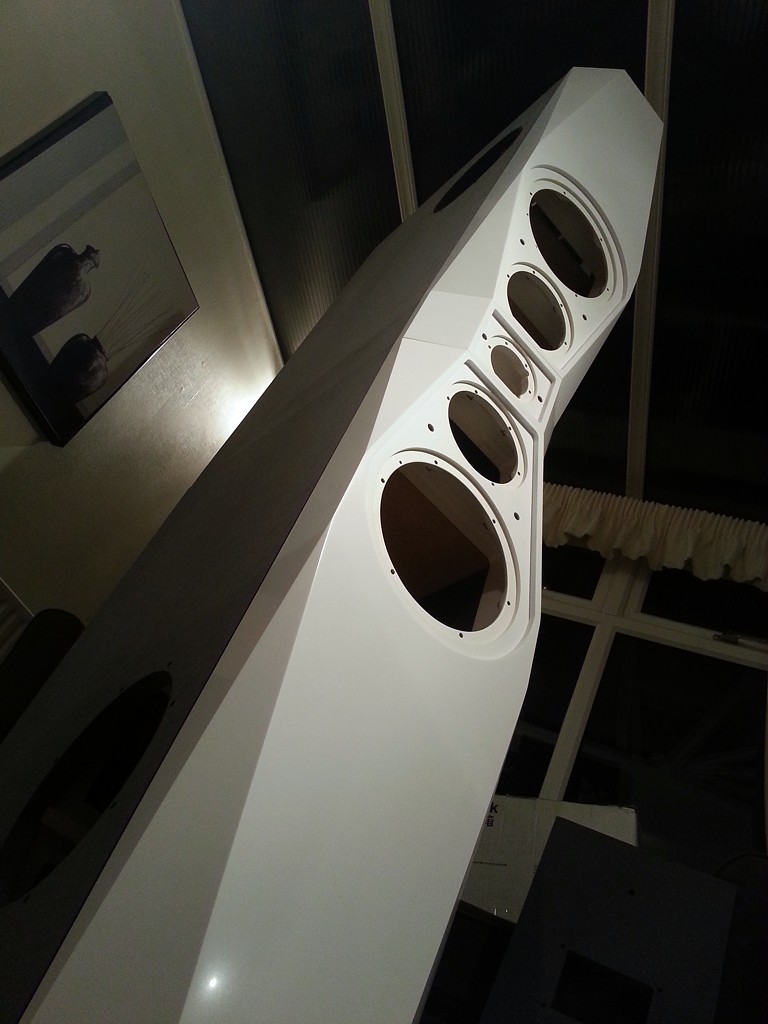

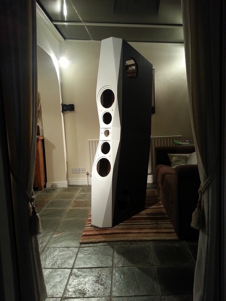

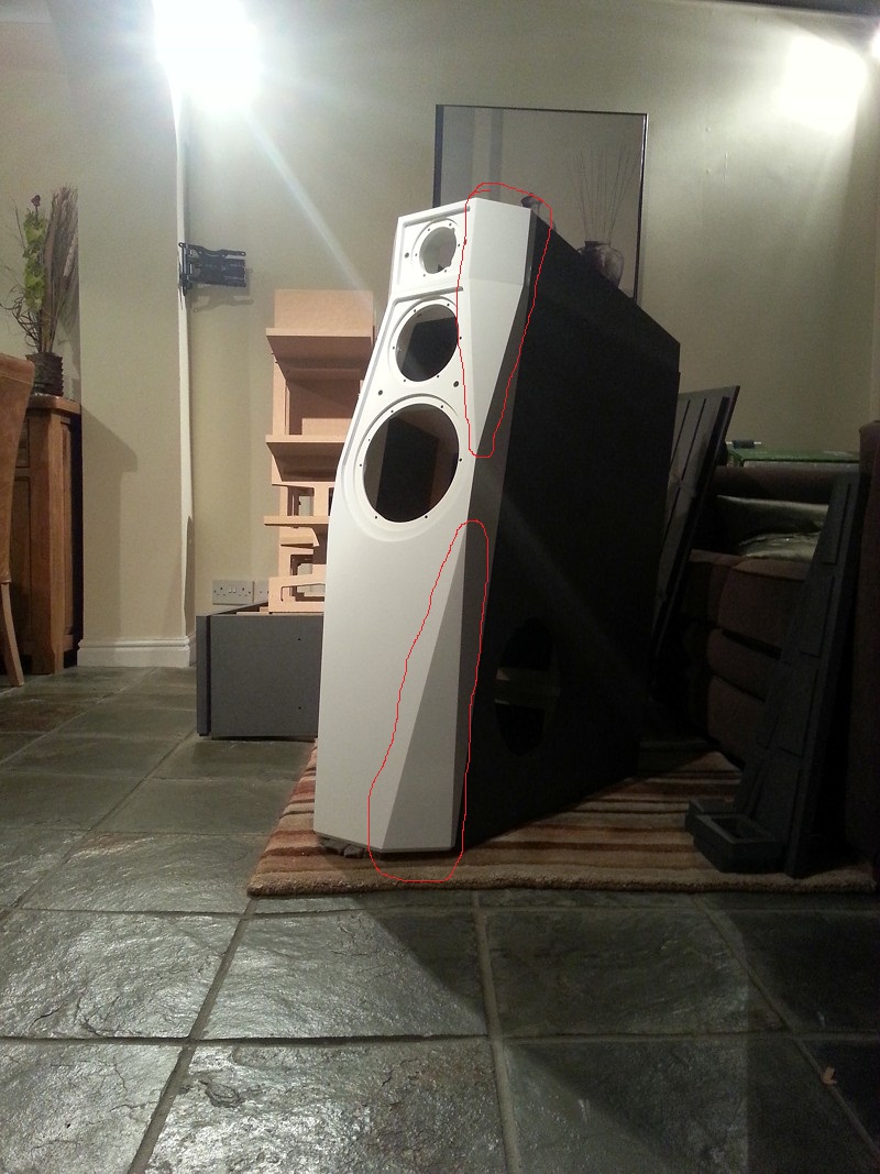

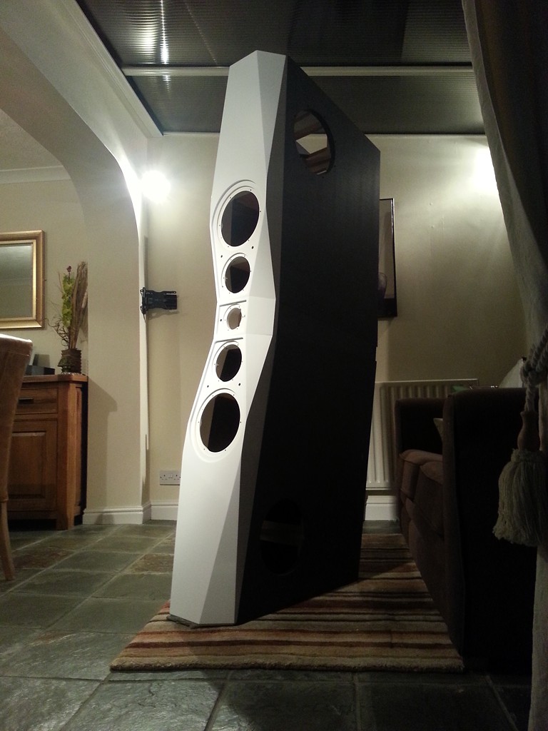

How did you make this angle side of the front baffle, see circled with red? Did you cut this part in an angle and glued another angle cut piece to it?

Those baffle cut outs were done by 5 axis cnc because they're corian but with wood you could easily do the same thing with a mitre saw or a regular hand saw and some guides to run the blade up against. This is how I've done it in the past and it worked well.
You can do the mitres with a 3 axis cnc, and a ballnose cutter, it just takes longer.

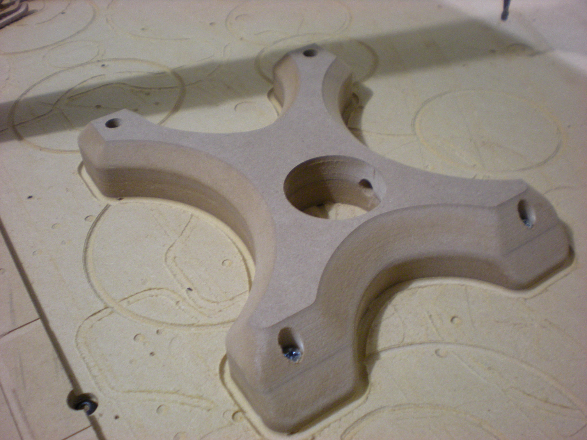

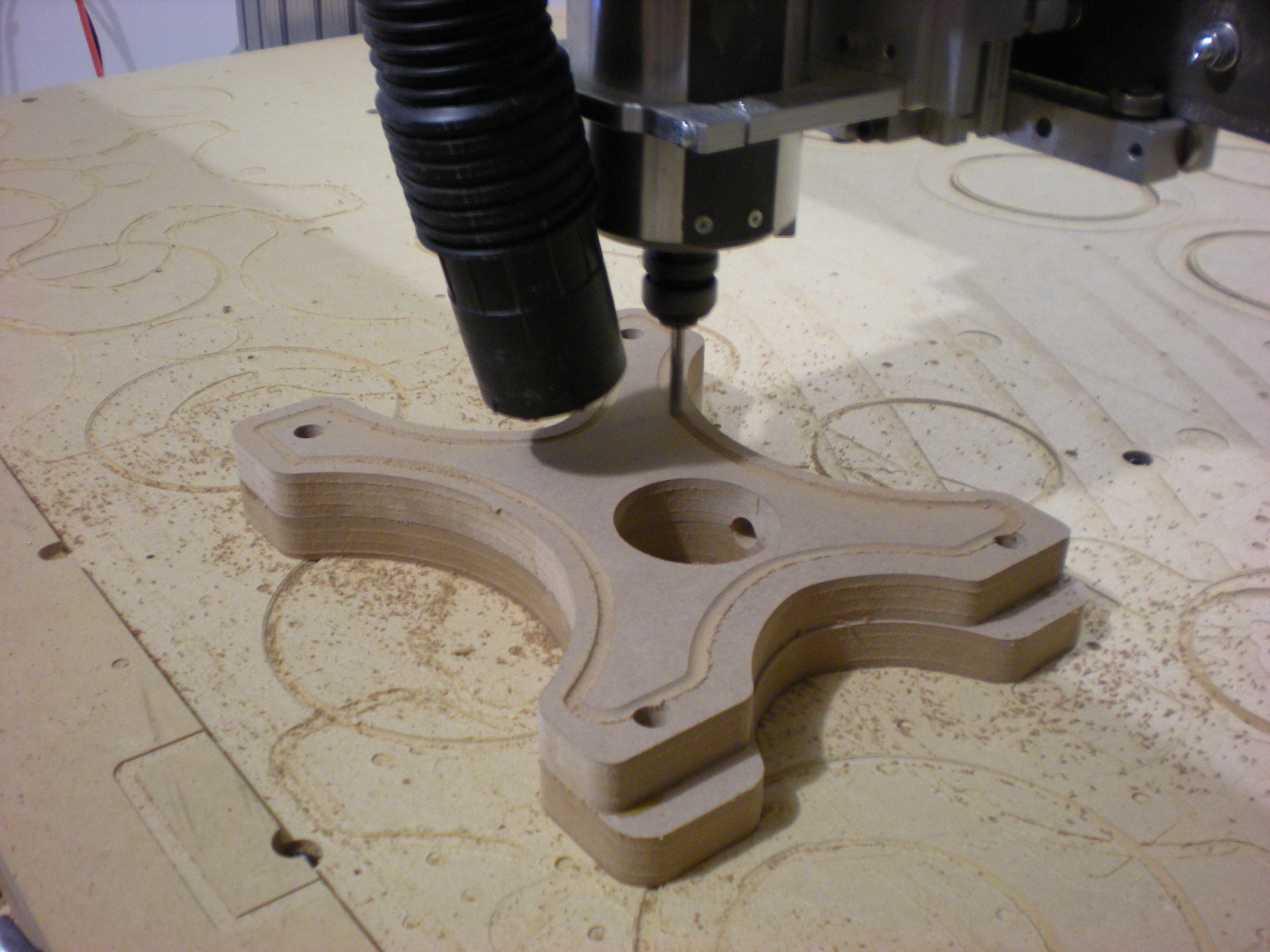

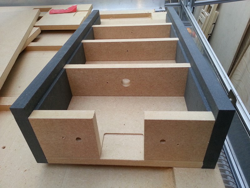

Tweeter parts cut today. They're all assembled and glued but clamped and drying at the moment so I'll get a shot of those completed tomorrow.
Been playing with the CNC feedrates and depth of cut now I'm feeling a little braver. Trying to find the limit then from there I can back off for some safety margin. Currently upto 6.5m with 9mm depth of cut and it handles this no problem. Little worried about snapping the smaller 6mm cutters with much more than this though. Still haven't figured out how to do ramping in the CAM software yet though. Its there but I've only took a quick glance at the settings so far. Will invest more time in it at some point because although its only MDF at the moment if I'm doing a straight plunge into stuff like Alu then its gonna knock the hell out of the machine.
This is looking really good now. The bracing reminds me of the Magico stuff except in MDF. I'm looking forward to seeing the finished product now. Can I inquire as to what it would cost or a set of these boxes? Not including drivers and crossovers. I'm curious since my wife actually likes the look of these speakers. And that is a BIG plus for me.

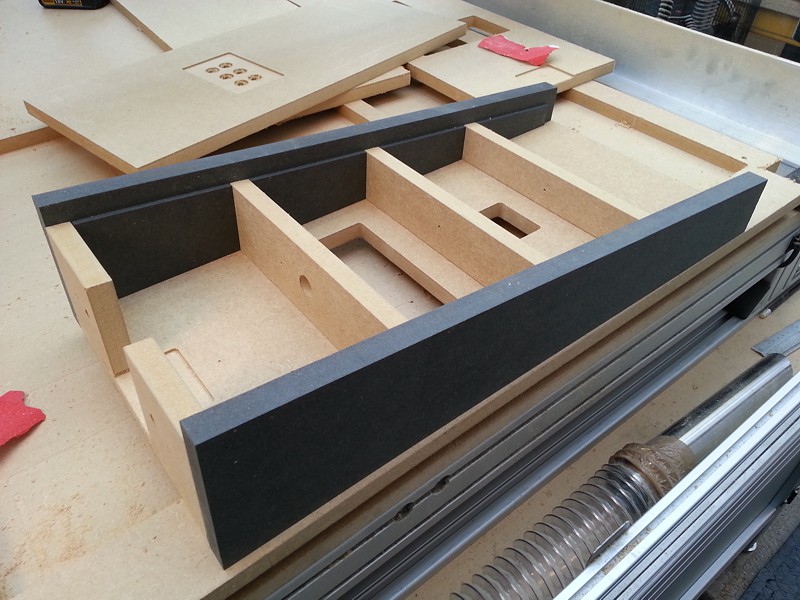

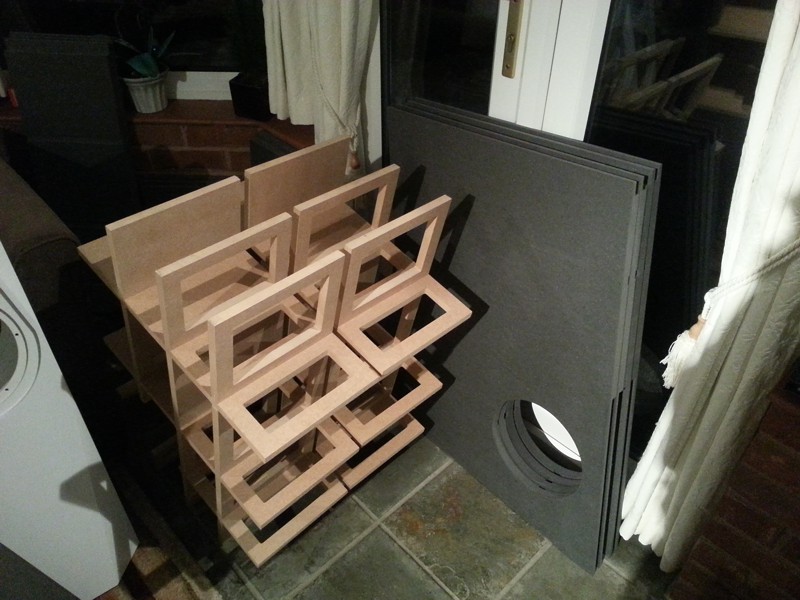

Its been an eventful day.
Broke my first bit through going too fast too deep. Its a bad idea to try 7m/min at 12mm depth with a 6mm bit. Bit stupid of me really since I've been told stick to around the diameter of the cutter as a safe area. Before the cutter broke I also noticed the quality of the finish starts to suffer when you go too far, sure the machine might move the cutter through the material no problem but its not rigid enough to handle those forces and that translates to the cutter and the work piece.
After the self inflicted drama the rest went smoothly.
They're starting to take shape now. This is one big speaker. Its testament to the fit of the bracing and rebates that none of this is glued or fastened in any way yet it still stands under its own weight. Pretty cool.

Broke my first bit through going too fast too deep. Its a bad idea to try 7m/min at 12mm depth with a 6mm bit. Bit stupid of me really since I've been told stick to around the diameter of the cutter as a safe area...
Yea, cut depth no deeper than the diameter is a good rule of thumb. I have seen guys using 1/2" chip-breaker bits at 3/4" DOC, but they're specialist things (and with hugely powerful spindles). General advice seems to be fastest linear speed possible (for reduced heat build up), rather than max DOC.
Also, deep DOC obviously gives more bit deflection (OK, fast linear does too), but for cuts that'll be visible you'd want a full depth finishing pass anyway.
Speaker looking absolutely superb, and yea - CNC is great for putting a box together to test with no glue. Got to say, what impresses me about your work is that the reality usually ends up looking like the render! My design process is usually back-of-fag-packet -> 2D drawing -> gcode -> MDF -> glue it -> run out of time to paint/veneer -> box sits in the livingroom under a table :D.

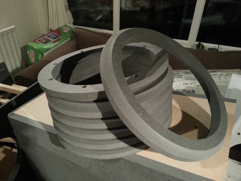

More cutting today. All the panels for the cabinet parts are now done. I'm moving on to the grills now and last off will be the base plinths and feet.
Last of the cabinet parts complete:
attachment.php
Grill frames for the 10" subs (the holes in the back will house neo magnets to secure the grill)
attachment.php
