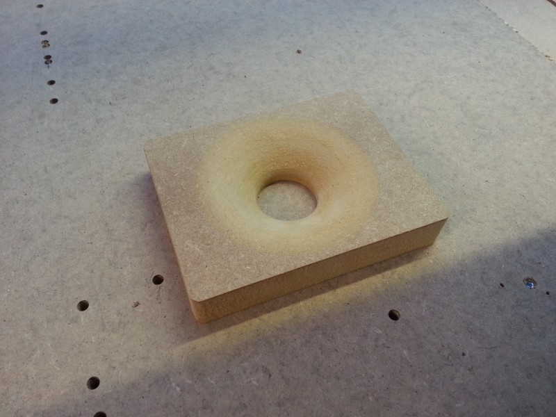

First Part - YouTube
Video of the first test part. Its one of the waveguides for the Apollo. Came out ok in terms of dimensions and accuracy. The 25mm MDF is made from was cheap rubbish and furred up like mad on the waveguide profile cutout. Will be much better with the Valchromat.
Went fairly conservative on the speeds as it was my first part. Its around 3m/min cutting here.
