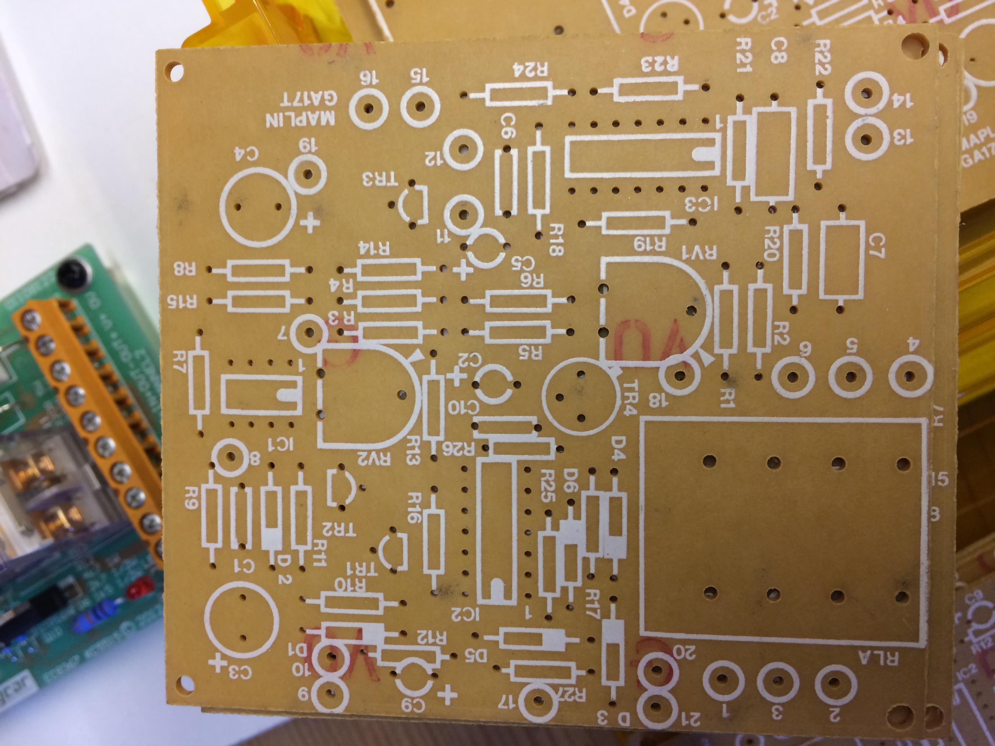

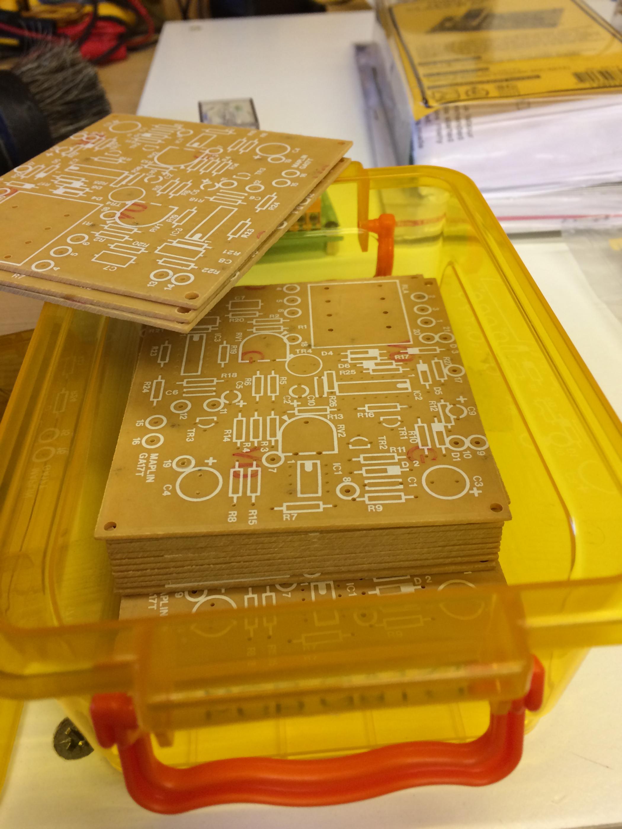

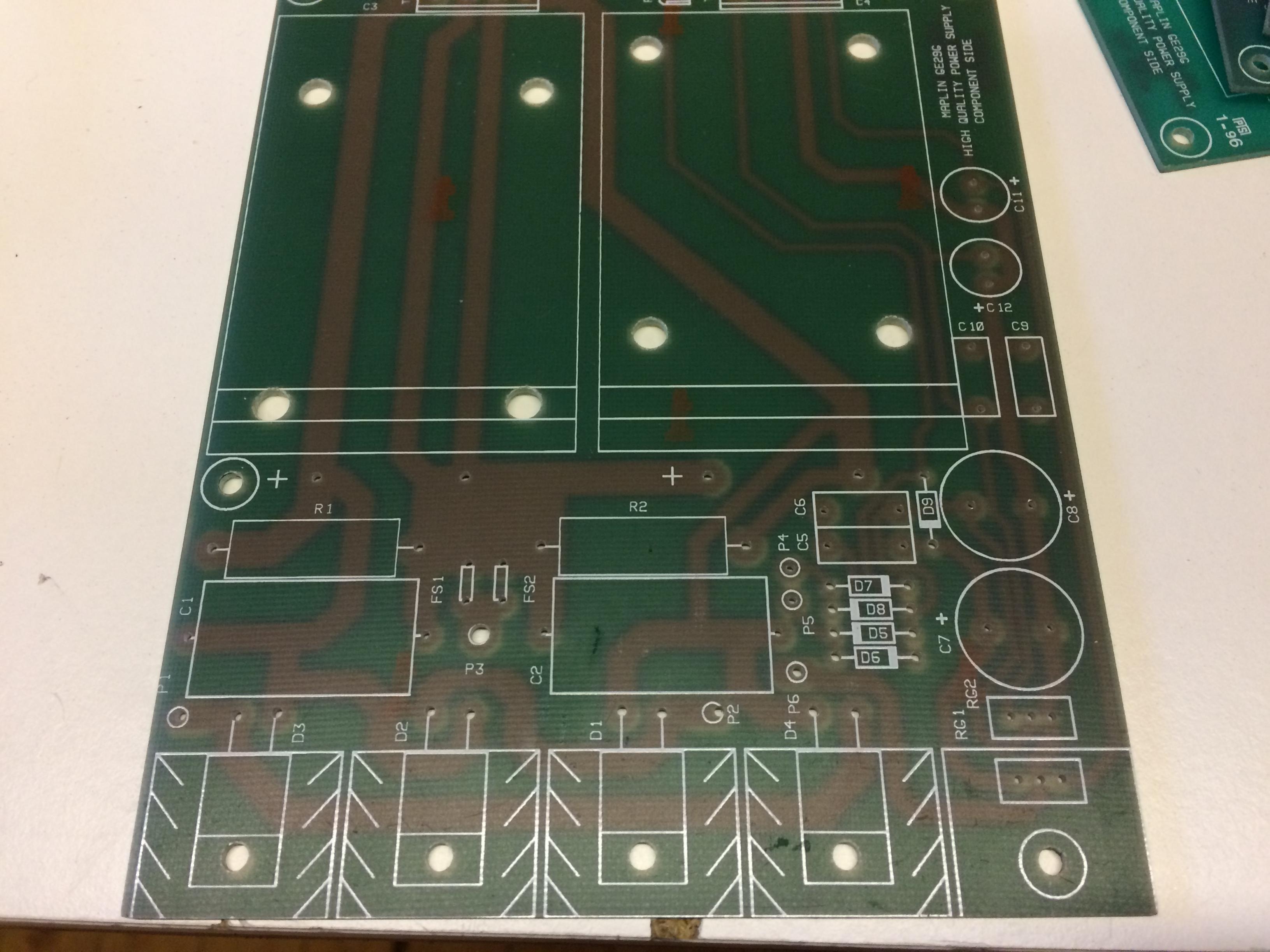

Hello ...
Ok cant hold back any longer as I have been working on a new design based on the upgraded Maplin unit
but I have some retro boards ... the original maplin amplifier power supply boards, when was the last time you saw some of these ??

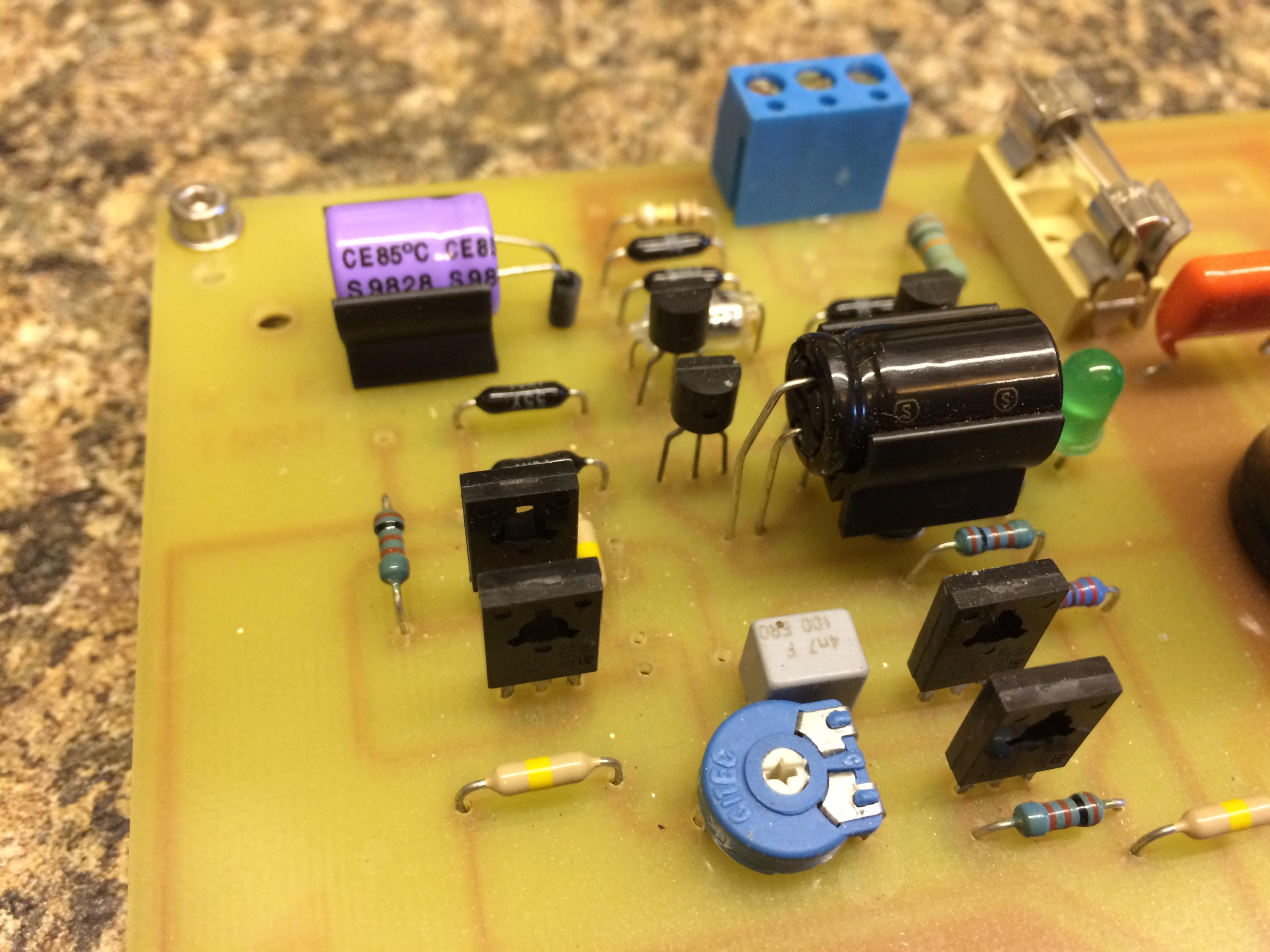

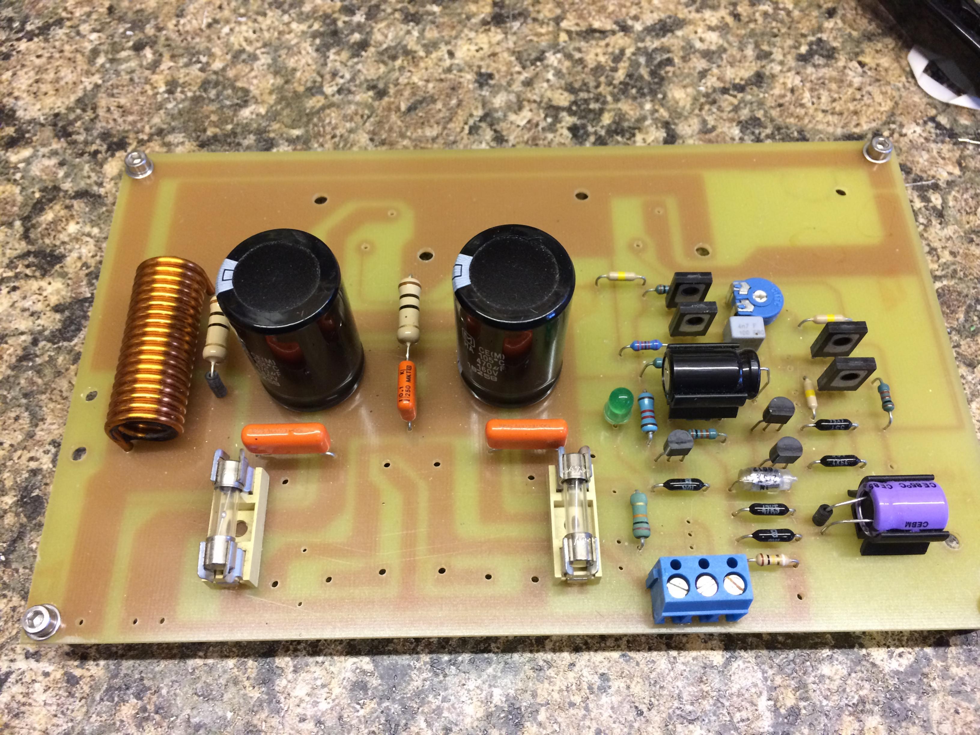

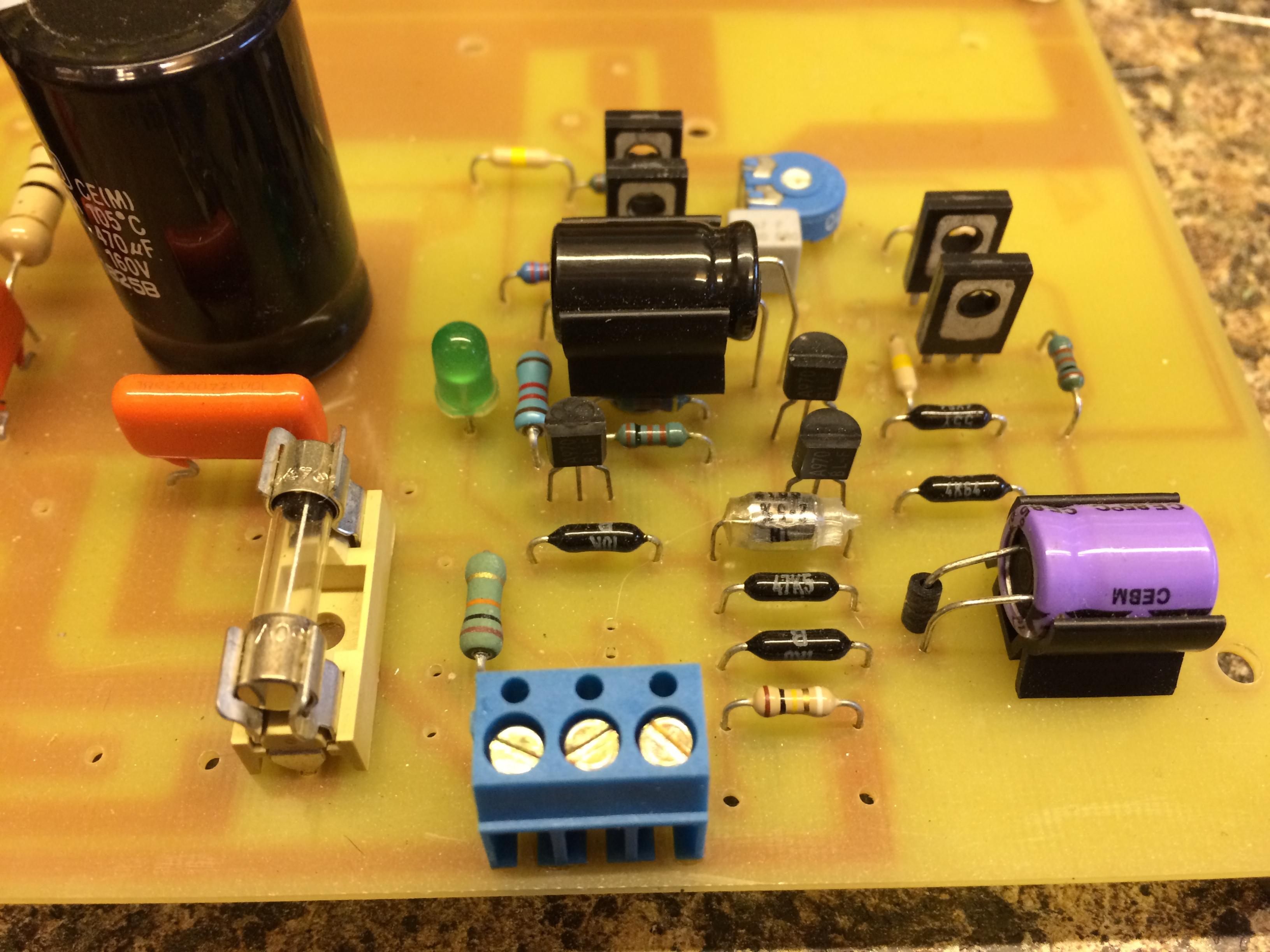

Bespoke Constructor
Joined 2006
this is my new uprated Maplin module ... still work in progress .. but is very similar to the maplin schematic but with a LED bias for the long tailed pair input .. and a very heavy duty PCB with thick high current tracks .. but all based on the same design
The experts amongst you will recognize the PCB ??
