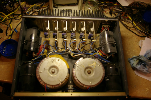

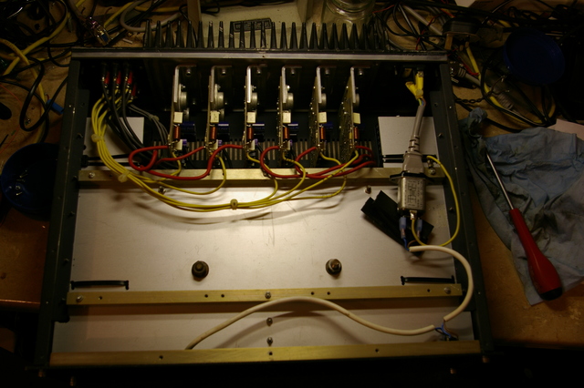

Yesterday evening I went to a junk sale at the local radio club and spotted a big box labelled "home made 6 channel audio amp". I have often wondered about toying with active speakers, so it caught my eye. I was encouraged by the fact that I could barely lift it. Seemingly, nobody fancied carrying it to their car so I secured it for a grand total of £5.
Had a quick look when I got home and it contains two huge toroidal mains transformers, 4 33000 uF 63V caps and 6 of these amplifier modules!
So, I'm reading this thread with interest...
