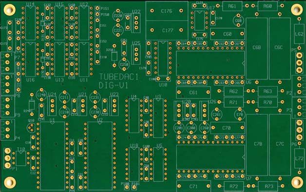

I have a question:
Is it possible to have a mother board for the TDA 1541 and two close pcbs to choose the inputs with a switch connector : via Async USB or via coaxial SPIDF ?

As I pointed out earlier, non of this is necessary.
The Tent Dac is an absolute reference in DAC design implementation. There are many things that can be taken to the extreme, but the design foundation is solid and is competently documented.
Has any of you had the opportunity to take a look at the documents and design implementation of Tent DAC which is kindly provided to the public by Tent Labs?
Tent Labs Dac main pcb will take an experienced Electronics Design Engineer with solid knowledge and experience more than a year to produce, if a min of 3 hours are invested daily in the design.
Add another year to debug, make corrections and test.
Then go back to experimenting and listening tests on the final assembled PCB.
After at least a couple of more ales, you will arrive at something similar to Tentlabs DAC design.
