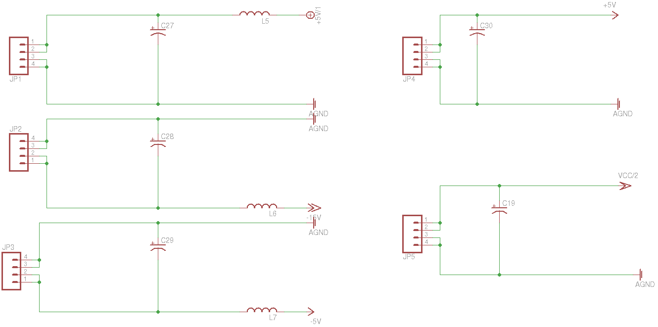

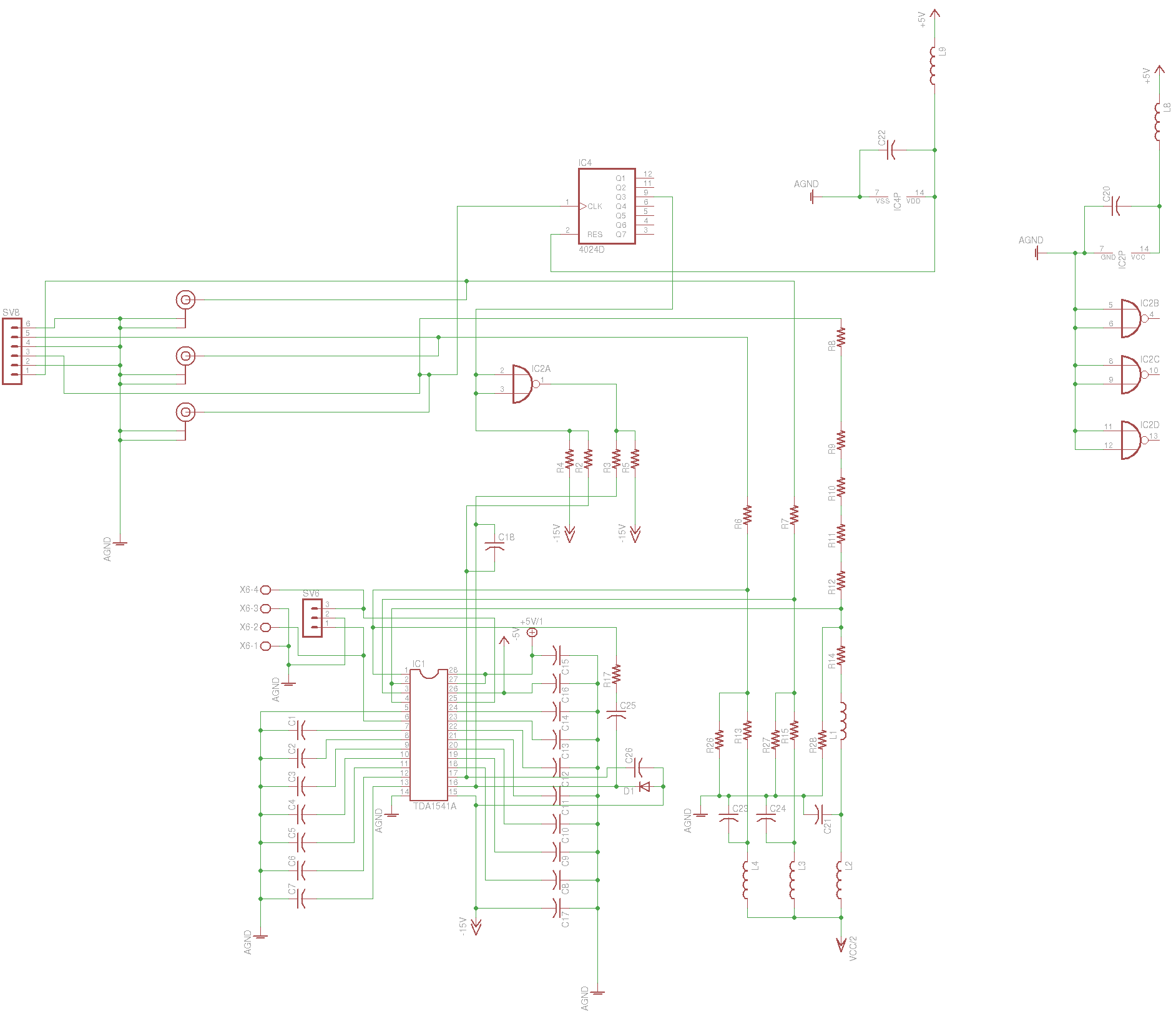

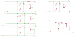

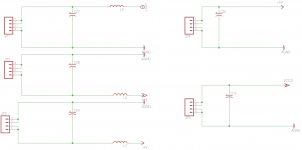

Use entirely at your own risk!! Hi all, despite all the interest, I never had anyone offer to run a groupbuy for this project, however, I have found another distribution method. I am sharing the board via oshpark.com. Here is the link to the latest version:
OSH Park ~ dac1-v14
I will not be available for support and make no representation that the circuit or board is functional in any way. I have not built it. Use entirely at your own risk!! I am not making any money from the sale, just using the free service to host. All I ask is that if it works for you, make a donation to diyaudio, and if you have a spare and would like to send it to me that would be nice.
The shared version is configured for external ps like the salas or regulator available from diyaudio store.
Thanks,
Chris
P.S. Use entirely at your own risk!!
OSH Park ~ dac1-v14
Thanks,
Chris

Chris, you are the man! Thanks so much for your efforts. I am definitely interested in building this board.
I hope you don't mind if I ask you to also upload the board (or Eagle file) with on-board TL431. This way one can build both and then compare the two approaches.
Also, can you add the labels for component values or provide a reference (legend) sheet to know and check the values of each component?
Thanks!
.....P.S. Use entirely at your own risk!!
Thanks!

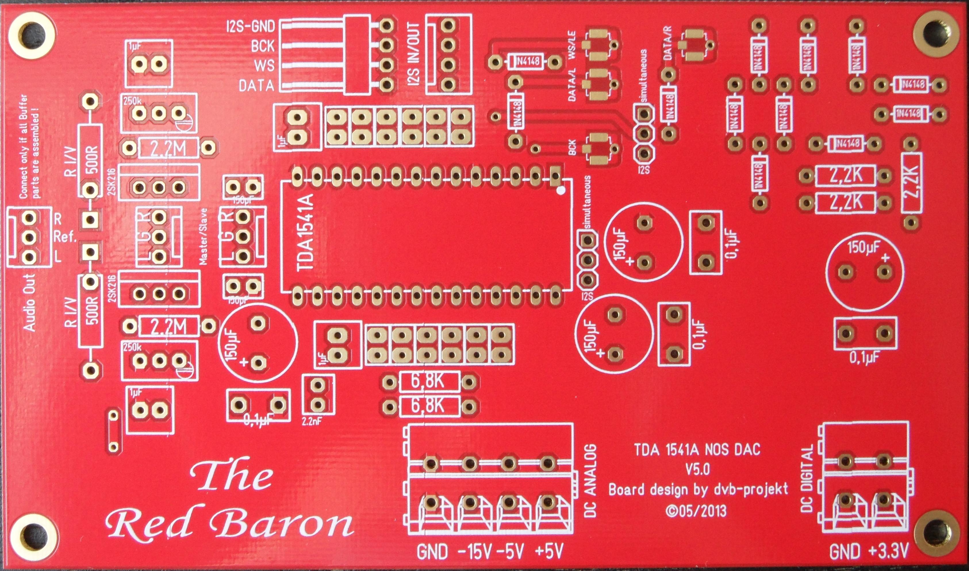

Yes red Baron seems good, maybe it lakes some better grounding for I2S (SGSGSGSG and not SSSSG for connect the wires (read it in a recent post with links given by Marce fellow: this last sort of grounding is really needed for better result for I2S in all the designs). And the kit doesn't resolve the problem of feed this kit... not easy feed it with I2S as it has to be shorter than short?! Maybe the outputstage is a little complex with 2 pcb (but it is DIY, doesn't it?)... and seems not to be the better way to match the texture of a good tube stage designed for the TDA1541... like Mr Loesch do since more than 20 years (some good old shematic here and elsewhere...).
The PCB of Vanofonk is very pretty and the decoupling caps are nearer from the pads of TDA 1541 (but you have not the choice to put MKT or polymer os-con.. which seems only important for just the two higher values for the dividers) : is it an ECdesign inspired one?
Maybe an AMARENO if the laptop is near the hifi system (or a long usb wire between the amareno and the laptop). Or maybe a Sure Electronics module with toslink and spidf input with W8804 chip to I2S ? www.surelectronic.net
Any kit with video opa chip as I/V convertor like your fellow countryman seems to have excellent result with ad844 ?
A nice pcb would be pleasant as I read we need 3X ad844 (by channel ?) for the I/V and it's too difficult to stack for poor skilled people like me which prefer listen Opera or jazz and not put fire in the house
Thanks!

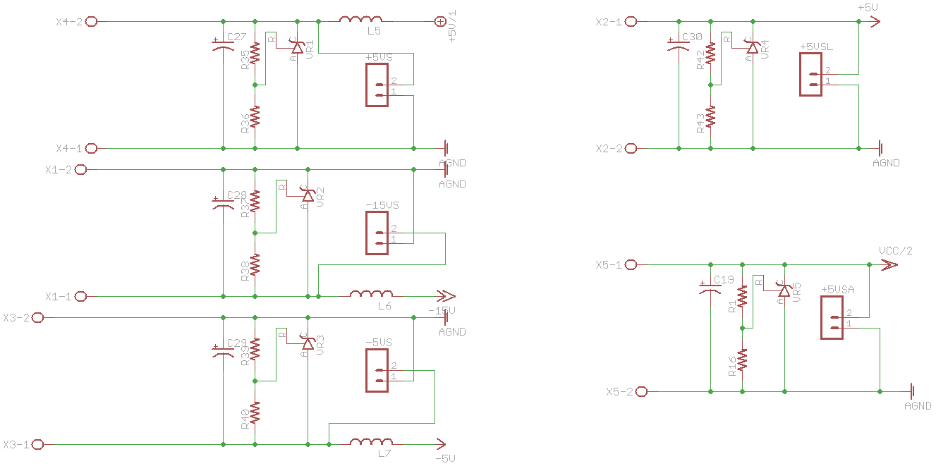

Here is v10 with the tl-431. Again, use at your own risk.
OSH Park ~ dac1-v10
I'll do my best at getting part values, but earliest will probably be this weekend. Earlier in the thread some of the values were discussed specifically by Thorsten. I can publish my layout for Thorsten's 6922 i/v as well, but not sure if I need permission from him.
Chris

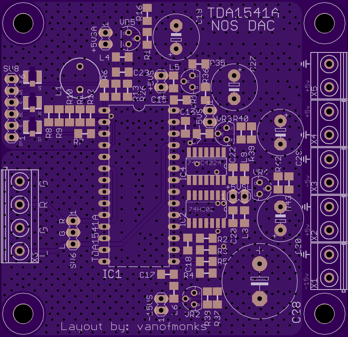

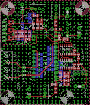

Thorsten the Man of TDA1541A:
vanofmonks has done some hard work here
http://www.diyaudio.com/forums/digi...any-good-tda1541a-dac-kit-57.html#post3866751
http://www.diyaudio.com/forums/digi...any-good-tda1541a-dac-kit-58.html#post3868497
Can you please post some comments?
He is also looking to hear from you if he can publish boards of your Final 6922 i/v stage?

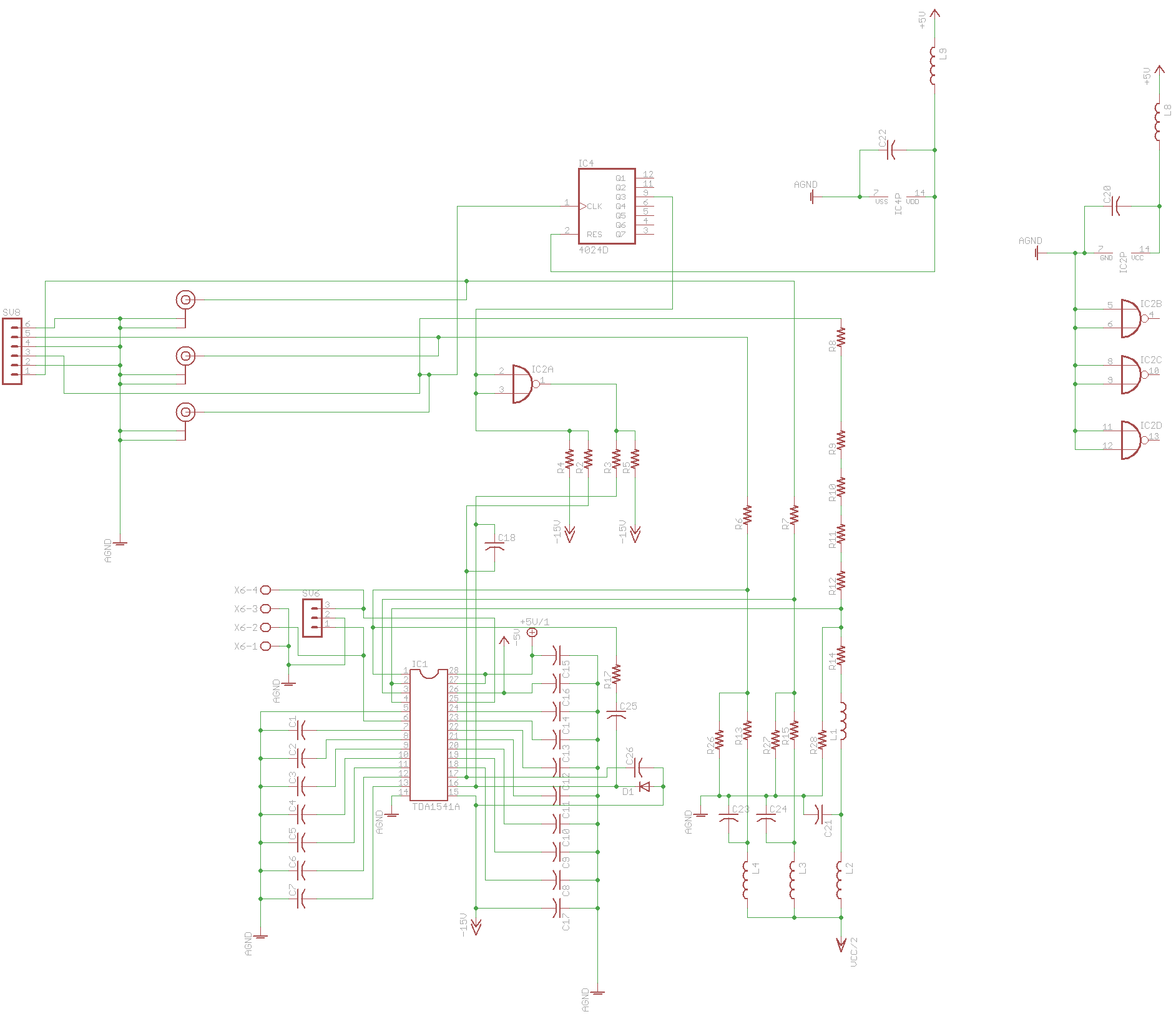

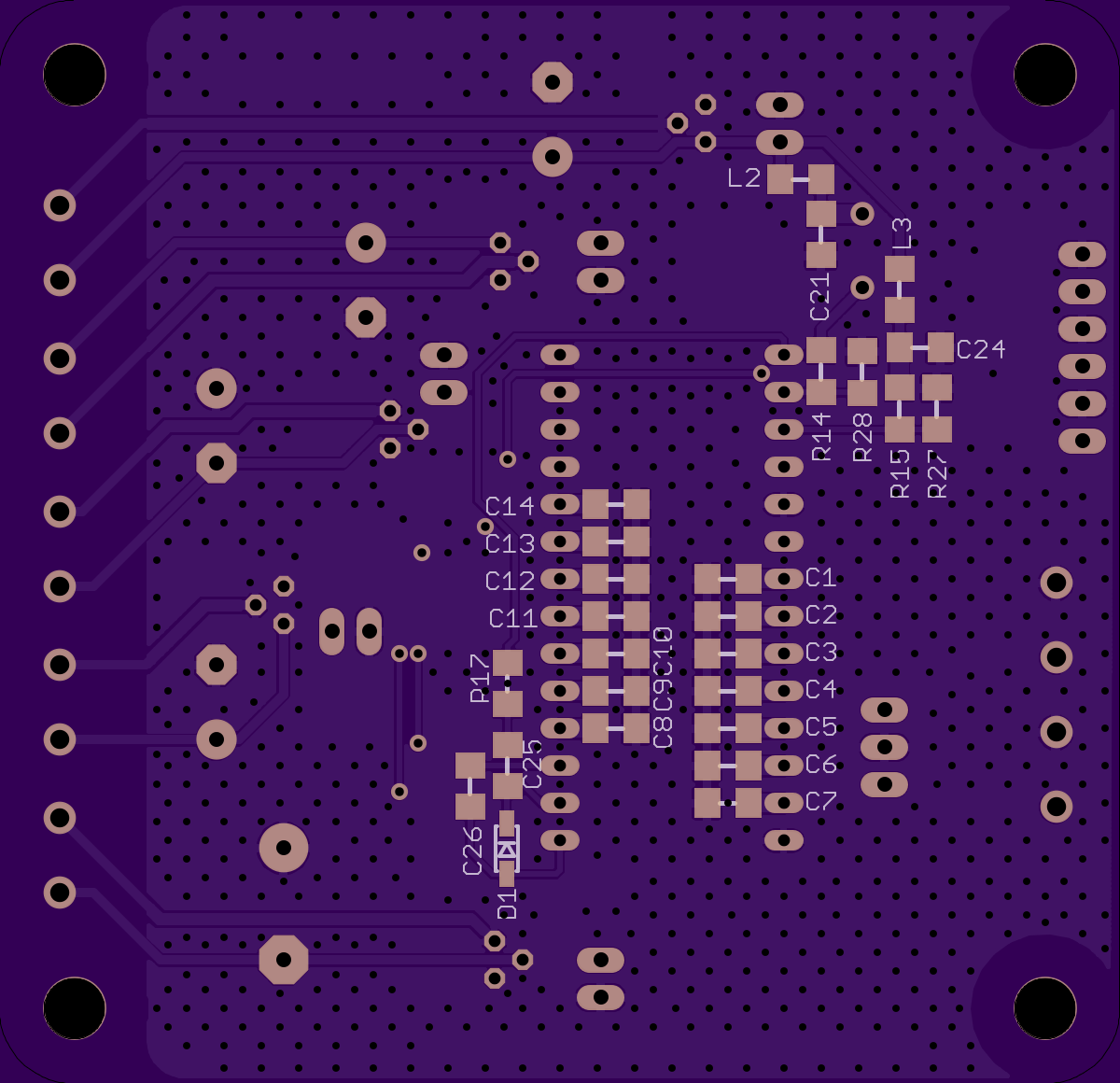

Any good TDA1541A DAC kit? Yes Red Baron vs 5
Hmm, the layout is ... not ideal. The PS cap order is backwards: high freq bypass further than electrolytics?
As well, the ground path for the multiple decoupling caps is cut by the analogue outputs so the currents have to take the long way around to get back to the chip ground pin.
Not ... ideal.
And vanofmonks although tighter ... not confirmed to work.
And I don't see how this could be used with a TDA1541
So ... still no good cheap TDA1541 DAC kit ...
