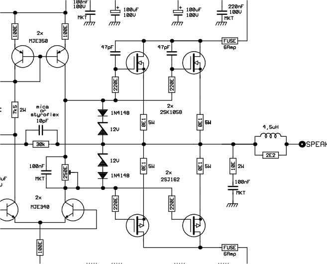

The EX , as it is (below 1) ... with it's retro Mje 340/350's , is quite a nice simple amp. perfect for a sub amp , I have so far "plugged" it into a pair of laterals , a pair of IRF's (like yours) and my 2 BJT power amps.
The typical dominant pole(s) of this amp (2 - 47pF / c6-7) work nice with the IRF's and bjt's. With the laterals , I used Dr Jagodic's (BORA's) technique , setting the Cdom on the output stage itself like his "sigma" (below 2).

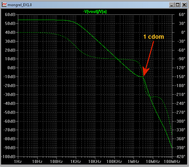

2 things I learned with my latest tests , The MJE340/350's sound better and are more stable than the faster KSA/C fairchild parts with this topology. Also the reason for the 2 Cdom's in this topology (attachment 3/4), is explained below.
(below 3) is with just 1 cdom - C7 - EX ... like some designs actually get away with :D .. that little peak around the unity gain point can actually be heard (scrillness , fatiguing) , but no oscillation or other destructive habits will occur. (below 4) is with both C6-7 , notice the curve is different (it's "smoothed" out a little) ... this sounds much better. The "sigma" Cdom with the laterals(below 2) smooths this "bump" in the bode plot out entirely and sounds by far the best with extended critical listening on full range speakers.
A good amp ... simple and clear , but it takes just minute changes in the compensation to go from good to exceptional. Amazing that it DOES NOT sound good with the faster 2SA1381/SC3503's. With the laterals AND the Verticals FET's I used 220R basestoppers and ferrite beads at the gates. My CRO can not "see" over 20mHZ ,so I measured any current that the zoble was passing to determine if I had oscillation. the slower BJT's will oscillate under 10mhz .. that I CAN see. So strange something up in the Mhz range can affect what we hear at 1-15khz !!!

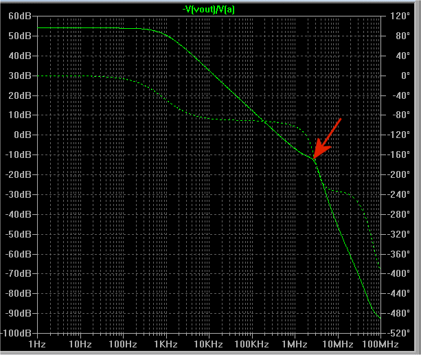

Attached what compensation looks like for this amp. Looks different somehow.
Ferrite beads are a good idea with FETs in general. I thought about adding some but didn't. I can't scope beyond 20 MHz as well and don't know what's going on there.
But I can imagine HF can impact sonics in many ways, for example modulation effects.

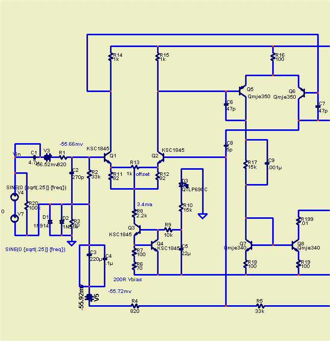

Here is a schematic for you with voltage values.
Please examine the schematic.
Now take your voltmeter and measure the labeled voltages.
Tell me differences.
Good luck.
Lee
(The asc file is for people interested in simulating this amp with LTspice.)

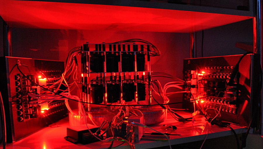

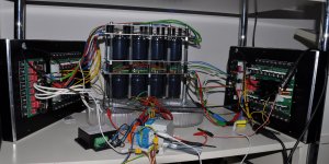

Tested the capacitor block today. I'm surprised the fuse didn't trip. It seems the soft start does a good job.
Plus the little buzz/hum is gone now. Obviously just 5cm of 2mm² ill conceived wire can mess up grounding completely. :eek:
