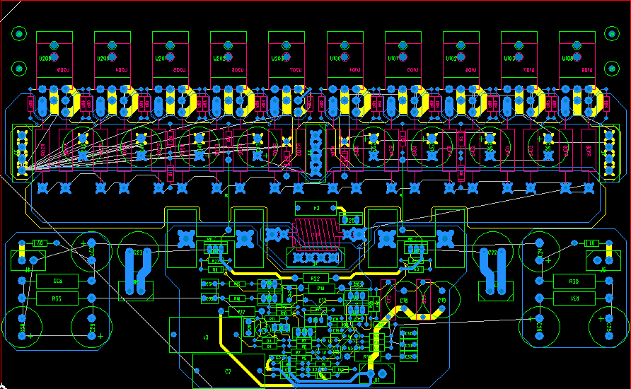

The last thing missing is a housing. First I wanted to have the interior complete and working. I have a concept already but I'm far from having usable drawings.

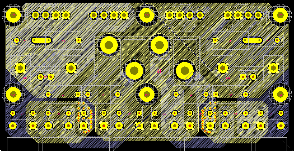

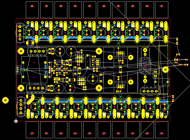

Hi Lee,
this is very beautiful work. I also want to build AV 800/1000.What is the smaller pcb in front of the big one. Would you send me the schematic of your amp and also the pcb layout (s).

The smaller PCB is for the rectifier.

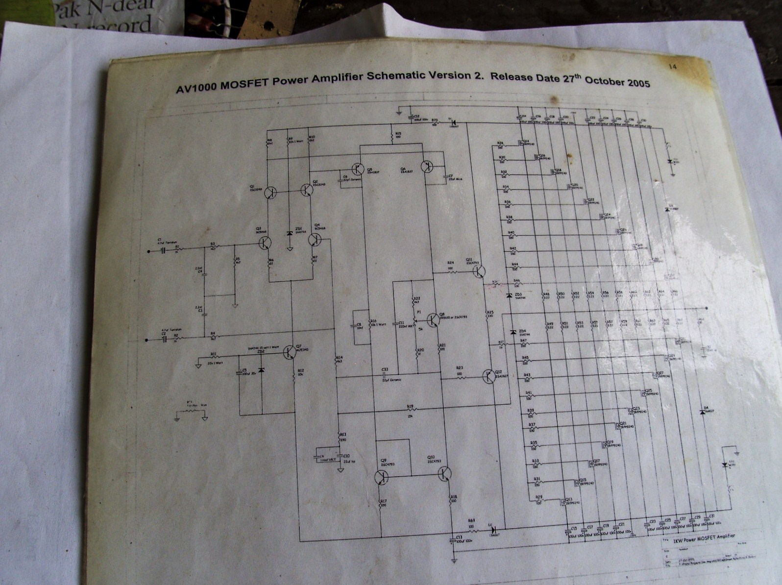

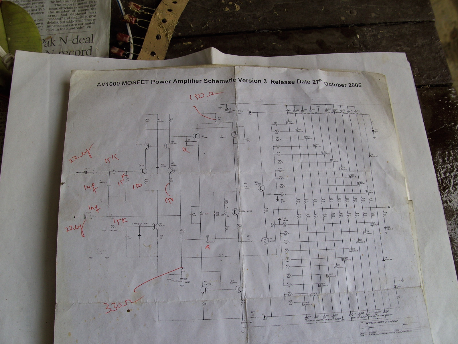

You should find the schematic in earlier posts already.
But I spotted some mistakes in the meantime and made some adjustments to components in the schematic.
This affects the inverting input. With the current resistor values CMMR is poor. With new values in theory up to -40dB could be reached but I expect much lower CMMR due to component temperature drift.
By the way: If you're serious about building this amp I would recommend to use a lower supply voltage. 90V is too close to the SOA. 70 to 80 Volt is plenty and gives more robustness.
Please find attached the latest schematic.
Regarding PCBs:
Please understand that I won't publish manufacturing data.
But you can have PCBs if you like. Contact me for an offer.
