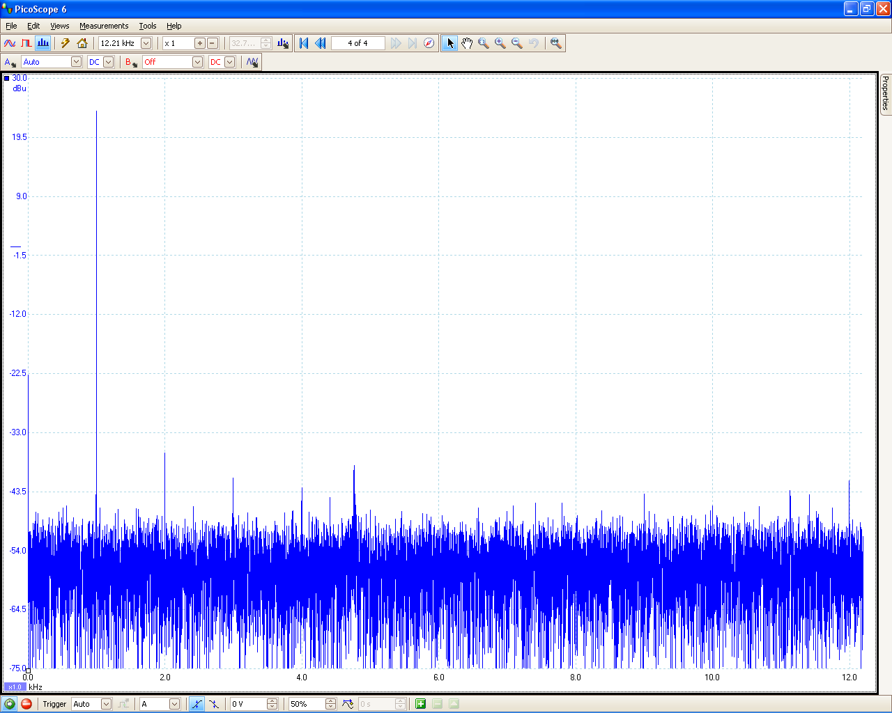

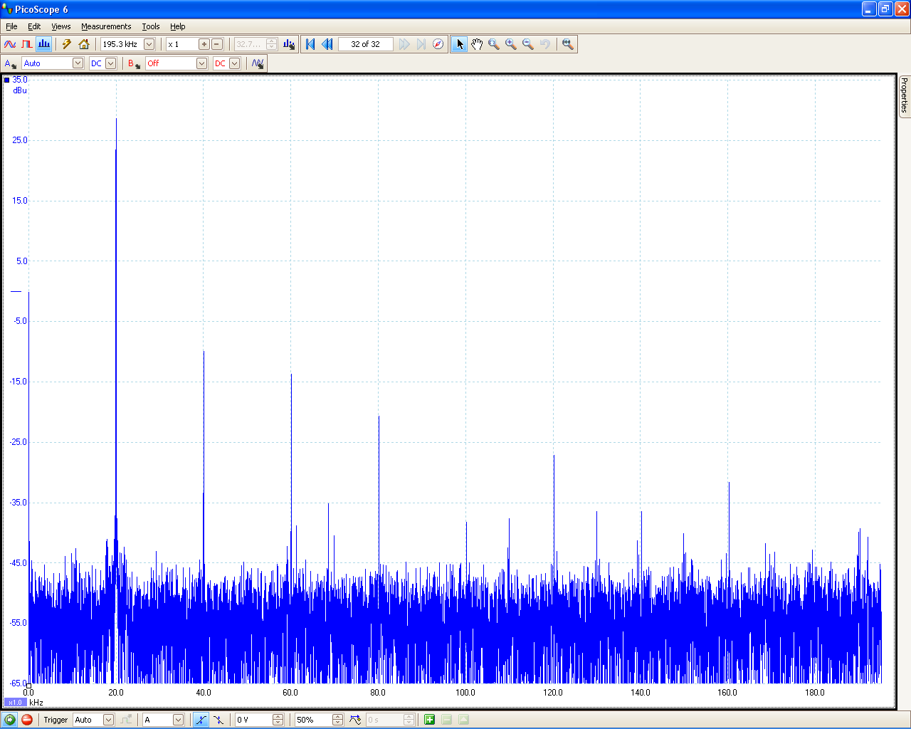

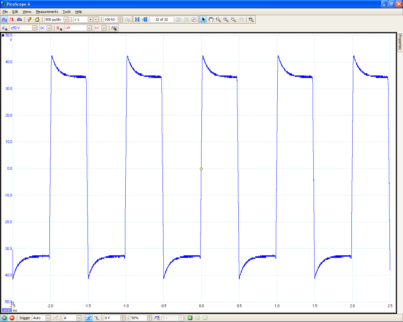

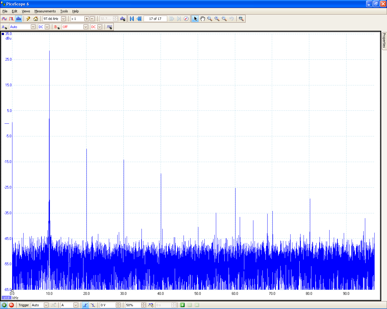

Ok, the amp survived the square waves.
Let's see what the spectrum looks like. I have a lot of noise since my test setup was everything but clean (and the scope shows lots of noise anyway with shorted leads...) but spectrum still gives a hint how harmonics are distributed.
First one: 10kHz 32Vpp into 5R6 load.
Looks nice to me.
Dominant second harmonic, lower third, even lower fourth,... Interesting the 6th is higher than the 5th.
About your spectrum:
I am not Audio expert, but some considerations:
1) it looks like that the small problem with the 6th come from some external noise "beating" with some of your harmonics. Maybe an energy spare neon bulb or so on. They have nasty oscillators inside in the multi 10th of kHz range.
2) It might be intersting to see the spectrum generated by a 1kHz input, since most of the harmonics , if present, will be in the audible range.
About the PCB, if you do not mind, I will appreciate if you share it.

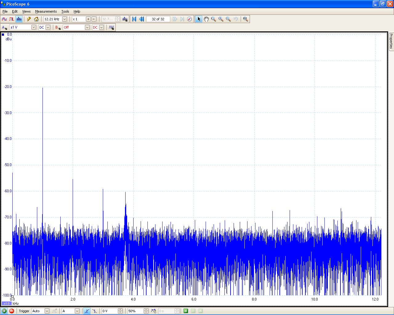

The place where I made the measurements was noisy indeed. To make it worse the input was connected with plain unshielded wire to the signal generator. I might have had some ground loops with all the equipment involved, the signal generator, the smps, the PC and who knows what else. A USB port isolator helped a lot getting rid of some very visible disturbance.
Sorry, I forgot the 1kHz spectrum.

The 1K spectrum shows something like 30dB 2nd harmonic rejection and close to 40 for 3rd right?
Not so bad..

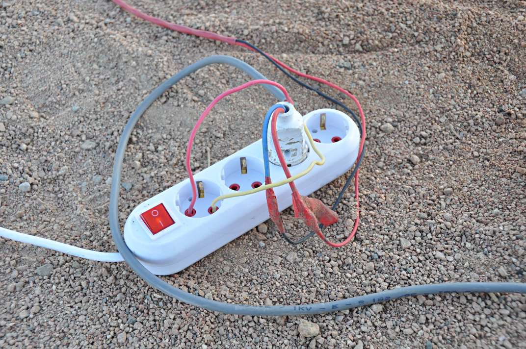

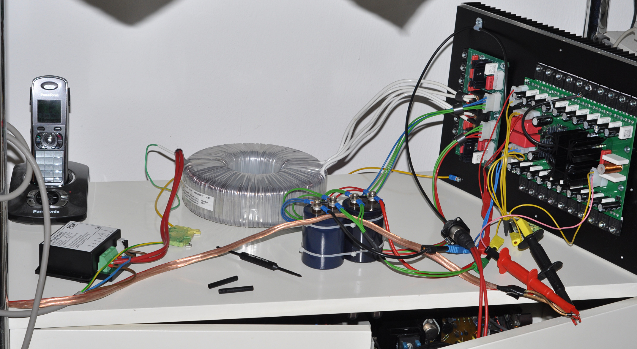

I think about building a provisional wire harness to use the toroid, rectifier board and storage caps for further testing. This way I could test it with a real loudspeaker as well.
It might be a bit dangerous but "danger" and "safety" are very comparative terms anyway.
See what they do in Egypt. This is how the workers connected huge electric hammers to the mains. I've seen this many times. They seem to connect everything this way.

hi Lee,
Nice results sofar!
The square wave tests are looking good, overall stability looks fine.

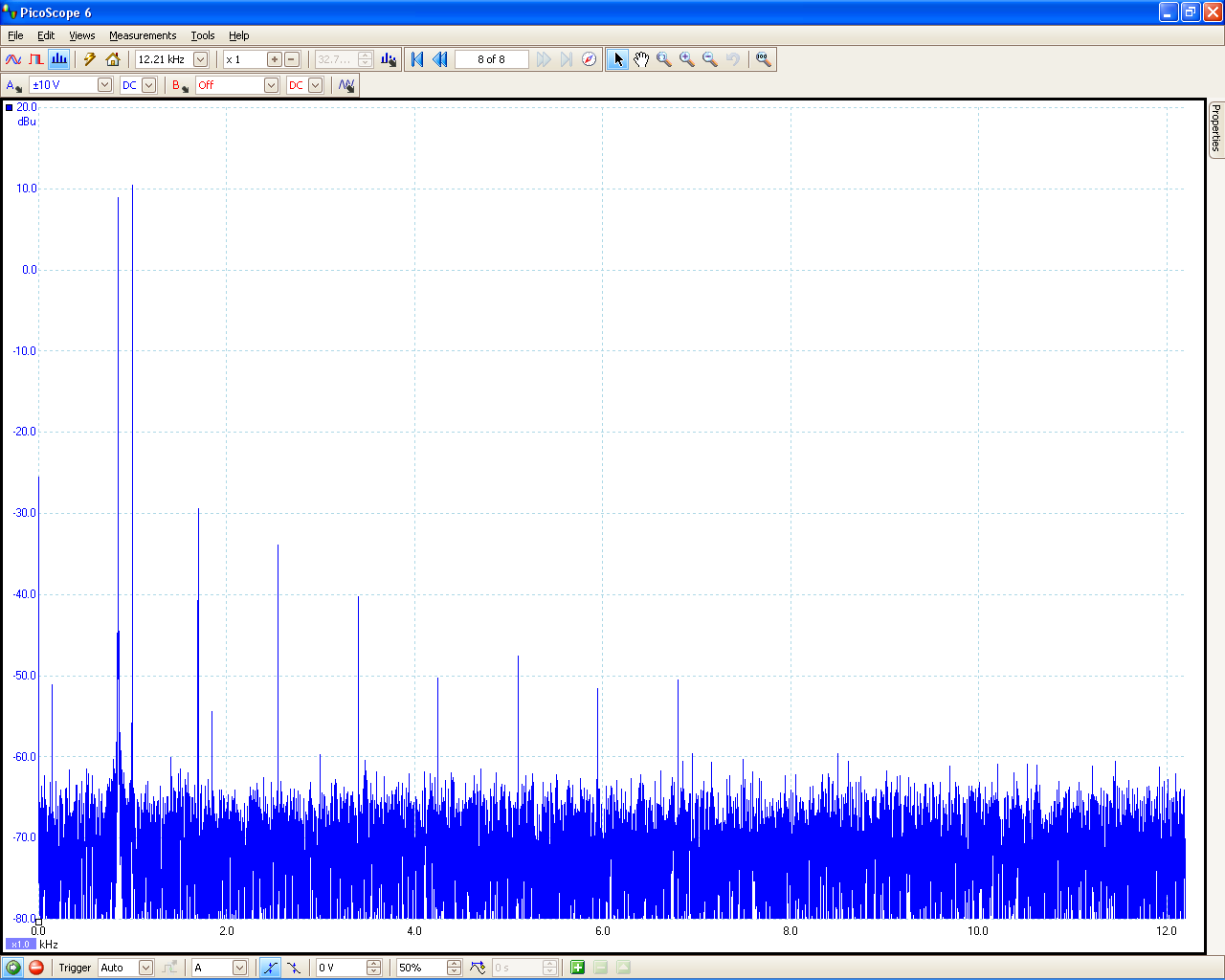

I spent the afternoon with measurements.
Now I'm confused again.
First things first.
No.
Last things first.

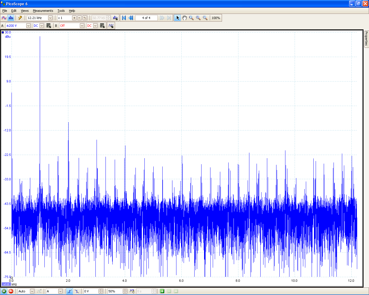

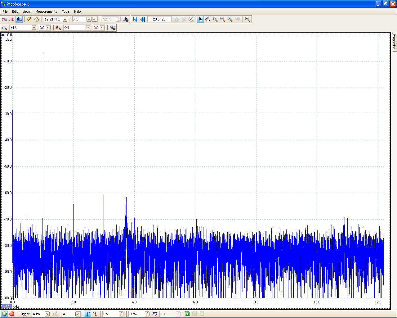

I found out that the Hameg 8030-4 adds a lot of harmonics and the PicoScope (3206) has a superior Wave Generator. I didn't expect this. The PicoScope generator has more third harmonics, the Hameg more second.
Attached spectrum of both loaded with probe only.
First things first.
No.
Last things first.

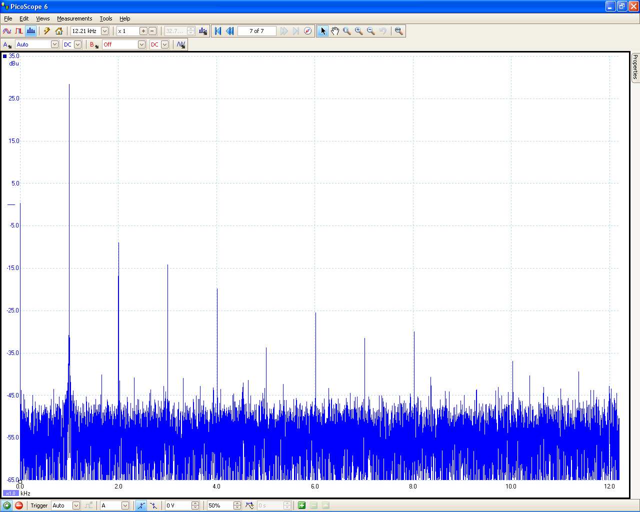

With the Picoscopes generator spectrum looks different.
I burnt my 5R6 load resistor and managed to find a 4R one with more power.
I can't set the level of the pico generator so results maybe aren't comparable anyway...
1k 36Vpp into 4R load

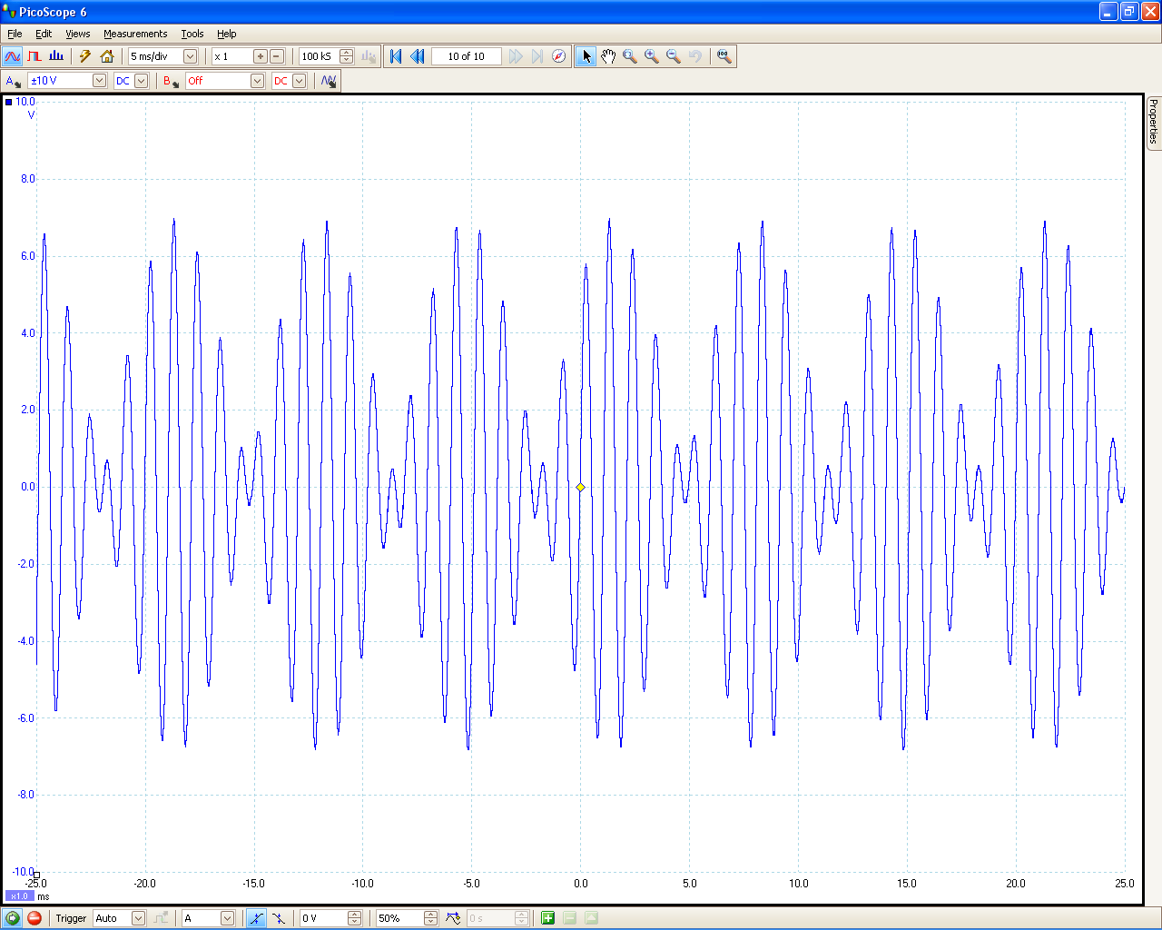

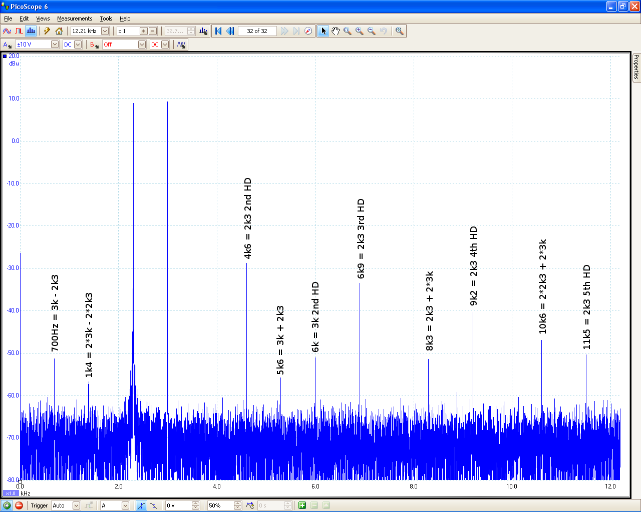

After looking at the spectrum plots for a while and thinking about what I see I came to the conclusion that this test didn't reveal much about the amplifiers behavior.
I made two big mistakes:
First was the sloppy input connection that picked up a lot of noise. After I fixed it everything looked much more reasonable.
Second was not to check the spectrum of my signal generator.
The spectrums of the amplifier's output actually reflect what harmonic content is present at the input from the signal generators. With the two different generators this became too obvious.
Intermodulations of harmonics are due to harmonic content at the input. I'd trust the f1-f2 and f2+f1 intermodulation artefacts since this are the base frequencies. For the 2k3 and 3k test the spikes at 700Hz and 5k6 are true, the rest is very generator dependant. In this spectrum the 2k3 was Hameg generated with lots of harmonics, the 3k was generated by the PicoScope with its typical harmonic footprint.
I'll do the wire harness then and just listen to the amp.

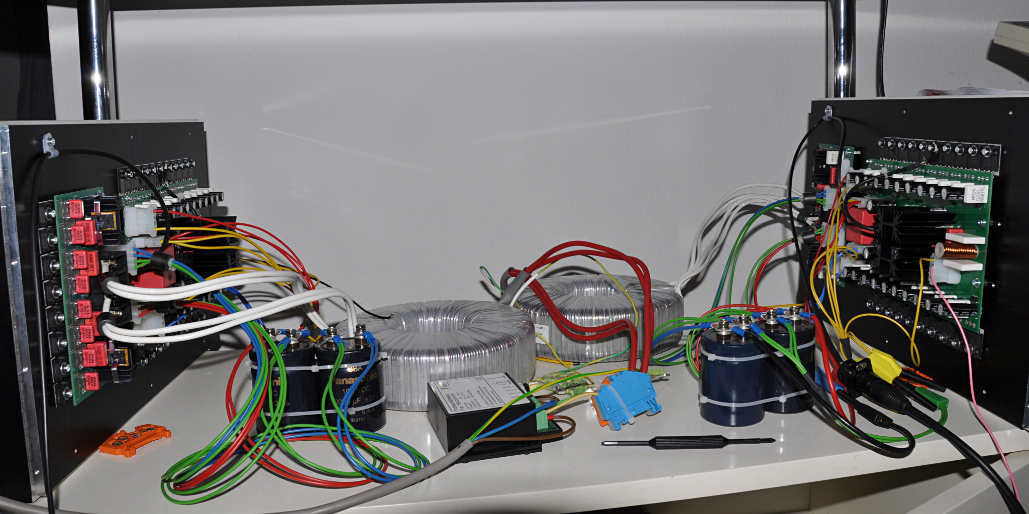

This is what my amp looks like at the moment.
Since I ran out of money it will look like this for a while now.
I will build the second channel and plan a nice housing in the future.
I already listened to it but can't tell you how it sounds.
I use a DIY active crossover because I don't like the bass of my full range speakers and have a 15" driver for everything below 100Hz. At the moment the Weld-a-Sym is used for the bass channel. Later it will be used for the fullrange speakers that run with my old DIY amp now.
