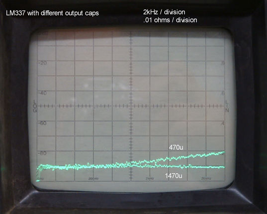

As to the unexpected linear Z of the LM337, I double-checked the analyser display scaling with .01 and .1 ohm resistors, no problems there. No errors in the 337 circuit. My hunch is that previous published graphs must have been done with very small output capacitors, 10uF are typical.
Here is a pic, linear impedance sweep to 20kHz, with 470uF and then adding 1000uF to it. (I'd have to take the fixture apart to remove the 470u, maybe some other time.) This is about what I would expect.
My conclusion is the LM337 responds very well to changes in output capacitance, better than its sibling 317.

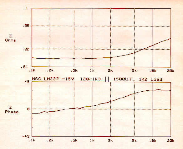

Well the impedance gods were smiling on me yesterday, I was able to repair an HP 4276A LCZ meter that I had given up on a couple years ago. The previous owner had spent over a grand to replace the custom discrete IC's (made by Sony for HP) which he had blown by exceeding the DC volts limit of the input, but with no success. I just noticed yesterday that he had installed all 6 of the IC's backwards! Amazingly, they were not damaged by it. I owned a 4276A back in the early 90's and wrote a program for the HP 9845B to collect and plot the data. Today I'm glad I hung on to that computer!
As I noted near the start, the spectrum analyser technique does not yield accurate numbers, but would show trends. The matter is compromised by the 10,000uF cap needed to isolate the DC from the oscillator output. At higher impedances it's not a problem. But at the milliohm impedances we're trying to measure, the capacitor's impedance rise with lower frequencies obscures the trends down there.
Here's the LM337 using the 4276A with 4-wire connection, looking more like we'd expect it to.
There is still some variability in the measurements due to equipment warmup, contact resistance, who knows what else. The same measurement made 1 hour later saw the baseline impedance value just under 10 mOhms, as opposed to the 15-ish mOhms of this sweep. But the shape of the curve was the same.

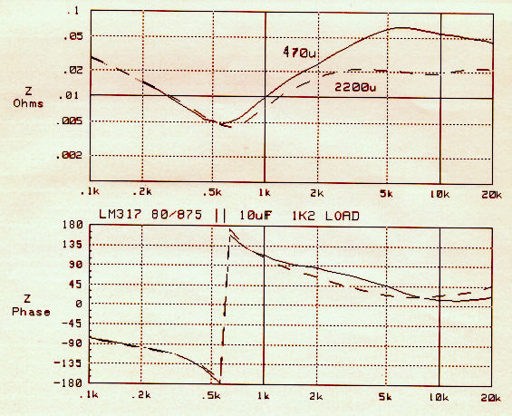

Busy week, sorry for the delay. Here are two measurements of the Nat Semi LM317 with the HP 4276A, same setup as before, looking just as stinky as it did with the spec an. One sweep with 470uF on the output, another with 2,200uF. This again confirms the sweet spot (that's a generous term) for the output cap is somewhere in the 1500-2200uF range. Note the 360º impedance phase cycling with resonance at 600Hz or so. If a lesser bump at 2.5kHz is extremely audible, this dip can't be a good thing, right in the heart of the midrange.
To see if this was a brand-specific issue, I tested a 317 from TI and another NSC from a different date code and they all looked appreciably the same. I also tested an instrument that I had been repairing this week which used LM317/337, and same results.
So it looks like the 317 is a lower bandwidth device than the 337. Any ideas on how to address this?

is that 360 degree phase shift when the reg become inductive present with the spec sheet recommended cap values?
the frequency of resonance is predictable: 1/(2pi rootLC) - the lm317 inductance with the load current above 0.1 A is about 1 microH.
i am inclined to think the resonance you observed is related to cap esr. try putting a small value resistor in series with the cap - this will also increase output impedance but perhaps you'll be able to find a reasonable compromise. 180 degree phase shift is definitely something to be avoided as what what negative feedback is now positive feedback.
an alternative approach might be to increase your adjust bypass cap to 1000 uF or more, your load current to 0.5 A or more and use a smaller output cap. According to Erroll Dietz this should also give low output impedance.
Yes, you can see it in my previous measurements too.
I played around with this last week and it was not significant in the audio band. But I'll try it again today.
I have already shown, this will lower noise but make the resonance worse.

As you can see, above the resonance, the output cap is the dominant factor.
My measurements don't agree.

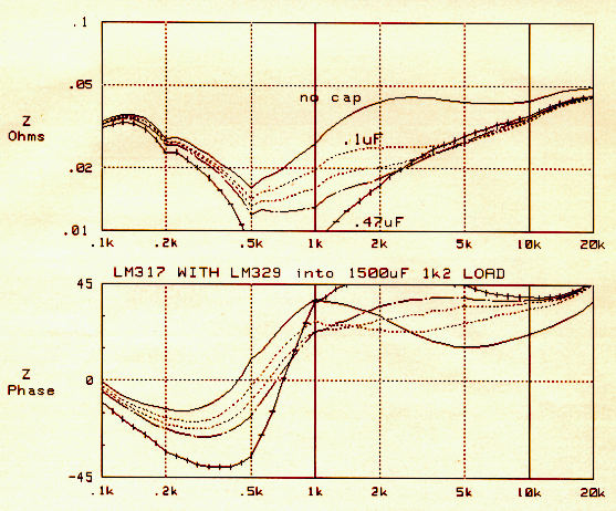

Okapi: I checked again your cap resonance theory and this is not an ESR-related resonance. Adding R up to 27 ohms made no difference.
I put together the LM317 version of the circuit shown in your post #16, reversing the LM329 of course. For +15V output R2 = 750 ohms. It worked fine. I didn't measure the noise because in my mind if the impedance is screwed up I don't care how quiet it is.
The impedance sweep is below, compare it to the normal scheme in post #55. It's a step in the right direction, the resonance is damped so the phase doesn't cycle through and the impedance bump around 6kHz is lower too. (When comparing, note the different graph scales, my program auto-scales to the first measurement in each plot series...)
I noticed there was no cap to shunt the noise of the LM329 so I played around with that (across R2). The plot starts with no cap, then 100n, 150n, 220n, and 470nF. It was obvious where this story was going so I stopped. Just as we saw with the resistor-only version, the LM317 does not like to see a large capacitance on the adjust pin (the LM329 impedance at audio freq's is around 1 ohm). It resonates across the 750 Ohm R2 after 220nF.

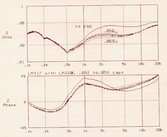

After seeing that, I decided to try lower-value caps. The plot below is with 56n, 68n, and 82nF. It's hard to tell, but the 82nF trace is the middle of the three lower traces. So the impedance went down until 68nF then went back up again at 82nF and then starts going down again as seen in the previous post. 68nF | 750 Ohms = 3.1kHz. Which is really close to Steve's Sandler's suggested RC value for optimum LM317 phase margin:

Notice that the 68nF curve is about the same as the 100nF curve except that it doesn't affect the resonance. So the 68nF across R2 as the best.
