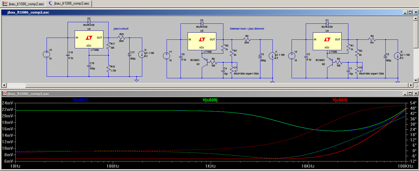

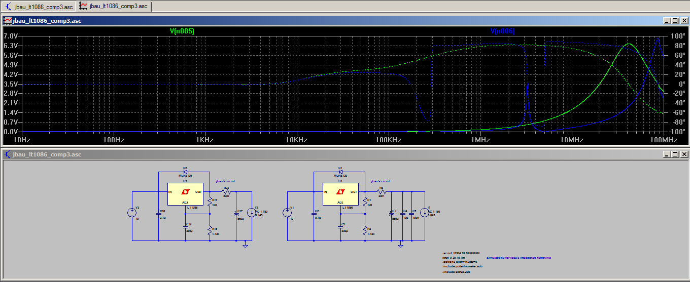

I've been doing some sims, using the LT1086 and also the LT317 and it has been quite interesting. One thing that had bugged me about jbau's results was that even though he was using large low esr caps on the output he didn't appear to be getting any resonance problems.
I also discovered that LTSpice does not take load resistors into account when doing AC analysis so the results being displayed when I did impedance tests were basically unloaded. Putting a dc component in of 0.045A which is the current jbau was testing with (330 ohm load resistor on 15V supply) the resonance disapeared (at least with the LT1086) with the LM317 it is there which is the hump that he was talking about when using the LM317.
Interestingly though dropping the current down to 10mA shows a strong resonant hump in the impedance even with the LT1086. It's completely gone by 45mA though.
What is even more interesting is that the impedance flattens out more (as does the phase) with increasing current. I can go to 240mA before the sim goes wacko. I suspect it is an issue with the current handling of the LT models.
The diekman mod doesn't make much difference except in one key area. The adjust cap can be MUCH smaller and still have superior phase at the low frequencies with the Diekman mod. 15uF cap vs 330uF cap in the jbau version.
I found that with 200mA load that 5mOhm resistance on the output flattened out the phase nicely also resulting in a much flatter overall impedance almost all the way to 20Khz and what I think is a better phase curve as well. That's great for me because the ciruit I'm powering draws about 250mA but I guess you could just add in some additional load resistors and burn extra watts to get it more linear.
Well if the sims can be trusted of course. Certainly the results with the standard circuit which jbau posted seem to correlate well with the measurements he posted.

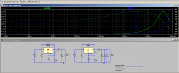

Attached is an image from the sim. Blue trace is jbau's circuit as per post #248 (without the paralell 10uF film and 100nF caps) green trace is the same circuit but with the Diekman mod and 15uF cap instead of 330uF cap on the adj.
Red trace is with the Diekman mod and only 5m ohms on the output. Note that doing the same on jbau's circuit with 200mA load gives very similar results with slightly worse phase at the low frequencies.

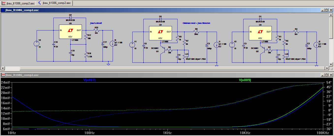

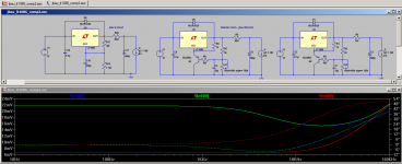

In the second plot I compare the results when using a 15uF cap on adjust with both the Diekman and standard jbbau circuit.

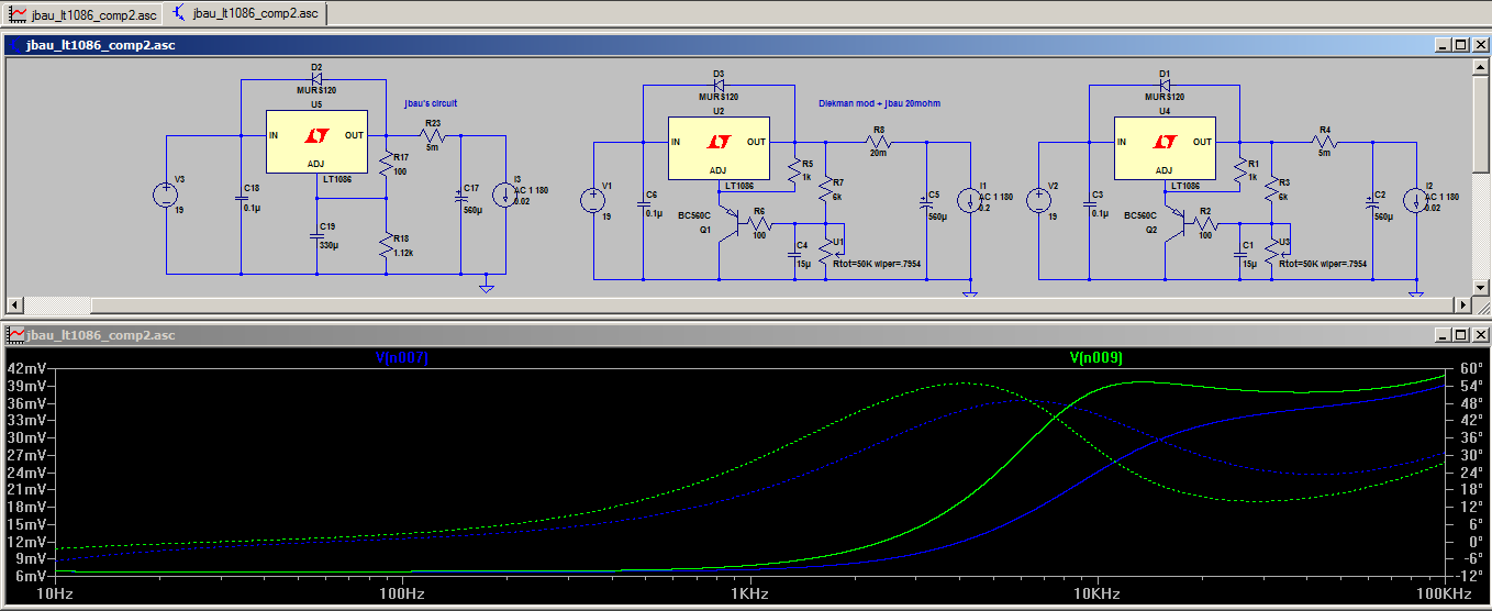

The third plot shows what happens when the current is dropped to 20mA (still with the 5mOhm output resistance). The resonance with the output cap is starting to show through, interestingly it is more of a problem with the Diekman mod.
Anyway that's probably enough for one post!
Tony.

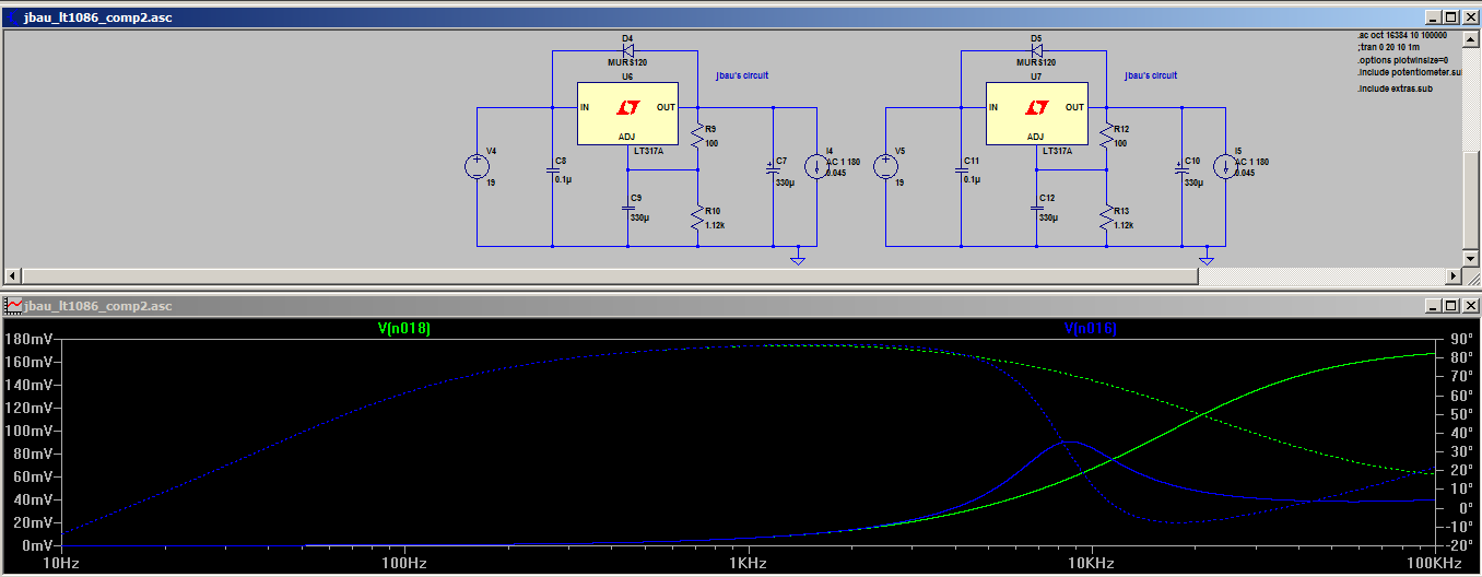

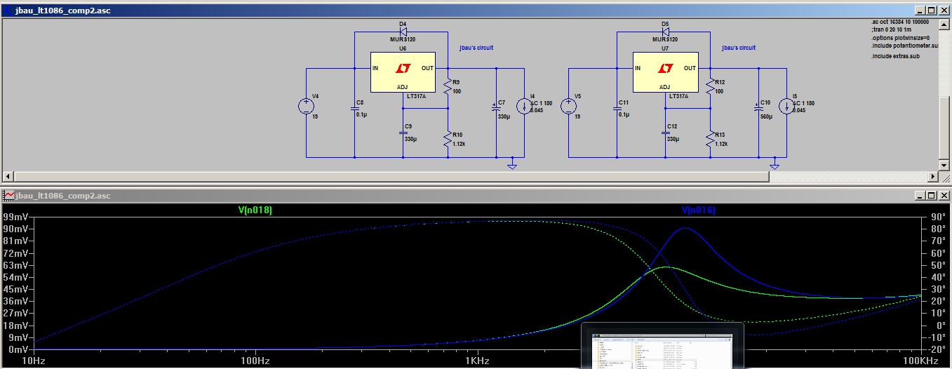

Attached is an example of low esr 330uF on the output (0.04 ohms esr) blue trace, compared to 330uF with 0.2 ohms ESR green trace for LT317. I dropped the output cap to 330uF for this demonstration as it makes the resonance clearer.
This is with no series resistance in the output. Current 45mA as per jbau's other tests.
With 560uF the peak is a lower and broader and pretty close to the 6Khz that jbau mentioned. The second image shows the 330uF blue and 560uF green.
The first plot clearly shows that the higher ESR tames the resonance but at the expense of much higher rising impedance with frequency. It is this that has made me think that moving to the LT1086's is a good idea.
Tony.

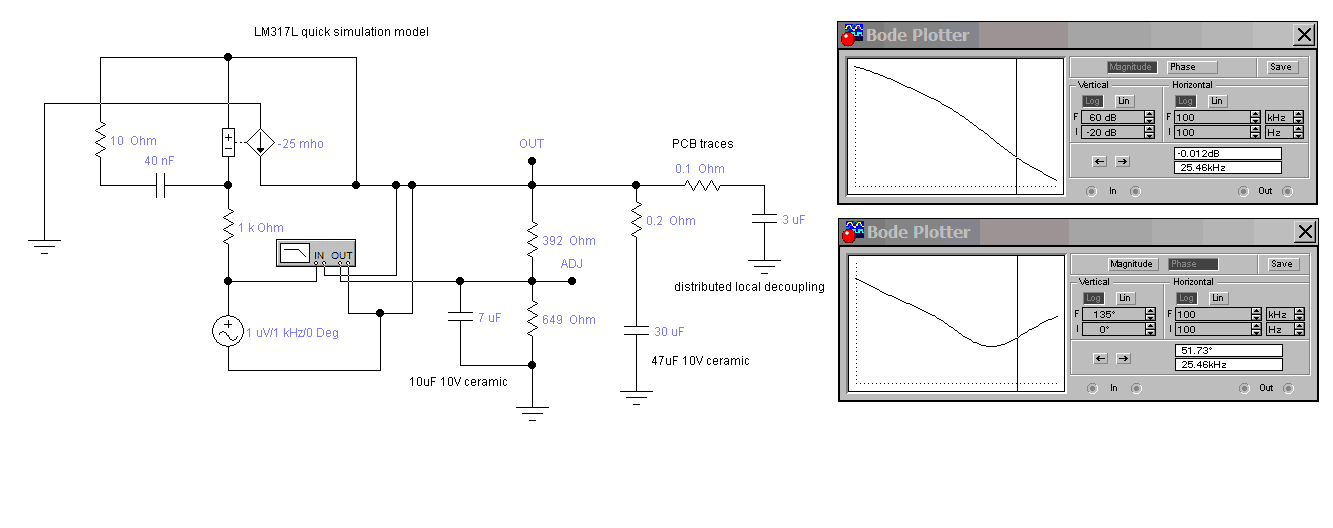

- LTxxx parts are expensive and improved and do not necessarily represent behavior of low cost LM317L from TI, National or ST.
- LTSpice is not the simplest approach to simulate linear voltage regulators, the power of this software is simulating switching power conversion.
- Electrolytic capacitors are programmed obsolescence. Values as high as 500uF are not practical in ceramics. So in the end the challenge is finding the way to make it well behaved with reasonably sized ceramics. In other words: finding the lowest cost option to get a circuit with the minimum set of features and no practical drawbacks.
A LM317L open loop gain simulation model obtained directly from prototype is attached. The added 0.2r is the trick to get it stable. The 0.1r are PCB traces.

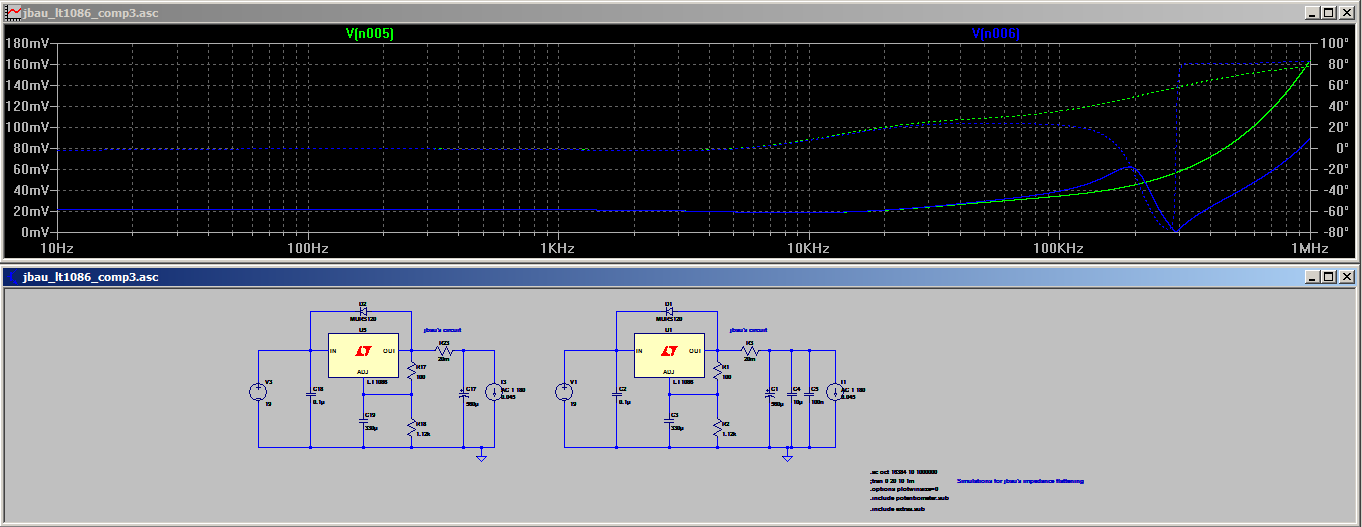

Bruce, post 382 was the original comparison. The sims correlated well with what jbau reported. I just added in the diekman mod to compare, as I was interested to see if it made any difference, which it did.
Post 387 was done purely to show the effects of ESR in the output cap on the LM317 and was not supposed to be representative of jbau's circuit at all (jbau abandoned use of the LM317 completely by that stage). with the 20m Ohm in circuit the resonance is not removed it is just masked, hence taking the resistance out to better show the presence of the resonance.
With respect to the original comparison in post 182, I didn't put in the 10uF film and 100nf simply because I did not have esr data for them (jbau did give esr details for the 560uF cap), and I did not think that they would be relevant in the audio band. Putting in wildly wrong ESR data for these caps could potentially give misleading results.
Just for completeness I have just added them with complete guesses for ESR. 10uF with 0.001 ohms ESR and 30nH ESL, 100nF with 0.001 ESR and 10nH ESL It makes very little difference at all in the audio band, so for the purposes of what I was showing I think it is close enough to say that the omission was not an issue, especially since jbau only showed data from 100Hz to 20Khz.

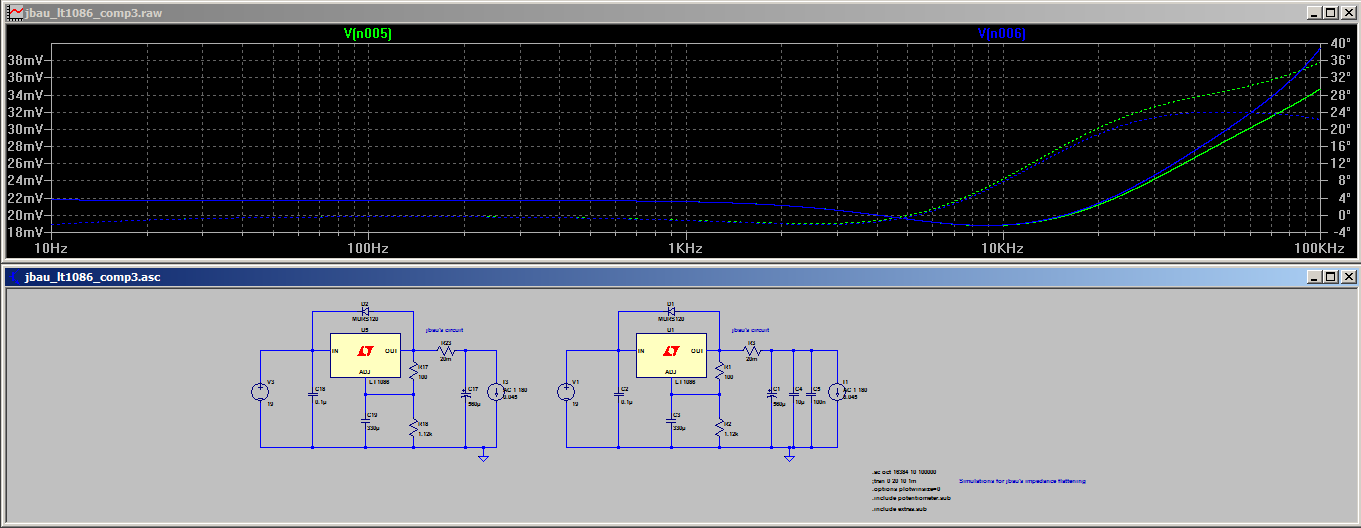

You may be interested to see what effect those extra caps have on the impedance at higher frequencies (again the ESR data for those extra caps was made up and is not really valid) in all cases green is with 560uF cap only and blue is with additional 10uF film and 100nf.

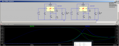

I've now also done some sims with the LT3080 (which is not a three pin so irrelevant to original purpose in this thread, of modifying existing PS) and I will be pursuing that, as it appears to be much better, and also simpler (though from the datasheet there are some layout considerations that are not necessary with the older three terminal regs)
Tony.
