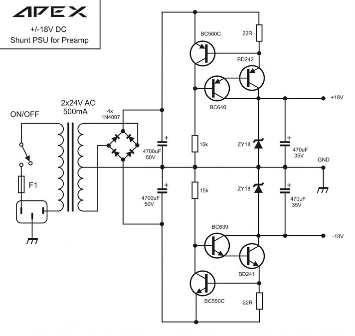

Having tried several other designs, including the Apex design below, I still prefer the sound of a LM317/337 supply with lower value caps for Cout and Cadj..

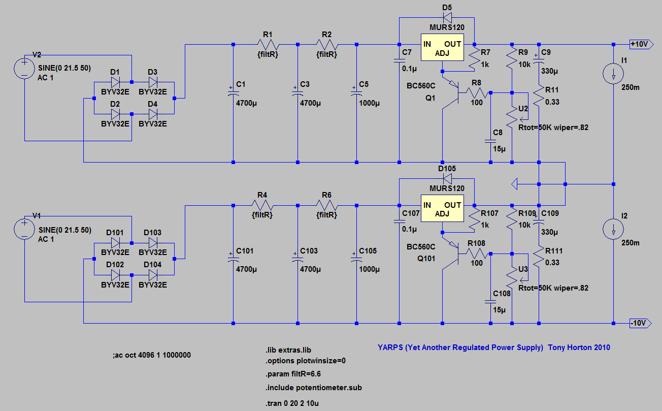

hehe, i designed the PS back in 2010, I revisited the sims when this thread popped up again. There are a few things I would change now.
The interesting thing about this thread is that the 337 was touted as being better than the 317 (and for matching purposes jbau paired it with a totally different +ve reg), but everything else I have ever read says exactly the opposite (ie the 317 is better performing than the 337).
However I think that "better" in the case of this thread was to do with jbau's goals of impedance and phase flattening/matching.

I'm pretty sure that post was the one that clinched it for me to do a design with two positive regs

The someone I suspect was you benbOne useful thread here on diyAudio was this one from Fred DieckMann. Post 34 in that thread is what the LM317 part of my circuit is based on. Another one was This thread from jbau, although it steered me in the direction of NOT using a negative regulator at all. The thing that struck me was his subjective evaluation that symmetry in the supply rails made a big difference to the sound of the amplifier. One person commented why don't you just use two LM317's (which in his application wasn't possible) but for me the decision was clear
ammel68 best is a relative term. For what jbau was trying to achieve he believed that the 317 was best, early on that was due to some errors in measurement that made it appear to have a much flatter impedance than it actually did. Later it was because he found it had a very similar output impedance to another regulator (the LT1085)
benb's suggestion makes the most sense (IMO) if matching is important. The reason jbau coudn't do that was because he was trying to modify existing power supply's NOT designing one from scratch.
So in that context, benb's suggestion is use two of whatever reg, be it positive or negative, which you think is best!
It is actually very simple. You create two identical power supplies. Run them off separate transformer windings and bridge rectifiers, tie what would normally be the ground of the first one to the output of the second one, and what would normally be the ground on the second one becomes your -ve rail. example attached (revised version of my original yarps ps now that I'm a bit wiser... still overkill though ) edit: Note that this is a bit OT from the original idea in this thread, as it does not have the very flat impedance and phase that jbau was aiming for, it does however meet the symmetry aspect very well (I think).
Tony.
The original source of the bc560 idea is here http://www.diyaudio.com/forums/powe...ing-lm3x7-regulator-circuit-2.html#post356154
I originally had a 4.7uF on the adjust to ground (and is what I implemented in the real circuit), but recent sims seem to indicate increasing to 15uF has some benefit, past that there are diminishing returns. Note that there have been many other proposed "better" lm317 circuits. This was just what I decided to implement.
Tony.

Certainly an option (or one of the newer LT series chips) (although I'm pretty sure the early thoughts around the LM337 superiority turned out to be measurement error, something to do with a 10000uF cap that was being swapped from one circuit to the other and not discharging properly from memory, but I can't find the post...) .
I found with the bc560 in play (in the sims) the impedance flattening that jbau used doesn't seem to have much effect, so an other wise bog standard LM337 circuit doubled up should do the trick, but as I said I'm not sure that the 337 was any better than the 317 other than it matched well in jbaus measurements with the LT1085.

brucew268, no I haven't built jbau's version. I have just simmed some of the mods he did (both on the standard reg configuration and on the dieckman version. On the dieckman version the adjust pin mods have very little effect on the output impedance, I also wasn't able to get much effect using the LR on the output either, though that may require more experimentation.
What I have built is an earlier version of the circuit I posted above. Main differences were I had 3.3 ohm resistors in both the supply and return lines, recent sims show that the resistance in the return lines makes the lower half very sensitive to small resistance in the output, with output inpedance increasing significantly below 100Hz. So as was questioned at the time it wasn't such a good idea!
The other difference is I dropped the output caps from 1000uF (with a 470nf parallel) to 330uF. With the 1000uF the sim was not stable unless I added the 470nf in parallel. That should have told me something The sim is stable with the 330uF and the output impedance is almost identical to with a 1000uF.
One other interesting thing of note. The impedance peaks that jbau talks about with the LM317, do not occur with the dieckman circuit provided there is some series resistance in series with the output cap (again in simulation as I can't measure the output impedance in the real circuit).
