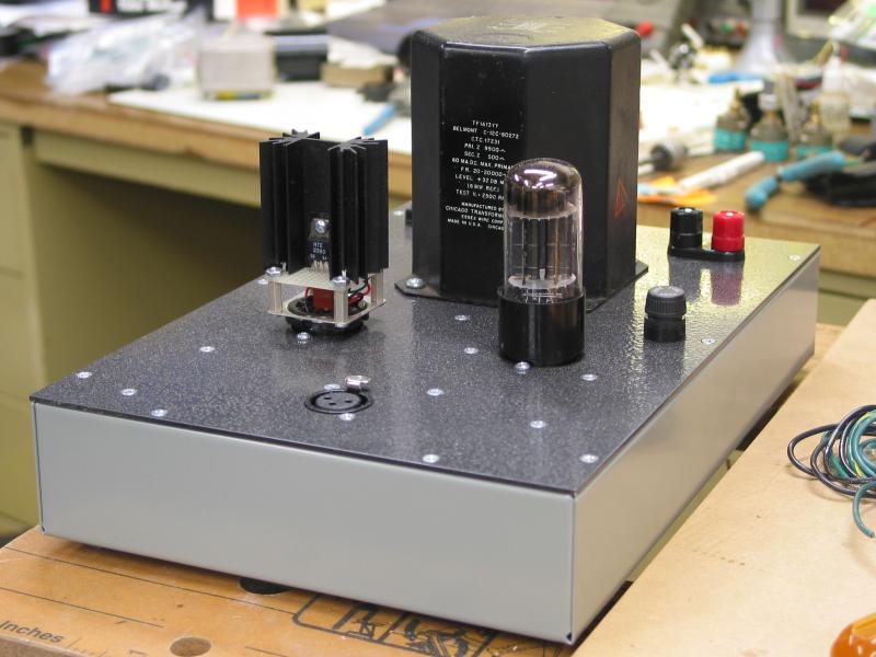

I built an amplifier about 2 years ago using a 45 tube with one Fairchild FQP1N50 (G connected to D) in the cathode and 2 more as the other side of the current mirror. They were wired up like a typical mosfet current mirror (I work with a bunch of CMOS IC designers). The amplifier worked great until you pushed it into clipping, at which point one or both of the mirror fets shorted. After zapping a few mosfets I put the whole idea on hold.
I considered using the 10M45's as a current mirror but thought they would blow up because of the 450 volt rating. IXYS has shown the 10M90 on their web page for years, but no one had any in stock until recently. Mouser now stocks them and I already have 50 of them for some science experiments.
When I published the PowerDrive concept on my web page a few years ago, I got tons of very negative email condemning me for corrupting vacuum tube designs with "sand". One even suggested that I change my name to Transistorlab! After people actually tried using a mosfet follower to drive the grid of an output tube (very nice for A2 operation) they liked it and the idea is far more accepted than it used to be. Maybe it is time to sprinkle a bit more "sand" into the mix. Is it time for the "boosted triode SE"?
I put a hybrid amp schematic on my web site several years ago. It is sort of a darlington configuration with a 45 tube and a BJT. The few emails that I got were negative and the page received very few hits.
http://www.tubelab.com/SuperTubeSE.htm

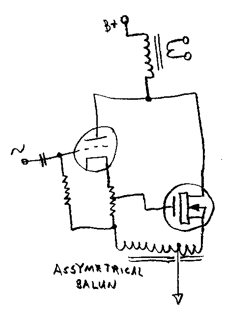

The Un-transformer
The cathode resistor tap gets sized so as to provide approx. the correct drive signal to the Mosfet gate to support the same current ratio between tube and Mosfet as the N:1 turns ratio of the assymetrical balun requires for neutral flux.
Hence the name Un-transformer, since there is zero flux in the balun, while still transforming impedance 1/(N+1) by means of the ratio'd currents. (No voltage transformation though, so only N+1:1)
Can use two of them to do P-P of course. And can use two Un-xfmrs (with tubes and Mosfets) in totem pole configuration to get rid of the output xfmr altogether.
Don ;)
I should have explained that the assymetrical balun enforces the N:1 current ratio between Mosfet and tube by means of feedback to the Mosfet gate across the balun.
Picture the assymetrical balun as a teeter-tooter or lever like device. If the Mosfet pulls too hard, it tips voltage wise so as to turn the Mosfet off some. If the Mosfet doesn't pull hard enough, it tips so as to turn the Mosfet on more. The balun thus only has to handle the error voltages in the feedback loop. This means the balun can operate with far lower turns (or voltage rating) than the usual output transformer would have to.
Since the Mosfet maintains its output at N times the tube current, it effectively increases the tube Gm to (N+1)Gm. The output impedance of the composite assembly is also Rp/(N+1) since any changes in plate voltage on the triode have N+1 times as much effect on current flow (indirectly controlling the Mosfet too).
Don
A 6.3VAC or 12.6VAC filament transformer wired up in auto-transformer fashion should work for the assymetrical balun. Some frequency compensation (rolloff) on the Mosfet gate will likely be necessary to prevent oscillation. Can also use a ferrite balun xfmr, (or both types of xfmrs. in series on tube and Mosfet windings) to improve frequency response.
Oh, for DC stability/thermal stability, the Mosfet will need some small resistance in series with its source terminal. Maybe 1 Ohm (around 1/Gm of Mosfet) unless using a Lateral Mosfet where it is unnecessary.
This resistance will help match the Mosfet Gm versus the tube Gm tracking too. The tube cathode resistor then needs to provide for gate drive for the Mosfet and for the voltage drop across the source resistor at the N:1 ratio of currents.
Don

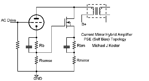

Here's my idea on a depletion mode SE booster. The Iq on the MOSFET only needs to be enough to keep it in class A.
Michael
You will want Rsense big enough in value to provide the approx. linear drive signal for the Mosfet in addition to the current feedback sensing to match the Mosfet current sensing Rmirror voltage. (since there is no Op Amp here)
This may push the gate voltage positive enough at tube idle current to allow an enhancement Mosfet (and so can delete Rbm and its cap. too)
[also, putting an assymetric balun in like I mentioned above will increase loop gain substantially too for closer current mirroring.]
Don

If you want to see the hybrid concept taken to the extreme, look at my entry into this Microchip / Circuit Cellar design contest. They asked for designs using the new dsPIC chips from Microchip, so I entered a vacuum tube amplifier. It actually won one of the prizes. That design approached the concept of getting more power out of a vacuum tube amplifier from a different angle. I used a SMPS controlled by the dsPIC to adjust the voltage across the vacuum tube circuit in real time. The tube operates with a constant plate to cathode voltage that is very low (50 to 75 volts). This allows reduced dissipation in the tube, so the power output can be increased. Plate efficiencies of 70% and higher have been observed in SE amplifiers. 30 watts out of a single tube in SE mode is easy. You can download the entire project entry here:
http://www.circuitcellar.com/microchip2007/winners/MT2209.html
I now have amplifiers operating with the DSP based power supply replaced by a mosfet. The efficiency enhancement afforded by the SMPS is gone, since the mosfet is a lossy element, but the power output and distortion improvements are still present.
