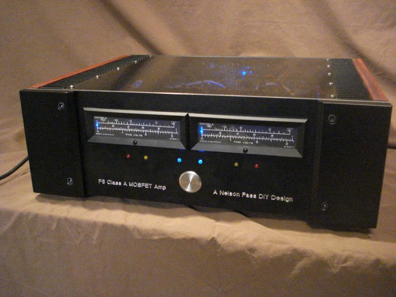

For those who have been following my F5 build thread, I'm declaring a successful completion as of this weekend.
I did go with powder coating on my front panel end plates, as shown.
I also (finally) calibrated the VU meter ballistics and sensitivity, as well as the settings for the clipping monitors and heatsink temp monitors. Had concerns about "releasing smoke" when I connected the VU and clipping drivers to the amp outputs, but it was all uneventful.
I've posted my final build pics under the "Pictures of your Pass DIY Amp" sticky thread. One last pic is posted here, FYI.
My thanks to all those who posted comments, thoughts, and opinions on this thread. I've appreciated the exchanges. Special thanks to Papa Pass for his exceptional (and simplistic) design, and to ZM for his official "fugly" rating of my amp....!

That's absolutely bloody fabulous! Looks gorgeous. I'd be interested to know if you ever clip it, or what the typical output power is in real use - so few of us ever really measure it.
Thanks for the great build-bk
Thanks, back at ya.....!
As for the clipping level, right now I have them set (left and right channels, independently) at 19.4 volts peak. That's against 21.4 vdc + and - PSU rails. Admittedly, that's probably a little arbitrary for now, but when I lug the amp back downstairs into my testbench, I'm do more formal clipping tests (audio signal generator, THD analyzer, and 'scope) to tune the clipping monitors.
For now, if I run my pre-amp fairly high, I can get both clipping lights to flicker--but only at an "almost unconfortable listening level" from my old Sansui speakers. (Yup---building new speakers is on a future "to do" list....)
