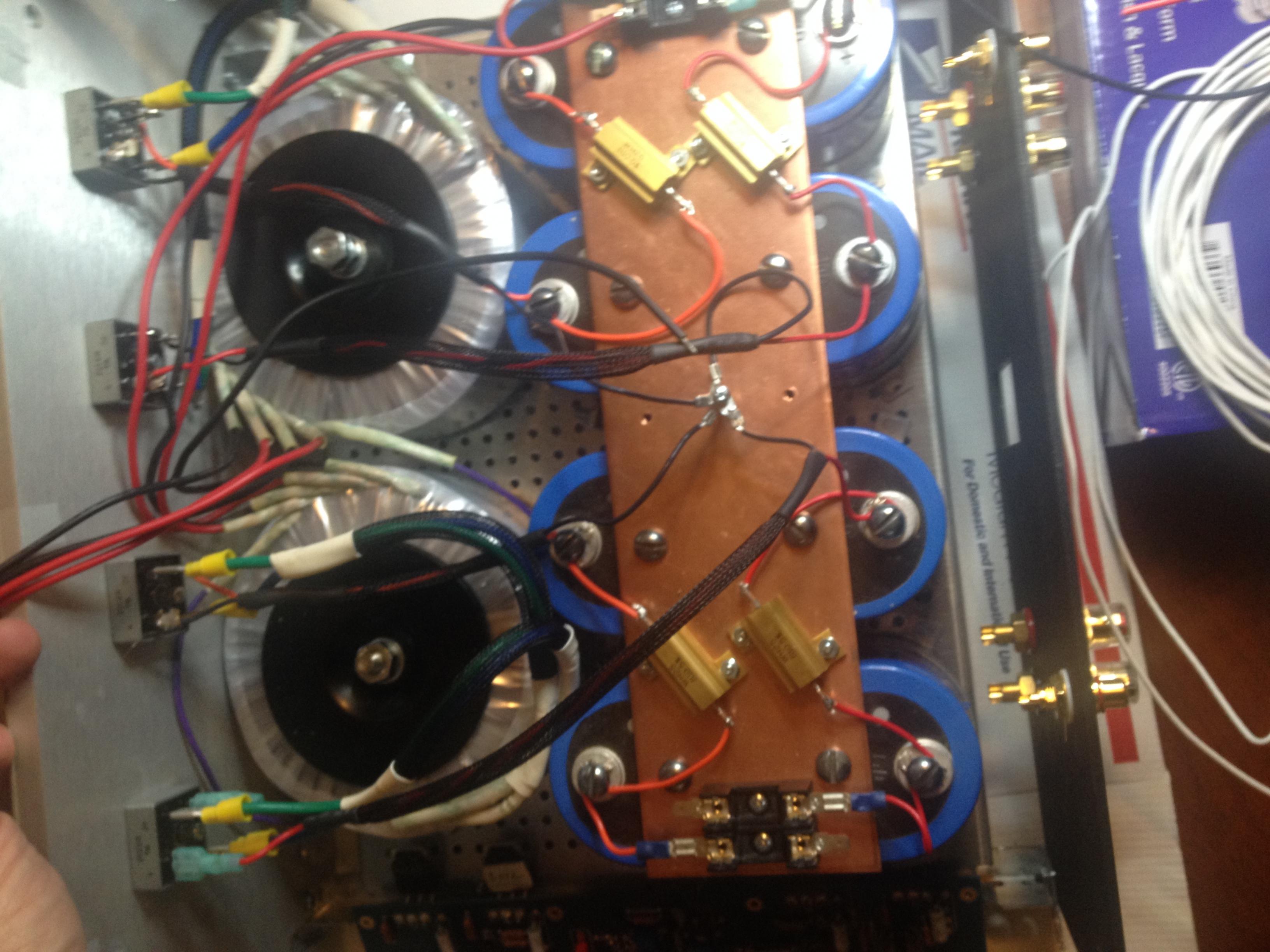

Finally a little progress thanks to nothing interesting on television.
Keeping with the old school theme, the resistors in CRC are 25W chassis mount, 0R1. The most time consuming part was tapping the star ground holes. I have spare points just if needed.
The tapping time convinced me to just drill clearance holes to mount the resistors and fuse holders and use nuts and bolts. Another interesting aspect of drilling copper was that even with sharp drill bits there were significant burrs on both sides of the hole. Bad enough that I used a large handheld drill bit to deburr before drilling the next hole or the piece would not lay flat on the drill press table.
Hopefully tonight I will get some wiring completed. That or do the cap screw mod to the heat sinks so I can actually adjust the amp. The pots are inaccessible with the big cans so close to the board.
I'm thinking of mounting the mains connection, individual transformer fuses and CL-60 on a piece of no copper perf-board mounted to the transformer mounting bolts. The bridges will mount on the front panel. Still in the air whether single or dual. Anyone see any issues with this?
Claudio, I will make separate grounds for each channel if I have hum or noise problems. The bus bar is 0.125" thick, I suspect that most of the charging pulse current will be confined to a small area between the caps. I've had success with a similar arrangement on boards with a mere 2 oz copper thickness.

Nice Bob!! Nice.....I'm still waiting for some more components for my Aleph J...to increase power...cascode the outputs with the proper rails and current? Oh, btw...I'm in upstate NY..we call Rochester upstate...I hope you're feeling better...keep the pictures coming...
Ron
Ron
That settles it, ZM. Dual bridges it is.
Thanks, Ron. Yeah, a lot of people consider anything north of White Plains "upstate". I'm 45 miles north of Albany. Snow yesterday, more snow forecast for tomorrow. What happened to Spring?
If you are looking for more power, I'd cascode the input jfets and add more output devices. Based on NP's comments in the F5T article, you should be safe with genuine 2SJ74s up to 30V. Higher than that you'll want to cascode. You may also want to double up the input devices to drive more outputs. See the Aleph2J threads.

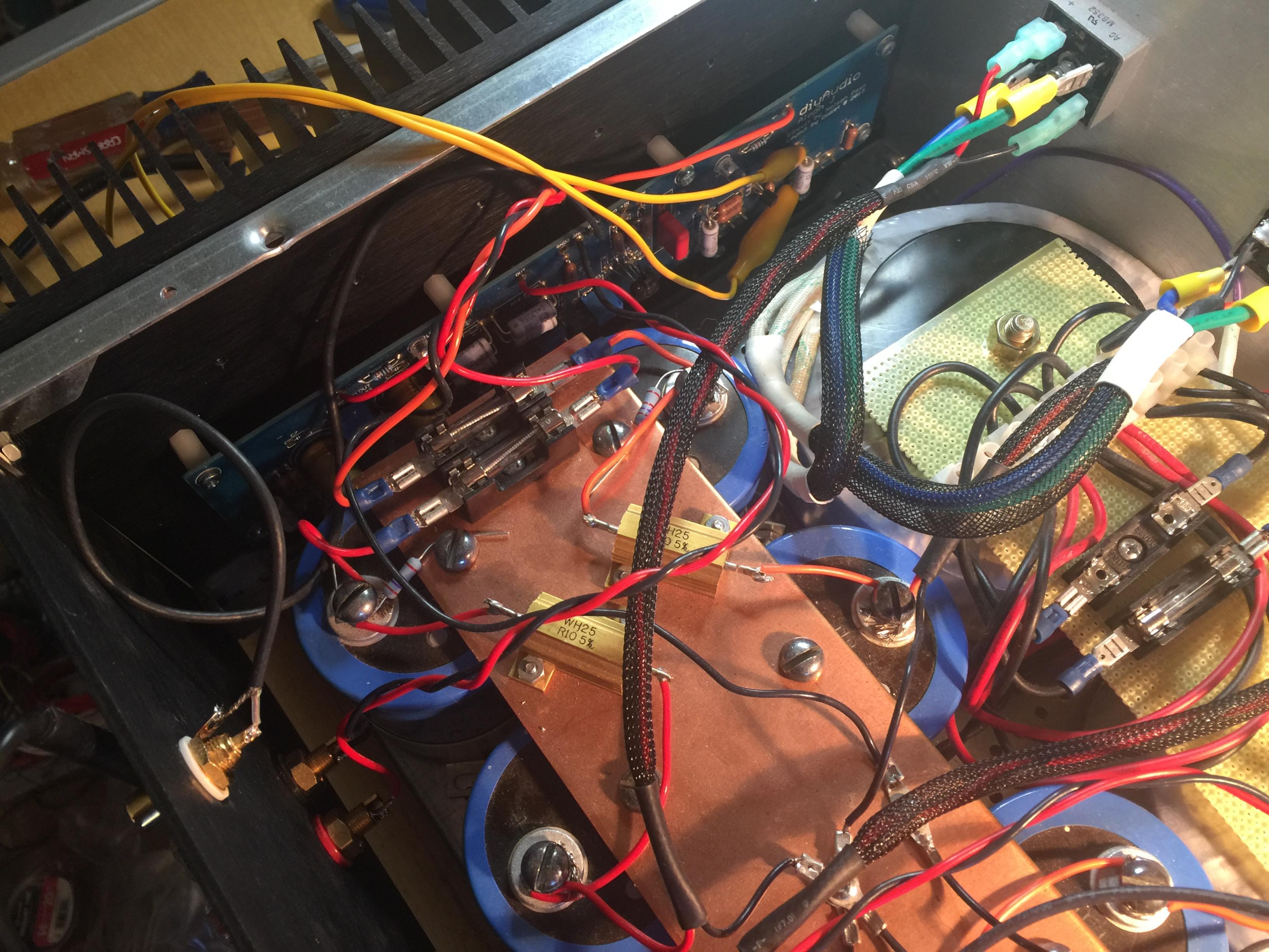

Cold weather and I don't get along well, so I spent some time on this today. I got the PSU wired up on the secondary side. It took a lot longer than I thought it would, but I'm just getting back to this. A couple bad crimps, and I need to buy some more quick release connectors, but otherwise, I am ready to set up the mains side wiring next session. Given the pace this afternoon, I guess another couple of sessions before I am ready to start testing and dialing it in.
16 gauge teflon wire looks a lot smaller than expected.

Back from the dead. After nearly two years of gathering dust I finally returned to my Aleph J.
I modified the heat sinks to allow for removal from the outside since there's no way to reach the pots with the sinks mounted. I was surprised how sensitive the offset adjustment is even with a 25 turn pot. Two iterations and the first channel is stable at 3.5 mV offset and .415V across Source resistors. That gives a 31° C rise. I suppose I could go a bit higher, but why push in a relatively small case? I set R27 at 68K but got .56V on the Source resistors, that's 1.2A/
I'll clean up the wiring a bit after I finish adjusting, then burn in several hours before listening.
Second channel set up, amp burning in. Looks like I got the bias set at maximum for these heat sinks. When I took the Variac out of the circuit the rails jumped from 22V to 25V. (I have a voltmeter that I've been meaning to add to the Variac, but didn't measure)
That calculates to 86W per channel. Overall average heat sink temperature is 55° C, with 60° C at the devices and bench temperature of 25° C.
Looks like I will be current limited to about 45W with my speakers' impedance dip to 6 ohms. Probably plenty for most listening.
