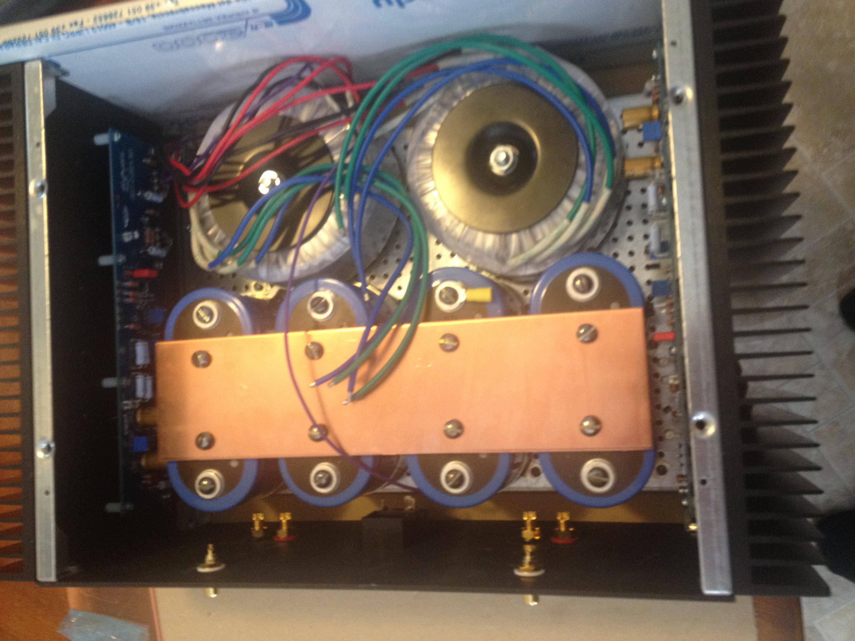

Feeling proud of myself for actually making progress. I got my ground bus bar (3" x 12" x 0.125") drilled out for the main cap connections and mounted the power transformers. I bought brackets to mount them vertically but since they fit (barely) laying flat that's the way to go.
I'd hoped to finish this amp today, but life has interfered, and I am waiting on a few parts. Resistors for the CRC, fuse holders for each transformer, and some hardware scheduled for delivery next Wednesday.
I can see that I am going to have to do the cap screw heat sink mounting mod - Otherwise I'll never get the front panel attached or be able to adjust the amps.
Nothing particularly special about the board setup, I used the store BOM other than using Fairchild IRFP240s and BC546C I had on hand. I bought the jfets a long time ago from ampslab and was pleasantly surprised to find at least 4 pairs with idss around 10 mA matched within .03 mA out of 20 pieces. I was also able to make 4 perfectly matched sets for my F5T. :)
There's not a lot of room to spare. Transformers are Antek 4220s. Smoothing caps are 68,000 µF/50V. Chassis mount 25W 0R1 resistors will mount on the ground bus. I realize that's an "old school" power supply. Rectifiers and AC connections will be on the front panel.
Progress will be even slower for a month or two, as the surgeon says I can't lift more than 10 pounds after much needed back surgery. I may have to turn my daughter into my amp mechanic so I can listen to it during my recovery.
