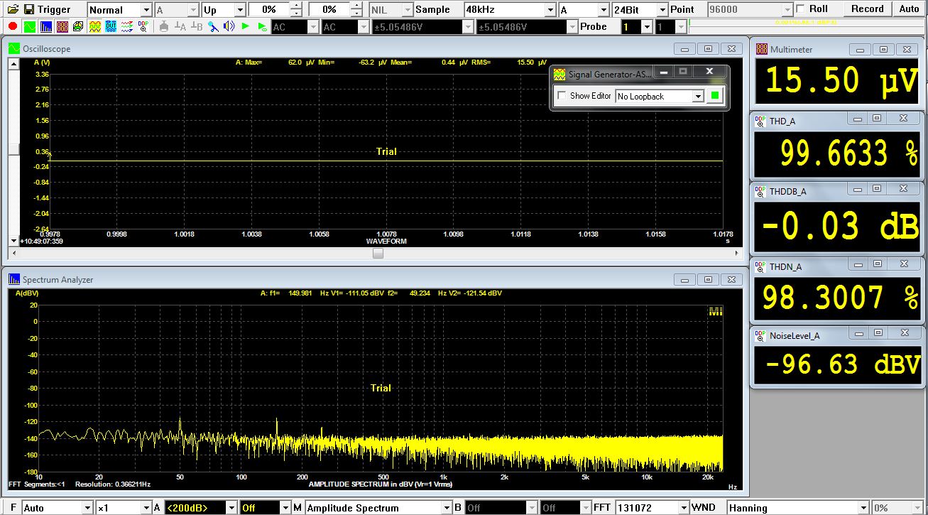

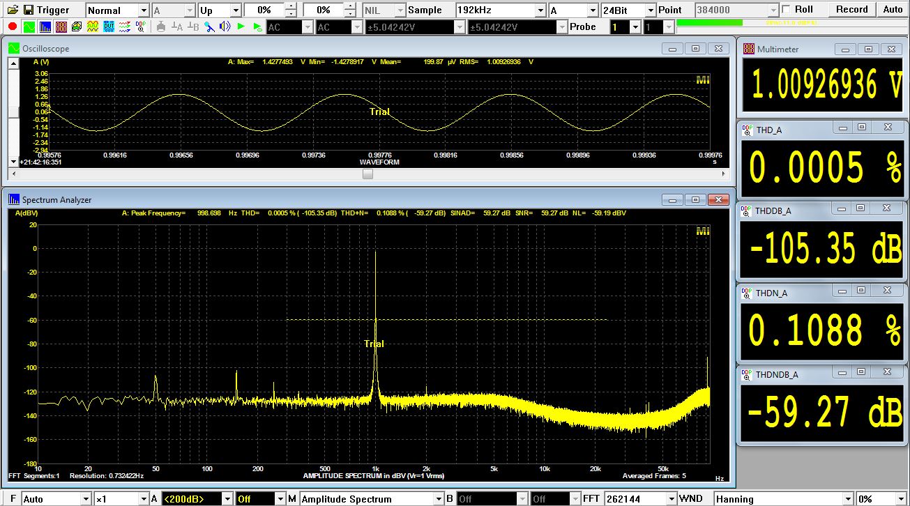

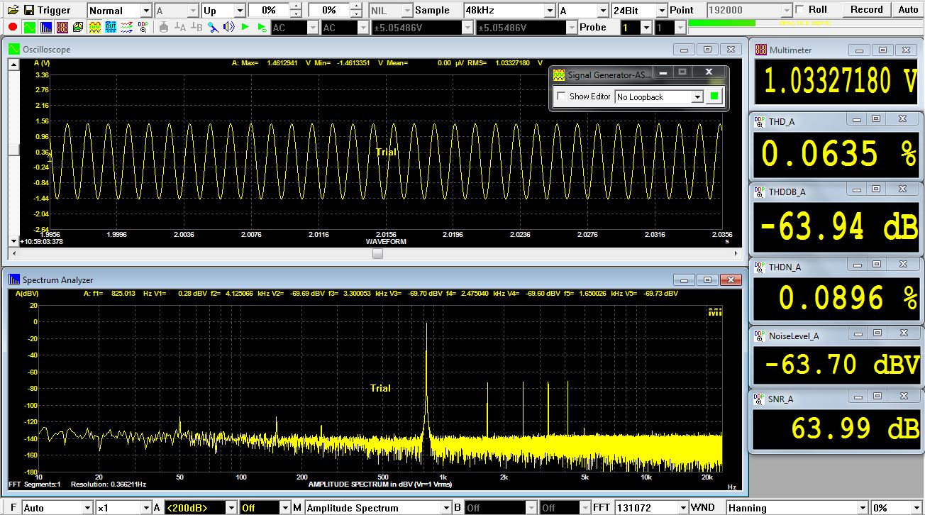

alright, the measurents posted before:
http://www.diyaudio.com/forums/atta...in5-aout1-loopback-0v_virtins_hann_48k_01.jpg
and
http://www.diyaudio.com/forums/atta...25hztestsignalat1vrms_virtins_hann_48k_01.jpg
were 131072 long FFTs. What went worng? I'd expect the THD+N to be very similar to the THD.
Where can I have a look at the RBW-spreadsheet you mention?
What is the/a LDO? (I dont think its describing a linear low drop out voltgae regulator in this context :))

We need clarity from HP here but a few possible concepts-
1) LDO low distortion oscillator
2) high sample size will improve the possibility that the harmonics will land in a bin
One presumption is that the peak of the highest bin is the amplitude of the signal. If the bin match is off enough the level will be off. The ideal would be to sum the levels in several bins around the harmonic.

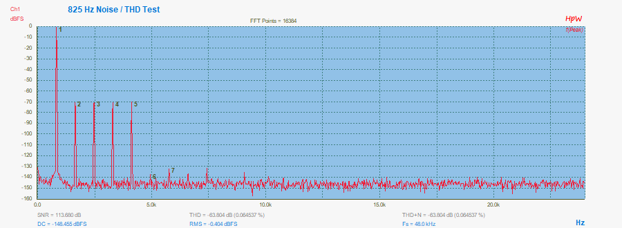

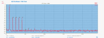

Did a 825hz/48kHz & 16k FFT simulation test using the RME ADI-2 Pro in loop-back connection.
Just a small hint to your issue: May use a better FFT Window than Hanning (2-Term) while I used a 7-Term Blackman only...

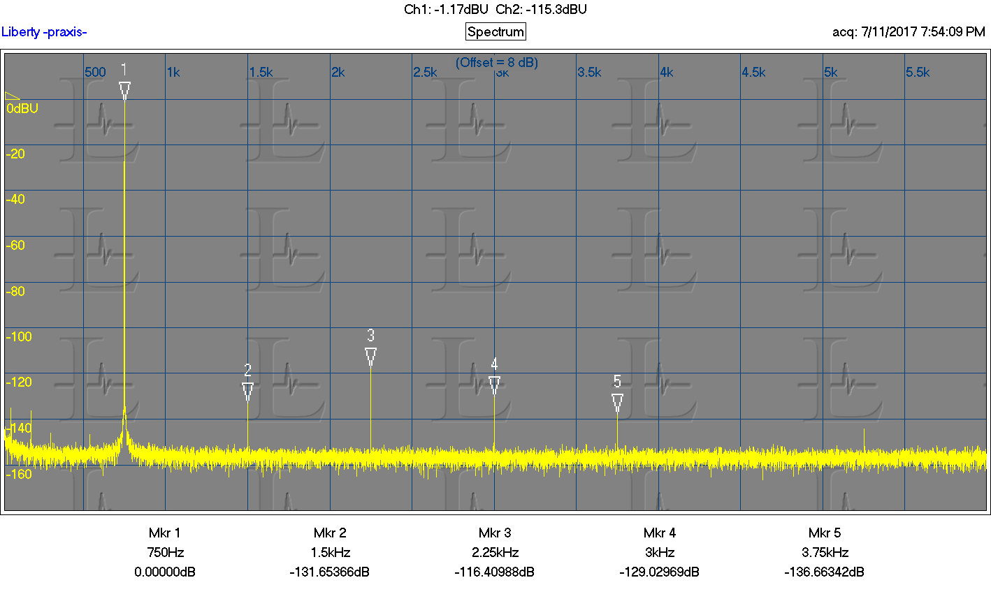

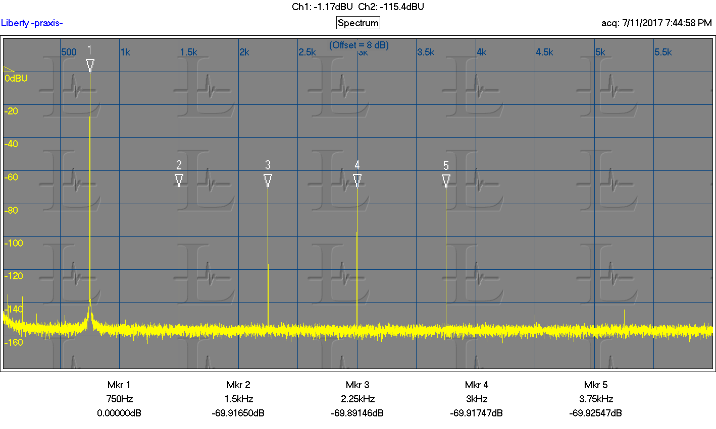

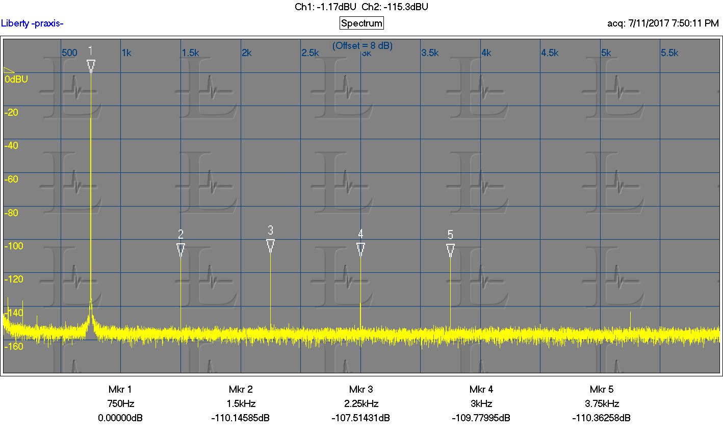

Here is a first pass on some measurements with the RTX. I used 750 Hz as the fundamental (even division of 48 KHz) and multiples which should all land in bins. Down side is that it won't exercise all the bits the same as a non integral division of the sample rate. I used Praxis for this since I know it well and the signal generation tools are pretty capable.
I checked the results with the Shibasoku 725d which can measure the individual harmonics and the numbers matched pretty precisely. As you can see at -130dB the internal distortion of the DAC (AK4490) starts to be significant and alters the levels. The altered levels in the plot are the same as measured by the 725d so the limitations of the ADC are not showing. Also this is at -1 dBFS, where the performance is not the best for the DAC. I'll do more measurements at -10 and -15 dB to see the effect of less fundamental along with other tests tomorrow.

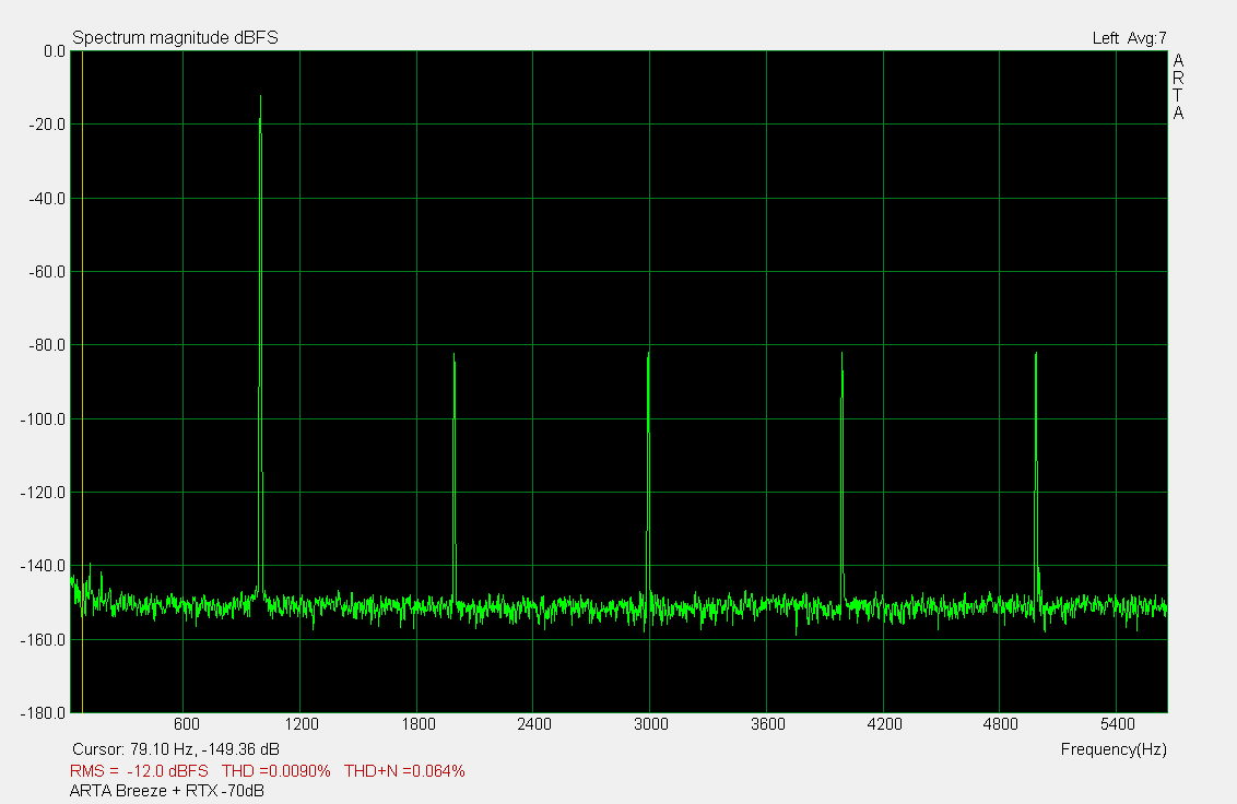

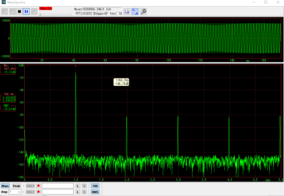

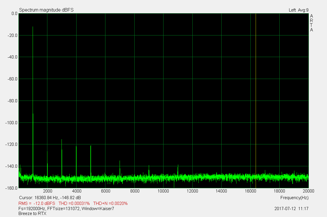

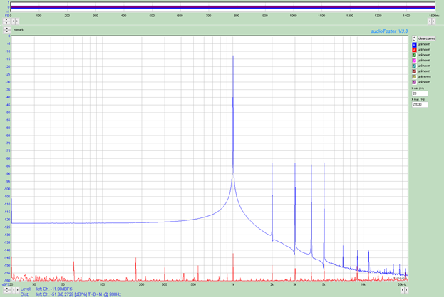

Some more plots. The source is a file at approx 997 Hz with 4 harmonics all at -70 dB. I verified the harmonic levels with the Shibasoku 725D.
These are 4 different software packages measuring from the Breeze DAC (AK4490, same as RTX) to the RTX6001. Basically they all show the same results. Each package has pro's and cons in user interface and setup. Arta is limited in its resolution. I had some challenges getting Audiotester set to useful settings (more UI stuff) and saving the plot is not obvious on most of these.
I need some help with audiotester settings. As shown there is a windowing/sample catching issue somewhere.
Wavespectra was pretty easy to use but I could not find the averaging setting if there is one.
ARTA is limited to 131K FFT. I used 1M FFT's where available.
Praxis has a THD calculator option but I never use it for what I'm doing.
I'll post some resilts of -110 dB harmonics and -130dB harmonics.

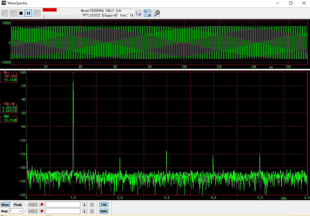

Here are a few more measurements- These are with the Breeze to RTX6001 at -110 dB Arta and Wavespectra. No Audiotester until I know how to get the correct settings.

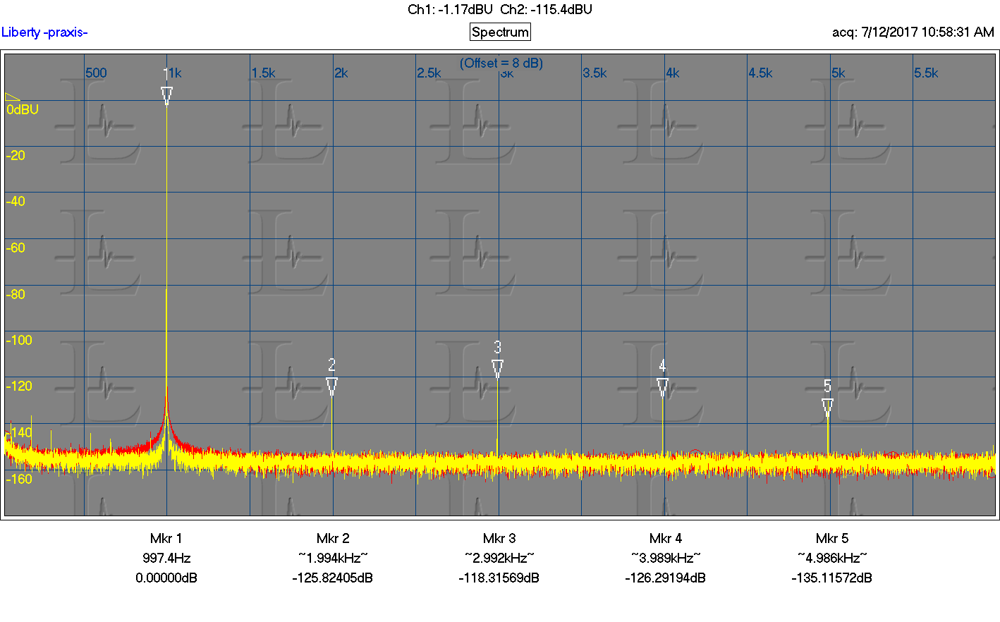

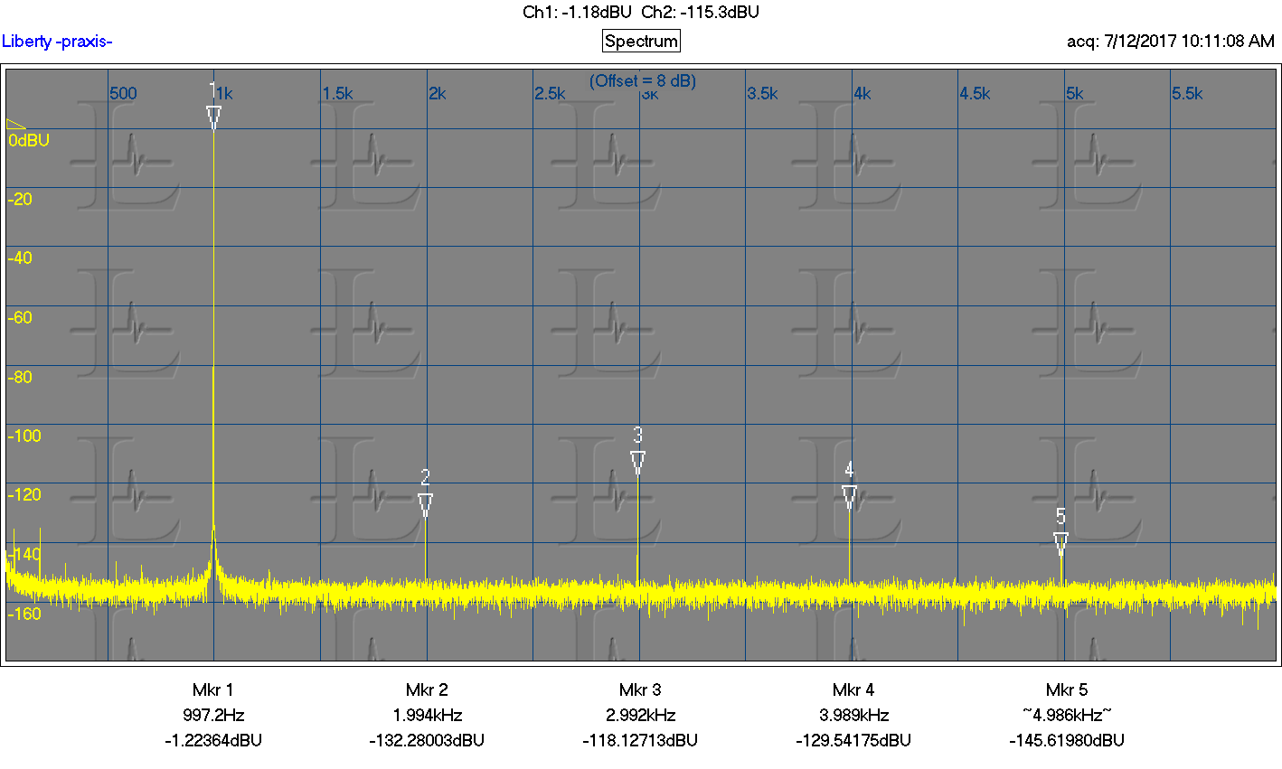

This is harmonics at -130 dB with the phase shifted by 90 degrees between so see if there is a phase addition/subtraction going on. It seems there is judging by the change in levels.

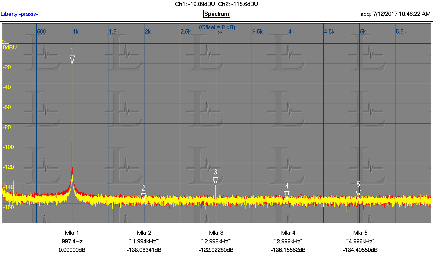

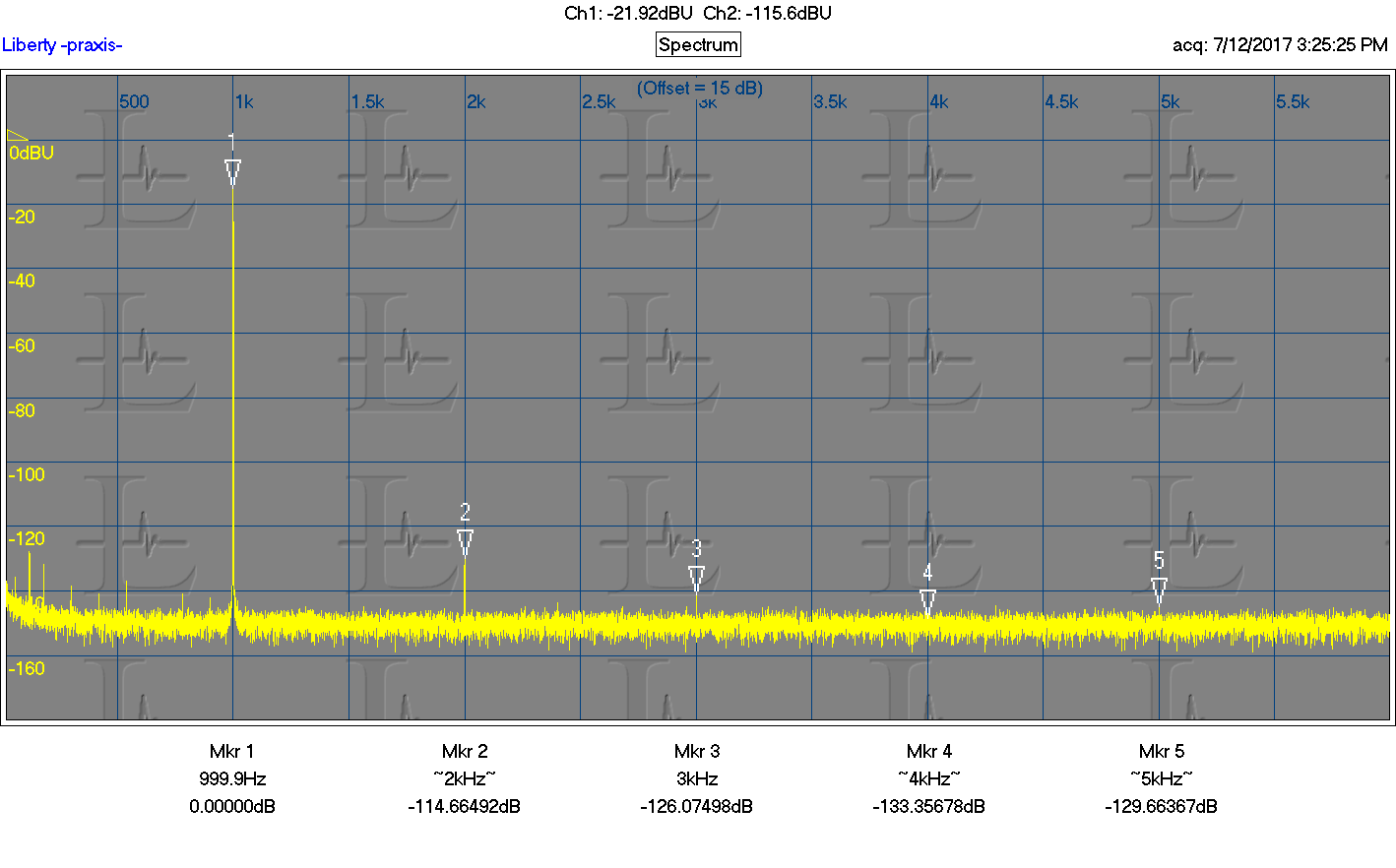

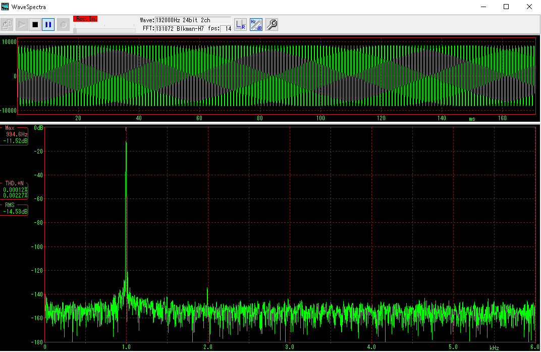

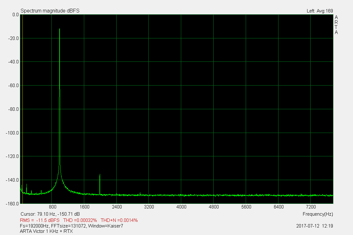

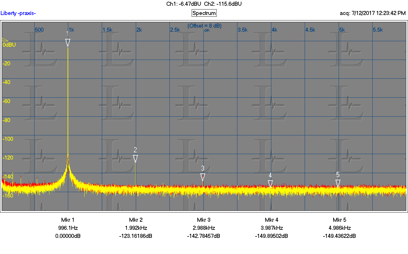

This is the RTX loopback, RTX + Breeze Dac or the Victor Oscillator. No harmonics added on any. The loopback gets better performance but some may have to do with balanced drive in the loopback vs. single ended connection to diff in on the RTX. The last two are Wavespectra and ARTA.
There does seem to be some inconsistencies in how they all calculate the noise in THD+N.
The Breeze is playing a file hosted on a remote server via a small Linux player. its running on a 15V supply. While not as good as the RTX not bad for $80 + an LME49720.
I created the files initially using Praxis which can make a 10 second file. I used Audacity to extend the files. Later I moved on to using either Praxis or the Altor digital generator into an RME 9632 digital in and recording using the built in RME recording system. The level on that is a precise -15 dBFS at 1 KHz (24/192). I have found that getting accurate levels on digital files generation is a bit of a PITA. There is a bit of sloppiness on that with some apps. The Altor is the easiest and most predictable.
