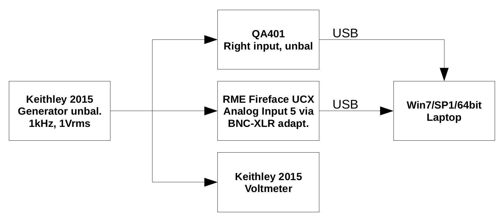

Analyzer Software Comparison -> divergent results???
Hello!
While the RTX is beeing assembled in denmark I spent sevral days setting up a new laptop (for audio analysis only). Today evening I tested several software packages in parallel in order to compare the results with the QA401 analyzer. Please have a look at the test setup and result summary (.pdf) attached.
The target of this test was to estimate the accuracy of the software and hardware used. Interestingly the results deviate quite a bit. This surprises me, since I gave my best to achieve comparable settings. Especially for the soundcard based measurements, which share the same hardware.
I am quite disappointed, that the results are THAT unreliable. This is not a THD-measurement, that is THD-guessing. I even doubt, that the QA401 figures are accurate.
Next step would be to record a 1second .wav-File and hack some code, that does the FFT analysis. This way I could learn more about the FFT-details and pitfalls.

I have seen similar issues comparing different software and devices. There are a few bigger issues like rejecting the skirts of the fundamental. This may be an issue in the QA401. Others have to do with the RMS sums of the noise and the rms sums of the harmonics. Then the bandwidth of the measurements.
I'm thinking a specific test signal with known harmonic levels that are high enough to not have interactions with the internal harmonics of the DAC or ADC would be the next step.
A validation routine would like like this:
1) calibrate sensitivity with a known 1KHz signal
2) measure noise floor in a known band with
a) ADC input shorted
b) DAC connected to ADC and DAC at digital zero
3) loopback with test signal with 5 harmonics all at -70 dB
4) Test with ultra low distortion external oscillator
This should create a baseline and show where the systems will disagree on signals.

First point is the fit of the harmonics to the FFT bins. That can mess things up especially with different windows. there are other issues like frequency stability etc. that will have an impact. If the harmonics in the signal and the harmonics in the system are close in amplitude they can modulate each other with phase relationships. Usually at -100 dB or less. That's why I suggested -60/-70 db. When I get home I'll try the same tests and also put an analog analyzer in the middle to check the ADC harmonic output.
Joined 2017
about error of THD
The programmer of Wave spectra writes comment (unfortunately for many written in Japanese) about tolerance of THD and THD+N because he received many E-mail claiming the result was incorrect.There are probably 3 major reasons.
1. bin of FFT.
When you use 1kHz with 48ksample and FFTsize of 4096, you can't use exact 1kHz because of limitation of bin. 1kHz in FFT means (48000/4096)*85=996.09375Hz.FFT unavoidably treats this as 1kHz. This difference becomes error.
Wave Gen, which is also programed by the same person of Wave Spectra, has special function to avoid this error. Right click on the frequency button can change the frequency into exact multiple of bin. You can decrease the tolerance of THD, using exact multiple of bin.
2. windowing
The skirt of fundamental frequency depends on windowing a lot.This is also the reason of tolerance, especially THD+N.He says THD is usually less than real value, THD+N is more than real.I roughly estimated THD and THD+N from your attached file. THD is about 0.03%,THD+N is 0.033%.The measurement of WaveSpectra is 0.02414% and 0.05278% from your ZIP. He says
Flat Top is the best for decreasing this error.If you use the frequency of multiple of bin, you can use rectangular window(this means no windowing).
Rectangular has neither windowing related error nor bin related.
3. FFT size
The larger FFT size, the less error.Large size FFT can reduce the effect of 1. and 2. But it sometimes results in error when frequency is not multiple of bin.
These are major reasons of error.I think software has limitation. Plug & Play is convenient but sometimes inaccurate. When I want to get accurate data, I usually use RX4 (iZotope) to measure THD+N. I need to remove unwanted spectrum manually. When I want rough measurement, I use software.

Noise level close to -140 dB!? Really?
I know lol - and I doubt it....
Even Focusrite quote -106dB (A Weighted) for the line input on the Scarlett 2i2.
I've often wondered how the software determines it's ~-140dB
The software magically reduces the noise floor by 30 dB or so? I'd say this is cheating.
Is it some kind of "aritifact" related to long test signals so that noise is getting averaged out? This would probably mean that the frequency bins are larger than the frequency resolution corresponding to the length of the test signal. But I have no idea how these software packages work, and how they were configured.
