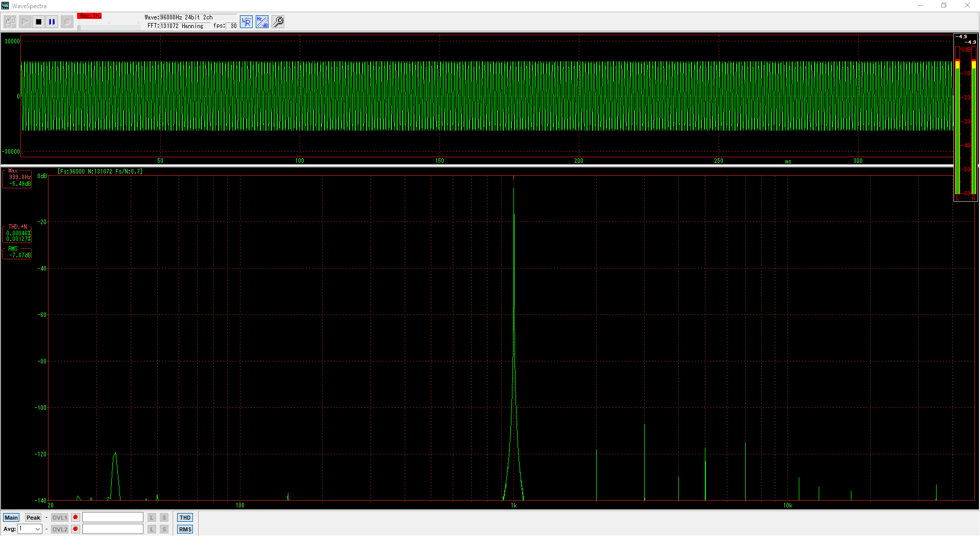

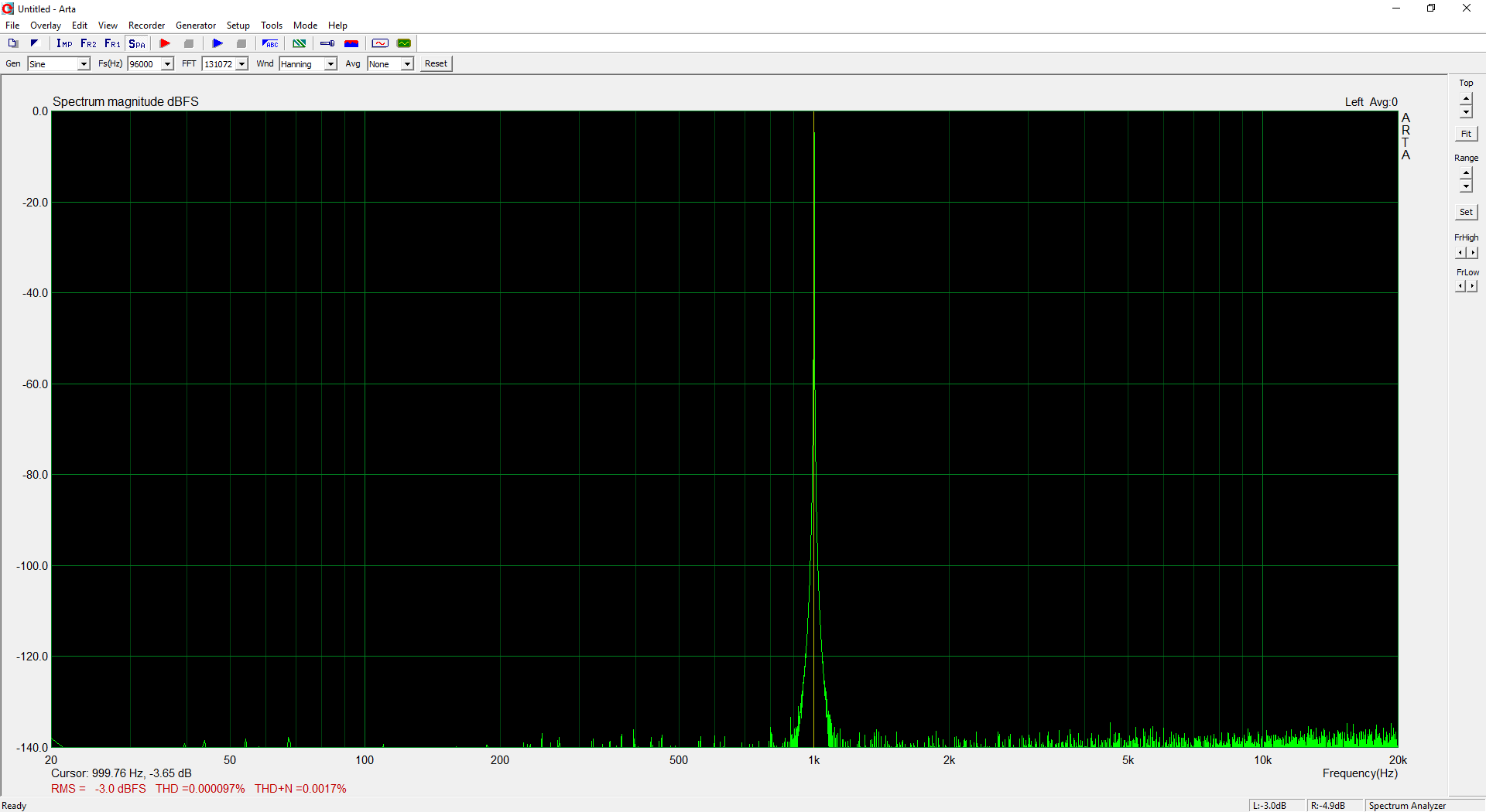

Hello,
I don't know if I choosen appropriate thread but I need sanity check from someone more experienced with measurment software. Is it possible to achieve such good results with relativly cheap soundcard? I'm using Creative X-Fi Titanium HD which is based at PCM1794 DAC chip and PCM4220 ADC. No modificatins were made to hardware apart from replacing NJM2114 with LME49720. Test signal in both cases is 1kHz -3dBFS. 24 bit 96kHz, using ASIO to bypass windows mixer. 13k FFT with Hanning window. Line out to line in with RCA cable.
In my opinion results looks too good to be true. Some results found in internet to compare:
RMAA
RMAA and Audio Precision (opens PDF)
I will probably retake my measurments later with stock NJM2114 opamps. Maybe thats LME49720 bring so much improvement?

I don't know if I choosen appropriate thread but I need sanity check from someone more experienced with measurment software. Is it possible to achieve such good results with relativly cheap soundcard? Maybe thats LME49720 bring so much improvement?
Those are very good results. Better than I got from the demo board. I don't have one of those cards so I can't duplicate the results directly. if you get the same harmonics with several software packages and at several sample rates they may be real. Usually the lowest distortion is at about -15 dBFS. I'm not sure what level you are operating at.
