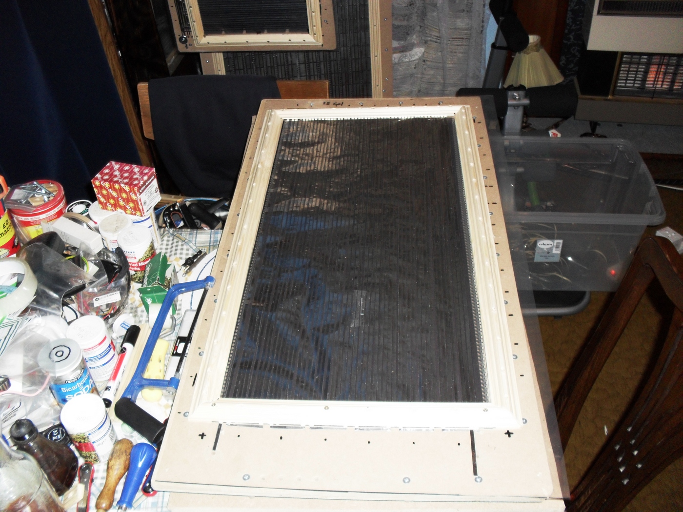

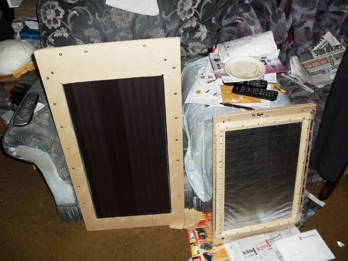

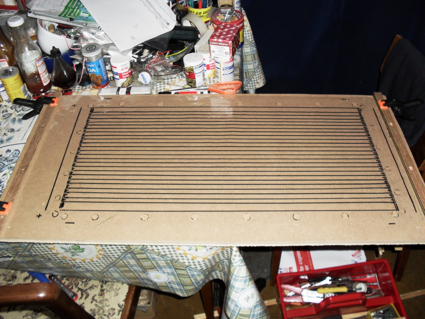

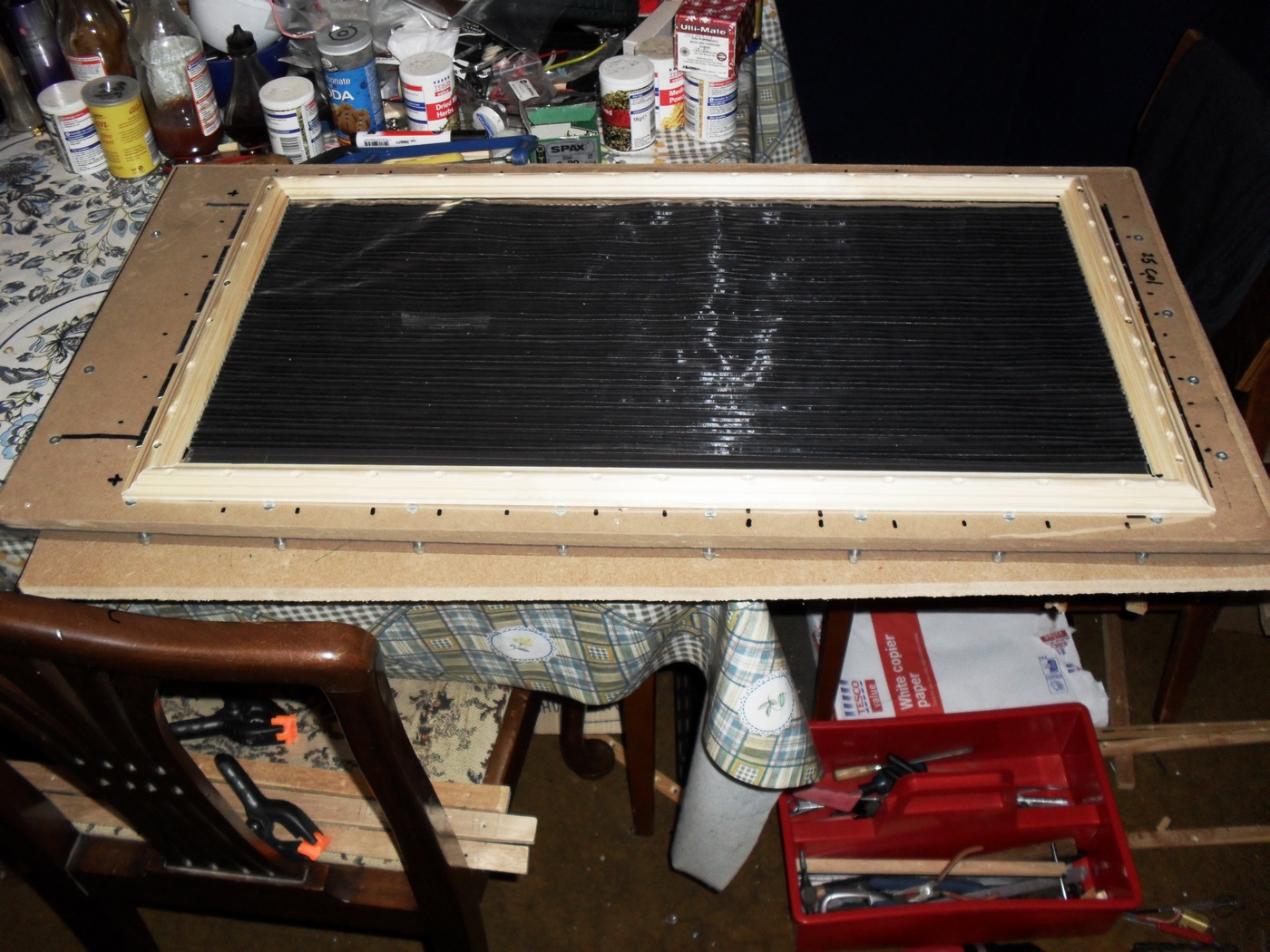

seems ages ago since i started this thread but it has taken a long time to source a suitable rubber for the suspension,finding some of the correct durometer and flexibility and well as consistancy proved to be quite a challenge. have decided to ditch the factory frame work which was mdf in favour of aluminium which makes it much easier now to remove or adjust the diaphram as well damping the panel better due to the extra weight, downside was having to drill and tap a large number holes but i think its a much better solution.
Have nearly finished rebuilding a previous design using very weak plastic magnets. The original design was way too insensitive. Using the epsilon layout will hopefully improve it significantly. Showing the plastic on the left 3' x 1.45' and the 60 x 40 cm on the right. Picture frame ready to be fixed and diaphragm tightened Should be finished tomorrow. I did break the aluminium foil halfway thro', but carried on with a repair, hope it's O.K.
