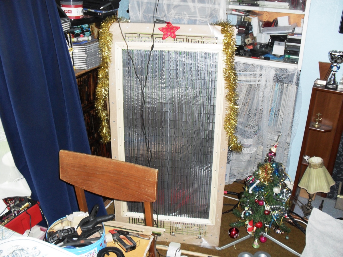

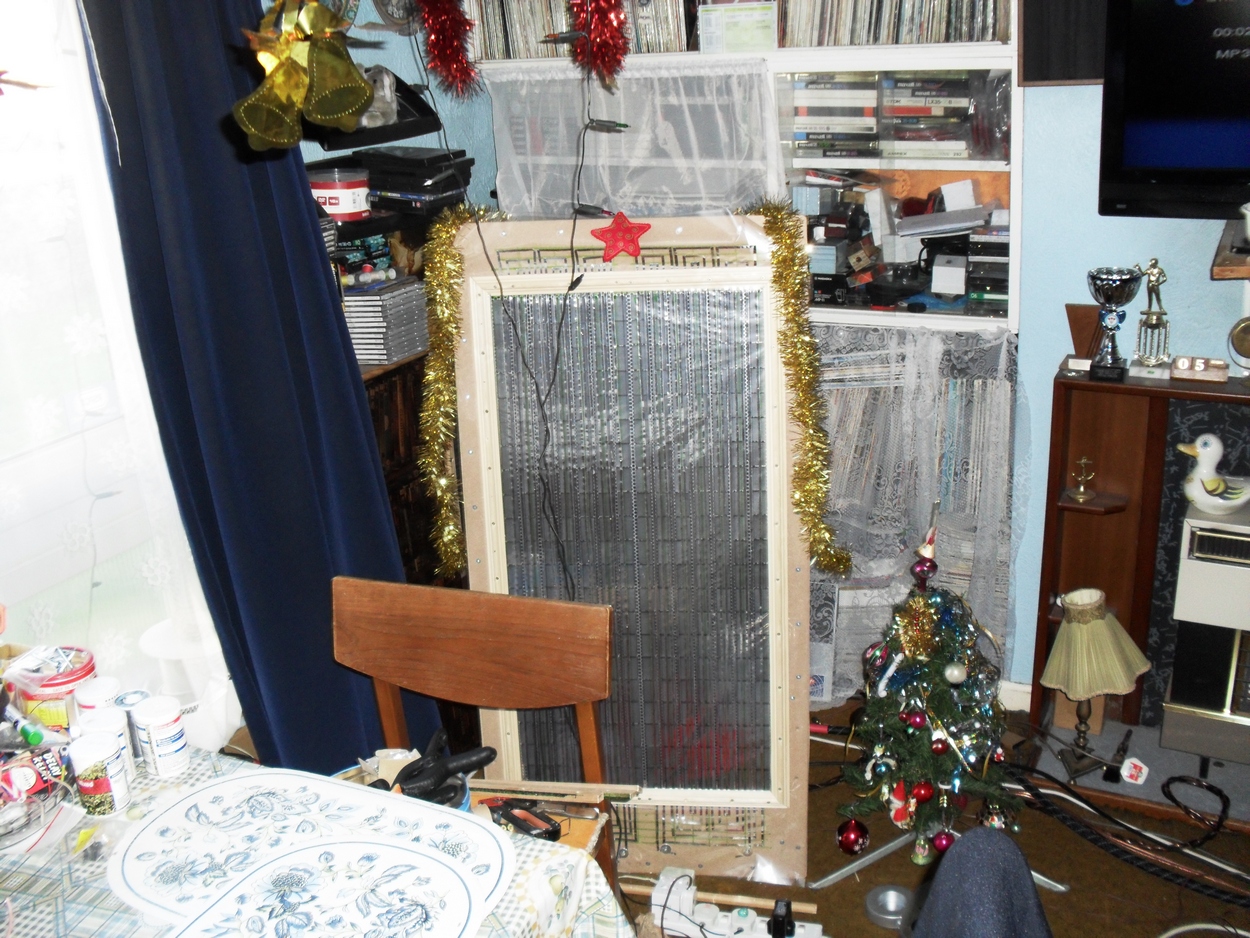

The big 4' x 2' sound very nice very revealing, can't wait to build the other one to make a pair.I need to get some more MDF before continuing. So I have decided to build the smaller 60 x 40 cm pair as I already have the MDF and perforated sheet. This will make it possible to hear a pair which will sound better than the one. They are a lot lighter and only use 125 50 x 19 x 10 mm ferrites in each speaker. I can't wait to hear them with the 4 epsilon type membrane. The planars don't need much power and the bass is very good and very tight not boomy at all, compared to the ESL 57, or the ESL 83. which I have as well. A big disappointment to me. I have easily driven my 4' x 2' ferrite ones with valve amps.Even the 60 x 40 mm sized using neos was even easier to drive with valve amps. Yes and no buzzing.
quadruple epsilon clone

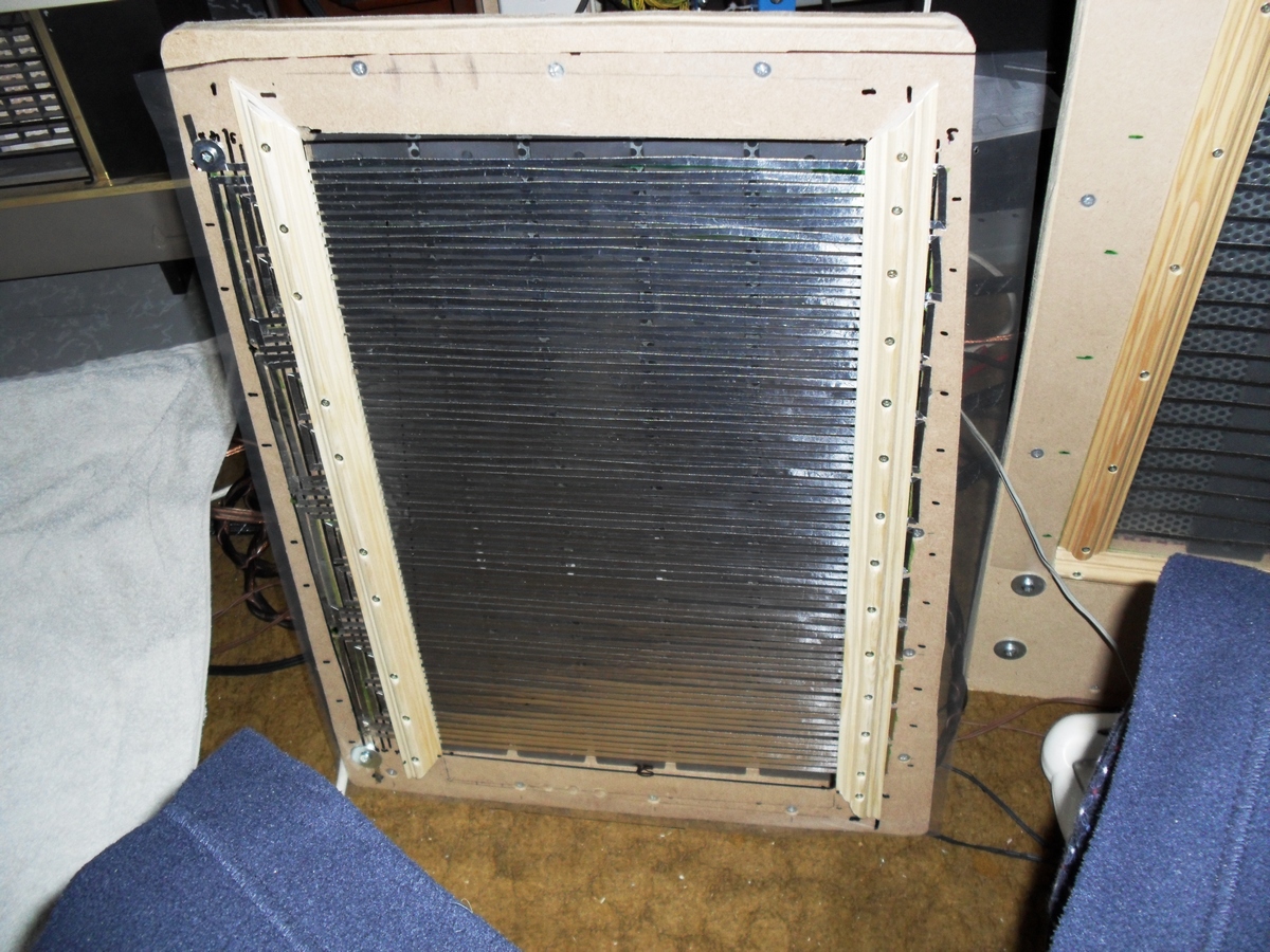

Magnets (125) in place and mdf fixed just need to mark the diaphragm out then put the foil on, make wooden picture frame to hold diaphragm in place. The foil will be in one continuous piece. Then just have to wire it up using penny washers. Then loudspeaker 4 mm posts.:whip::djinn:

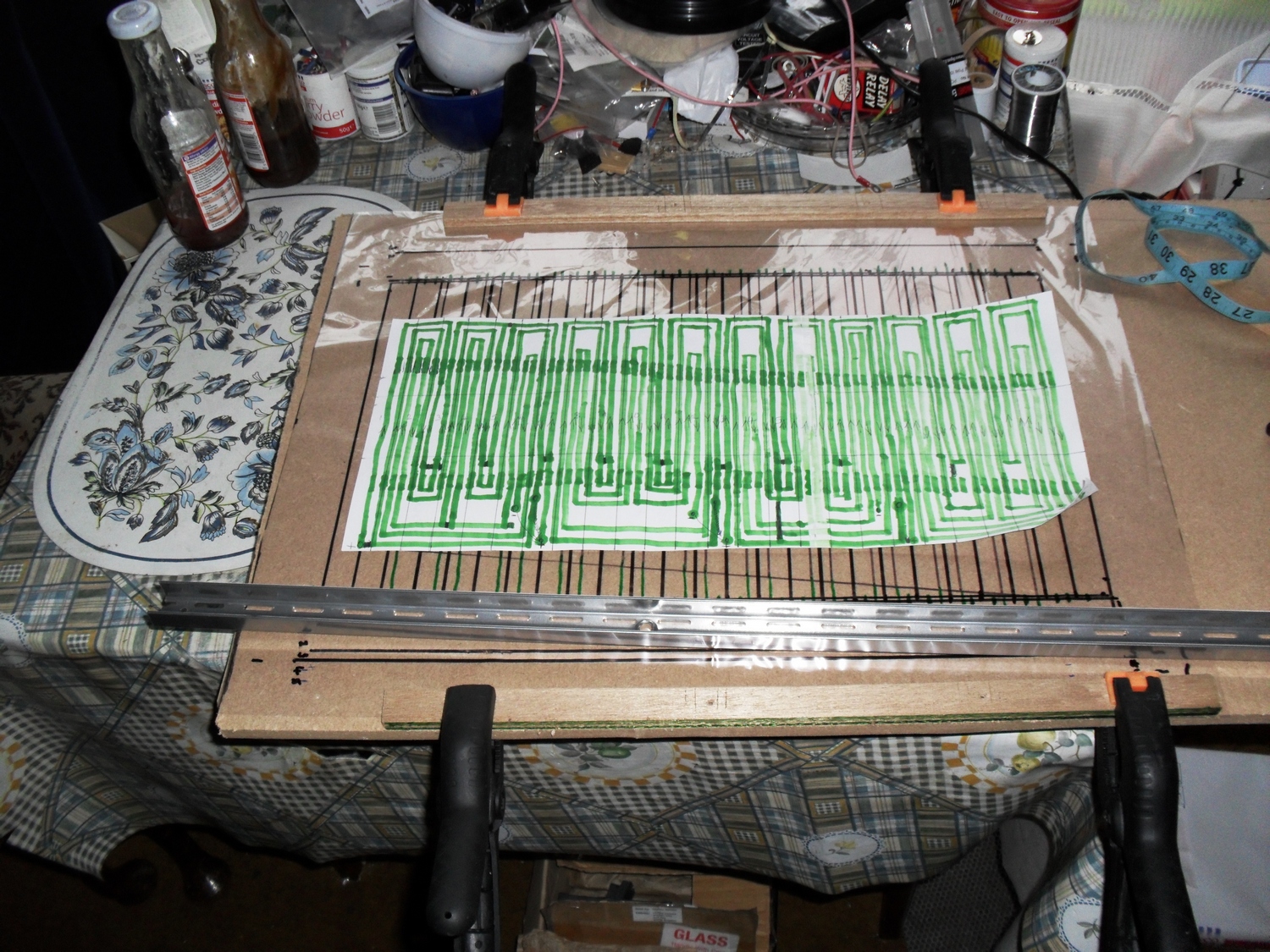

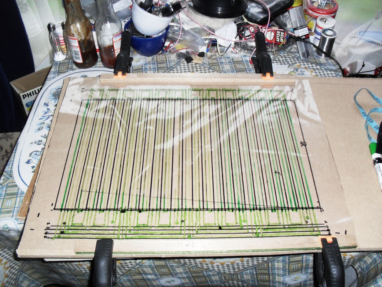

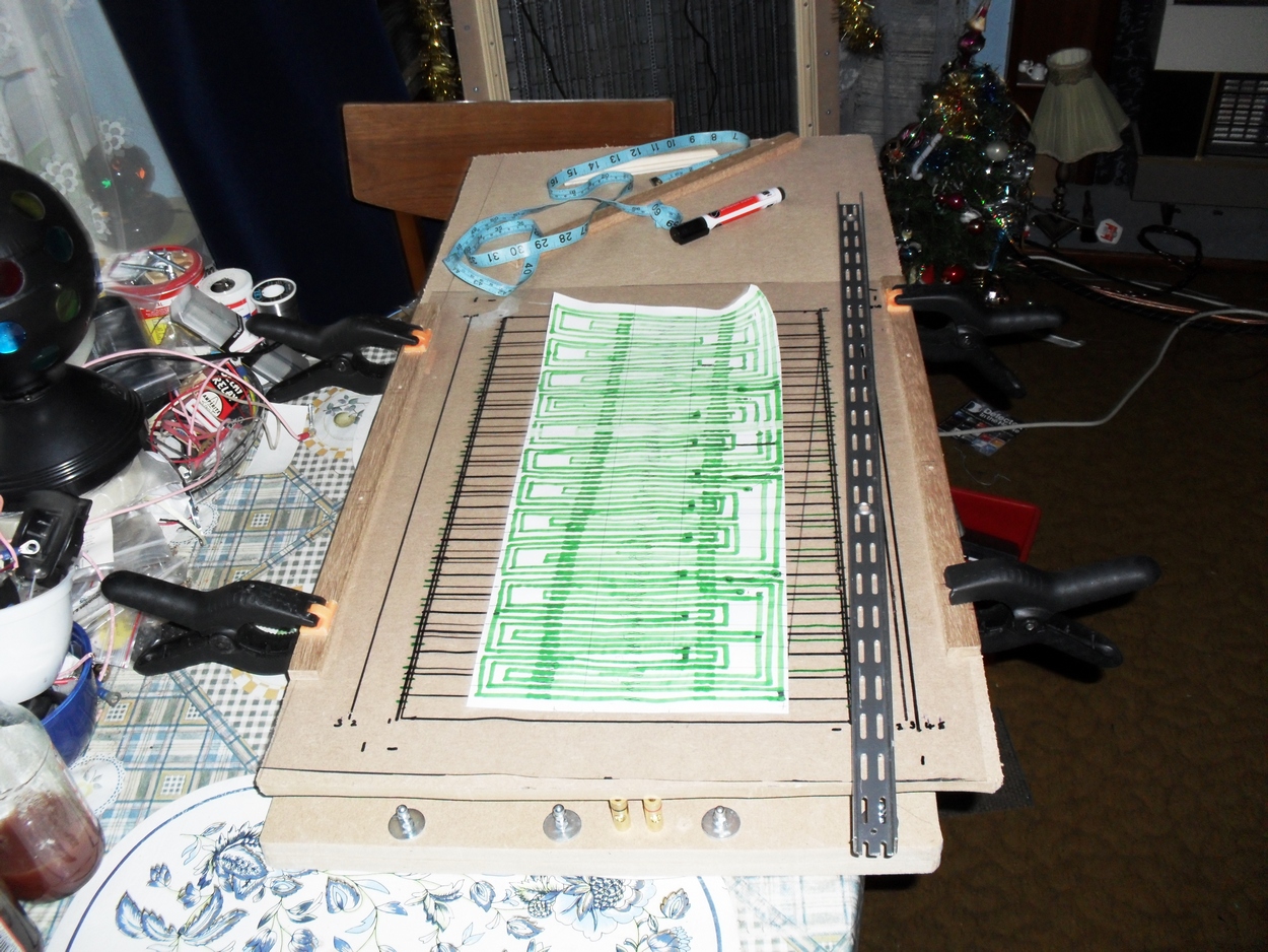

continuing epsilon clones

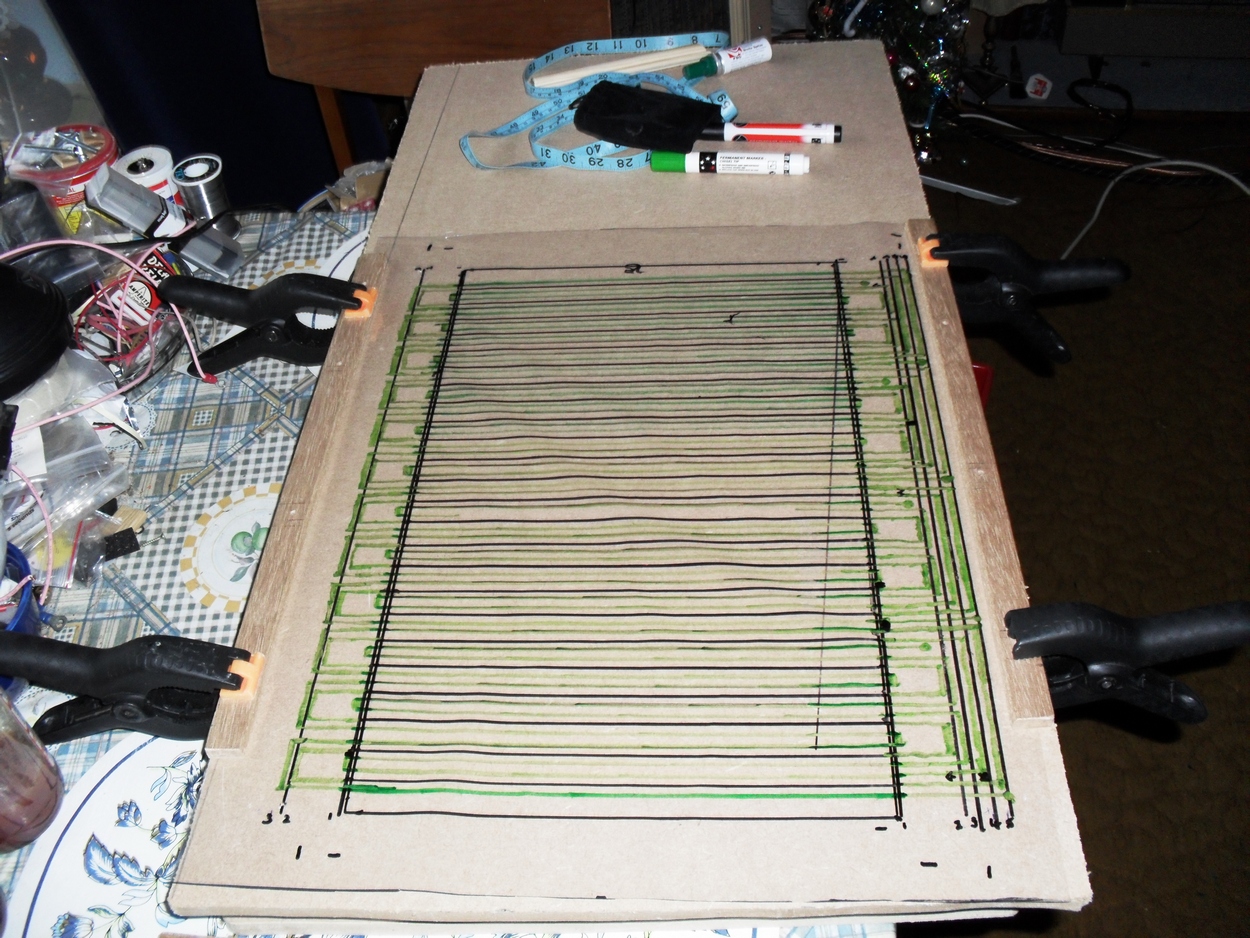

Can't wait for the 12um mylar, so I'm using a neo diaphragm I had hanging around.:santa: Pictures show diaphragm being marked for foil in one continuous piece , will have to use sellotape between as there are 4 epsilon diaphragm layouts on this one. Should finish sunday depending on what I do new years eve!!!;):joker:

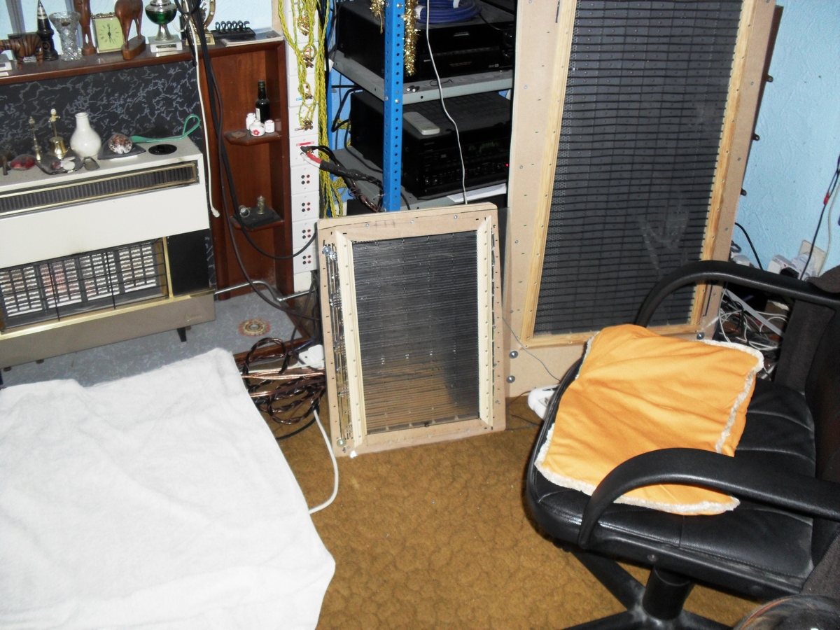

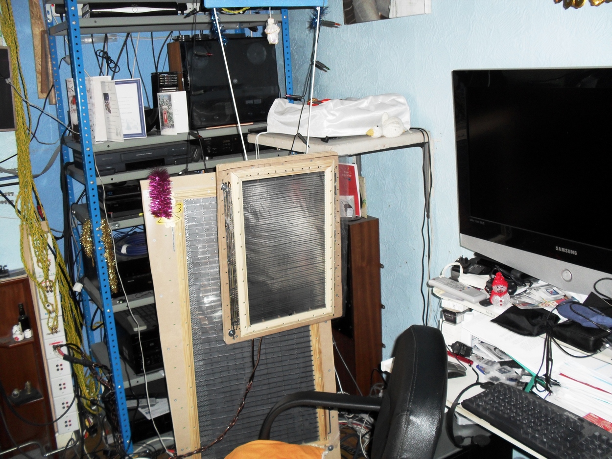

Have not quite finished but enough to try it against the big one on the left . Which is a double epsilon diaphragm. The small one is a quadruple epsilon diaphragm, which works quite well even tho' the design of magnets is incorrect!!

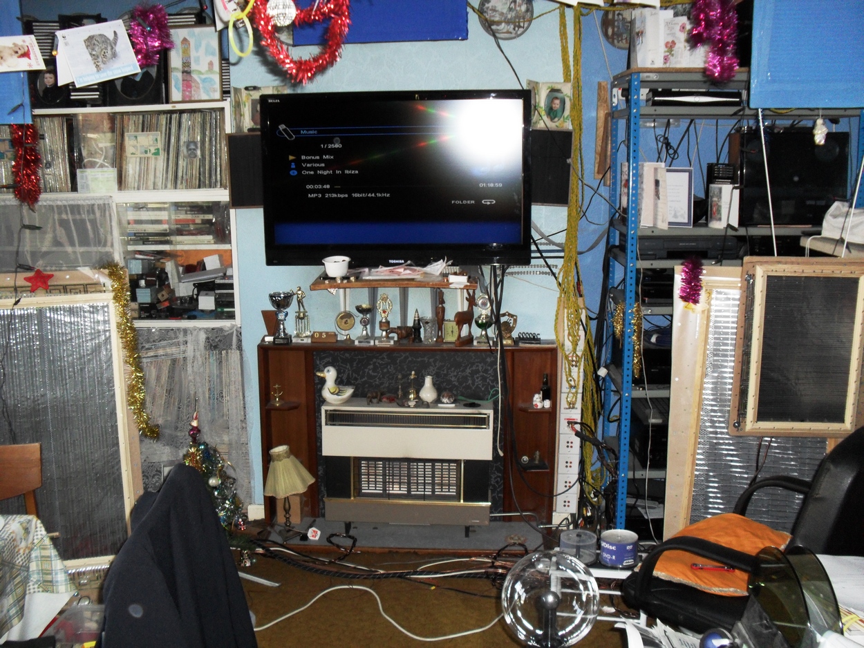

finished small one hanging up and sounds as sensitive as the big one and it weighs 8 kilos and uses 125 magnets as against 294 for the big one. Very happy with the design, may have to rebuild all my designs again:D:eek:
