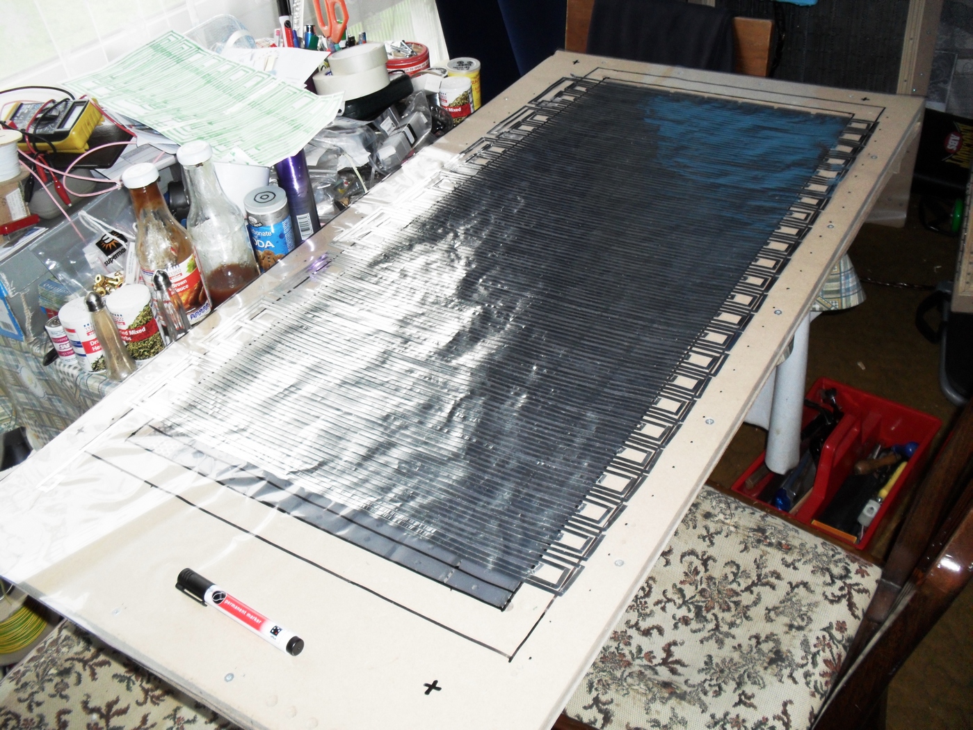

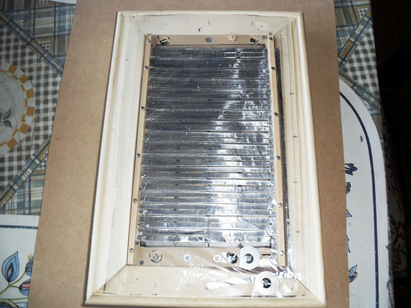

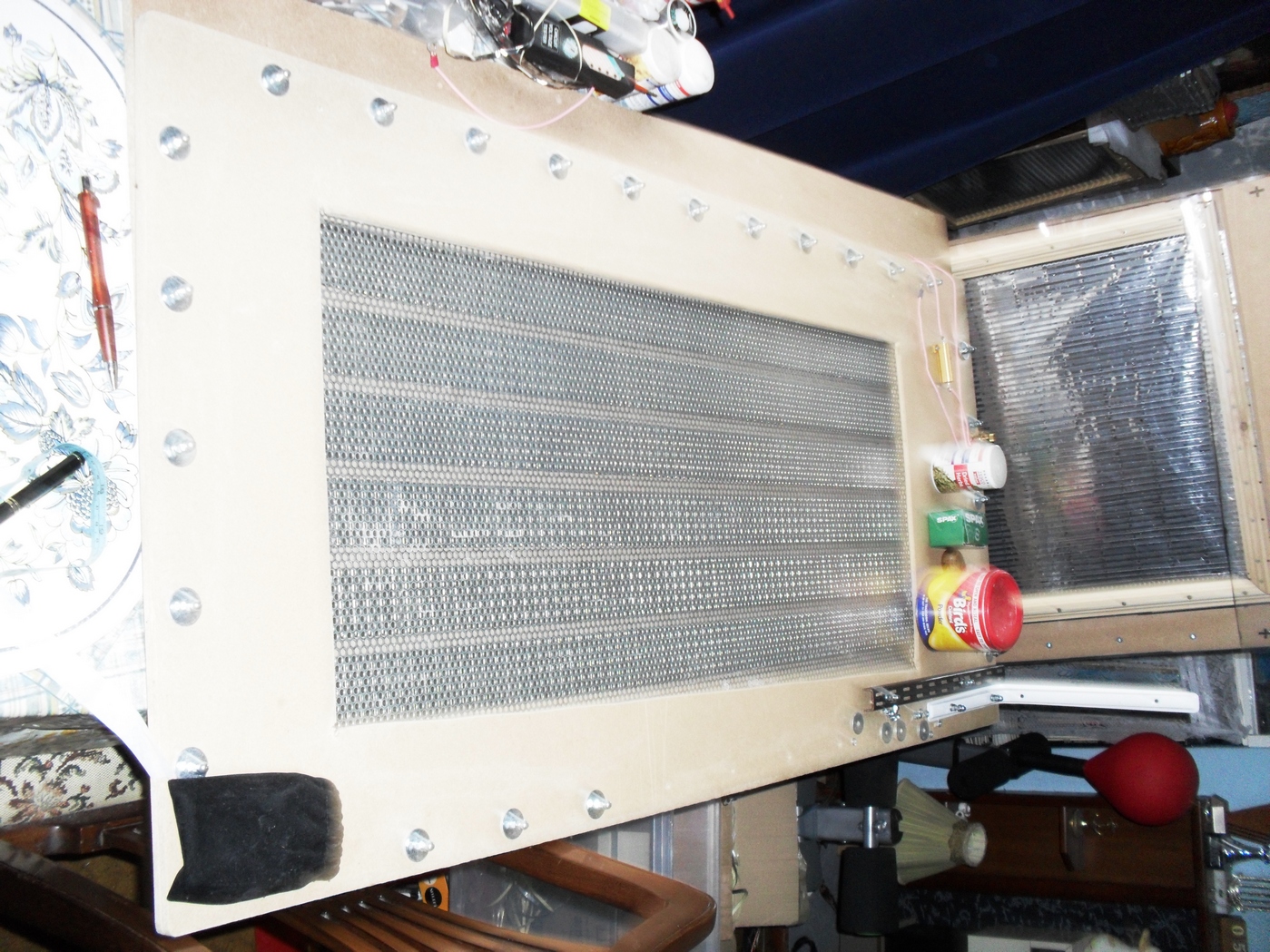

Hi Brian

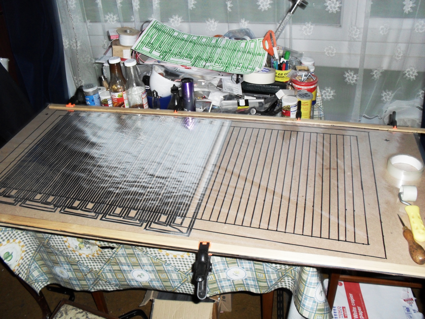

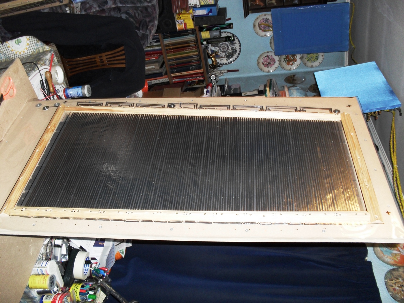

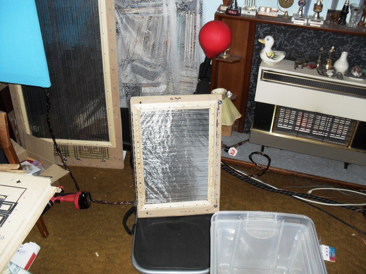

Made a frame of wood and drilled holes through the sides and put long screw's in.
Then I glue the frame to mylar.
I put a aluminum profile over the screw's and mount springs.
Attach the profile to the speaker mdf and now I can adjust the tension of the mylar.
Then I use aluminum tape 9mm wide from farnell for the conductors.
Rob

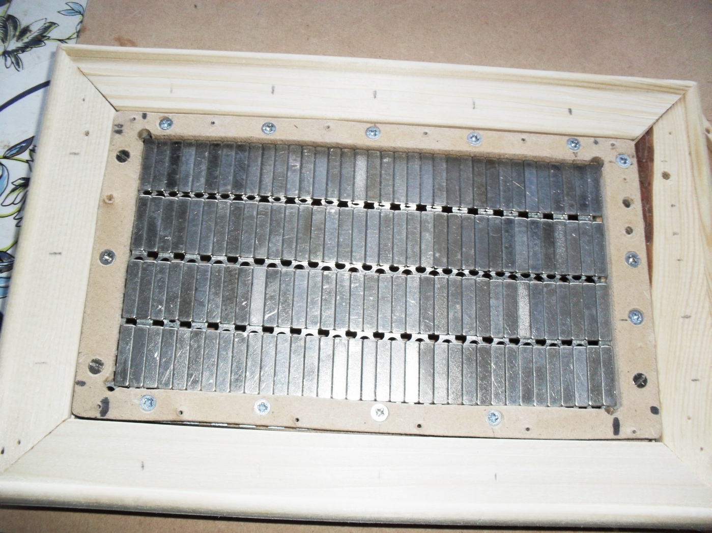

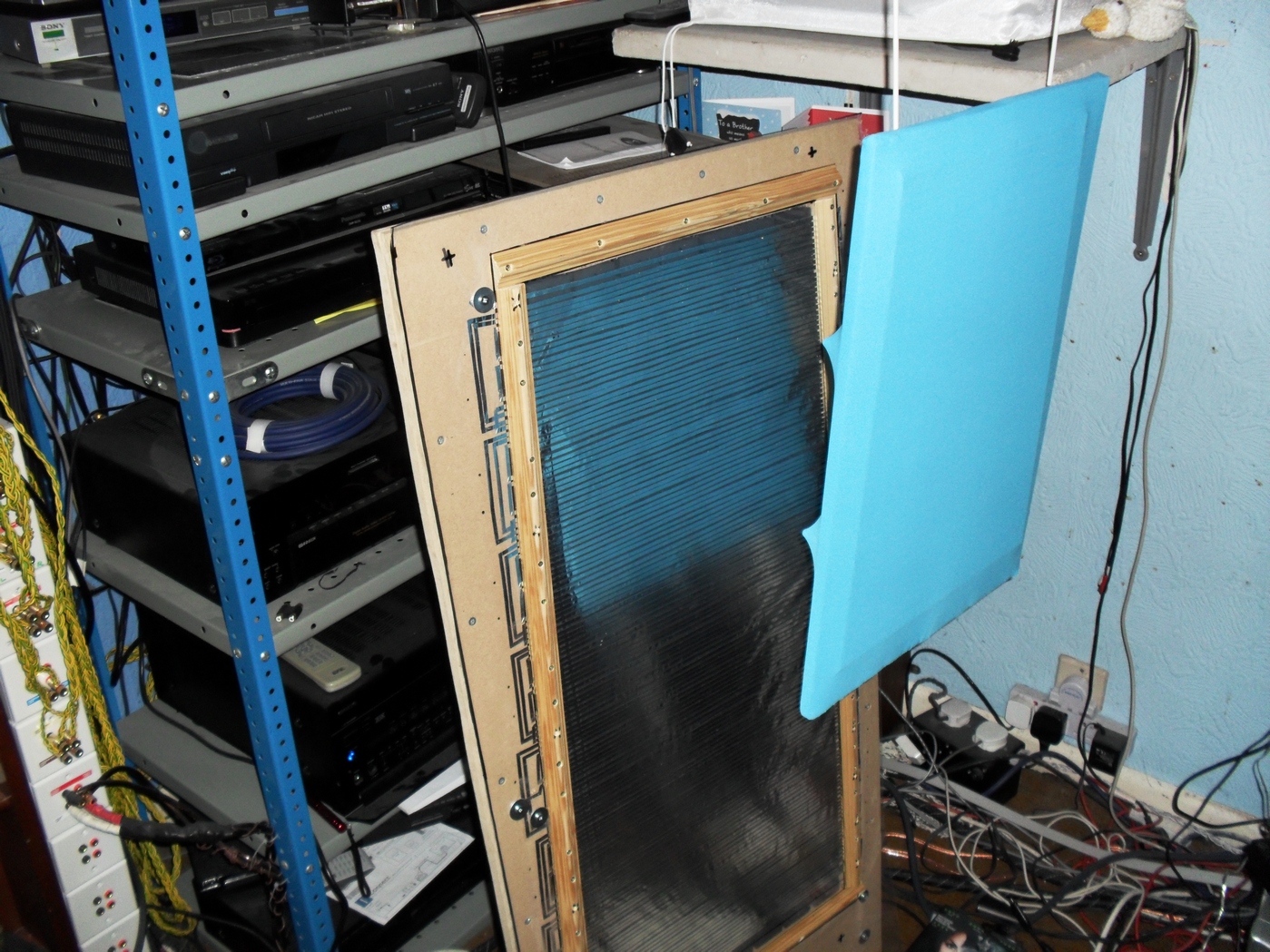

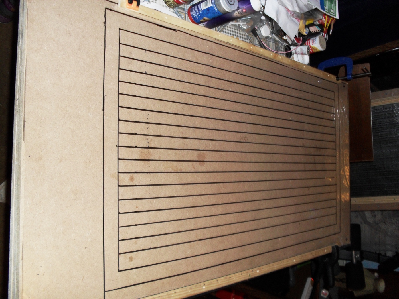

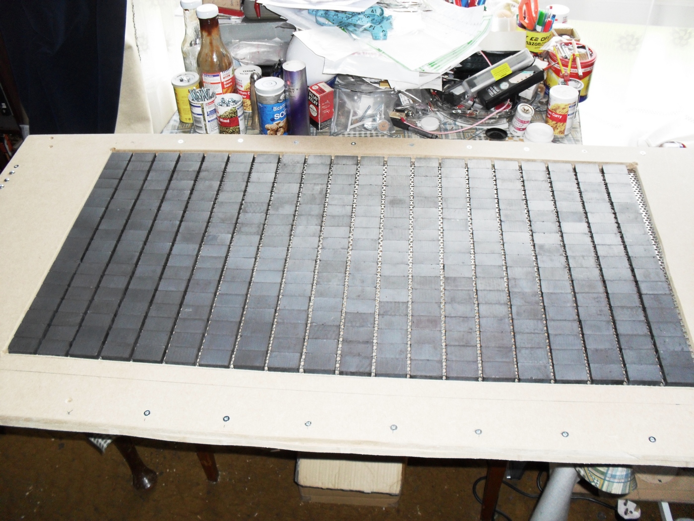

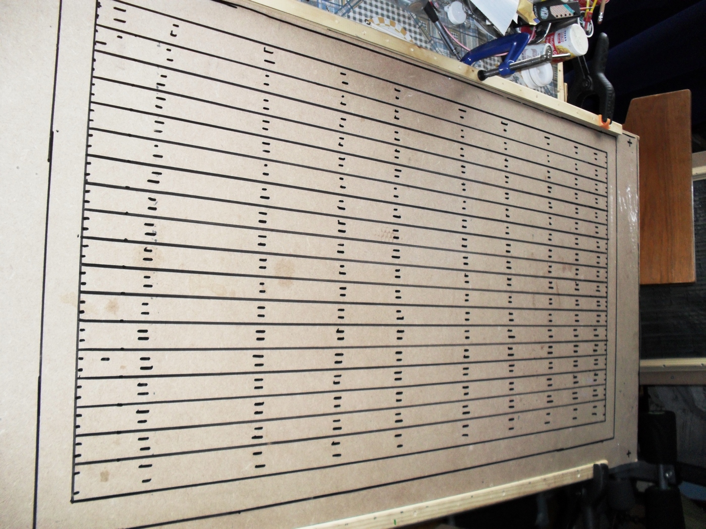

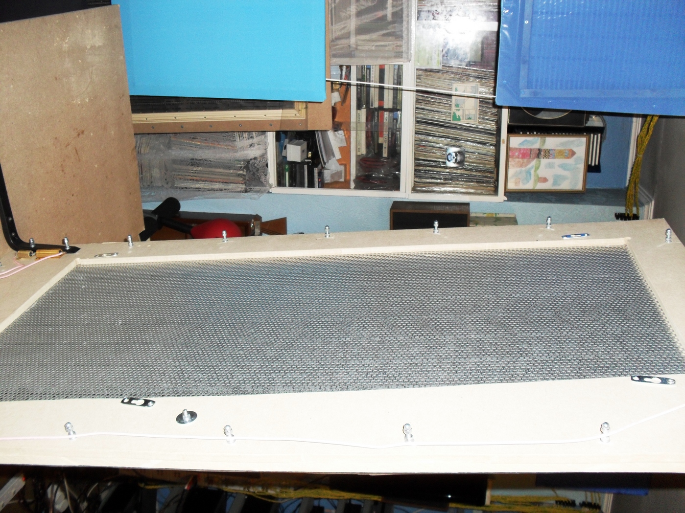

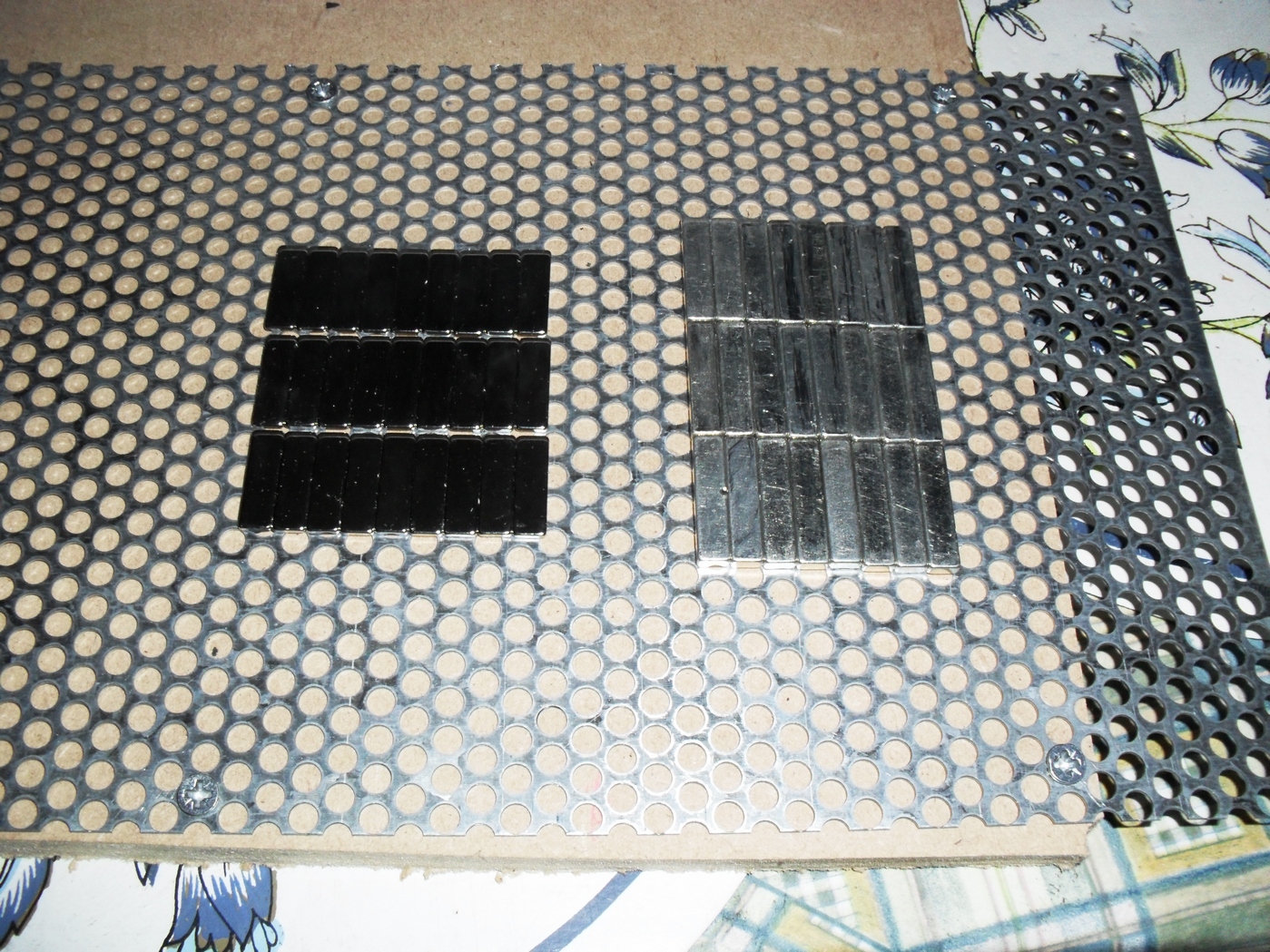

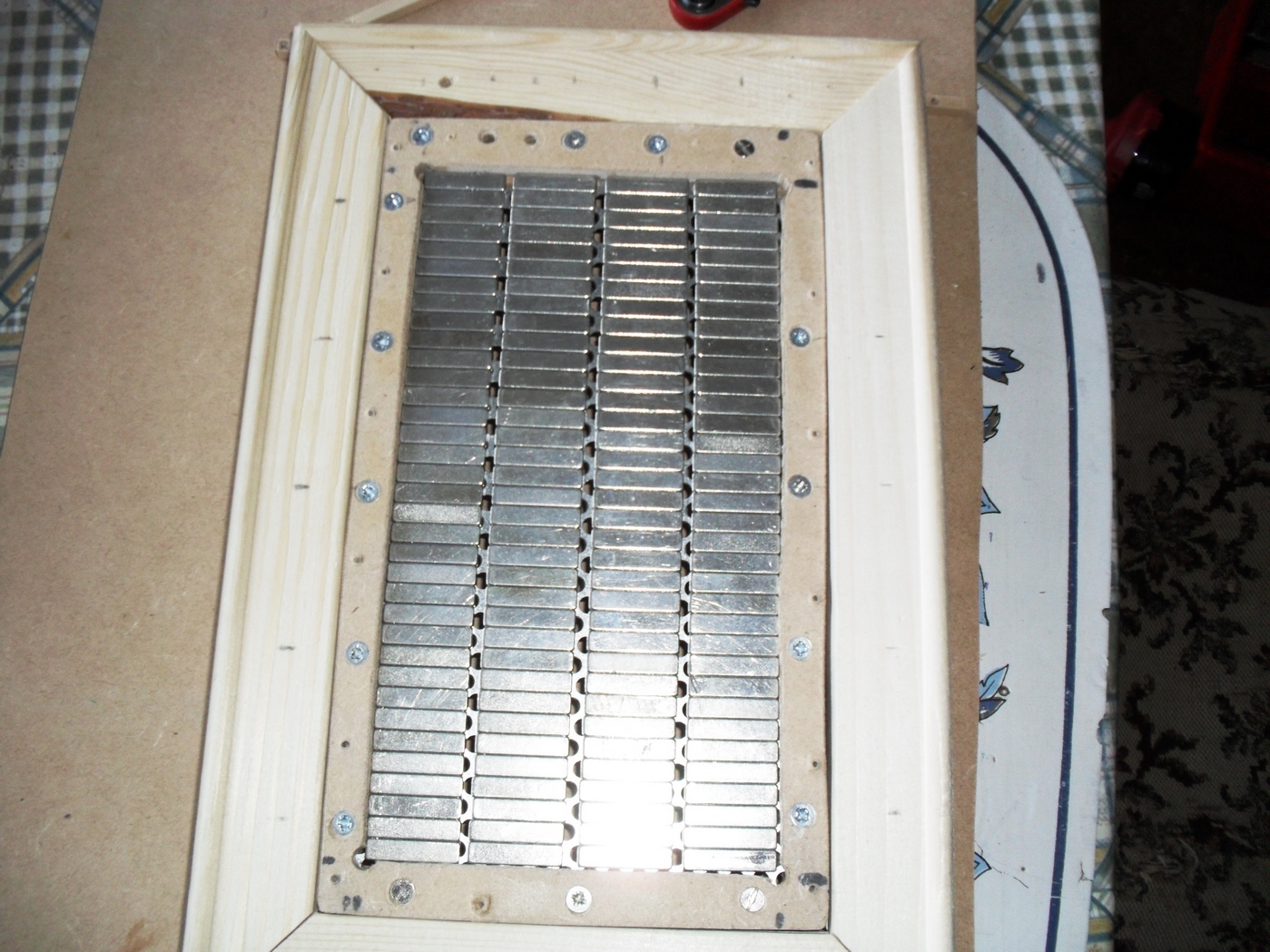

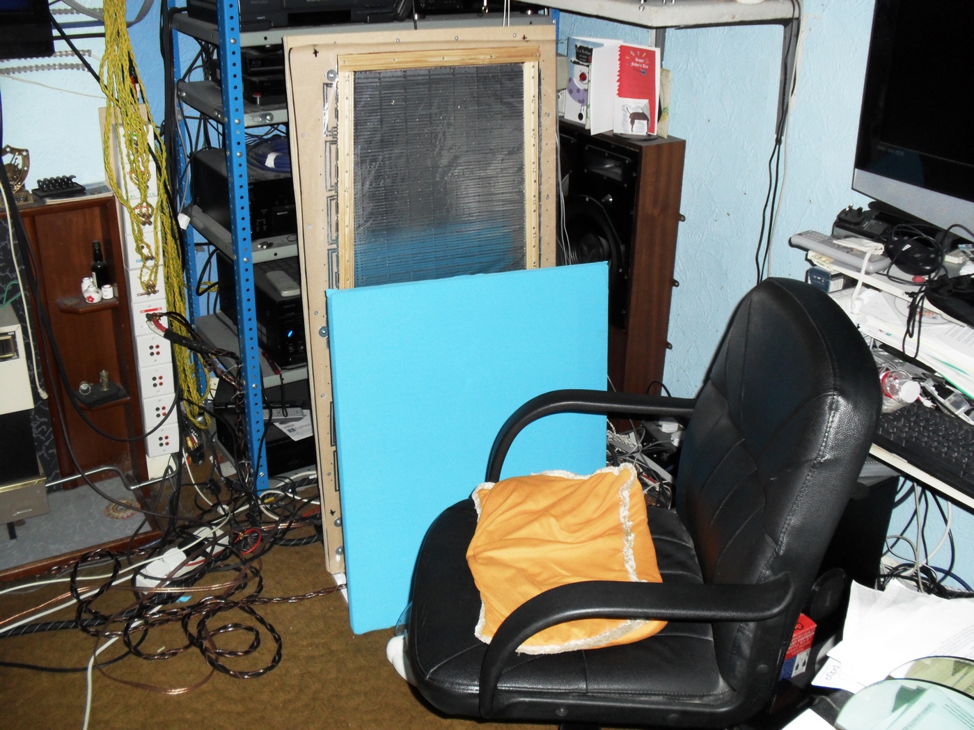

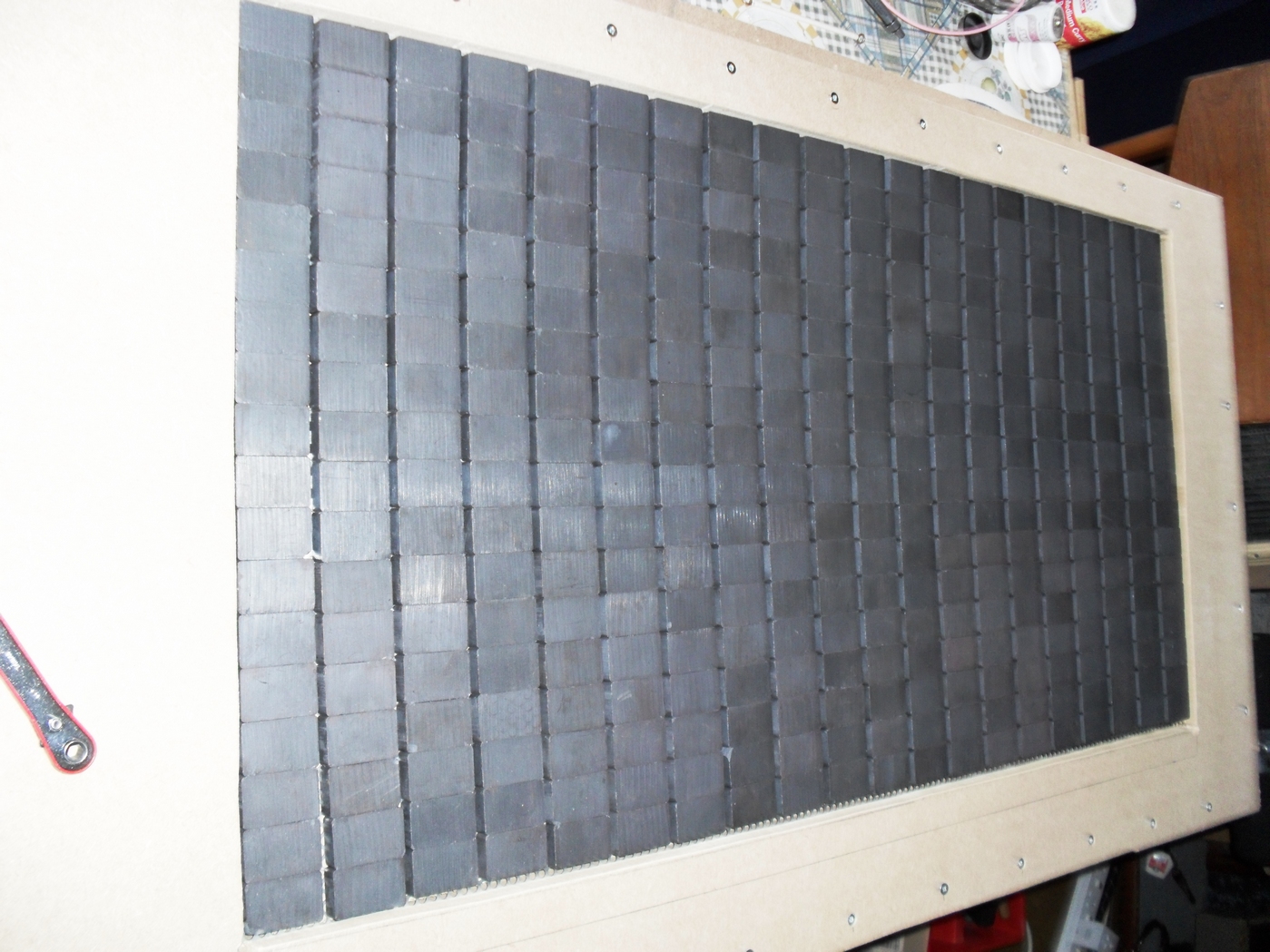

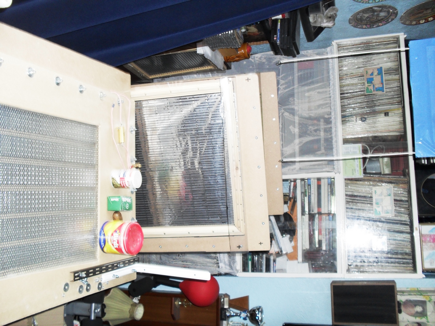

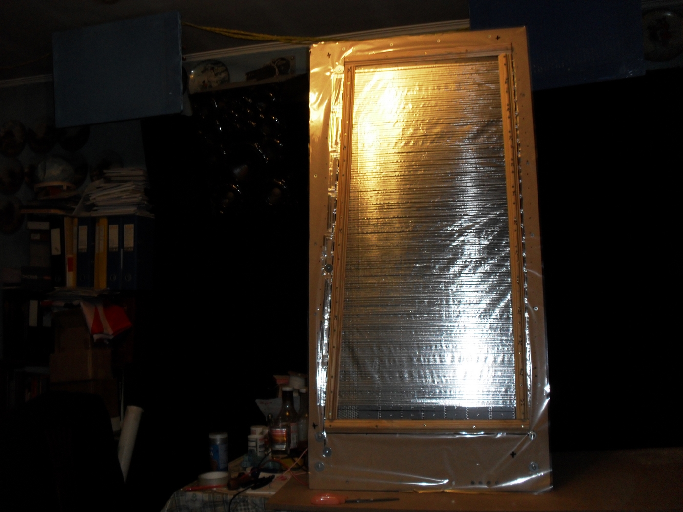

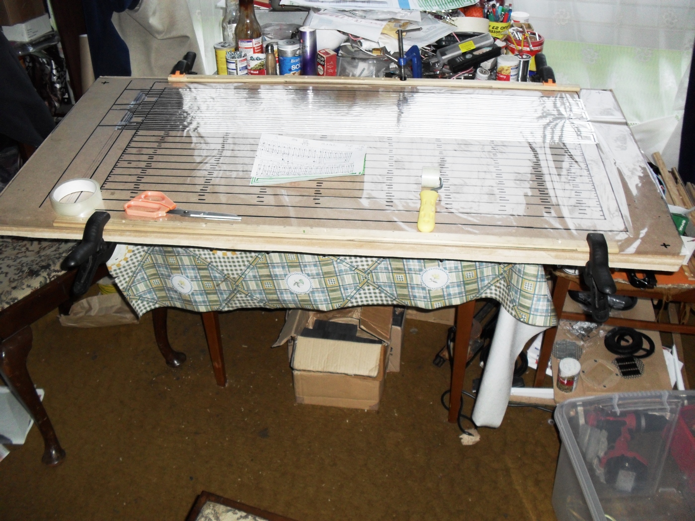

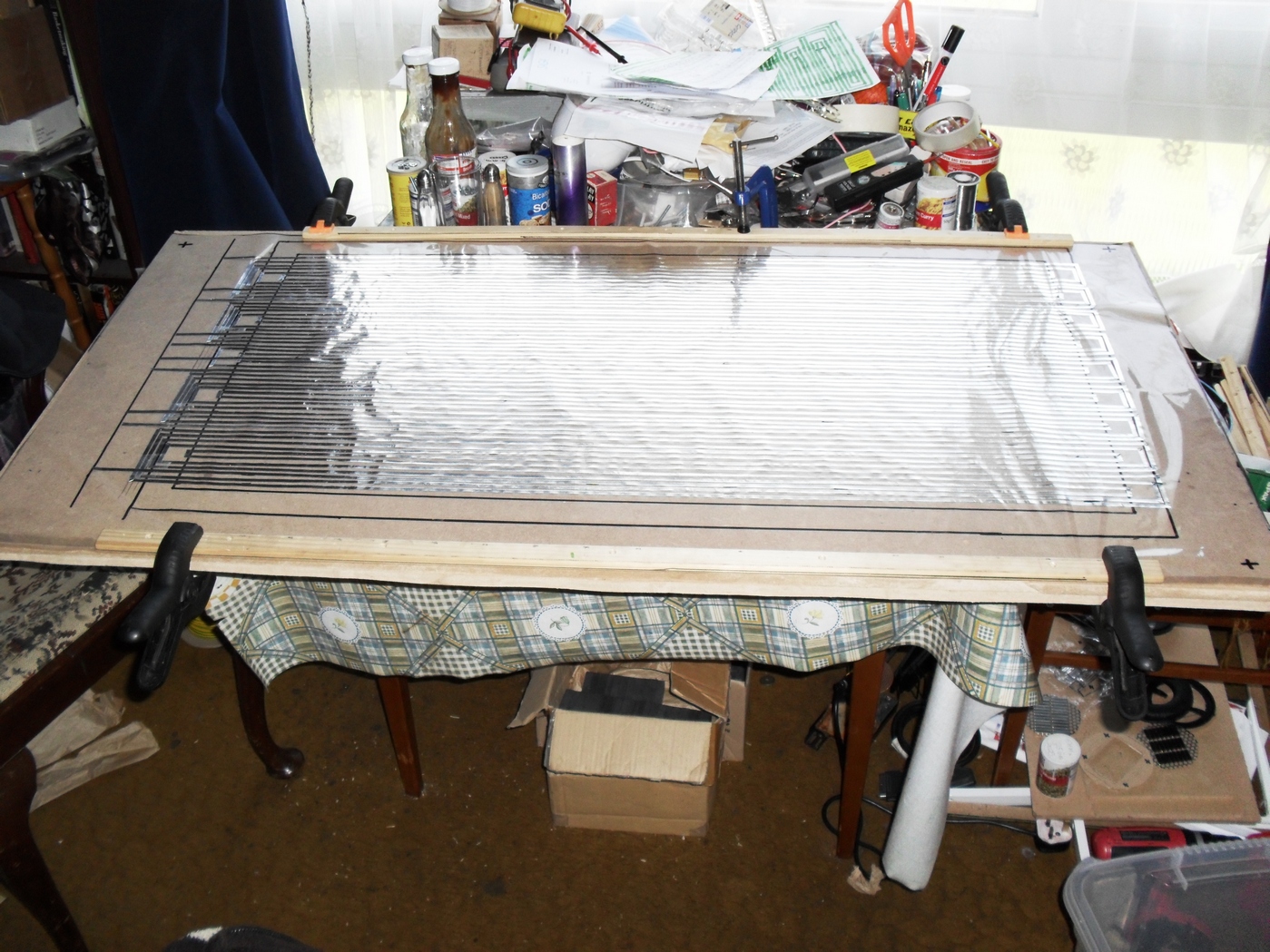

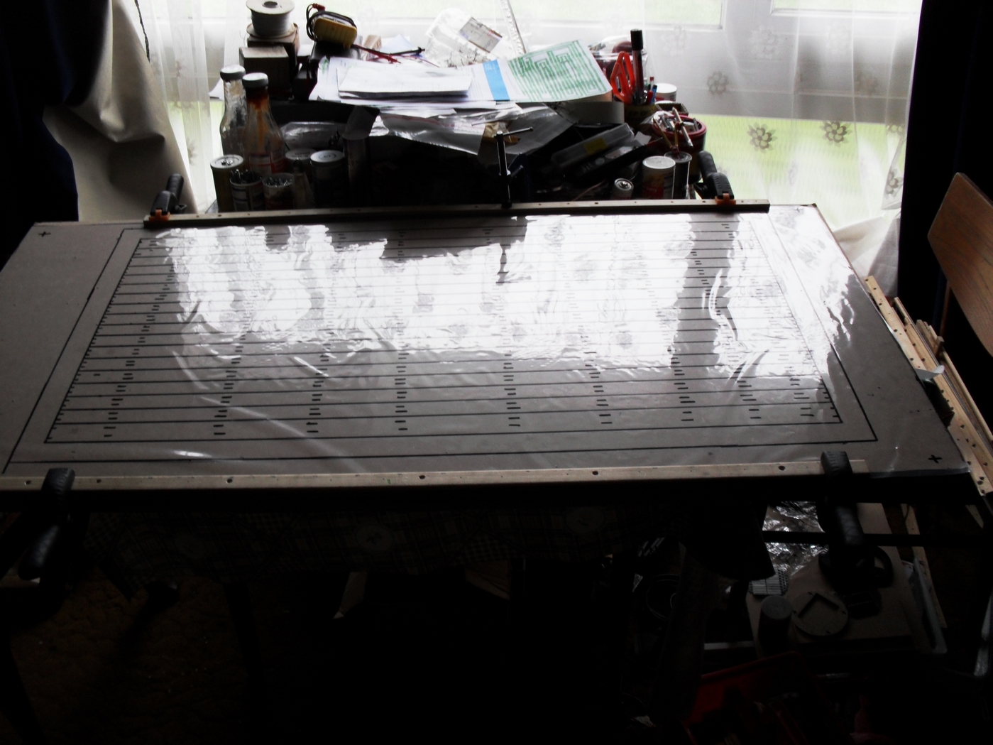

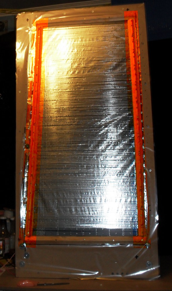

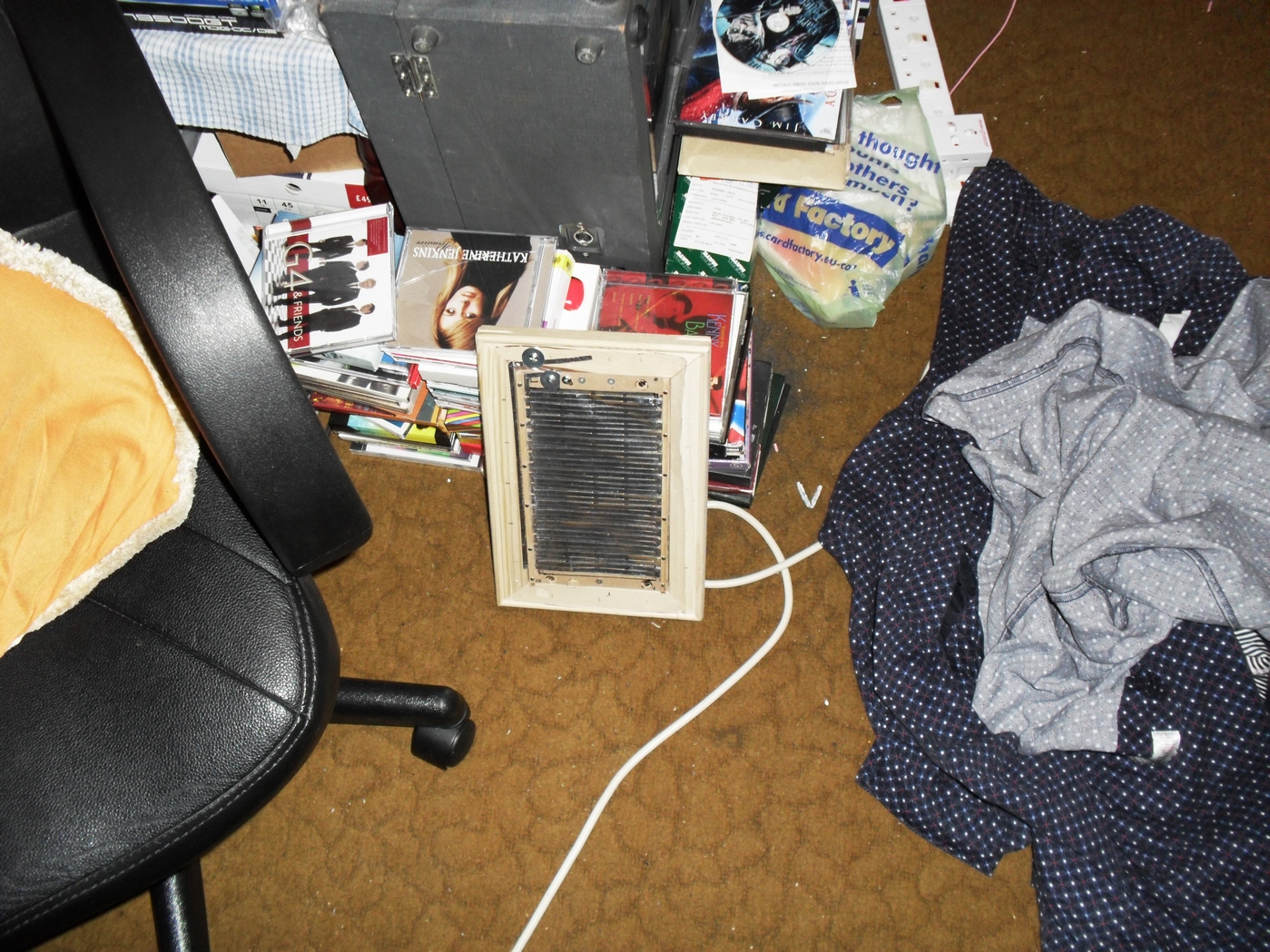

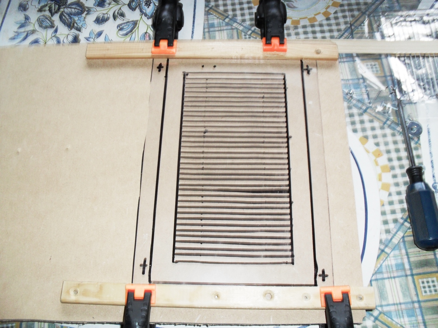

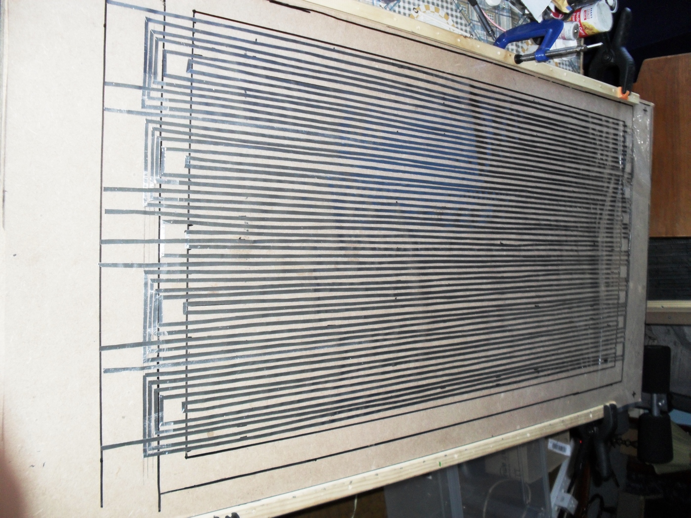

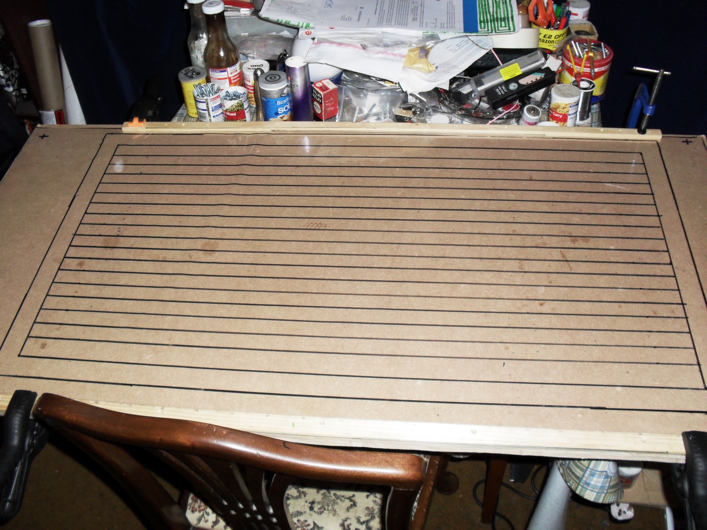

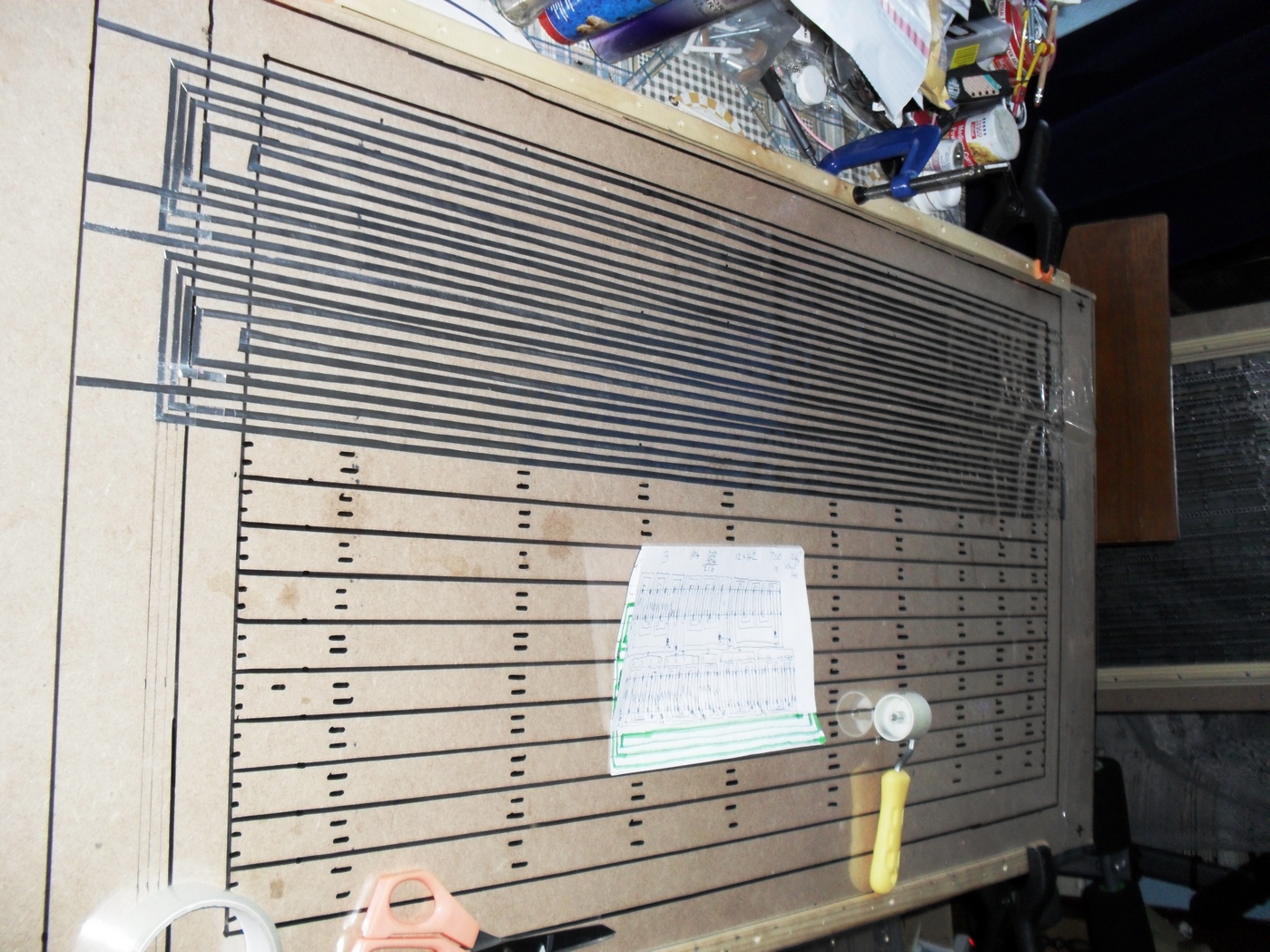

Some more for you to marvel at!! Finished latest design using 80 meters of 4.5 mm wide tape. The first 45 meters ran out before I realized. So the diaphragm is in 2 unequal parts which caused problems when wiring in parallel and the top half is louder than the bottom half. You live and learn. It is running with my first epsilon layout design (with the glued magnets) The small A4 sized design is my next rebuild. Then I may finish my planar headphones next.

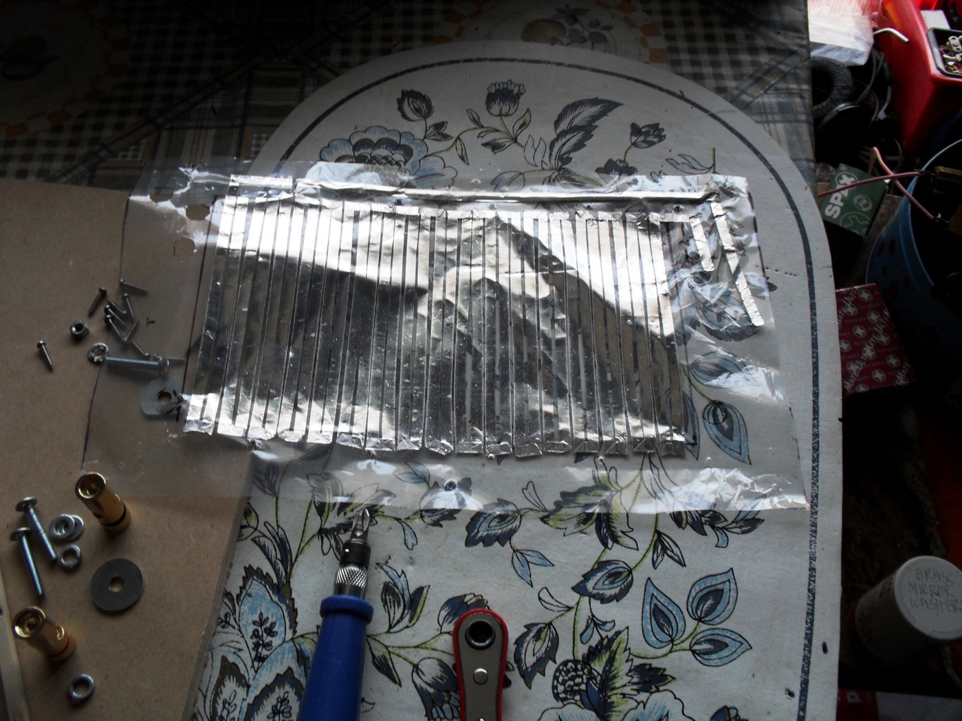

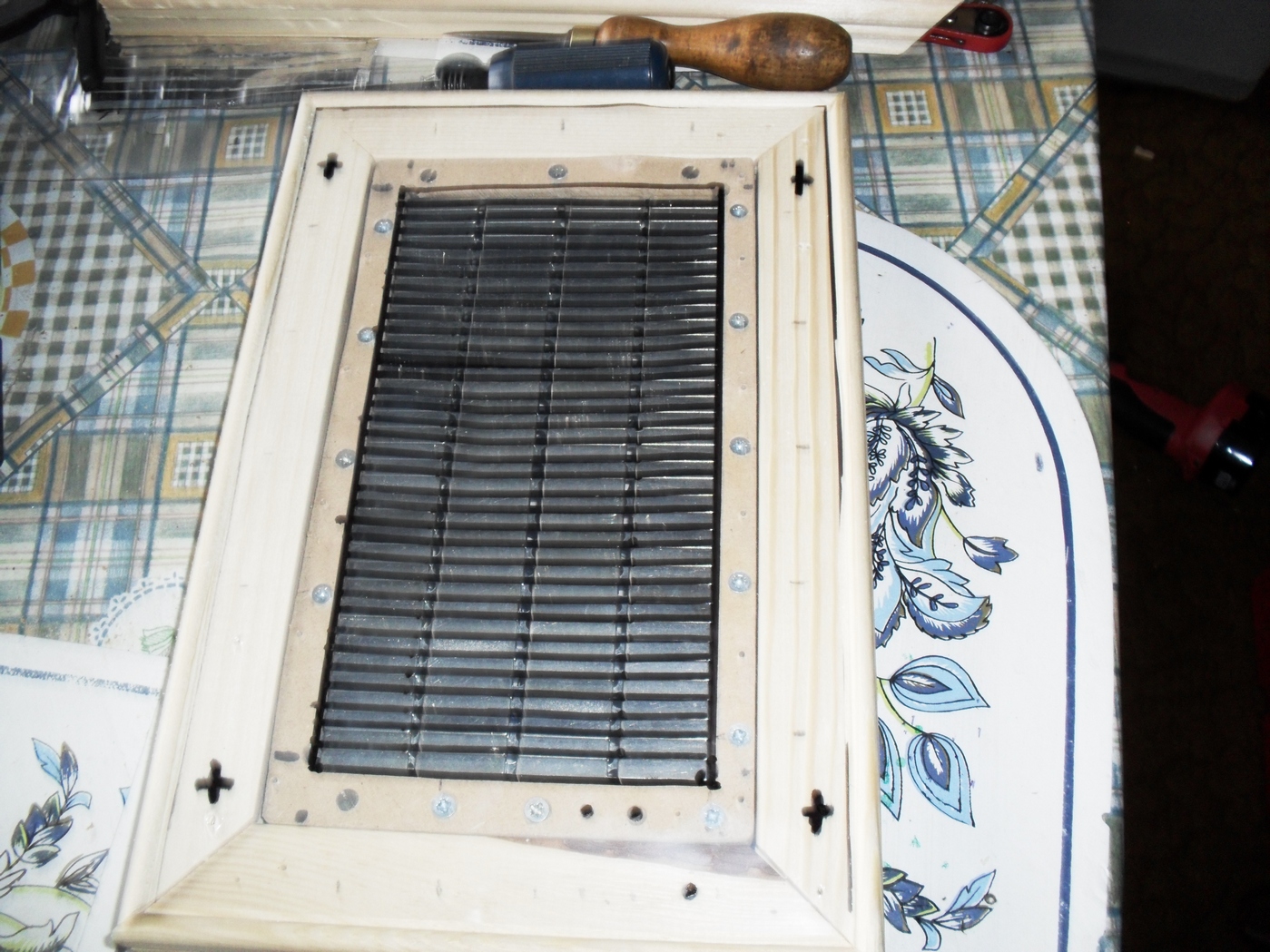

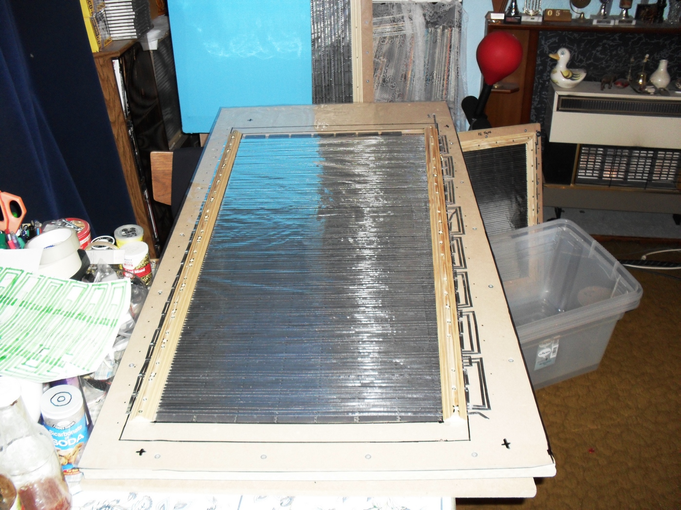

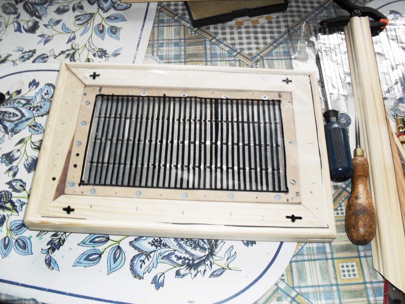

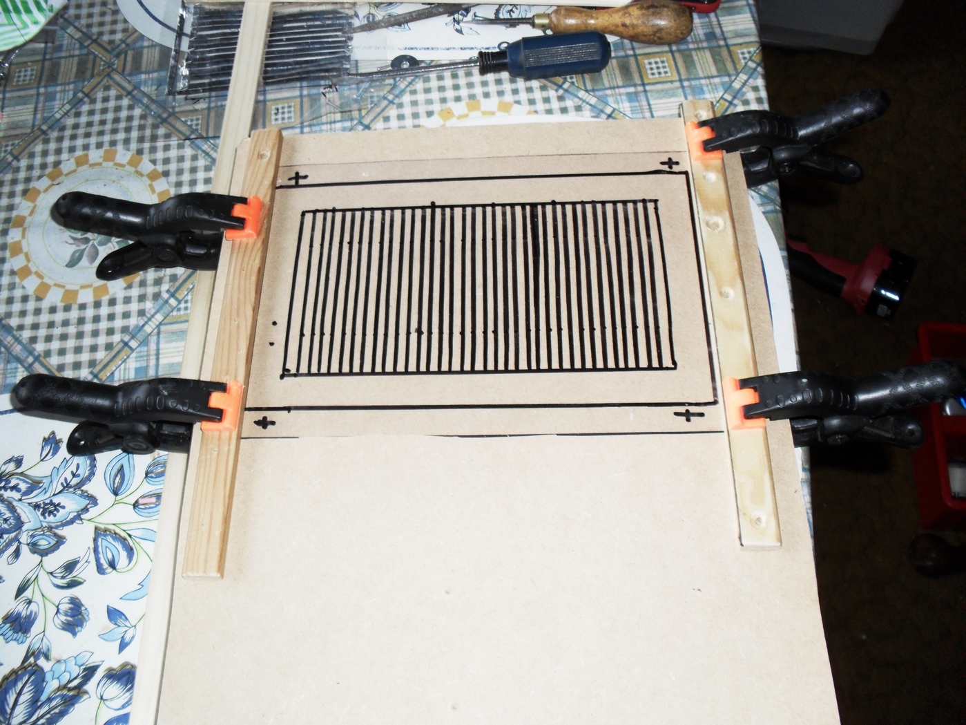

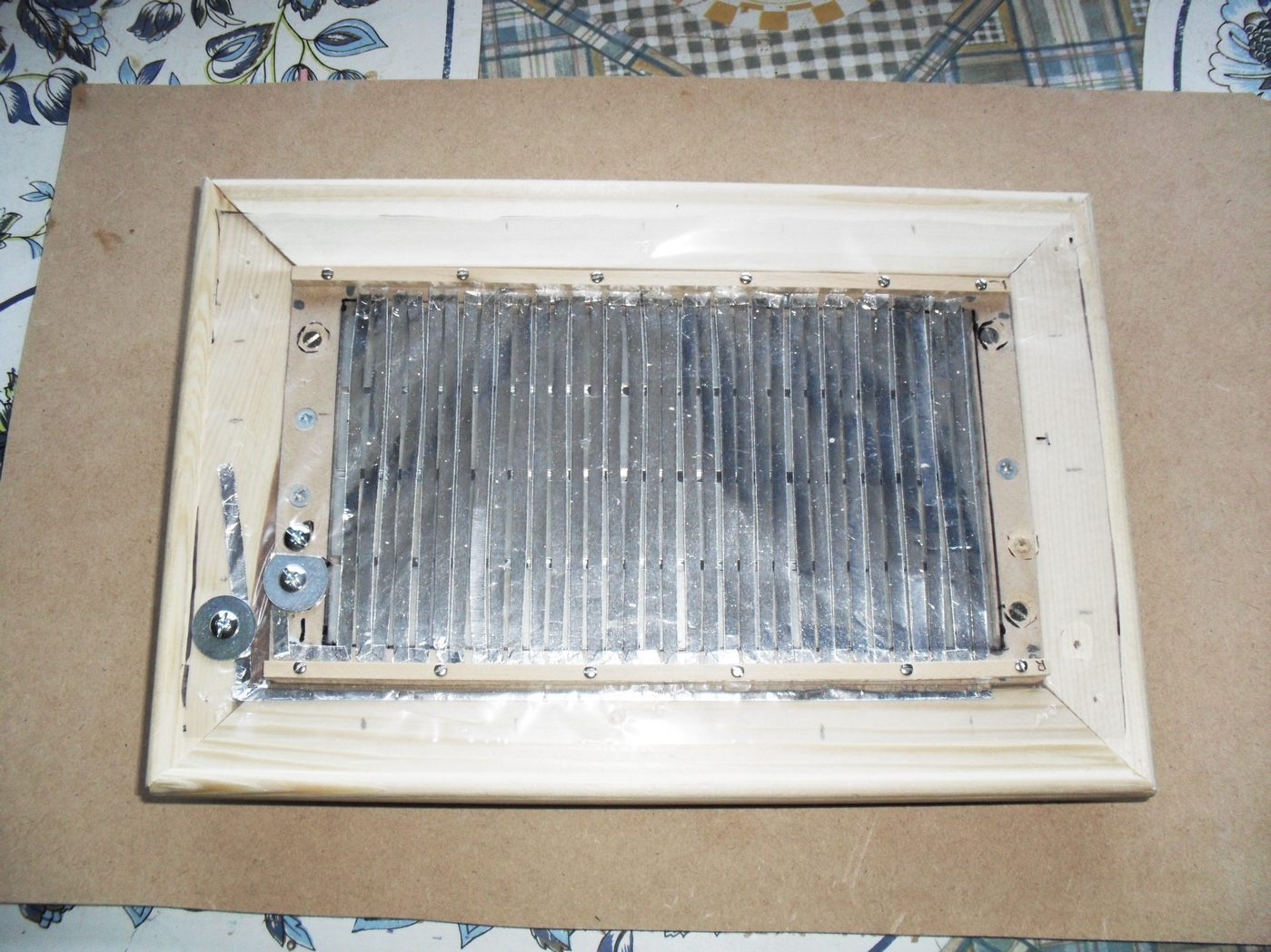

MY A4 SIZE REBUILD.
Some more photos of my latest rebuild. The last but one is the old diaphragm, and the last photo is the new tape 2.25 mm wide to fit magnets on the rebuilt diaphragm using epsilon layout. I think it's called being obsessive.!! After this it's my planar headphones, to be finished. Then it's back to the rebuilds, all that tape cutting, about 300 meters.

I have stopped work on these at the moment as I ruined the diaphragm fitting it to the surround, and I have not heard it at this time. The resistance of the old diaphragm was 1.4 ohms, the new one is 4.4 ohms.Hi Henry

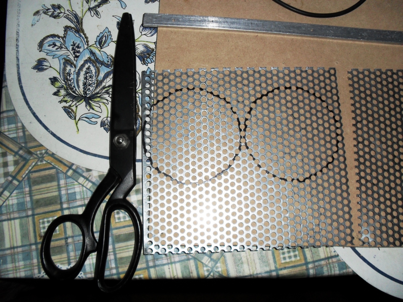

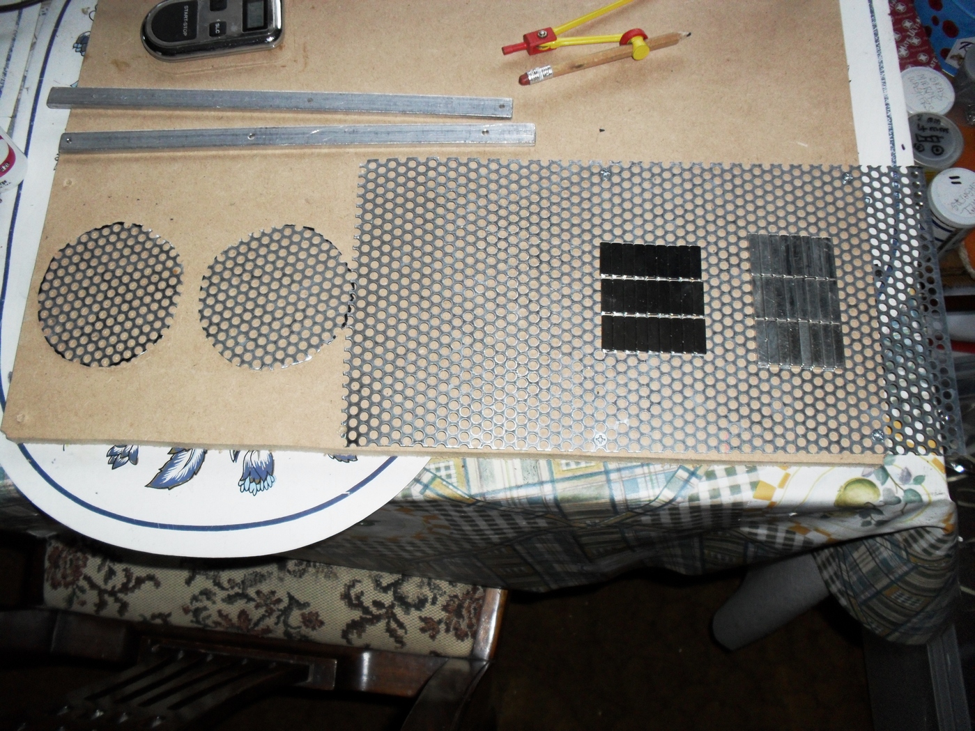

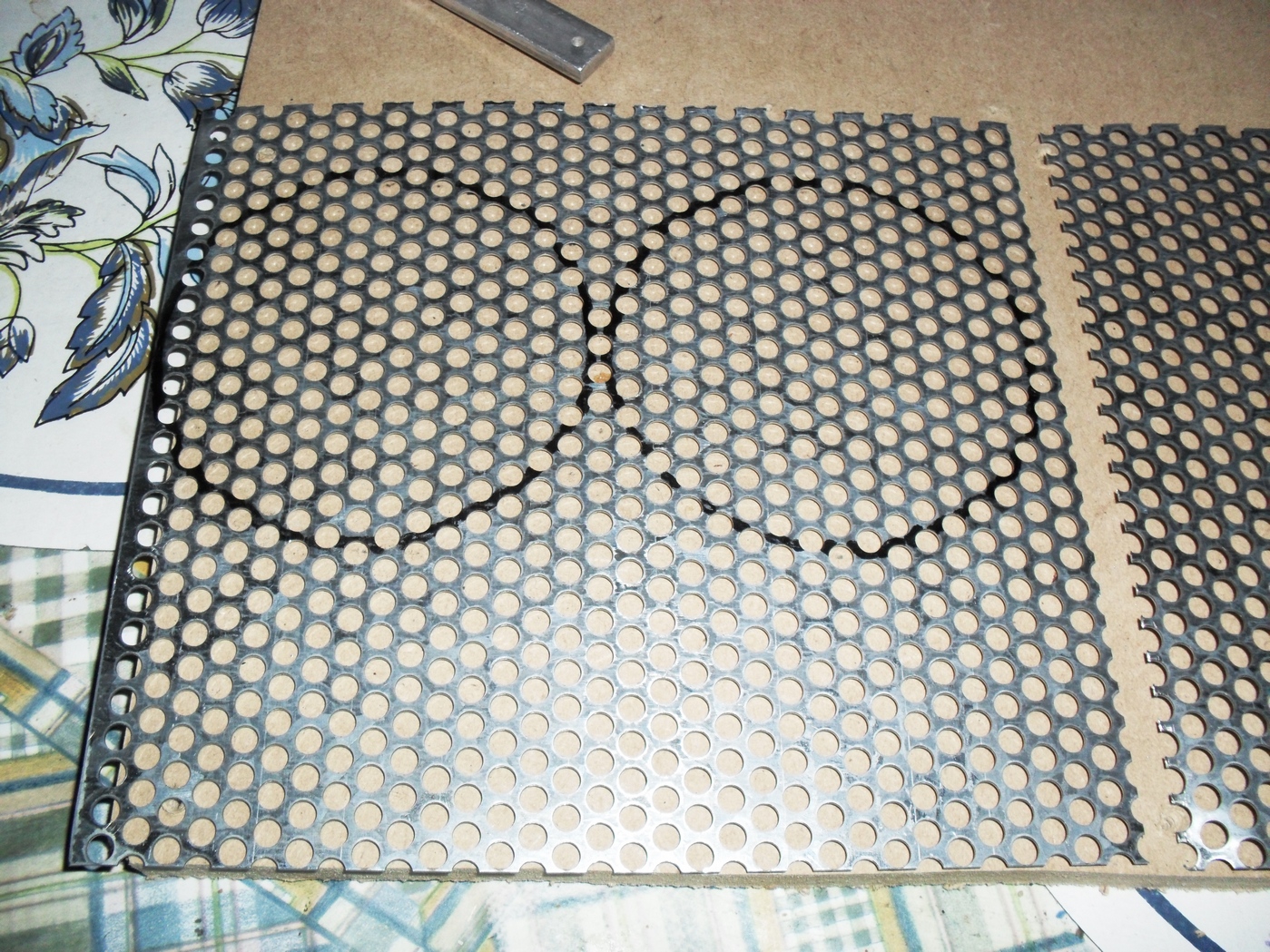

next project headphones 2 designs
The blue ones are my latest rebuilds, 7.1 Ohms. Then headphones 2 layouts see which is the best!

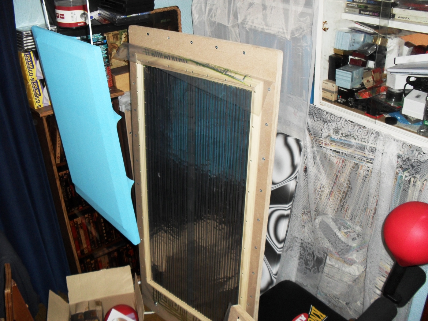

some more pics of rebuilds
A epsilon layout design using 5 separate layouts on 1 diaphragm, using 40 x 25 x 10 mm ferrites.
