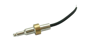

How about some kind of temperature sensor trigger circuit. The biggest reason electronics usually eventually fail is temperature.

It is a thermistor CTN, looks fine, don't you find ?Christophe,
You are proposing a thermocouple to monitor the heat rise of the transistors? I guess you would just set that to the maximum allowed temperature before shutdown as your trigger?
NTCAIMME3C90373 http://www.vishay.com/docs/29131/ntcaimme3c90373.pdf
