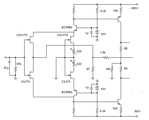

Jam,
Yes, I like that double-diamonbuffer amp too. Although having
more parts it is still a clean and straightforward topology. It might
be suitable for a headphone amp perhaps (or power amp for
those who can afford the heatsinks and electric bills of running
class A ). Maybe one could experiment with a resistor to
ground at the input of the output buffer to reduce the OLG?
As for the Mosquite/Buzquito amp, I was not really thinking of
DC servos (if that is how you interpreted me) but rather something
like this, perhaps. The JFETs of the leftmost pair are the input
buffer and have to be closely matched. The rightmost pair looks
like a buffer to, but is two adjustable CCS's which are intended
for bias and DC adjustment since this can no longer be done
at the input buffer. The Rc's of the cascodes will need a lower
value than before since the Iq will be higher, and maybe the
cascode BJTs will need to be replaced with something more
"sturdy". Note, only input and VAS shown in this figure.

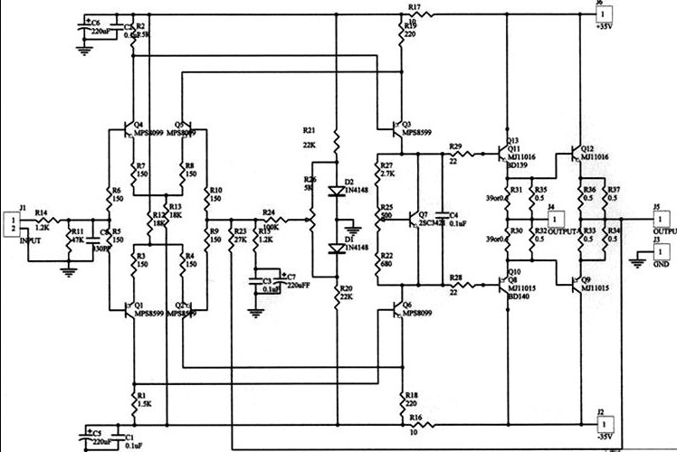

Hi, Graham,
Hi, Subwo1,
I read that you drop the folded cascode. I'm curious about this topology, Q1+Q2+Q7 in your first design. Many design uses this kind of folded cascode configuration, like Mr.Curl, Mr.Borbely, Mr.Pass(in A75), MCIntosh, and so many other.
Usually the differential is more independent to the VAS, only 1 leg of the differential is connected to VAS, but in this design both differential's leg are connected to VAS.
What is the merit of this configuration (compared to old fashioned design)? In measurement? In sound result?
I dont understand this. Got any drawings?The 2xC+R networks should improve the balance between halves at rf frequencies.
Hi, Subwo1,

Hello lumanauw,
To borrow a phrase, the reports you heard of the demise of the folded cascode for me are greatly exaggerated. The circuit without the cascode was an experimental one for educational purposes only. When I actually build a circuit, the folded cascode one using some value of base input resistors is presently the top contender while the 2nd more conventional one for tests is not even in the running. Thanks for mentioning that those other circuits from well know designers use the folded cascode. Quite honestly, when I discover something, I often do not even know there is already a name for it. I just assumed that since it was such an elegant layout it must have been previously known by someone. I learned that from my _discovery_ of the synchronous rectifier several years ago. I didn't have a name for it so I had a very hard time doing a patent search on it. Also, I played around with the folded cascode about 20 years ago when I was experimenting with the old Tiger amp circuit. In fact, it was in an identical way to how you say it has most commonly been used.
The advantage of applying folded cascode drive from both differential collectors to both VAS emitters is symmetry of operation. A music wave form can have equal chance of a particular excursion in either direction, so it just makes sense to me to enable equal control in both directions. Since cascode drive is faster than base drive, I just figured that it was a way to speed up the feedback loop and give the feedback a forward boost in time. That sounds simplistic, but nonetheless, sums up that aspect of what I was thinking.

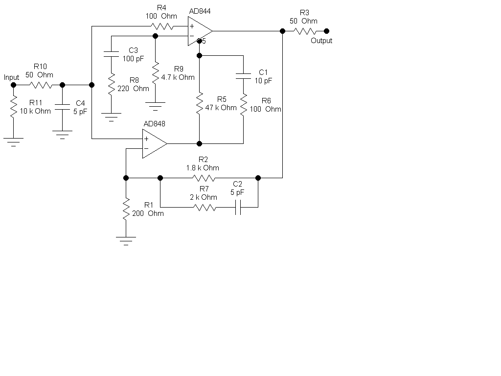

Jam:
>1) No Servos
>2) Keep the design as simple as it needs to be, without hurting performance.<
I guess both of these leave me out.
>3) No chip amplifiers.<
I admit that unfortunately the vast majority of opamp audio circuits published in magazines and on the web are dreadfully boring. OTOH, opamp circuit can be unique and fun, _if_ the designer is willing to think "out of the box" and devise composite-type circuits. In my own case, I start by assuming that an opamp is not a black box with sealed internals but rather a discrete circuit that is waiting for me to figure out how to get in.
A lot of opamps have compensation pins that provide access to the internal circuit nodes, and you can use these to create interesting composite circuits.
Pins 1 & 8 on many opamps (5534, OP-27 for starters) tap into the bases of the second-stage differential, allowing you to splice in a completely separate discrete input stage (just short the normal input pins 2 & 3 to the minus voltage rails). Gives you great flexibility in setting the input device choice (BJT or FET), input operating currents, degenerative feedback, cascoding, open-loop gain, phase compensation, multiple feedback loops... Different opamps have different styles of compensation nodes, so simply think of what you want to accomplish and look for an opamp that has the internal topology and external access points that you need.
A second example is the AD744/AD811 composite circuit designed by the esteemed Walt Jung, and AFAIR used by diyAudio member Michael Lloyd.
I will include the schematic for a third example (corrected from thread http://www.diyaudio.com/forums/showthread.php?s=&threadid=6328 )
Believe me, there are many other kinds of composite circuits that you can accomplish with opamps.
hth, jonathan carr

jam said:
You might have something here but I can't see how performance could be much improved.................which brings up our second rule.....to keep it as simple as possible............. (but then again rules are made to be broken).
It is almost as simple.
In the original design, the input buffer serves
two purposes, it is the the input buffer that makes the amp CFB,
but it also (indirectly) sets the bias and DC offset of the OPS.
This latter function motivates the variable source resistors which
add to the buffer Zout. In my suggested mod these two
functions are separated. The intended improvement is a much
lower Zout of the input buffer which makes the whole amp
a more ideal CFB amp and should also make it possible to
lower the values of resistors in the feedback network, which
might further reduce effects of stray L and C. Would it be any
better in practice? I don't know, but it should be rather easy
to fit two extra JFETs and some jumpers onto a PCB so one
can try out both versions. Oh well, somebody will probably
find some flaw in my thinking anyway that I have missed.
BTW, I do really wonder if the original design does work well
in practice regarding output DC, since it doesn't even have a
(Jam, plug your ears ) DC blocking cap in the feedback network
(Jam, unplug ears)? To avoid misreadings, my mod would still
suffer from the same problem.
I think the double diamond buffer would make an excellent output stage in an especially if it is a zero global feedback (I had to clarify this in case Steve Eddy was around ) design.
With a load resistor as I suggested, then yes I suppose it could
even be a whole ZGF (zero global feedback) amp, at least for
moderate gain like for headphones.
