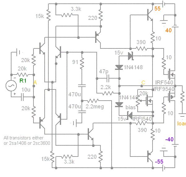

Hi subwo1,
Like jam I think your input collector resistors are higher than usual. This slows base recovery in the Q3-Q7 VAS stages. Stable yes - accurate no, with the additional potential for output stage cross conduction during party time.
A propagation delay of say 1uS is nothing to worry about when an amplifier load is a resistor, but when a real world loudspeaker becomes energised and produces back emf from output that has gone before but is no longer current - say 1Vrms at 10kHz - then the output terminal can shift by almost 100mV before the NFB loop takes control. This sudden shift is much worse than 0.1% distortion from an old valve amp. and why different amps can appear equally good when tested with steady state sine-waves on the test bench, yet sound so different when auditioned using real world loudspeakers.
Can I suggest some changes, maybe you could first simulate them, I do not have time.
Change R1 and R2 to 10k.
Change R16 and R19 to 1.5k as in jam's design.
Remove/short out R3, R4 and R6.
Connect two 10pF capacitors in series between Q2 base and Q7 collector.
Connect a 1k resistor between the capacitor mid point and the 'speaker out' line.
Do the sam in the other Q5 and Q3 half to maintain symmetry.
Reduce C5 to 22pF.
Does that help ?
Cheers for now ............ Graham.

Thanks, all for the comment.
As for the transistor counting (almost the same as full differential), actually I dont really realize this (until now). The design main goal is to use only single diffential, and pushpull VAS. As the component number, just happens as it is.
Graham, I dont understand, where can I put the LED?
FYI, this design is not made by me. Other enthusiast made it for SIM. What I made in real have more differential current (I use 4mA), the transistors are indeed 5550 pairs, The VAS is running at 20mA, BD139 pairs (with heatsink), the outputs are triple darlington, not mosfets.
Just dont have drawings of what I have made, but I want to participate in this thread, so I submit this picture (to give major design idea).

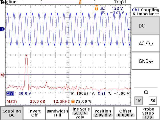

Here's an actual scope capture of the tube portion of the hybrid prototype reproducing 20 Khz at about 130Vp-p using the voltage doubler and tripler as I described in my last post. And the offset only is shifting 20mV from a zero signal condition and is also nearly insensitive to changes in supply mains voltages. This circuit has only about 6db of AC loop feedback as tested.
Here's the circuit's impression of a 100Khz square wave at just under 30Vp-p indicating its wide small signal bandwidth and balanced transition performance. The slight fuzz is due to test bench supply ripple what with those simple capacitor input supplies which I will change to CLC Pi filters in the actual amp. I expect the slewing characteristics to degrade somewhat when I add power mosfets to it, but hopefully not too much!
