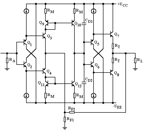

Good question. You could use a j-fet cascode but they are not available in higher voltages so bipolars offer more flexibility when higher rails are required.
Here is a variant with j-fet cascodes. Mosfets can be used as cascodes as well if you are so inclined. The j-fet version is nifty, because j-fets are depletion mode devices and can be made to self bias and eliminating the biasing circuit. I hope this answers your question.
Current sources are highly recommended. At least the circuit is not quite as sensitive to power supply fluctuations because the folded cascode (?) helps to stabilizze the operating point of the VAS and reduce the tendency of the VAS current to vary. But I do wish to purchase some of those CR470 type diodes. I like to use as few parts as possible since I will probably wire the whole amp p2p.

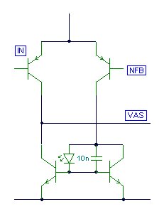

Cascodes And Ccs...
I wondering too how it would affect the differential pair in comparison with a CCS or just a resistor.
Some says that a resistor gives a poor PRSS, ok we fix it with a voltage regulator referenced to GND or whatever! What now....
I suspect the difference between a resistor and a CCS gives a diffrent distorsion with respect to 2:nd and 3:rd overtones etc.
Don't have the equipment to find out but maybe someone perhaps has the answer?
Diff pair with CCS cancels out 2:nd, something to go figure on...
Subwo1,
Please let us know how the design turns out, you might want to build a prototype, circuit boards even.
All,
I am working on changes to the topology I presented (current feedback ) and want to see how far I can improve it.
I hope that everyone that submits a design shares their results. I would like to thank Graham, Subwo1,Thoriated, Lumanauw and everyone that has contributed designs and ideas. The Citation redo looks promising and I hope a schematic gets posted soon. (hint! hint! Millwood)

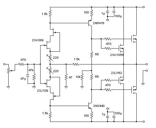

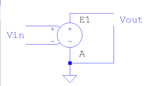

Oh, I think the schematic says it all. Some will not like it since
it adds no fancy colouring to the sound, some because it has
no feedback, some because it doesn't even need a PSU we
can argue over. Most will not like it since such a device does
not exist in the real world, but otherwise it seem to be both the
optimal and simplest topology.
(It was posted as a joke, of course, in case somebody missed
that.)
I also like the Mosquito amp, judging purely from the schematic
and my limited knowledge, largely becuause it has a kind
of simple and elegant straightforwardness to it. One thing that
bothers me somewhat, though, is the high value of the source
resistors for the input buffer. I don't quite know what typical
value one will end up setting the pots to, but since they are
200 Ohm ones, I suppose they should be expected to not to
be set very low at least. This would cause the output impedance
of the input buffer to be somewhat on the high side to achieve
"true CFB", but maybe that is even a delibarate design decision
that is supposed to have some advantage? I haven't come up
with any obvious way to fix it though, without modifying the
whole buffer topology. Maybe one could run the JFETs close
to IDSS and use very low Rs values and, if necessary, adjust
the cascode collector loads to compensate for this, but I haven't
tried to dive deep into this issue. Maybe getting rid of the source
resistors alltogether and provide some other means for adjusting
the OPS bias might be a better solution, but once again, it would
increase the complexity. One can also swap the whole
input buffer for a BJT diamond buffer, but some of the elegance
is undoubtely lost then. As a minor thing, I guess it wouldn't
hurt to upgrade the VAS transistors to something more modern
and better.
and better.
Christer,
J-fets lend themselves to simplicity..............like you said elegant, but I am also working on a version using mosfets............bipolars have too much drift due to base currents.......................and the rules say no servos!
......but to make you happy, you may try this.........

I ran the simulations comparing the resistor with the CCS for distortion. I did not see any difference when the power supplies are rock solid. I am not experienced with all the fancy ways to introduce noise into the circuits. However, I am now convinced that the CCS is worth the trouble since it isolates the emitters of the differential input stage from the noise on the power supply rails as Ultima Thule and thanh know.

Subwo1, since you have removed the big input resistor now, is it possible that in your old design, the big input resistor+transistor's internal capacitance produces a LPF so by putting this big resistor your cct doesnt oscilate?
About R VS CCS for feeding differential. Many argued about this, up to now no one can tell which is better. For myself, R loading (but bootstaped with C between 2 half R) gives more pleasant sound, compared to CCS. CCS certainly more acurate, but after the amp is finished, the R loading seems to have more nice sound. But still I cannot put this R loading in my own design. Some designs just HAVE to use CCS. Incase of Subwo1's amp, it can use R loading. But my design have to use CCS, otherwise the DC offset will run crazy.
Graham, your explenation is good, but since I'm an amateur I dont get it all. Why is that this feed forward cap between Q2 base is always have to be connected to Q7 collector? In my experience indeed if we change it to Q3 collector it PRODUCES oscilation. My experiment fits your explenation. But looking at the schematic, both halves, up and down half, are really identical, why should it always attached to upper colector?

It should say,"it is still not very solid"(in stability).The feed forward type capacitive divider does further enhance stability, but it is still very solid.
