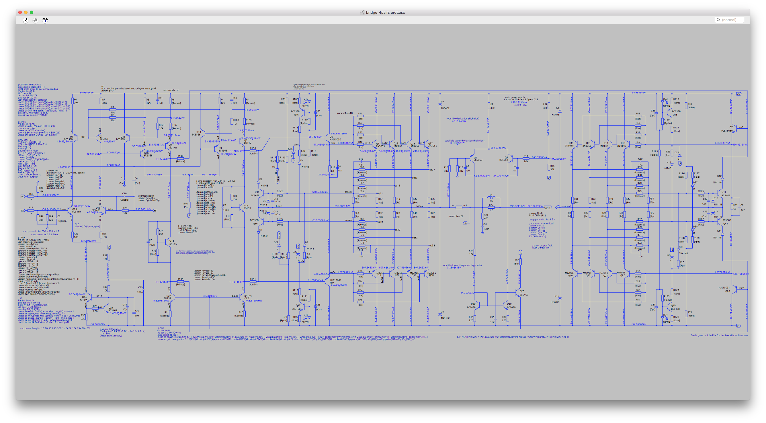

Not too awfully long ago, I built up a simple 2N3055 amplifier running off +/-32V. Powered by a 22-0-22 650 VA toroid meant to power 12 gainclones simultaneously. Simple diff pair, single ended VAS with a 6 mA current source, and the same output triple used in the Phase Linear, with 3 actual 2N3055’s per bank. It had absolutely no trouble with a 2 ohm load - that is, 4 speakers in parallel, turned up to abusive levels. I really don’t think you’ll need to go to 5 transistors per bank.
Those 3055s are pretty robust, as long as we make sure they're not taken too far.
A 3 pairs version of the grounded bridge probably would be fine on an 8ohms load, if it's not an overly difficult one, like electrostatic speakers of whatever.
I'm aiming for the 4 pairs version, so it can be bullet proof, as much as possible, with all the protections we can come up with: VI limiter, input limiter/compression, thermal sensing, DC detection, output and input muting, SSRs for rails and amp output. I think there might be a good reason to use a micro-controller to handle all those things and do proper power-up and shutdown, as well as handling faults, in a proper sequence.

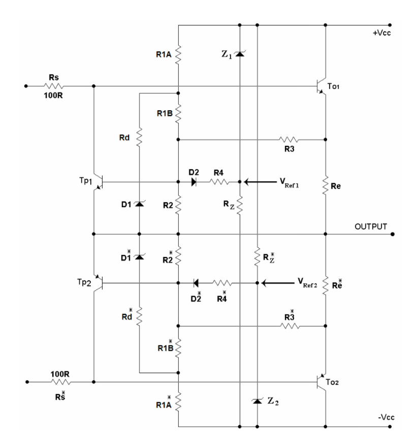

Here it is, the latest 3055 grounded bridge sim with the VI limiter reconnected.
Don't pay attention to the values for everything in the limiter, as nothing has been calculated yet, including the zener choices. Although the current sources I put on them should work as they are now..
The overall scheme for the limiter is basically the 3 slopes from M.K, attached, except that I put the zeners on current sources, which shouldn't change anything to the calculations for the limiter itself.
I think this time it's going to work, with both sides of the bridge having its own limiter. It wouldn't work before, because I was trying only on the high side.
If someone wanted at some point to build this using other trannies than the 3055/2955, there may be a few things to adjust if the rails are higher, and then the limiter would require recalculation of course. But this could be done.

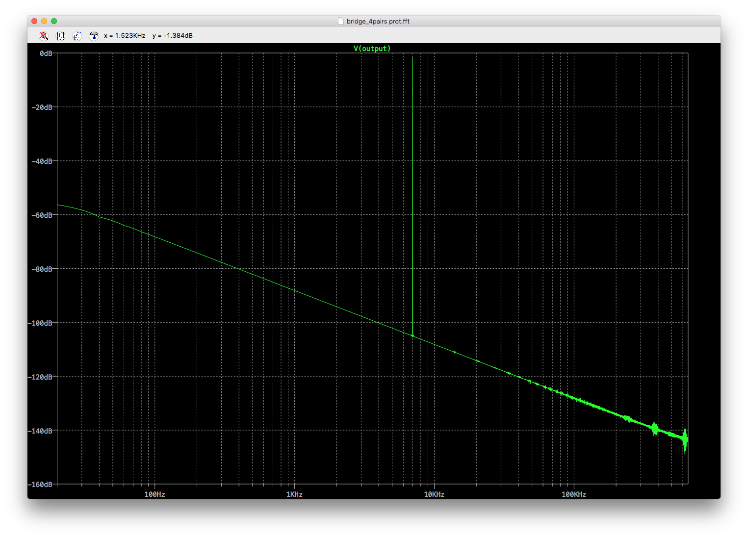

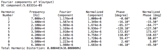

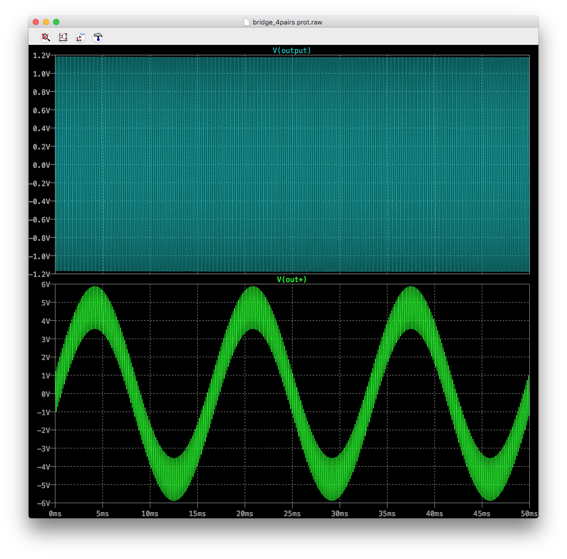

3055 bridge SMPTE IMD
Here is a sim I just ran with the limiter re-connected, although no values have been calculated, they've been made to prevent it from acting on legit signal, so it's not bothering anything and I can get a normal result.
This is a sim for IMD using the SMPTE method, with the 60hz/7k at 4:1, and adding a 60hz notch filter at the output to get a clean FFT view.
Looks pretty good to me.
If I'm doing something wrong, please don't hesitate to croak please :)

Hi spookydd,
Here's a pdf of your desired VI limiter (MK's Fig. 44), with standard component values inserted. I'll post the full range of spreadsheets to your address, now that I have it.
Brian.
