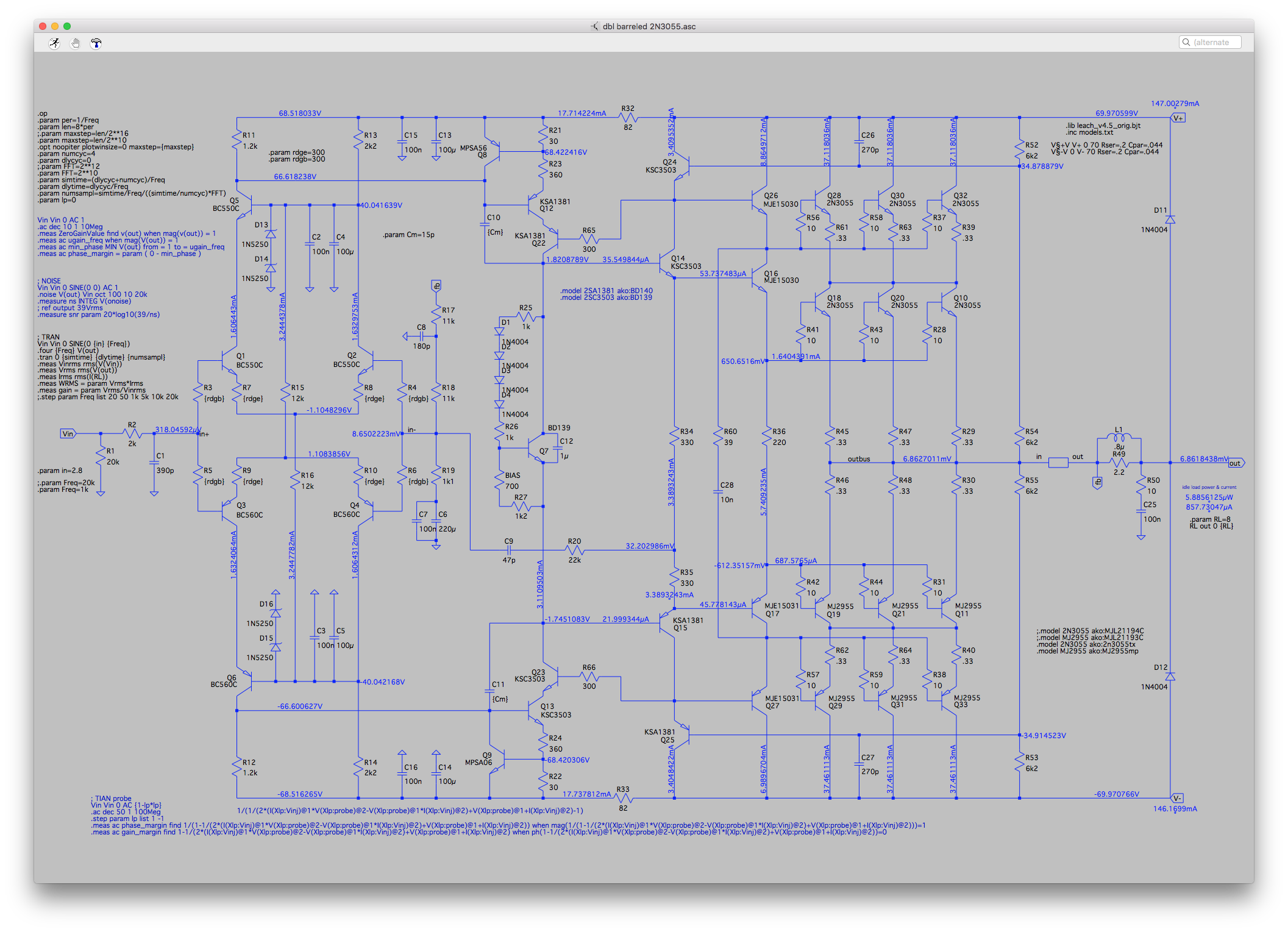

I did some simulations a few years back of the super leach with 3055s, and made that work.
Maybe to speed up a development process there is no need to reinvent the wheel and make use as is of a good pcb layout that someone must've done already.
The only thing needing some calculations would be the VI limiter to be tailored to the 3055 situation.

Here is a snapshot of that leach super amp 3055 based sim that I did long ago.
As with any leach amp sim, it doesn't simulate totally well, with some issues and thd performance isn't stellar. But that's how the leach amp simulates anyway, so this should be a working amp to build.

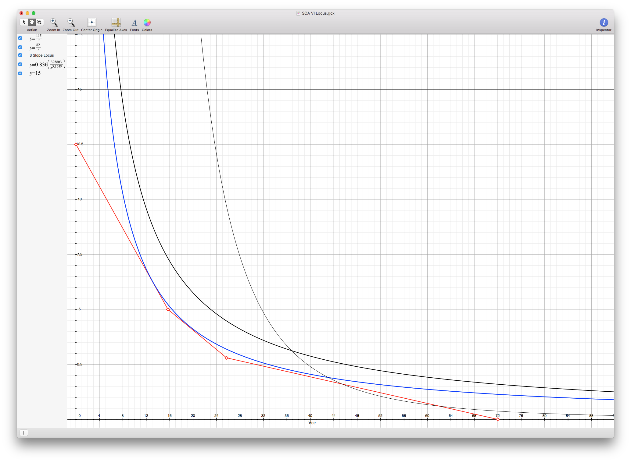

but how to derate that? Anyone can offer some insight?
The low segment of the locus may have to be moved slightly down to accommodate for the second breakdown..
Is this of some help?
General form equation for the Ic/Vce log-log gradient is Ic=k(Vce)^n
where
n = (logy1-logy2)/(logx1-logx2)
k = y1/(x1)^n
For a 2N3055, by inspection from the log-log SOAR graph, the second breakdown segment has co-ordinates x1,y1 at 40V, 2.88 A and x2,y2 at 60V,0.8A respectively.
Thus k=325803 and n = -3.1549
So Ic = 325803*Vce^(-3.1549) at 25C.
I’ve seen data that extrapolates the Tjmax for second breakdown of a TO3 device as around 330C, so the de-rating factor at 75C becomes 0.836 (ie (330-75)/(330-25)).
So Ic = 0.836*325803*Vce^(-3.1549) at 75C. (ie y = 0.836*325803/(x^3.1549)

As an aside, an explanation for the other curves might be useful to some.
The thermal gradient usually follows the law Power(P) = Vce*Ic, so Ic = P/Vce.
(thus P=Vce^-1, so from above k = P and n = -1).
In this case (2N3055) P=115W, so Ic = 115/Vce or y=115/x, as displayed.
The temperature de-rating factor is (Tjmax-Tcθ)/(Tjmax-Tc25), if θ is >25.
Tjmax = 200C for a TO3 device thermal gradient, and here θ is taken as 75C so the factor becomes (200-75)/(200-25) = 0.714.
The de-rated power thus becomes 0.714*115W, or 82.11W at 75C

I discovered just a few days ago that I had that little "grapher" utility that can plot curves and that's what I used for the plots I shared earlier.
I was thinking about excel, but although I use it for many common things, doing such plotting with it isn't familiar to me enough yet.
What else to use?

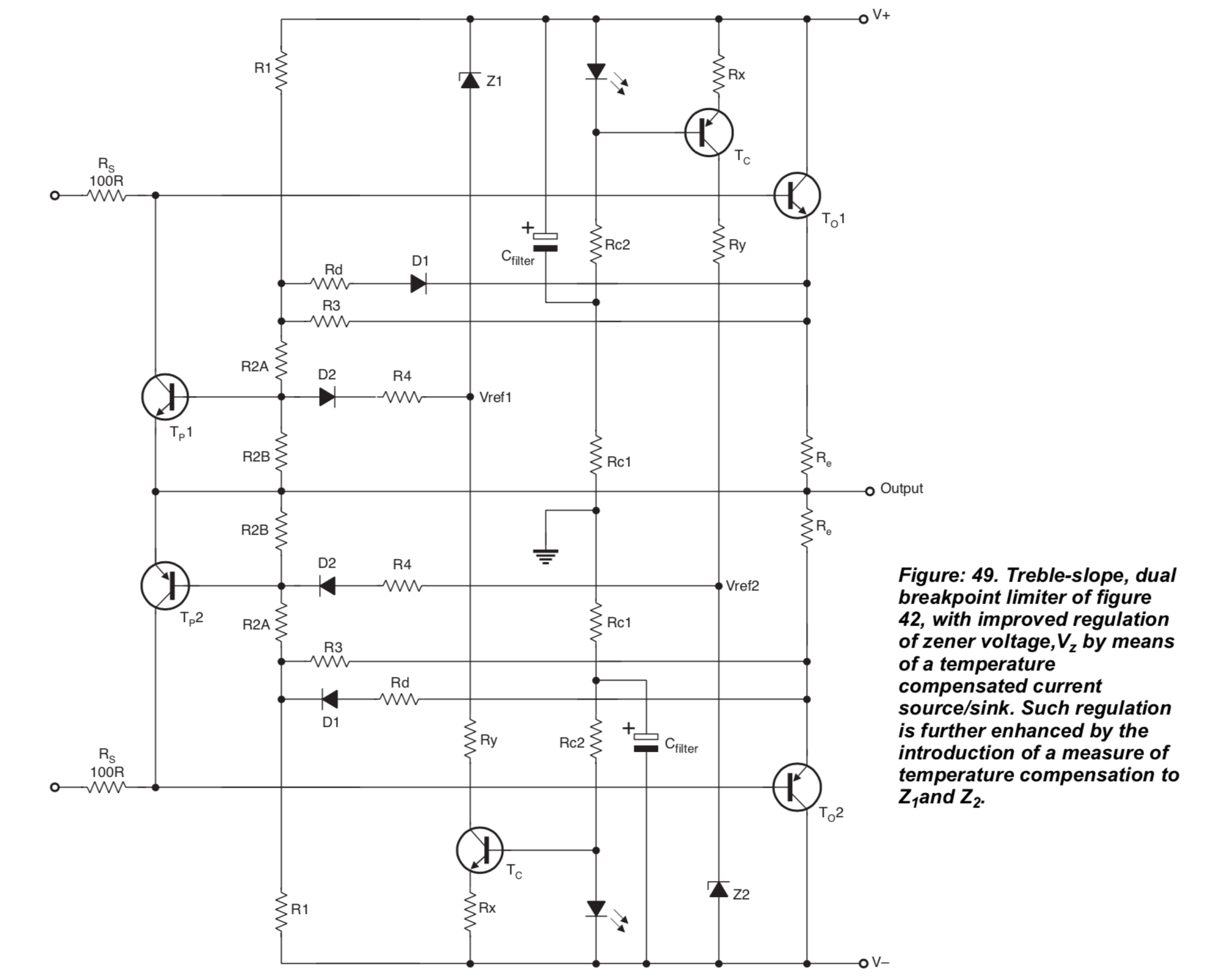

By the way, long ago, you mentioned having built a spreadsheet, based on M. Kiwanuka's VI paper, to calculate limiters. Was that shared somewhere?
Does it calculate the values? For which limiter type? (slopes...)
I'd like to calculate the values for a limiter such as the one attached here:
It turns out it's a pain to use that grapher utility. It's not much of a calculator, although it does plot the curves from equations and tables of values.
It allows defining limits for the axes, but then it doesn't obey that in the display.
When we add text annotations and place them on the plot, they disappear when the file is reloaded later, and whatever happens to remain isn't where we had placed it.
Too much trouble. So what to use instead?
I'm posting what I'm trying to do now, but it's not complete and many things, like text annotations have disappeared, again, and it's been impossible to get the axes limits displayed properly, it doesn't use what we set and does whatever it wants.

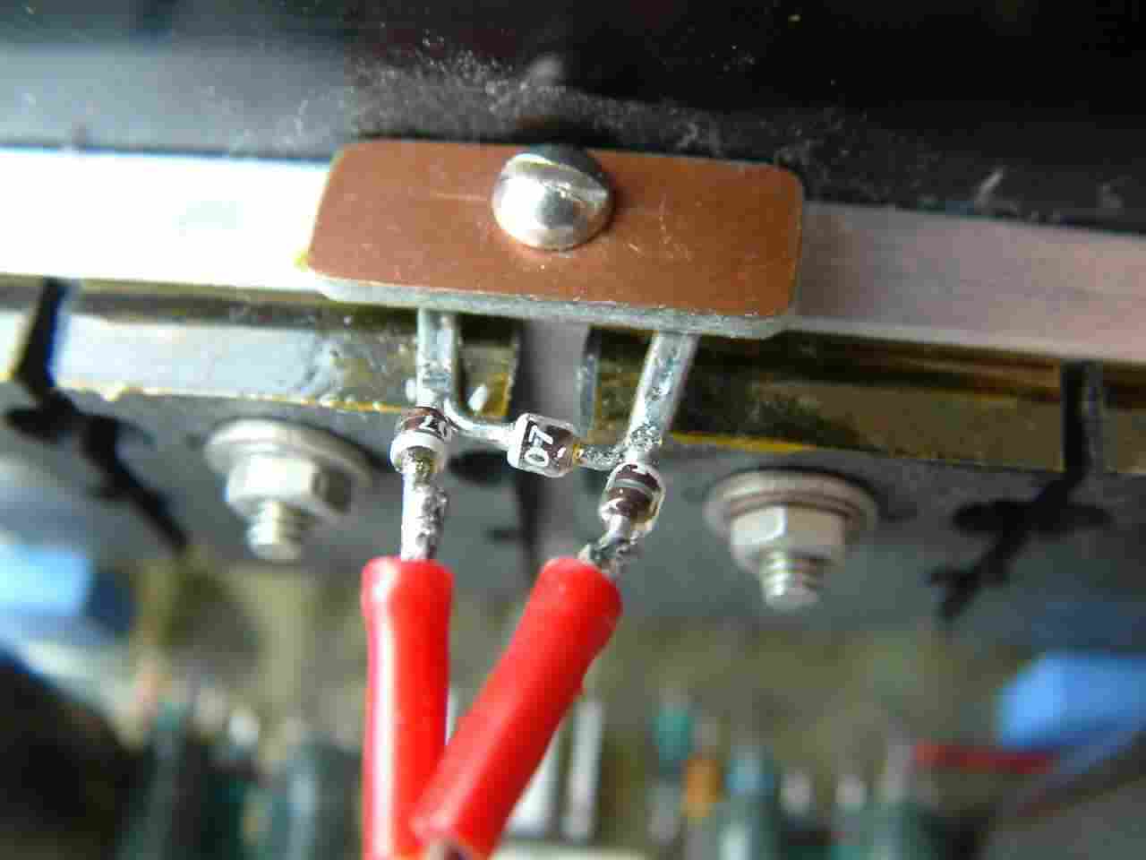

With the super-amp topology I had envisioned using four heat sinks per channel, each with 3 TO-3’s and a TO-220. Non isolated, and mounted directly to the PCB. Why? I already have said heat sinks, pre drilled, and PCB mountable. When doing that, you must separately compensate the Vbe’s because they may not track temperature perfectly. The Leach vbe multiplier with diodes in it works well for that with two diodes (or diode connected BD139’s) on each master heat sink. The slaves don’t need compensation. Put an insulator spacer between the boards, heat sink to heat sink, and clam shell them together soldier side out. Force air thru the center. Have the fan run on low all the time and increase speed at some temp, say 60C.
Would anyone have in pdf the article from M. Kiwanuka that was published way back in the september 2002 electronics world?
I know this is very old stuff. I have the article from the next issue, but I'd like to get the previous one.
The amended article is available at Bonsai's site, but I've attached the original. Note that his triple slope arrangement in the original, Fig 42,the one you are interested in, has been superseded by Fig 44.
Why not? If you have the stuff already, better use it than buy new stuff ;-)
How do you plan on making the diodes make good contact with the sink? With holes through them like some did who made the leach?
Maybe there are usable diodes in a TO126 case that could be used instead, making far better contact and making the assembly easier and more straightforward. No need for extra drilling and making plastic round diode case make thermal contact with a sink...
BD139 transistor with the base shorted to collector. Easy mounting, no insulator, no muss no fuss. It’s too bad the TO-126 case is going away. The 139/140 pair will probably be the last hold out before it’s finally obsoleted. Most of them are already gone. There’s always the fully insulated TO-220, but most of those have a bit too large a die in them. You don’t really need or want a 10 amp diode - not enough drop and it will end up being overcompensated.

I like that better than the diodes. The thermal sensing can only be much better that way, and the mounting so much easier and more secure.

Anyway, I was looking for the article published in the september 2002 electronics world, because having read the next one in the october issue, which is the continuation, I found it more elaborate than this full paper in pdf.
The october article is going more into details for the more complex limiters, with more calculation examples done, so I assume the first part would also be a little more explanatory..

But the bias diodes are still there. I thought maybe we had replaced them with something else, but I was mistaken.
Still, I guess there should be no problem doing that, using bd139 as diodes. The amp has 4 bias diodes, the same number as your planned heatsinks, so no problem there.
I found that only three diodes were needed on my Leach. I mounted them with four leads clamped directly to the heatsink, via a Kapton tape insulator, as shown.
Try a not very scientific test to see why:
Hold the diode body between thumb and finger. Apply a hot soldering iron bit to the lead. Time your “ouch, better drop it” response as the body (and fingers) heats up. Now do the same but hold the opposite lead instead of the body. Betcha drop it sooner!
There are thus three PN junctions that respond much faster to the heatsink temperature change than does the glass or resin diode bodies. It probably responds better than any clamped TO126, unless perhaps the collector lead is clamped?
Bonsai’s site carries the latest revision of Michael Kiwanuka’s (MK) article, as far as I am aware.
I’ll have to check the contents of the spreadsheet I sent you; it may not be complete, from the sounds of it. I’ll post a more detailed version, calculated for your device
I derived spreadsheets for all the VI limiters and plotted them onto the Vce/Ic graph in Excel. I used MK’s method of analysis to derive general form equations to determine limiter device values that modify instantly the plotted VI locus as they are varied.
Wow! So that means you're sensing the heat from the sink via the leads and not the diodes' bodies. The length of those leads must be important, affecting the response delay.
What bothers me with using diodes is that flimsy mechanical mounting system.
So that makes the one you sent a prior version. Always good to have anyway.
Sounds awesome!
If several limiters are calculated, we can compare them as well. And this could help decide which to choose...
Sometimes it may not be a clear benefit to use a 3 slopes instead of a 2, or single.
The leads protrude merely to show them. They fit snugly against the H/S, with almost their full length clamped. In addition the sleeving covers the leads and body, reducing heat loss and improving rigidity
MK suggests that a three slope is overkill for rails below 40V. I've found that, depending on the Vce/Ic curve, single can be good enough, particularly when multiple OP's are used
