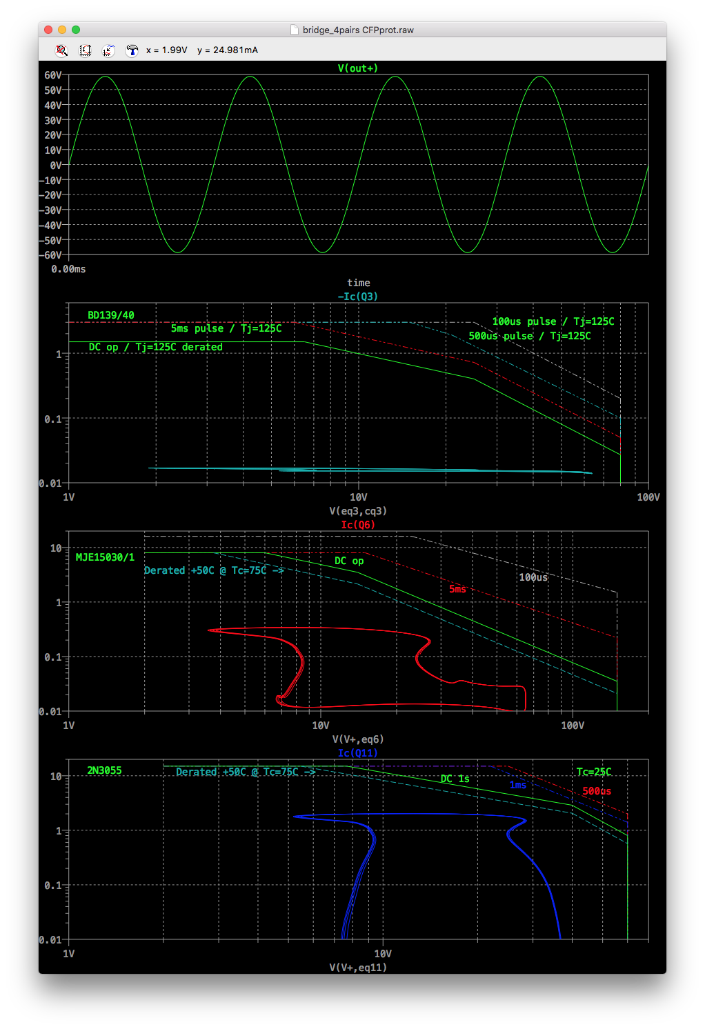

With +/-30 volt rails (using the spec max vceo) you need to dissipate 112.5 watts instantaneously driving a 2 ohm resistor. Half way up the rail the dissipated power peaks going down on either side. This is for a tiny fraction of a cycle, and for practical purposes the 10 millisecond SOA can be used. This could be handled by a single transistor, and certainly by two. Reactive loads are worse by a factor of two in practice, making the requirement 225 watts. If you are derating the devices to 80 watts you only need three. Why only double and not quadruple? Real speakers rarely go reactive by more than about 60 degrees. If they do there is something wrong with them. This requires half the peak current (7.5A) at the full rail voltage (30V). Any current drawn at more than the full rail voltage gets progressively shorter in duration and are not usually going to drive failures. Failures will usually come from relaxing SOA protection to allow this 60 degree condition without activating, and then attempting to drive a short. Which allows this condition to persist for entire half cycles at a time, not just the couple of milliseconds that it does when driving an elliptical load line. This results in not only the max instantaneous dissipation, but a high average power which heats the heatsink up much more than driving the speaker does. This is how Phase Linears blow out - the SOA is insufficient at Vce=75V. But it takes enough persistence at these conditions to heat it up before it does blow. Won’t go out with a cold heat sink - which is why they can do the scewdriver test in the lab and get away with it but subject it to mobile disco use and you take your life in your hands if you stand too close to it. Putting in MJ15024’s went a long way toward making them reliable but what really helped was a FAN and MJ15024’s.
I don't think we need to debate more about how many pairs we need to go for and how to place a protection locus.
This amp with 4 pairs can handle any "normal" load, even reactive, and still have enough SOA headroom, so the current locus chosen makes it transparent on a "normal" 8ohms resistive load.
And on a reactive load, things don't get that much more scary, as seen on those attachments, I just ran it on 8ohms with 11uF in parallel, at about 215Wrms ouput, and it's doing just fine.
Things get a little less tidy when dropping the load to 4ohms, but I'm talking a 4ohms load on a bridge, so each side sees 2ohms, and even then, we're still not going over SOA. The chosen protection locus does make it start to act a little before reaching full power when the load is 4ohms, reactive or not, so it's not fully transparent then, but that's only a little before full power, so anything below that goes through just fine without limiter interference.
The only issue is when things get far more freaky, like a 2ohms load on the bridge, that's just 1ohms load for each side, nasty. And on a dead short on the output. Then at some frequencies, the limiter isn't acting quite hard enough to keep it 100% SOA safe. That's my main worry and I'm counting on having a sufficient input limiter to work in coordination with the vi limiter, which should keep it more within the SOA.
And if a dead short condition, or perhaps even an overly low load impedance could be detected as such, then an output SSR relay could be tripped, hoping the short to be beyond that and not inside the amp (very unlikely), so the relay tripping would remove the short and things are handled.
Now temperature sensors should also be on the heatsink(s), and be acted upon to keep things under control and prevent a disaster.

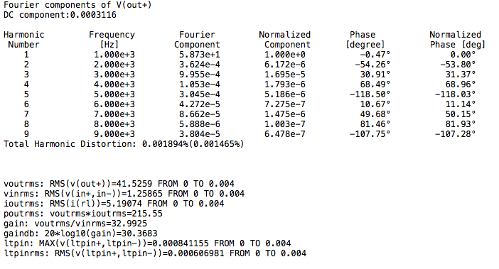

I have simulated a 5 pair version, and that may be the better way to go for those who want to bridge the bridge, even though 4pairs look like sufficient even for that.

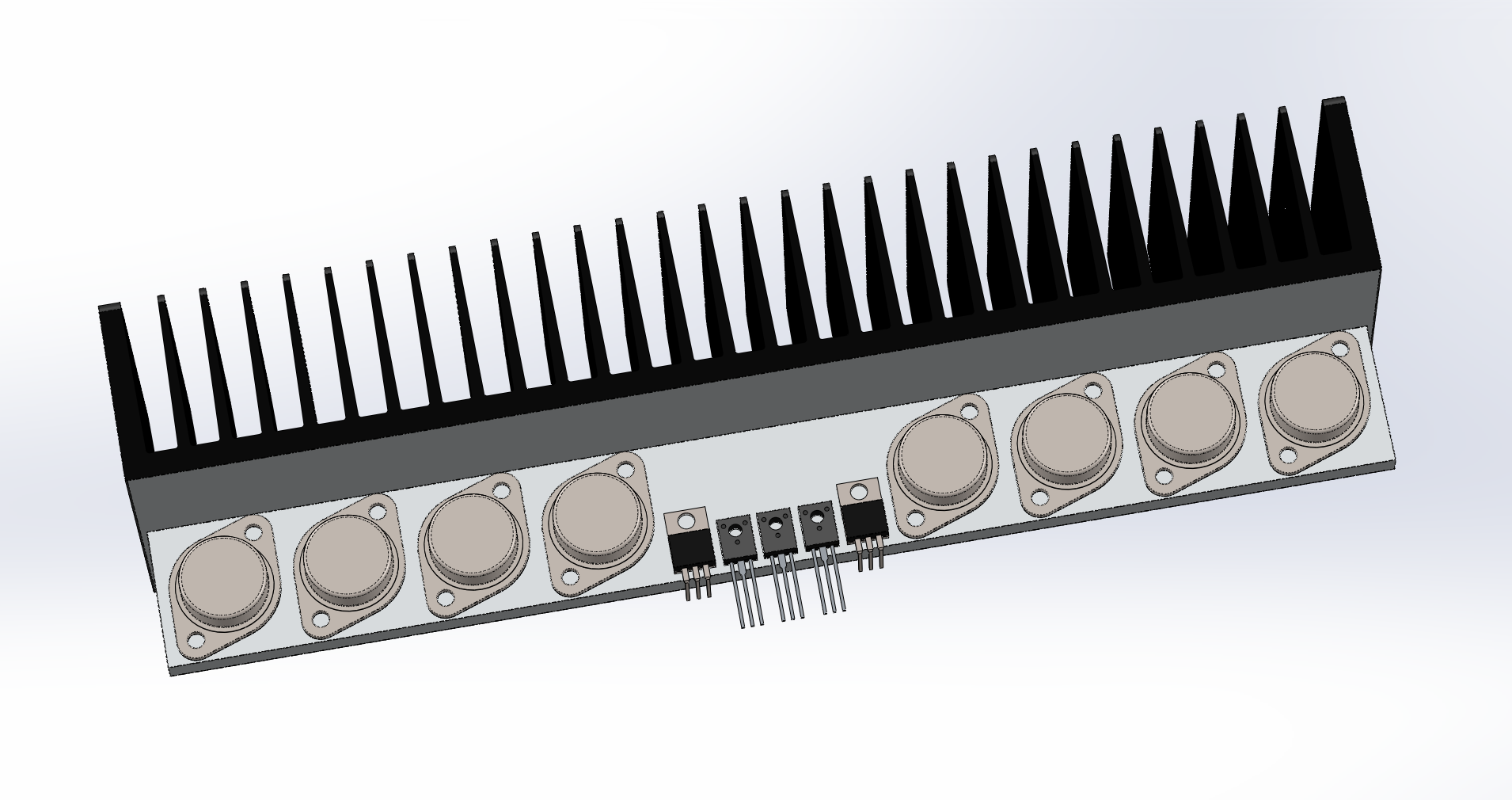

One thing to keep in mind, is how many TO3s are to be heatsinked. With 4pairs, we have 8 TO3s per side, for 16 total to heatsink, so that's a fair amount of heatsink real estate.
With so many TO3s to cool, I think it's best to use 2 heatsinks, with 8 TO3s on each. At least one thermal sensor per sink should be used.
We can always go for even more silicon, with perhaps a 6pairs version, but that's getting pretty damn big and I'm not even sure a good heatsink large enough could be found.
This is the kind of heatsink I've had in mind for those amps:
Conrad Heatsinks - Products
Their largest one has enough room on the flange for 8 TO3s, so 2 of them looks like a workable solution. This can be "shaped" into a monoblock amp, with one large PCB with everything on it, to minimize external wiring and keeping things tidy.

I dug out an older drawing that I made to check how much room there was on the conrad type of single flanged heatsink.
A couple of years back, I experimented with various heatsinking possibilities, for the grounded bridge and others.
This drawing shows how 8 TO3s can easily fit on that sink, along with drivers, pre-drivers and a bias sensor.
Now it might be a better idea to mount the bias sensor right on top of one of the TO3s, to speed up its sensing abilities. There is plenty of room for that much, so with 2 such sinks, the grounded bridge would be fine.
For maximum dissipation, it's probably best to use their largest model, and that's more than enough, with 2 of them, to fit everything, probably even for a 5pairs version of the bridge.
With thermal sensors on each sink, at the very least, there is no need for fans or whatever forced cooling.
Maybe a thermal sensing with 2 levels might be good, with action on a 1st level being only some input drive compression, and the highest level being the panic mode one, which would trip the output relay.
