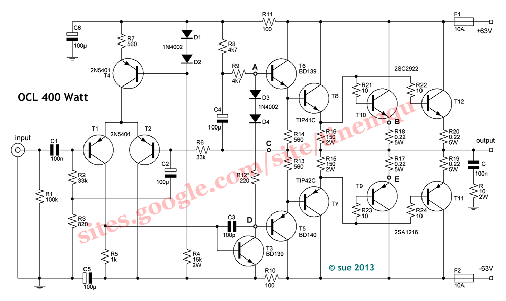

you mean like this one???
i've just open google and found it...
Very similar, few changes, but all different devices, and one extra stage was added. But then it's definitely no longer like a 3055 amp.
Even if you used the MJ15015/16 instead of the 3055s, it would still be very much like a 3055 amp, as those are almost the same.
This one is so similar to what you got, maybe it could be possible to alter the one you have to bring it up to be like this one, but all devices are to be changed anyway.
I wonder how you could add the extra stage though,with the pcb being already made for everything on the board. Not easy to do. Could get messy.
I just wonder how available the parts are where you are. The 3055s are obviously abundant. But what about the MJ15015/16 for example? Cheap enough, if available?
I didn't look closely enough earlier, but this one has the same kind of issue as the one you have.
Although it's not 3055 based, they state a 63V rail, which would push the BD139/40, as well as the TIP41C/42C beyond they breakdown limits.
And I don't know those japanese outputs, but the same may hold true for them as well.
A better choice of parts would be preferable to be free of worries.
I think I'll simulate this one though, I wonder what it can do. And for 400W, it's obviously for 4ohms load, and 2 pairs may be a stretch for their SOA.
