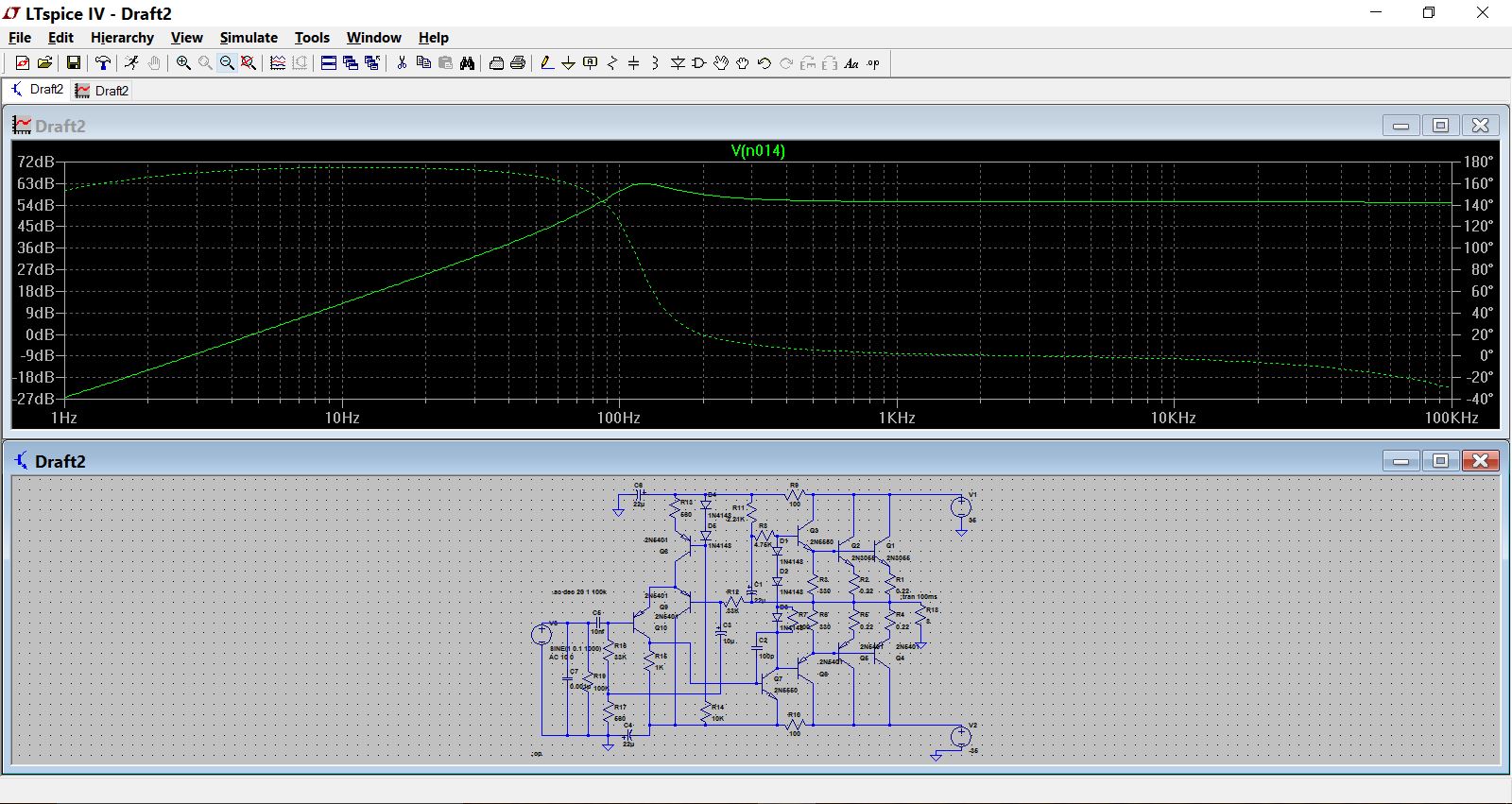

A quick look at that sim and I question a few things.
First that cap shunting the input right there before anything else, with no R to make it a filter. We can't even know what the cutoff frequency is.
Next that C5 blocking cap is only 10n, and with about 33k after it, that cutoff frequency is below 500hz. So I don't even see how full range audio could pass through.
One other thing is the 2N3055 is only TO3 case, while the MJE2955 is only TO220, so that's more than odd, and I don't see this being built for real as is.
No output filter?
No cap on global feedback?

The bootstrapping on fandi's amp gives it an odd LF response.
There you go :)
It doesn't take much to realize some details are wrong and values need adjustments.
It must sound "weird" as is. At least the bass level must be way off, and even sound weak.
That cap at the input can't be right.
I understand using different models in sims if you don't have the right ones on hand, but a real build obviously couldn't be done that way (mixing TO3s with TO220s for example).
I wonder what a tian probe would reveal, with no output coil/zobel, and no global feedback?
The cap at the input does look a bit on the low side, however it appears that the input resistor R18 is in fact bootstrapped using the 680R negative feedback resistor R17 (referring to Mooley's "draft 2" schematic above).... This makes the input impedance considerably higher that it seems at first glance. So that value probably quite in order!

Your simulation file uses a 10nf for the input cap. The diagrams in post #620 show a 100nf which would be like this:

This is from the manufacturer...
After turning on for some days, i don't get good sound
So i call my friend(using same amplifier but with some modification) then testing it
After some time, we make some decisions
But i.have another idea based on my experience
Not changing too many components, but just little that can give better.result
That's the story why my LTSpice is so different from mufacturer

LTspice will be different on things like bias current and DC offset, because those things depend so much on the actual transistors used.
The overall frequency response should be pretty accurate in simulation though, no matter what devices you use.
