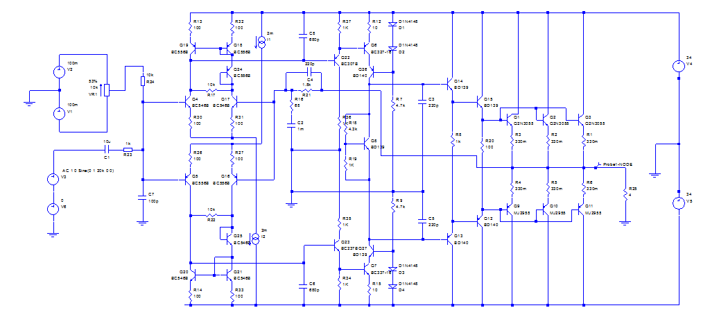

Amplifier based on 2N3055
Like this? But, I do not optimize this design. I sim it for fun, because I found spice model for those transistors.

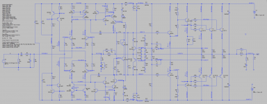

I couldn't run that sim as is, because of missing models. I changed diodes to the 4148 available in ltspsice and looked for others like the bd139/40 and that zener.
I ran the sim with those but I don't find the same low thd. Perhaps because of the models.
I'm posting back the sim with the added models and a log.
Perhaps there are some ideas here to use for the project. I am wondering if using those regulators on the rails for the front end is worth the bunch of extra parts. Anyone can comment on that?
It's amazing how this one can reach 100khz with such low thd... How is that possible?

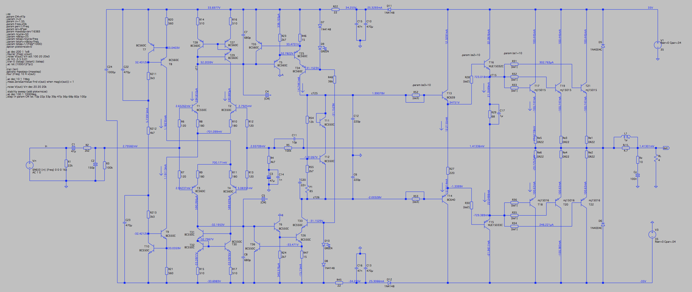

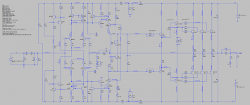

I'm still trying to stabilize the complementary triple now. I had it oscillation free at some point and the thd was down below 0.001% at 1khz on 4 ohms load. So it should work, but for some reason it oscillates again and I couldn't stop that.
What I have now is a tiny and very high frequency oscillation, and the thd isn't really that bad at 0.062369% at 20khz despite that. I'm posting this now.
I'm using the MJ15015/6 models. I put snubbers on the drivers' bases and they have base stoppers.
One thing that brought a huge improvement was to switch to the higher beta small signals (BC550C/60C), so this is a simple and dirt cheap thing to do for better results. Some values had to be changed with that, so then the choice of parts is important at the time to build. All parts should really be matched the best possible when building.

To achieve low distortion in high frequency, we must use advanced compensation like TMC, TPC, etc.
This link, Super TIS is very interisting.
I looked at that super tis stuff before, but this looks rather complex for the average diyer.
I have been trying to figure out a simple way to add a cascode on the diff amps, without adding too much complexity. This seems like one good way to increase gain and bandwidth, and for higher rails amps, it can allow using higher gain small signal transistors on the diff amps, while allowing those high voltage rails.
My simulations, although not very advanced (I'm still a newbie), have shown how much can be gained by using those high beta small signals transistors, and there aren't any that are really high gain with high vce0 at the same time.
This won't be an issue on the current 3055 amp project, but perhaps the other advantages of the cascoding could be useful, as long as we only add a few cheap parts as we do it with current mirrors for example, but without adding overly complex calculations.
One other thing that bothers me is the fact that it's hard to find designs that are fully stable without any compensation, and I hate to see so many compensation caps all over the place.
I was able to stabilize that simulation with the outputs replaced with the MJ15015/6 models, but not without too many compensation caps and a snubber on the drivers. And once stabilized, the performance isn't really there as much as it could've been, with overly high thd at high frequencies.
I'm afraid that with such an unstable design to begin with, that requires such tricky compensations throughout, once we add the other considerations from the pcb and other building issues, there would be additional sources for instability from a bad pcb layout and other wiring, so such a difficult to build amp by a diyer wouldn't be worth the attempt.
I really want to make sure we make something that bullet proof and that can be built easily by anyone without much experience. For one thing, the pcb design will require some serious scrutiny to make sure it's done right and with all the proper optimizations and precautions so there are no chances for instability and that the amp can be built with the minimum amount of precaution, perhaps just making sure the parts are properly matched.
Can anyone suggest a good and simple way to cascode the diff amp stages? On top of the current mirrors. I think high beta and low noise parts like the bc550C/60C could be nice, and then the higher voltage ones could be lower gain types like the 2N5401/5551 or mpsa42/92...
Having simulated this 3055 amp with added current mirrors, 2 transistors vas plus cascode, followed by a triple output stage, I can see that we can achieve a very decent amp, with very low thd, despite making use of old style parts like the 3055/2955. The only thing that I'm now trying to reach is better stability and lower thd at high frequencies. The thd at 1khz is outstanding already, as I was able to reach below 0.0008% at full rated power of 50W on 8ohms. The 4 ohms thd is a bit higher but still very respectable and would likely get even better if the higher frequencies thd was under better control.
If I get this right, the high frequencies thd is high because of insufficient slew rate, so I'm thinking we can help this with the use of cascoded diff amps. We could increase the input stage's gain, which would allow more degeneration and the slew rate would get better. Am I wrong?

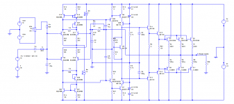

I took a MJ2955/2N3055 based Maplin 225WRMS amplifier and redesigned it with constant current sources and a current mirror and modern transistors.
The result was I cant tell the difference between the sound of the original Maplin amplifier and my own redesign !
Looks like they got it right the first time or my redesign is poor !

For a newbie the simplest method of stabilisation is to use Miller. I'd recommend, however, inclusive Miller feedback. Here is such a circuit based on the previous one. Changes are basically (1) delete the 680pF roll-off capacitors across the bases of the Darlington-cascode VAS stages (2) replace the emitter input resistors in the diff pairs by 330 ohms and (3) run the input stages at 6mA instead of 2 and (4) use 47pF inclusive Miller capacitors (taken from the output rail) to the bases of the VAS inputs.
The 220pF sprog-stoppers are still required. Is the input stage noisier? Yes, but I've never heard anything coming from hifi speakers with moderately high input bias currents. The design is very flexible, however, and if you want to keep 2mA bias you could use 1k emitter degen resistors. This is somewhat large and will increase distortion compared with 330 ohms. (but if you do this remember to reduce the Miller capacitors to 15pF). The whole point of having a critical upper frequency point set by the input stage is to prevent cut-off and severe transient intermodulation distortion.

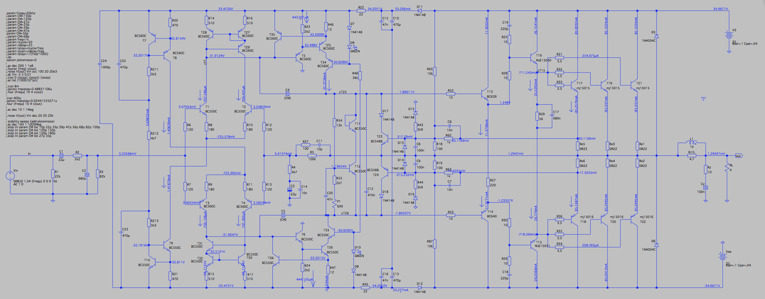

Alright, let's see how this compensation scheme would work on our design.

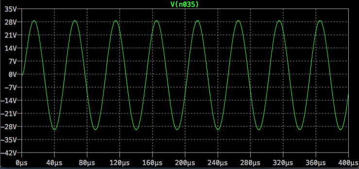

I disabled the millers and to make it clearer I deleted all the protections. I disabled a few other things and this simulation uses the MJ15015/6 instead of the 2N3055/MJ2955 for the complementary EF3.
This triple stage output is as standard as it can be, and perhaps there is something to do to the bias spreader.
However it is now stable and there is no apparent signs of oscillations. That is not unless we look at the signals on the diff amps output and inside the vas, but what I don't understand is how the signal can be so clean coming out of the vas when it's so uggly coming in???
I used the same values for the caps, but obviously this needs to be calculated for this setup.
Increasing the tail currents on the ltps beyond about 3mA is very uggly, the signal looks totally clipped at the top.
I embedded the models in the sim file, for convenience and to make sure the same ones are used when comparing. Most come from cordell's collection, plus some from onsemi and others.
The signal looks quite clean on the output, at about 20Vrms and I left the load at 4 ohms. The thd doesn't look so good, although at 20khz, it could be better.
Let's see how those different compensations can be adjusted to make this work better and take a look at an inclusive miller tapped from the output bus. Maybe we can also take a look at splitting the pre-drivers' 220ohms into 2 and tap an inner feedback from there as leach did it. I wonder how complex that is in calculations.
The slew rate increase would be good to reduce tim and the thd at high frequencies.

So although the excursion on the ltp stages isn't huge, I am wondering how close we come to the vce0 limits.

I'd like to see how this can work. Proper calculations required. I tried increasing that on my sims and beyond about 3mA it gets quite ugly and the thd climbs real fast well before we can see it.
The way I have it now the tail current's sweet spot is somewhere around 1mA, more or less.
There is no doubt the 550/560 can handle some more current. We're nowhere near their limits and we can't push them so hard as to think about dissipation issues. It's just that with the current setup my sims have shown an steep increase in thd when tail current goes up.
I "sim" your file. The THD is low enough. Why do you not build it? Sometime implementation is more difficult. If you get THD 2x or 3x than simulator, I think you success.
