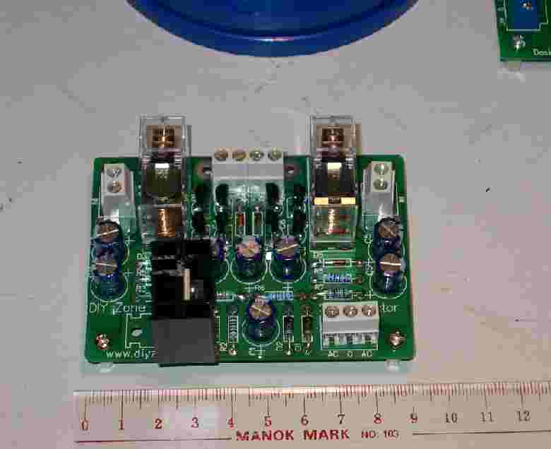

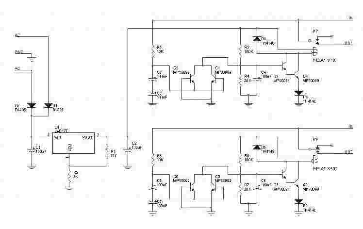

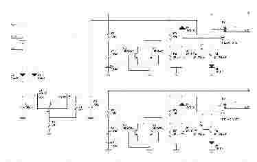

Yet another speaker protection circuit
I refer to Iceman's circuit. It is simple, and will do the job. However, it has one deficiency compared to Peter Daniels'. It may introduce crosstalk between the two channels as both output are connected through R6 and R7. Although Peter's circuit is very good, this is a bit too complicated to build.
I obtained this compromised version from DIY Zone from Taiwan:
http://www.diyzone.net
unfortunately, the site is in Chinese only.
The circuit is very simple: in essence, it is an isolated and duplicated Iceman circuit, plus a latch to keep the relay deenergized if DC is detected. The good thing is that the circuit operates independently, allowing one to identify the failed channel easily. The only draw back is you have to synchronise the time delay of the two channels by adjusting R3/R4 and R6/R7 combination.
I build two of these (from the PCB purcahsed from DIY Zone). The first one I spend hours adjusting the resistor combination, but thinking of it I don't think it's worth the effort. The second one I just tried to match all resistors and capacitors beforehand. The result is that the two relays are turned on out of sync, with a 0.5 second difference. I guess I can live with that.
