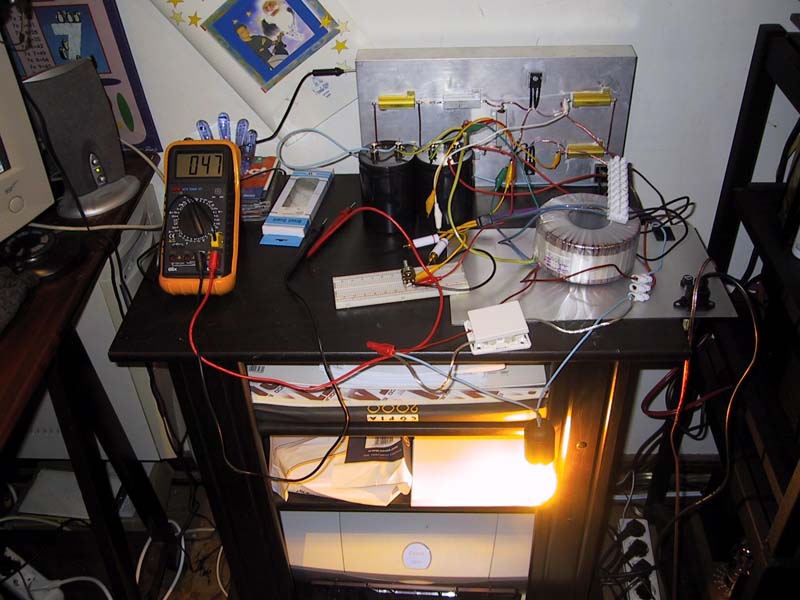

As for inrush current i tested a simple, simple, simple soft start circuit on my future 15w SOZ with 300000uF/ch ( my design, with a little help from NP)
here is a pic of it:
Yes, thats just a 150W 220V lamp in series with the transformer primary and a light switch.
Turn the switch off and when you turn the amp on the house fuses don't blow.
Wait 10 secs and turn the switch on (lamp goes off), amp is runnig at desired volts
No signal mess and digital time delay circuits and stuff.
