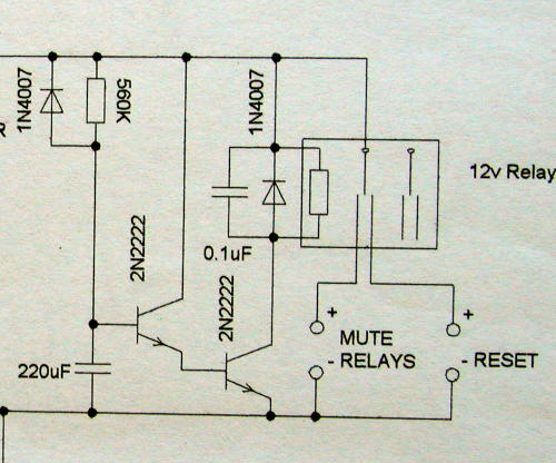

fcel, bosoz delay:
I'm building the bosoz also and has the same concern, and I really prefer to be able to turn of my amps and I'm also looking for a delay-before-operation solution.
In Audio Electronics 6/97 you will find an article by Mike Rosenstein, A Simple Delay Timer. This circuit may be used in different setups. I can e-mail you a scan if you're interested...

fcel,
I didn't show the rest of the circuit because it was irrelevant and complicates the delay circuit. It consists of a rect. bridge and 1000u smoothing cap, the voltage is about 12V.

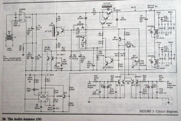

Since most of the interest seems to be in the realys and not the circuits , I present here a schematic of a protection system. I didn't build it because it seemed too complicated to me but it looks pretty interesting.
It has the following features:
Turn on delay with fast turn-off at power down
Amplifier offset shutdown
Adjustable thermal shutdown
Pilot light flasher indicating fault condition
Modular topology for easy adaptation
According to author "C1 had a significant influence on the amplifier's high-frequency performance. The reason for this is unclear, as I chose the capacitor value and type for optimum sound rather than for any numerical reasons".
