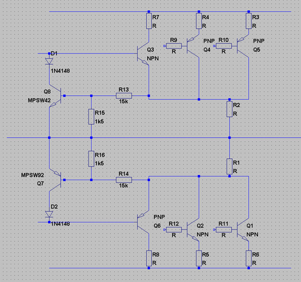

I am not much of a fan of agressive current limiting either - a soft clamping of the drive is fine ..but .....and here's the big but....... if you anticipate driving difficult inductive loads of the type that can produce phasor plots 35 degrees misphase between current and volts - such as KEF104/2 (5 drivers per unit + a very complex crossover) Reference or Magneplanars - B&W801's - causing a whacking amount of harmonic and assymmetric conditions - current limit is not what you need -- it's a bigger VA (i.e. more current) available in the supply.
So often have I seen medium sized power amplifiers strapped to insignificant power supplies - take the Quad 405 as an example. 2x 100W amplifiers on a transformer I would have rejected for a 50W - then because of this they current limited the thing to death because they feared their precious ESL63 electrostatics would get harmed otherwise. Instead of cutting in at extreme conditions the current limit was bouncing in and out during normal operation on my bench -- which is poor design quite frankly.
A strong philosophy for designing amplifiers is look through all the most difficult load conditions you anticipate you are going to drive - and design from that position. Designing by including and considering the important loads is just good craftmanship.
anyway that said... and just for good measure... here's a hopefully non-agressive current limit that may suit your plans. It shows a representation of your back stage and is designed to soft clamp the drive of the BD139/140 stage at extremes. The final tweak I would do on the bench into an inductive dummy load.

the single slope VI limiter shown by phaselocked loop will operate only in the condition where the load goes below 1E or there is a short circuit correct me if i am wrong.......
other wise it should cause no current limition for 4 or 8 E load.
I need help in calculating the values for the resistor so that the VI limiter starts working from 2.5E load .....

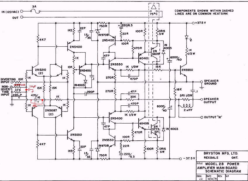

these are all I limiters. The V part of the IV limiting is omitted. Except the Bryston with the 18k giving some V element. But where is the other half of their limiter? Or is it not needed?
All semiconductors can pass a short term transient of very much higher current than they can for continuous signals.
The IV limiter implementation must take account of this transient ability.
If it does not allow high current transients to pass unlimited then ythe designer is wasting some of the resource that has been installed.
For sound quality reasons alone the IV limiter must pass all valid signals to all valid loads.
The limiter should ONLY be allowed to limit output when the current/voltage falls outside the pass definition.

I agree Andrew. For an example of a true V-I limiter (also called Safe Operating Area - SOA limiter) see http://www.linearaudio.nl/SOA-2.htm .

As I said in my post - I'm not a fan of any of them. It's like buying a BMW 6 series at 500Bhp and limiting it to only 300. Knowing full well the engine is awesomely designed to take it anyway and you'll probably never need all that power - and you certainly wont use it in normal operation anyhow. I think with current technology and intelligent design - it's not really necessary.
So why not design the engine to take the hammering? I find more satisfying challenges in combatting noise and distortion.
This is popular and used by many so guess it is okay and nice for someone to post it. Around here we call that circuit "the always fail blow up the amplifier circuit." If it is going to be real current limit the circuit should track the SOA (safe operating area) of the transistor or transistors in parallel.
