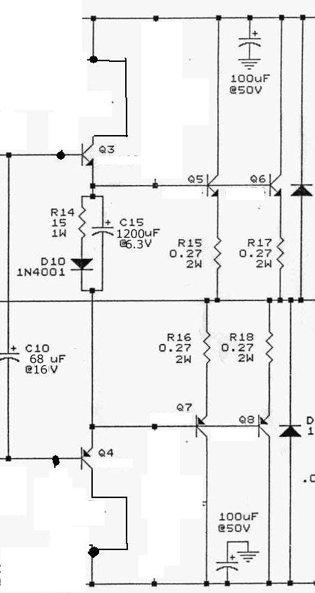

Reality versus Empirical Testing and Theory
Sorry sirs, you seem to be stuck on the thought the models represent all distortions of the amplifiers. This is just plainly and clearly not true. Consider that amplifiers which test similarly in distortion and model nearly the same result is grossly different listening experience. Is this true? Of course! To make matters more confusing there are almost no speakers available with distortions matching amplifiers. Indeed loudspeaker harmonic and intermodulation distortion are at least an order of magnitude greater than the amplifier. So how is it possible these very low distortion amplifiers all built to similar method and power sound so different using speakers which distort ten times as much? I will leave that for another time as it is clearly the case and therefore obviously true.
If you are truly interested, make the test with your favorite amps and discover the facts. These distortions are not about bad grounding or other layout problems. The method greatly reduces these poorly documented distortions grossly improving listening experience and clarity. I mean this is so obvious when tried there can be no doubt of the effectiveness. Please try it and then discuss!! Possibly you will be the one to define the mechanism of distortion. Good luck to your task of that.
FYI- I have build about 250 different power amplifier topologies using identical power supplies and similar layout techniques. These amps were all tested for many things what was found is most amps really do not work that well. The result of this extensive testing is two different topologies which work pretty well. The rest of the 250- not so. No I shall not release this information in general however I will show the result of output stage configuration used in all amplifiers now.

hi everybody i finally understood one thing that bridging is nt for me I am simplely happy with my simple amp with valuable modification from all of u............ I need more experience to do such serious stuff ..............neways thanks to all of u for such valuable information i have already made an amp which is happily driving 150W in 4E next time i will make something bigger and better.................
