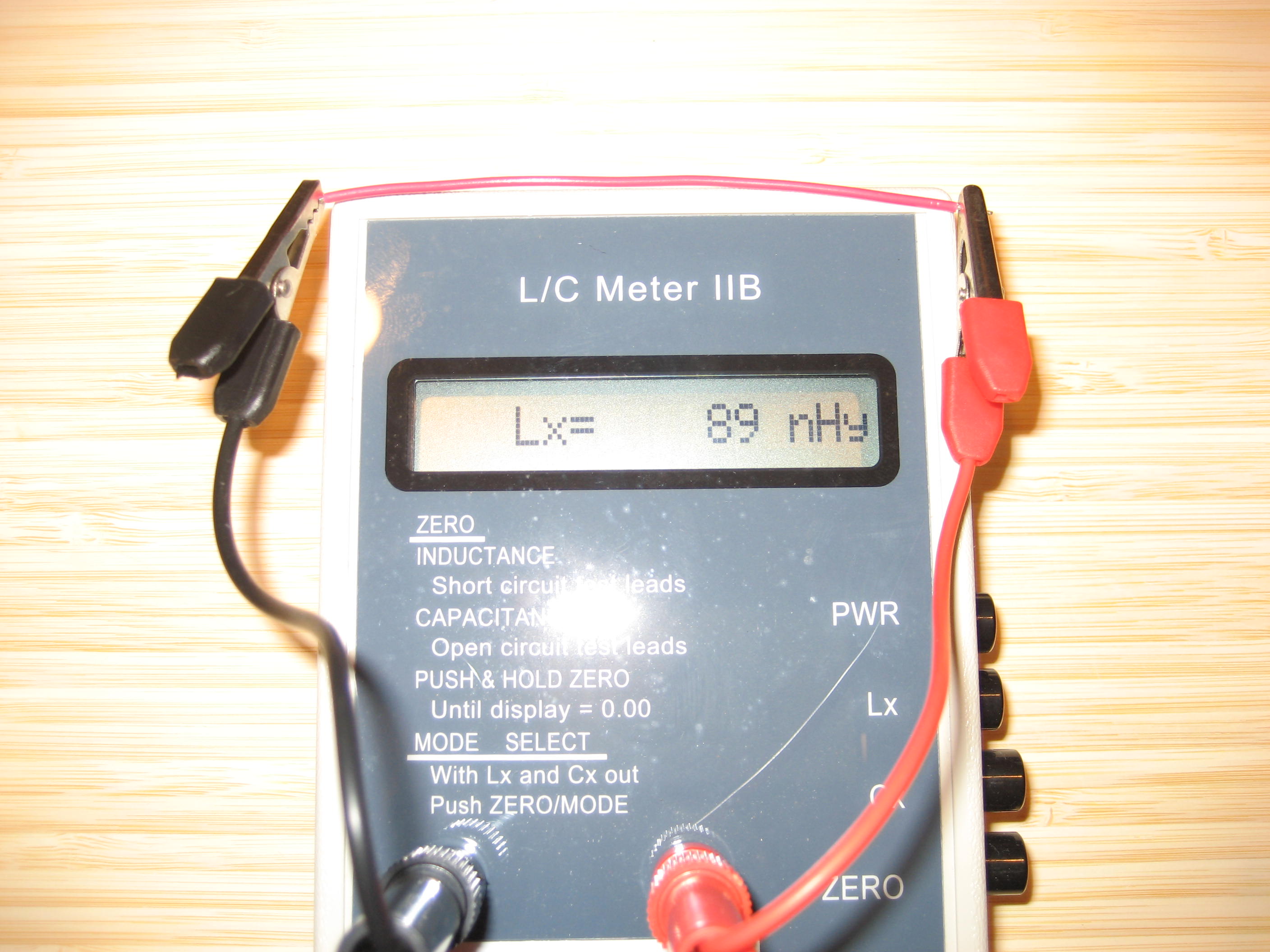

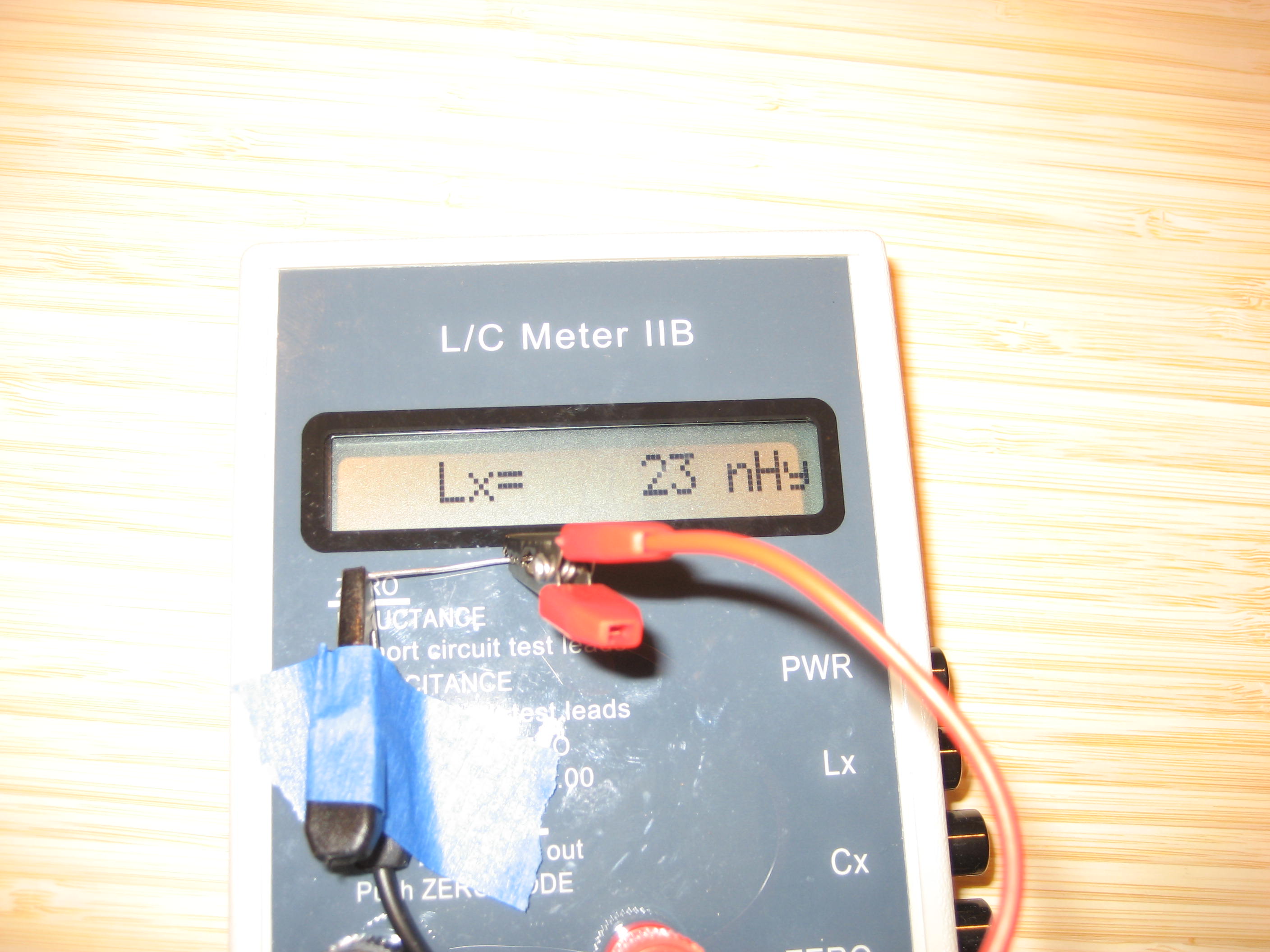

Perhaps the AADE LC meter (link) might do some of the things you want? It's meant for RF work so it expects you'll be measuring relatively high quality (hi-Q) inductors and/or capacitors, whose inductance or capacitance is relatively stable vs. frequency. 60 Hz power transformers are not the intended application!
I just used it to measure the inductance of a couple pieces of AWG22 hookup wire, length=9cm and also length=2cm; photos below. Seems reasonable to me.

You must be a mind reader. I was only looking a this last night and was wondering about its accuracy. Then today you kindly provide the evidence I was looking for. This is certainly a possibility. What's it like for lengths shorter than 2cm?

I haven't used the AADE LC meter to measure inductances below 20 nH so I can't offer any opinions. The meter continuously measures and displays, so the reading drifts around, and every once in a while the drift diverges monotonically. I've decided to trust the measured value seen immediately after zero-cal (for L: short the probes; for C: opencircuit the probes), which I write down in my "lab notebook" a/k/a cocktail napkin for a permanent record. I wish the thing had a sample-and-hold button that freezes the display, but it doesn't.
How do you know the accuracy of the indicated result? I mean, it reads something but is it really that number shown? How do you know?
Thx-RNMarsh
And this is the question. You could calculate the inductance of a given length of wire then take a measurement. Or buy precision inductors (if they exist) and measure them.
Even if it has an error then as long as its consistent then you could deal with it.
The figures measured by mark are consistent with the rule of thumb of 1nH per mm. But how accurate is the rule of thumb?
Too many variables... Need more thinking time and research.
The equipment vendor does provide (this web page) which presents quite a bit of measured data. He measures sixty (!) different calibration-standard inductors, with his instrument and also with three other LC meters. Error results are tabulated.
But of course, that just tells you about the accuracy of his LC meter; how do I know whether my LC meter, on my workbench, is accurate? I don't. If someone wants to send me a precision inductor whose value is known to be 89 nH (or 22nH), I'd be glad to measure it with my LC meter and post a photo. PM me for USmail address.
It is true that textbooks give formulae to calculate the Self-Inductance of a Straight Conductor, which are applicable to the case of a 9cm length of AWG22 wire. I consider (Frederick W. Grover's book) to be authoritative / definitive on the topic.
Much to everyone's surprise, Grover gives a formula for the inductance of a straight wire, in which inductance is not linearly proportional to length. I will repeat that: the inductance of a straight wire is not linearly proportional to its length. Instead, inductance is proportional to { length x ln(length) } , i.e. super-linear growth*. Image attached.
Plugging the numbers for the 9 cm length of AWG22 wire, into Grover's equation (7) on page 35:
l = 9 cm
rho = 0.0644 cm
L = inductance = (2E-3) x 9 x [ ln(2x9/0.0644) - 0.75 ] = 0.0879 uH = 87.9 nH​
*As anyone who took an EE class called "Analysis of Algorithms" can tell you, N ain't the same as NlogN, not by a long shot. Finding the max of an unsorted array is order N. Sorting the array is order NlogN.

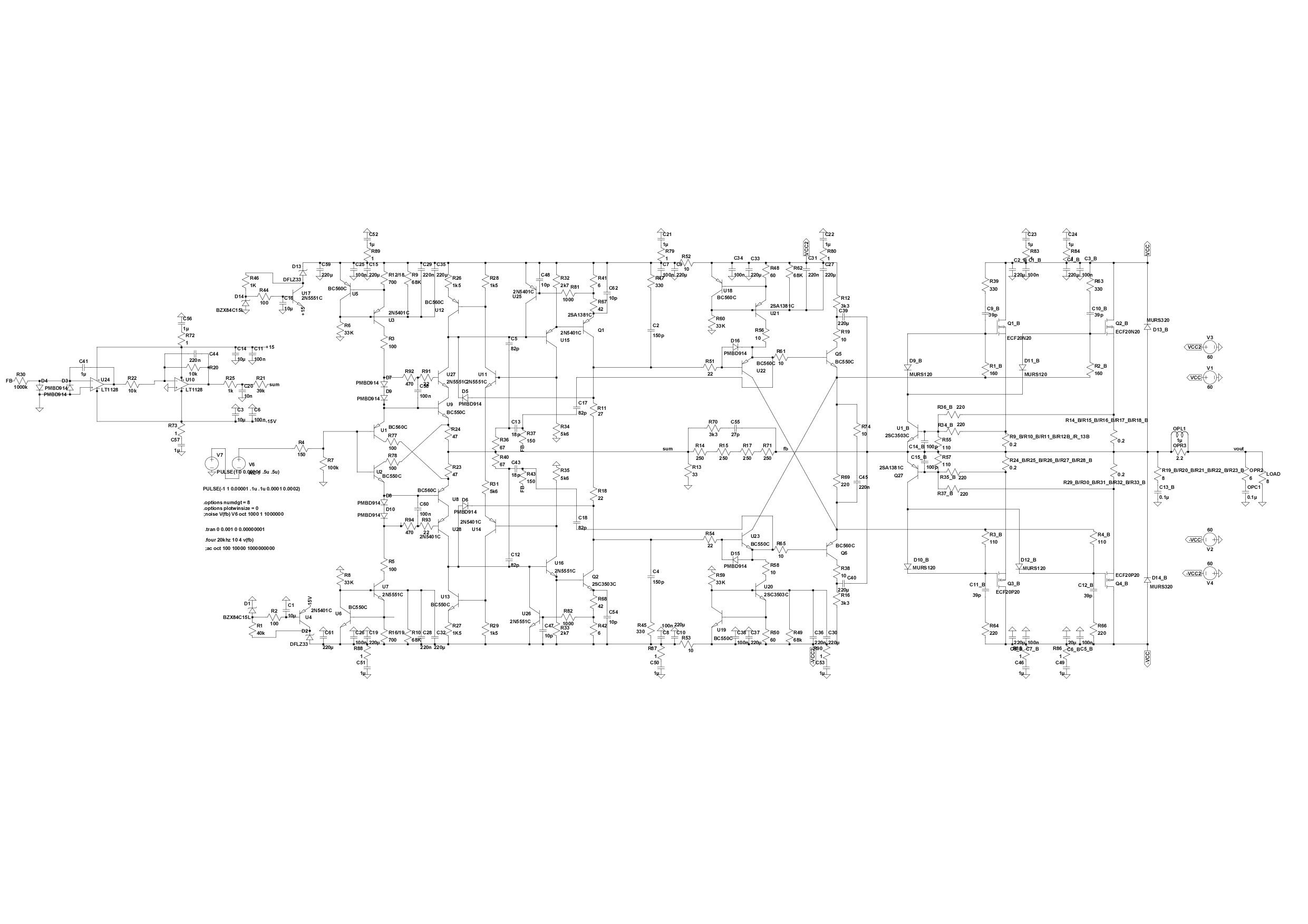

Update on the project so far. There have been some changes to the schematic. A cascode has crept in (Manso's suggestion). Allowing the use more suitable input devices with better matching of operating conditions.
Changed to BC5xx devices where the transistors are subject to low Vce. This was prompted after reading about quasi saturation in the impressive astx thread.
Would like to use BC3xx devices for the output devices but cannot find decent spice models for them. Will be tweaking component values for a while but the basic design has been settled on (for now).
PCBs have also been designed and ordered. So hopefully in the next couple of weeks can start building and experimenting. Time to accumulate the rest of the parts.

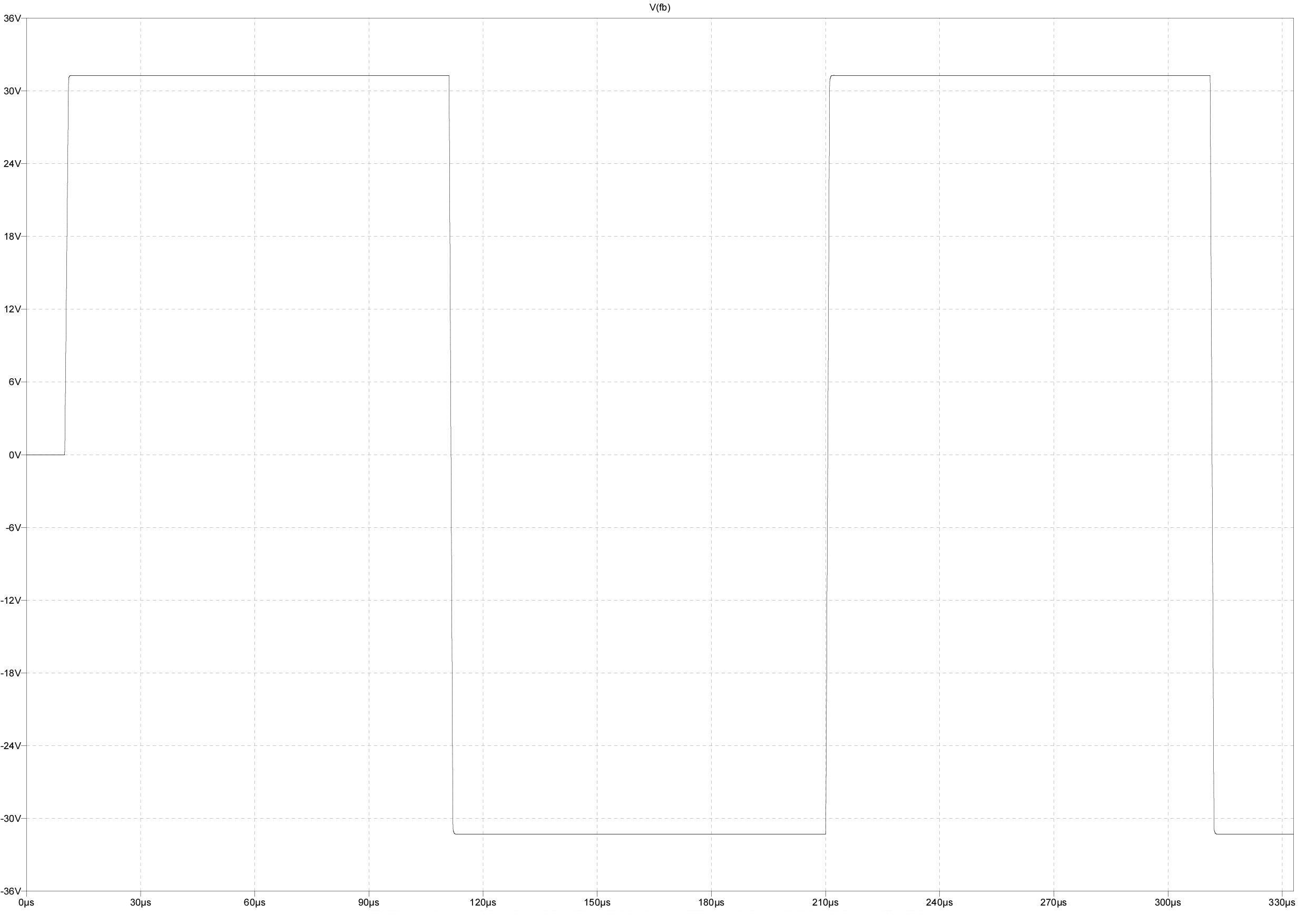

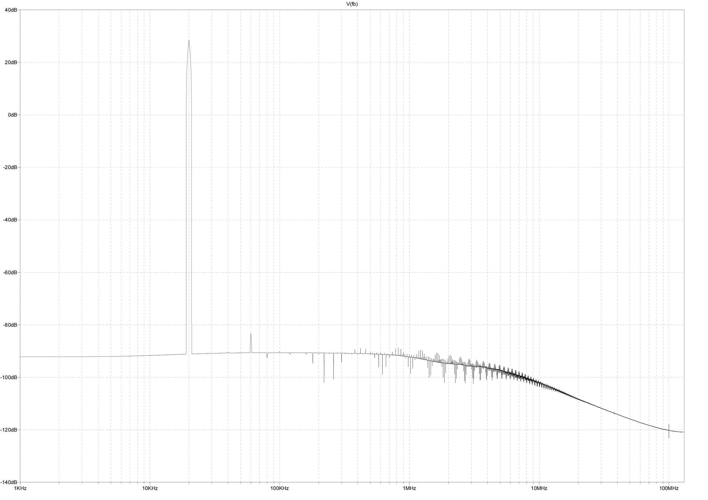

Some plots etc for you... if anyone is interested.

I hope this will not complicate project, but I have to say that from my experience BC550c/560c are bad sounding. Kind of rough sound.
Fairchild BC5x0C are different from OnSemi BC5x0C. According to datasheets, the OnSemi parts have lower nonlinear capacitance. I'm actually surprised Cordell's models show relatively high Cje for the BC5x0C. By the datasheets, the BC5xx series actually have amazingly low capacitances, and my experience is they do sound rough if they oscillate but are capable of mind-blowing clarity when used very carefully. Anyways, if the Fairchild BC5xxC don't sound good, try the OnSemi parts. I switched them into my EC buffer and I think they sound better.
As far as BC3x7 models, what problems are you encountering? You might try the BC807/817 models from NXP.
Excuse my inexperience and lack of knowledge in this area. What would cause the BC5xxC to oscillate and what precautions could be taken to prevent this from happening? In spice they seem happy enough, reality may be somewhat different.
The PCB is designed such that there is scope for experimentation. Eg. I realised that since the pin outs for the BC devices were similar to the 2N devices with the base pin in the centre, I could easily swap between the two. Also could loose the input cascode with a few wire links.
I liked the low Cob of the BCs along with the high gain. The BC546 + complement looked very nice with the high gain. They also seem much better for the current sources in spice but this could be down to models.
The problem I'm having with the BC3x7 models is convergence. I can drop the Gmin down to 1e-006 to get anywhere.
Edit: for a laugh simulated 100KHz @ +/-36v ad got 0.004%
I suspect you a right. Have been doing quite a bit of reading about source stepping. It's not quite sunk in what a lot of the settings do. Eg changing Voltol seems to help matters. Just not sure what it relates to.
The funny thing is that the complete parasitics version of the circuit gives a lot less problems with source stepping than the non parasitic version.
