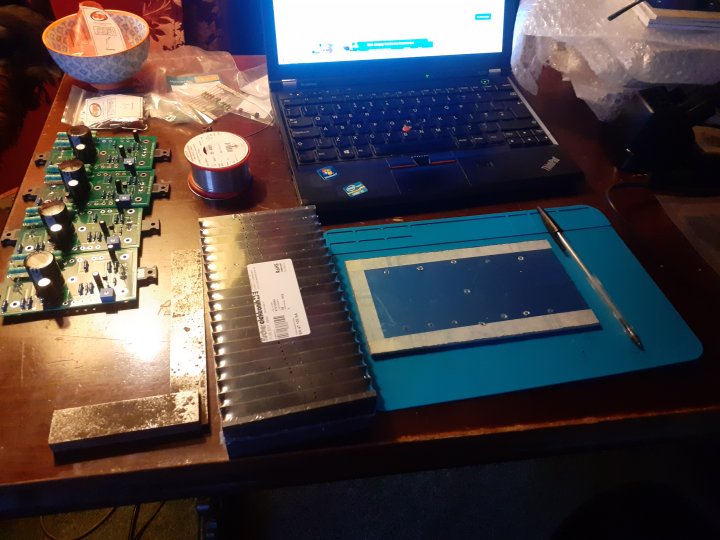

Hi Folks,
Have finally started assembling my ACA boards, I have 2 questions :
I saved my old IBM laptop supplies for a pair of amps, they are 20V 3.5A . Will these work ok ? (I'm assembling according to the 1.6 build guide)
I'm struggling to find a chassis mount DC connector rated above 1A for the power socket (UK suppliers) Do I just buy a 1A connector and assume it will be ok ?
Thanks,
Rob.

Joined 2010
As long as you balance the channels for a 20V supply it should work. ( but I know little) Do the voltage checks outlined in step #56 in the V1.6 bill guide
https://guides.diyaudio.com/Guide/Amp+Camp+Amp+V1.6+Build+Guide/5?lang=en. Look at the V1.8 build guide long enough to familiarize yourself with the minor changes from the V1.6 but follow the 1.6 build guide for the most part. Read both those guides end to end before you start. Good luck and have fun.
Thanks,
I'm sure I remember reading that the 20V supply would be ok, it's just I bought the boards so long ago that when I came back to this thread it all seemed to be 24V.
I've decided to do without the chassis power connector, I will use a cable gland and solder the power supply wires direct. Better solution than using an underspec connector.
Rob.
