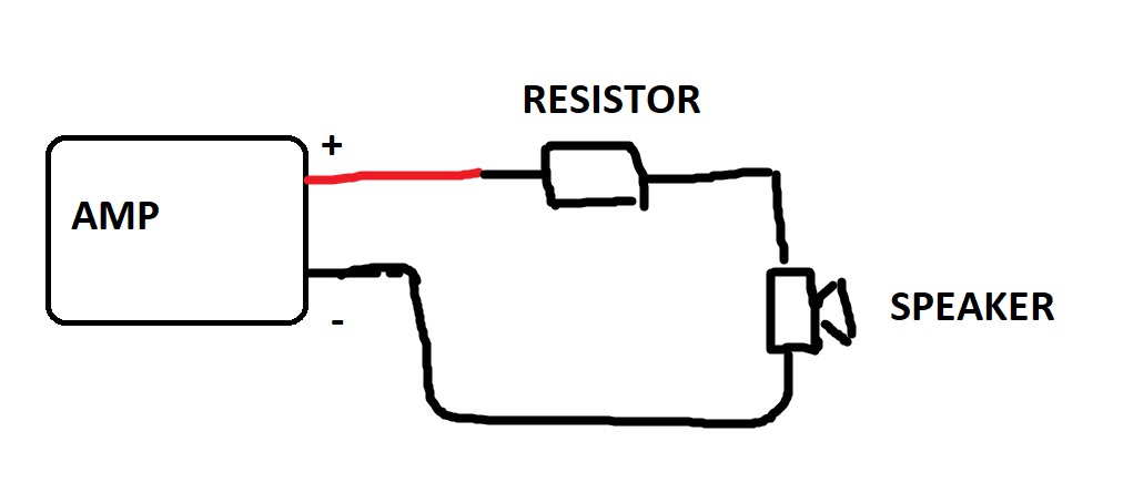

If you have another amplifier that you think 'sounds right' then there might be a way to compare the response of the ACA with that one using just a meter and test tones.
