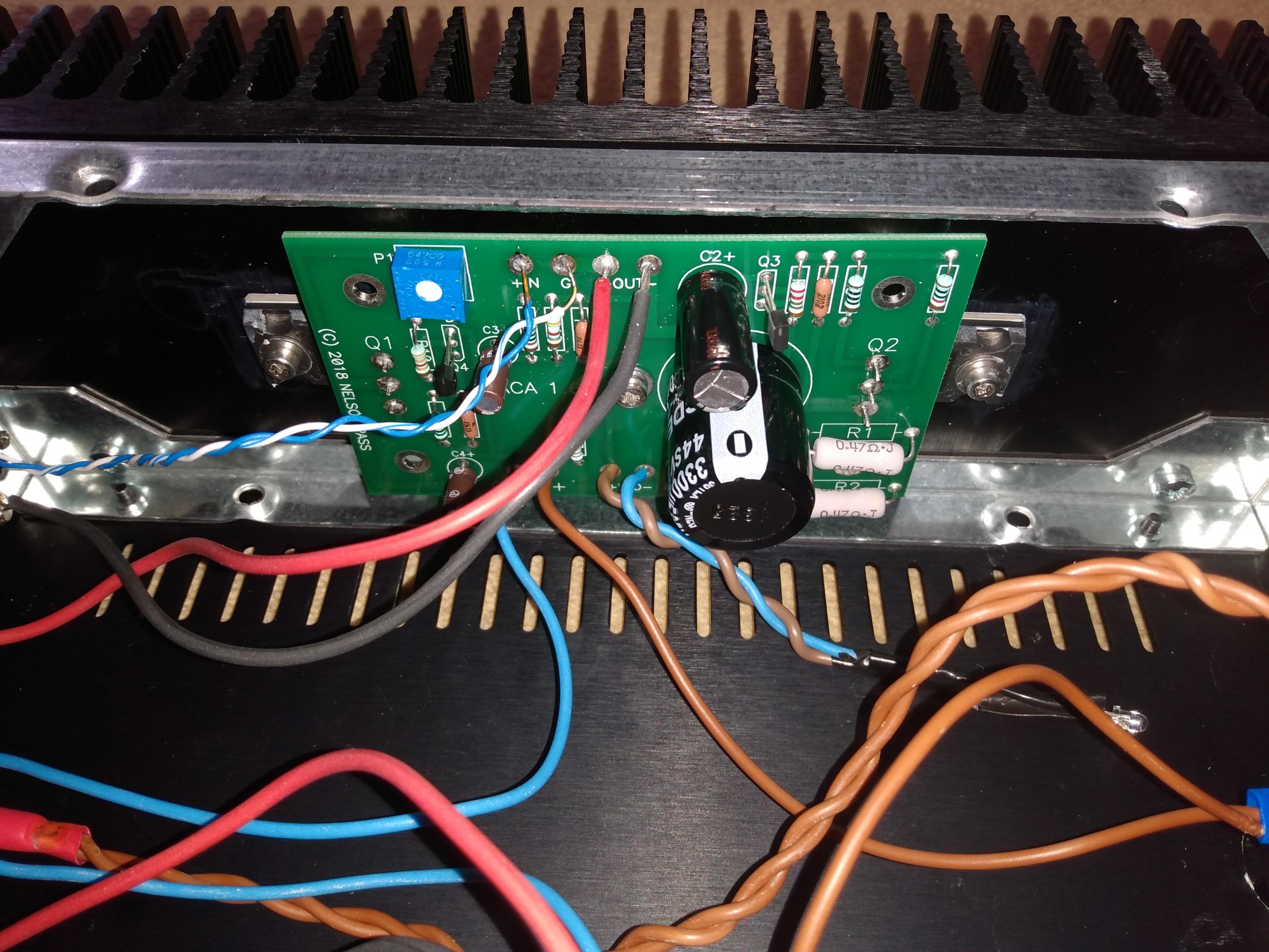

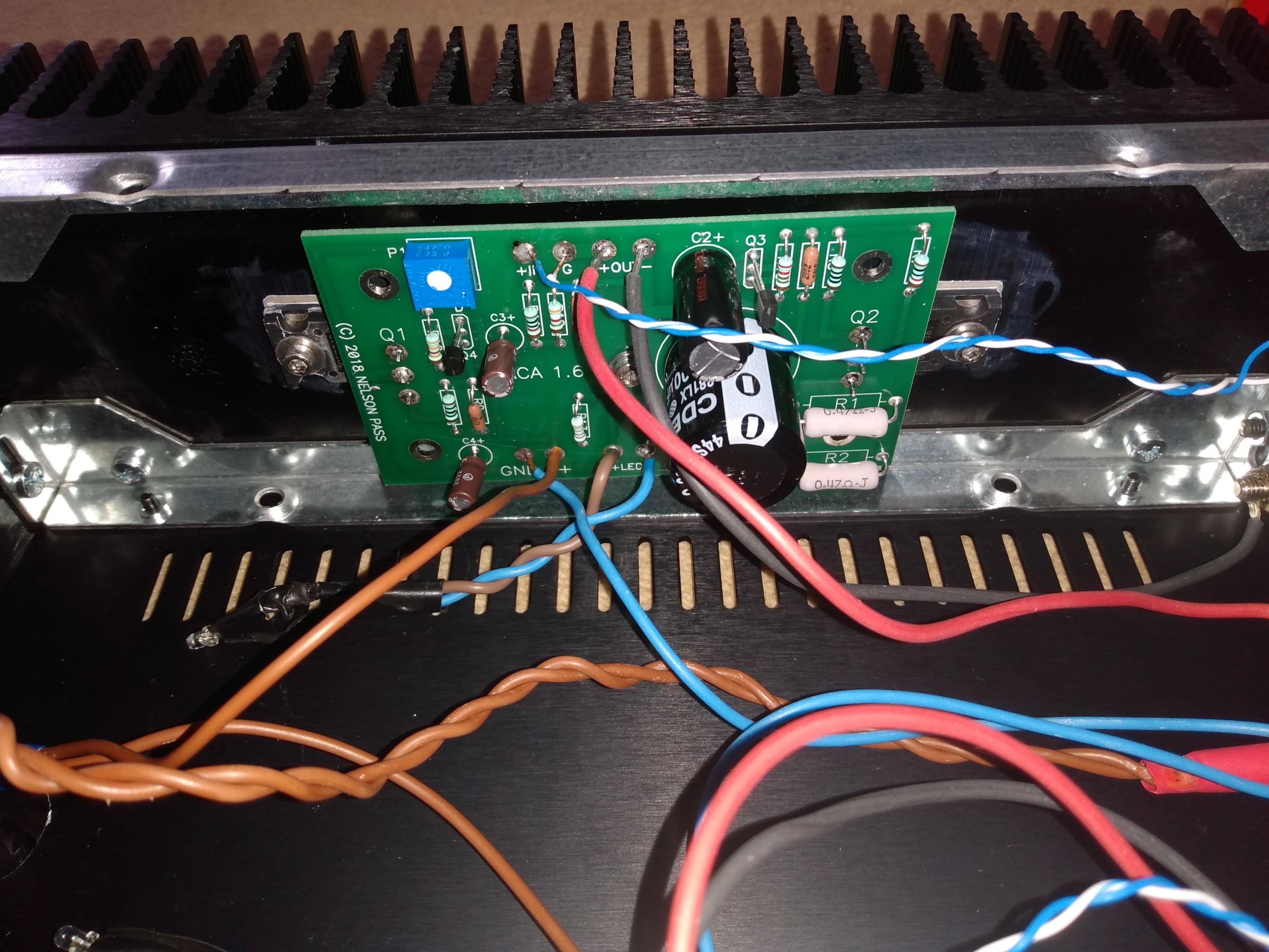

Help!! So I thought everything was going well until I tried to play some music, then nothing!!. Well not quite nothing as I could hear VERY faint music with my ear right up to each speaker but much more than a meter away nothing.
I have built 2 amps simultaneously and the problem is the same with both when set up as individual stereo amps. The very faint music I can hear is the same with the rear switch in all 3 positions.
When I switch on the LEDs light up with no flickering.
All 4 channels biased ok at around 12v (24v supply).
Preliminary checks;
No continuity between mosfet drain and ground.
No continuity between each individual input and output sockets plus and minus.
Around 0.98k resistance across red and black speaker sockets (starts around 0.75 and rises to 0.98k after about 20 seconds!)
Not sure what to do next, if anyone could help please.

Nothing obvious, caps are in the right way round and the transistors. Impossible to make out the resistors from your pictures though.
Really dumb question, I'm not familiar with that 24 volt input connector, so is the wire between the two red speaker terminals soldered to the outer ring / tab? I think I can see a 'free' tab in the picture.
Then measure the resistance from the centre of each RCA to the outer, it should be about 50kΩ.

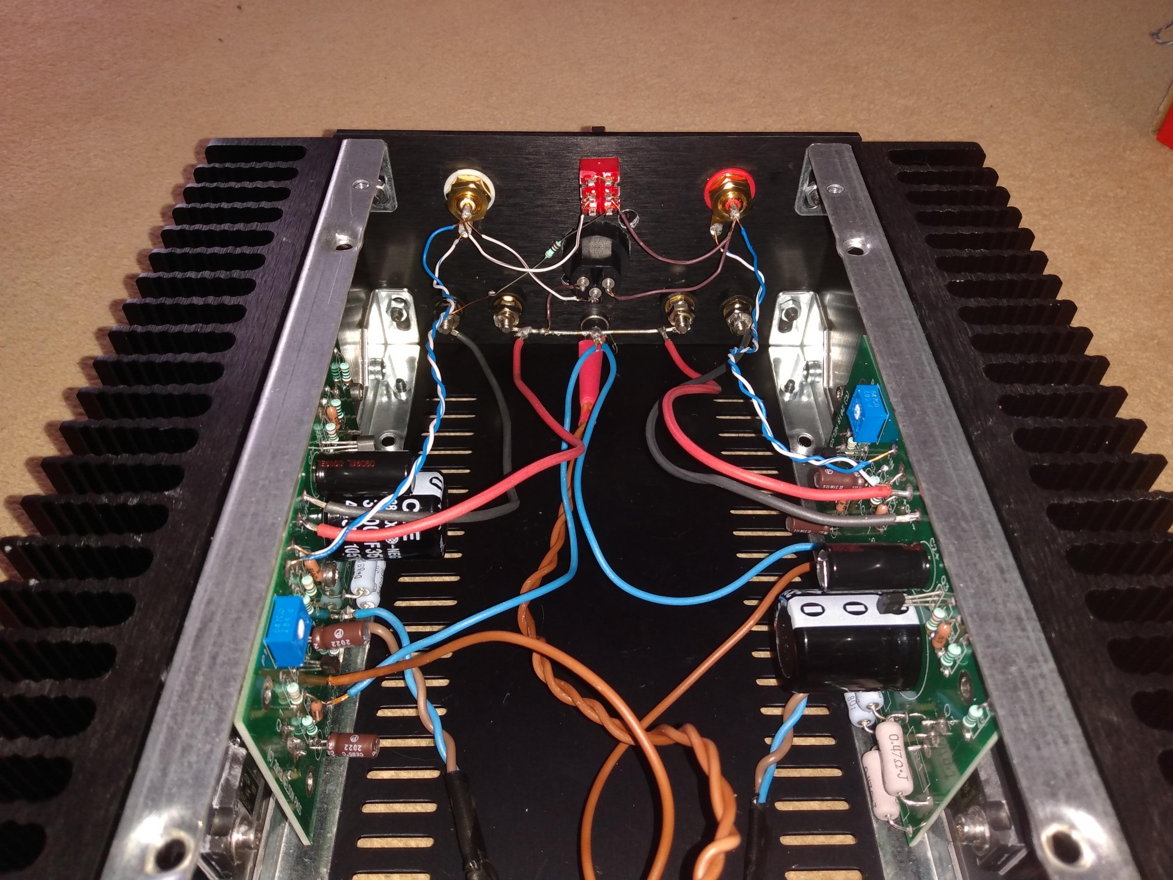

so with the switch in the centre one amp gives about 10.9k for each RCA and the other has 10.9k in one channel and still zero for the other.
If any of the signal wires on the board reached the heatsink I would get continuity at the sockets right? If so then all is ok on these.
Yes the binding post were meant to have solder tags but didn't so I went straight onto the threads, its ugly but seems ok.
I would be amazed if it was a wrong resistor value as I was very methodical in measuring and separating but of course I can't rule it out. Likewise for any shorts as I did inspect the boards before mounting, but of course I will check all these again.
Whatever I have done seems to have repeated on all 4 boards. I'm curious if some sort of short on one board would also affect the other channel?
Umm,

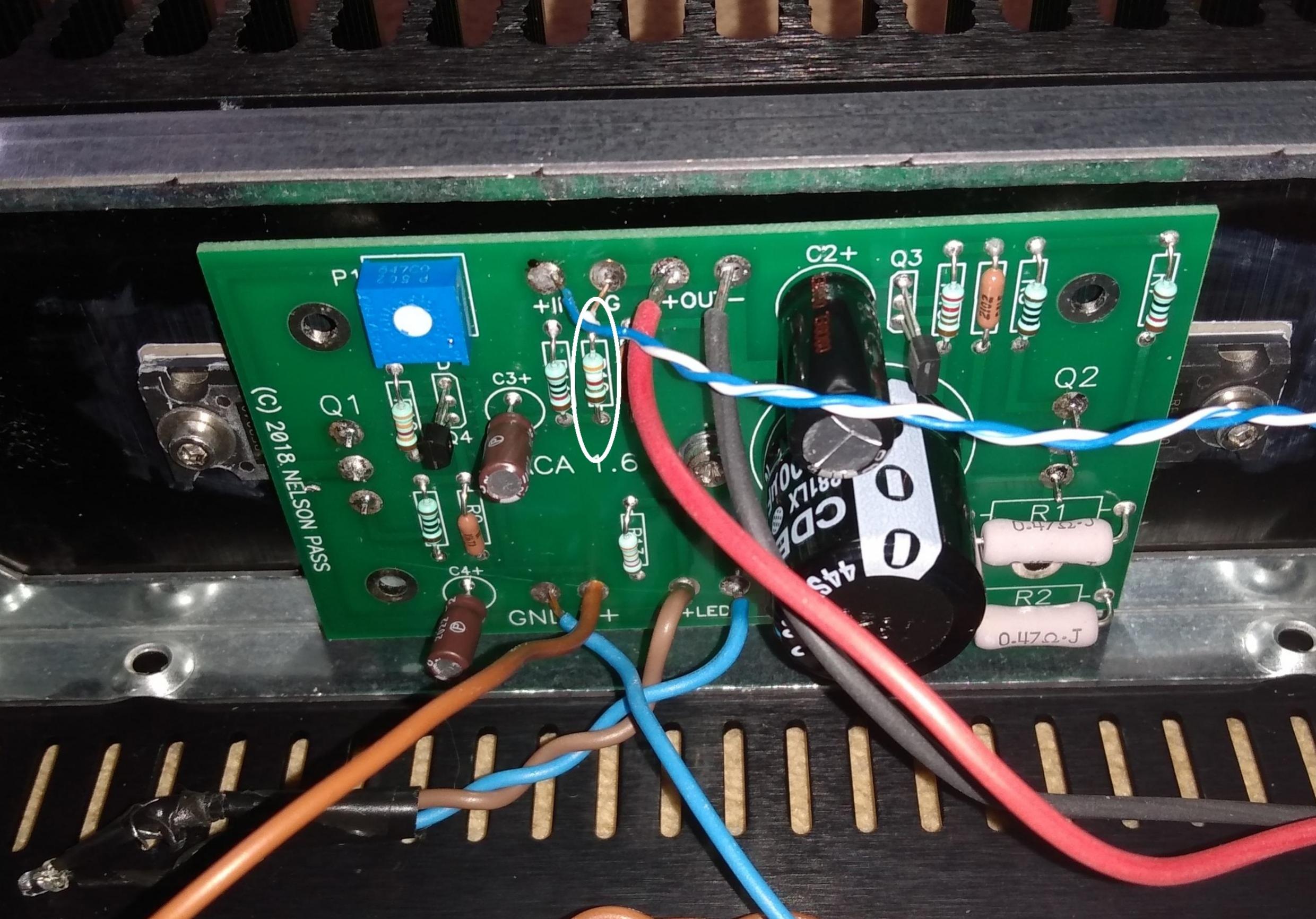

The 1K should be good, you measure 1k across the speaker terminal. I think the 10k is correct too, you get 11k total. So R12 the 39.2k is wrong.
If you look it should be Orange, White, Red, Red, Brown. But if you look at the picture the 2nd Red band on yours is a different colour. Measure that next.
On the channel with the 0kΩ reading, unsolder the +IN wire from the board. Now measure the resistance again at that RCA connector. If it reads 0 ohms still the socket or wiring is short. If it reads open circuit (it should) then the short is at the board.

We've all done that, no shame. It does not need to be 39.2kΩ, a normal 39kΩ (or even 47KΩ) will do. If you have 'spares'.
If you have the wire off the board and the RCA still reads 0Ω then you are very close to the problem. A whisker or solder blob perhaps.
A close up of the rear of the socket might help us see too.
Alan
PS: Have a look at the switch too, a whisker or blob there to the switch body will give you a short to 0 volts through the chassis...

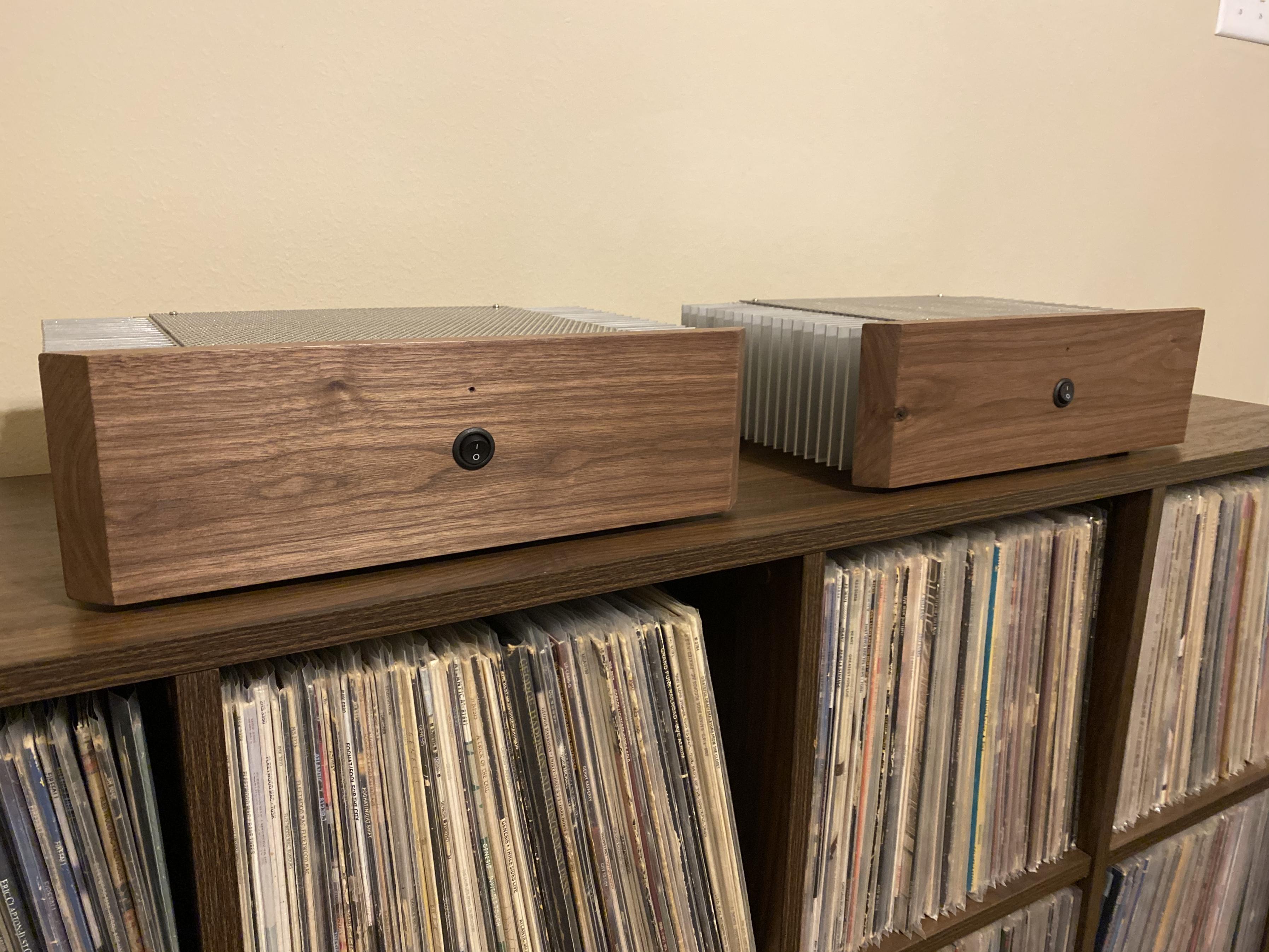

Just saw this pop up. I recently bought a pair of Harbeth 30.2 XD in Walnut and had just build a pair of Rudi Rozek’s torroidal Amp Camps for another set of speakers. I can try the combination out and give my impressions.
Using an F6, M2x and of course F5 turbo gave me good enough sound with a nice Rel sub.
