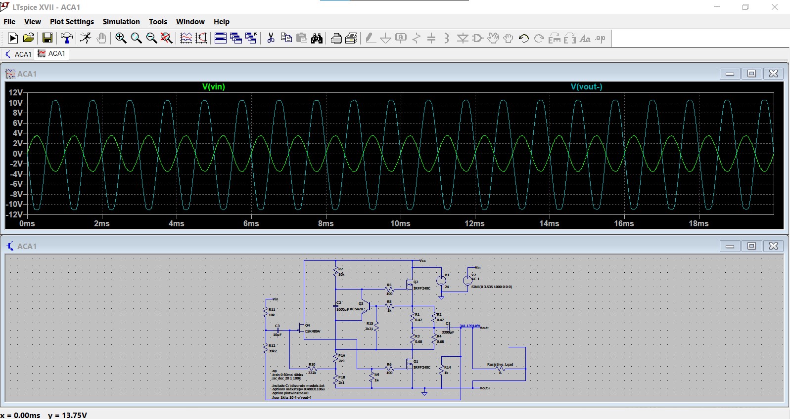

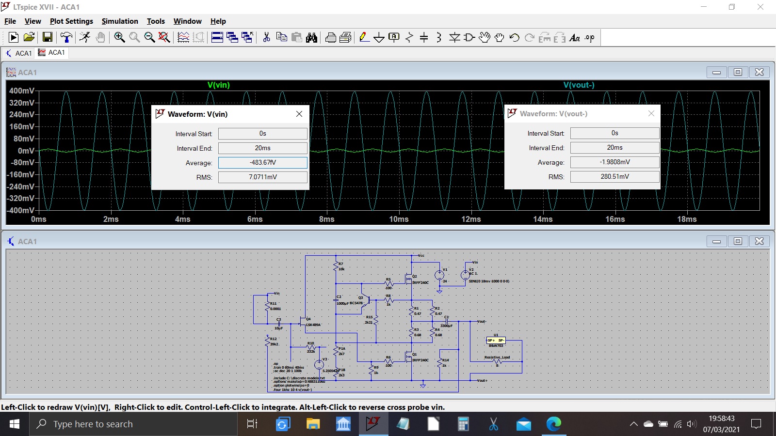

Very interesting. I wonder if anyone has actually measured it in practice. The sim gives an OLG of around 40 numerically (or 32db) so you and the sim seem certainly seem to be in the right ballpark.

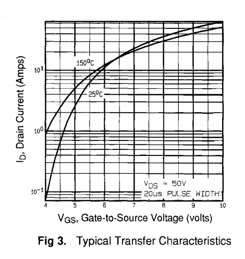

It's a source follower stage (gain approx 0.98) then a common source amplifier stage (gain equals (gm * Rspeaker)). Interpolating the datasheet curve for the common source MOSFET, gm is around 2.5 to 3.3 Siemens, giving a stage gain of 20x to 26x with an 8 ohm speaker.
