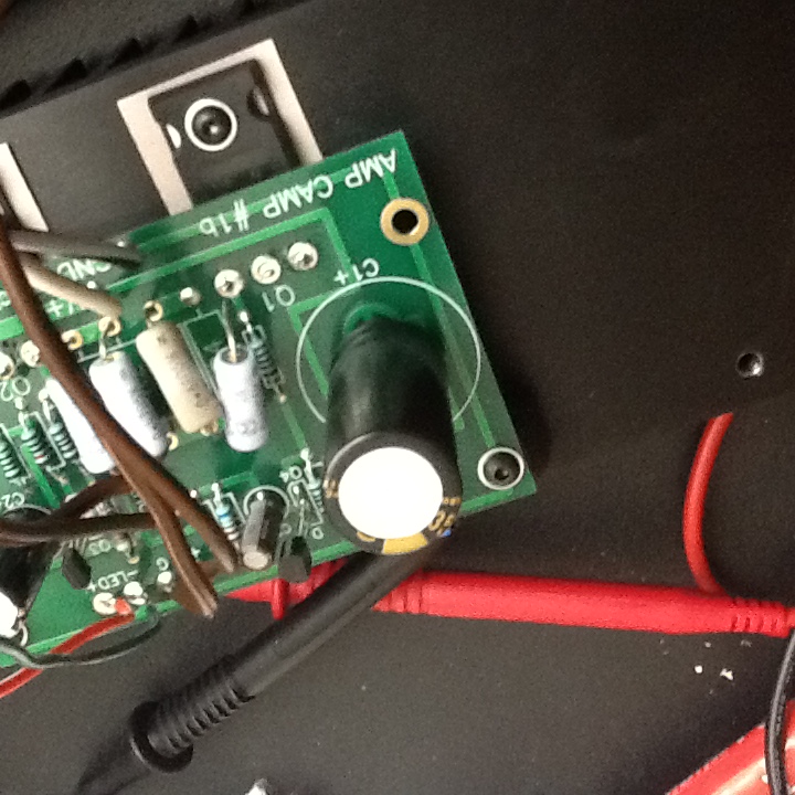

Just assembled ACA v1b. As photo shows, R3 and R4 got very hot and leads melted. When power originally applied was easily able to adjust bias to 10V. Heat rise in heat sink was moderate and output devices pretty cool. At four minutes allowing to heat, both amplifiers began smoking. Removed power (19V laptop supply). It appears one of the smaller transistors would need to have failed to over exert the R3 and R4? Search results here didn't yield postings of the same problem so I could use a little help.
First congratulations on getting post #7000 on this thread and #400 on the v1.5 thread, sorry no prizes though :)
Second, that is a rather odd fault.
I am surprised there was enough current to melt R4's lead, was it soldered in correctly? In the picture only R3 looks burned, but R4 is lifted and does not look burned and you say both amplifiers have the same problem.
Can you post better pictures? Of the boards and the whole assemblies so we can see the components and wiring? And are the components from the kit or from other sources?

The overheating fault points to a problem around Q3. Make absolutely certain that R7, R8 and R15 are the correct values.
All things being equal, no fault around Q1 (even if it was dead short) would cause this. Q2 and Q3 (plus parts connected to them) are pretty much self contained in forming a current source.
As mentioned above, make sure the parts are genuine and what they say they are.

They probably are burning, just less noticeably so than the others.
Being slightly higher value (0.68 vs 0.47 ohm) means there is a very large difference in power dissipation between the two, for example at 4 amps per resistor, the dissipation is 7.5W in the 0.47 ohm and almost 11W in the 0.68 ohm.
Power is calculated as 'I squared' or 'V squared' which means seemingly small actual differences make a big difference to the actual result.

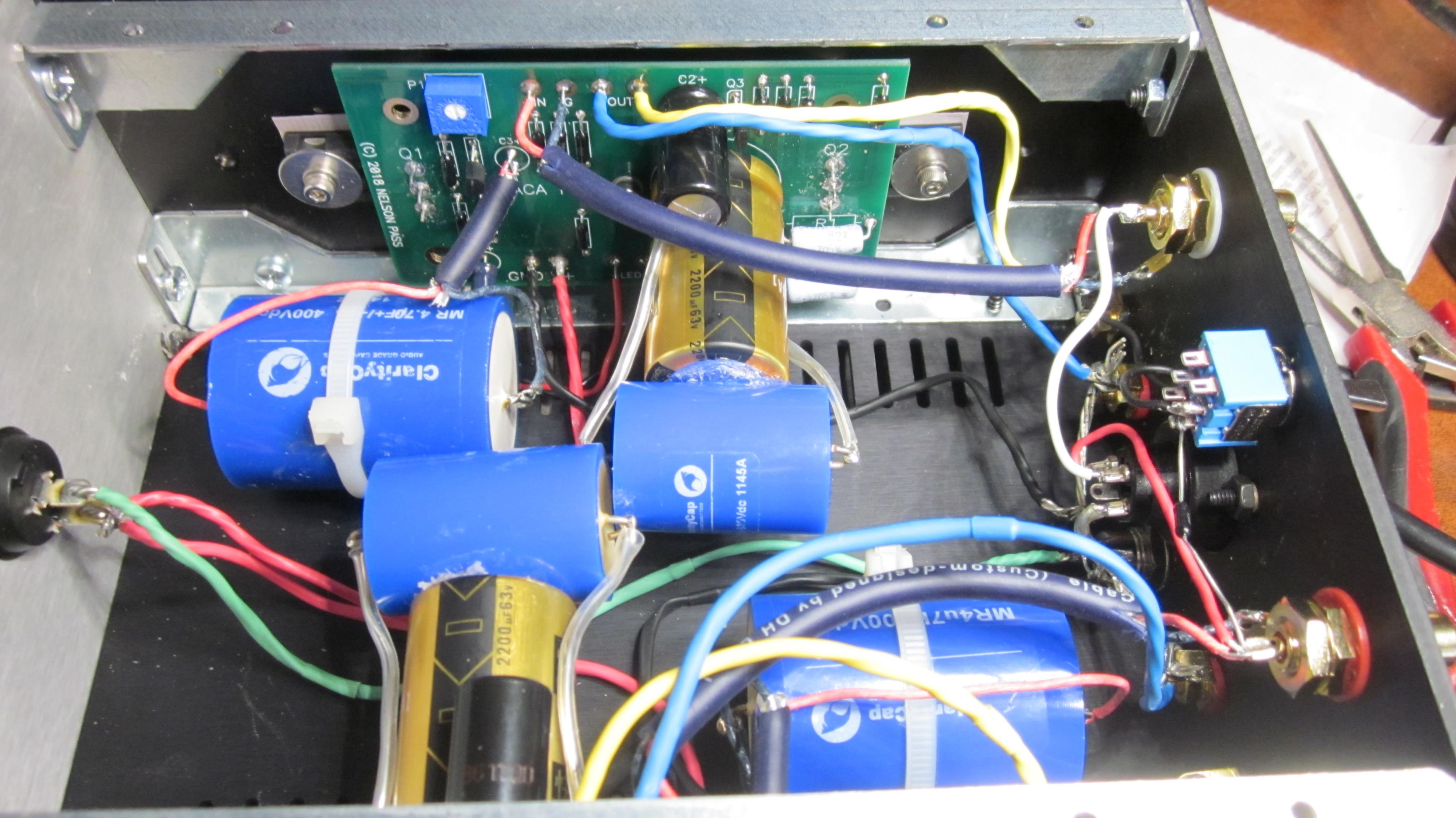

I just wanted to post the results of my monoblocks build with alternative piece parts. Some of these were chosen from my parts bin, others purchased new.
-4.7uf/400V ClarityCap MR film bypass caps
-2200uf/63V Audio Note Kaisei bipolar electrolytics, bypassed with .33uf/630V ClarityCap MR.
-Welwyn RC55Y 15ppm 1/4W resistors
-Rio Grande .999 dead soft silver round wire, 20awg for signal and 3x 20awg for power and binding posts.
-Parts Connection Connex/DH Labs BL Ag bulk IC
I don't have the stock kit parts to compare it to, but it sounds fantastic. Interestingly, there is no sound of the 2200uf AN 'lytics charging at startup.

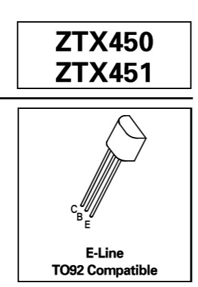

Q3 (ZTX 450) has the printing on the "rounded side". I suspect this may have been installed backward but can't test in the circuit. I have a few more of these devices from the same source so I will dig those out and see if I am able to test on my DMM (not sure I can as I've only used BJT devices in the past).
