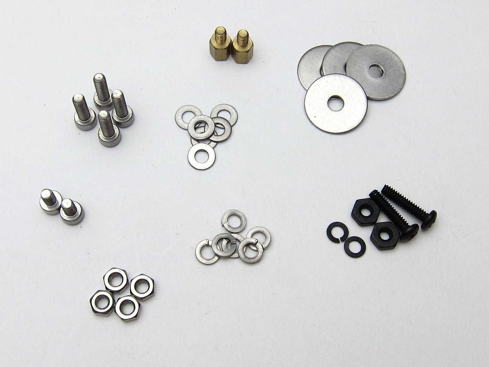

I am just now getting to building my ACA and discovered that the hardware bag with the screws and washers was missing from my kit.
Can someone here post a list of the parts to see if I can find them at my local hardware store. Thanks for any help you can provide.

I was missing hardware too.
I just brought a heatsink with me and found what I needed. I used the assembly manual to figure out what I needed.

Sorry to hear that. To get you started:-
All the threads are M3 (3mm).
To mount the PCBs, you need 2 x 6 or 7mm brass stand offs, 2 x 6mm (short) socket head Allen screws to fit them and 2 small washers.
To mount the MOSFETS you need 4 x 10mm socket head Allen screws, 4 penny washers (fender washers) and 4 spring washers.
To mount the XLR socket you need 2 x 10 or 12mm cross head screws, 2 spring washers and 2 nuts. Black if it bothers you.
Alan
