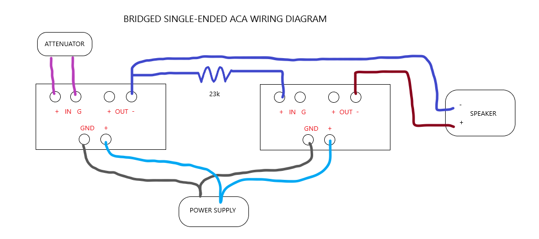

...That said, before I do so can anyone confirm that (Gnd vs - notwithstanding) the diagram I posted is correct?
Yes the diagram in #6923 is correct. As long as both boards are working correctly, that will give you a 'Mono block bridged' ACA. (caveats not withstanding...)

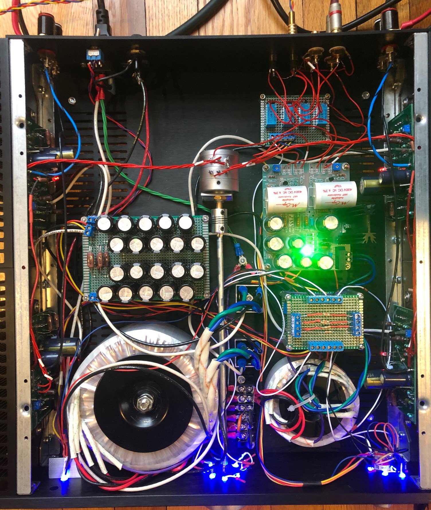

Yeah, you're right. I should check each board individually. I'm not building the amp in the kit; I'm building an integrated amp consisting of a BOZ preamp and bridged ACA in a 2U Dissipante chassis. I'd hoped to avoid having to disassemble the amp to test the individual ACA boards but that would seem to be a prudent approach.
Scott
The diagram looks correct. The speaker connects between the two '-' output terminals of the amp, the + terminals being left unused (and these are in fact ground anyway).
The resistor feeding the input should be whatever was recommended in the design, which for two identical amps with identical gain would be around 33.5k for an 8 ohm resistive load. Use what was recommended though.

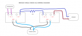

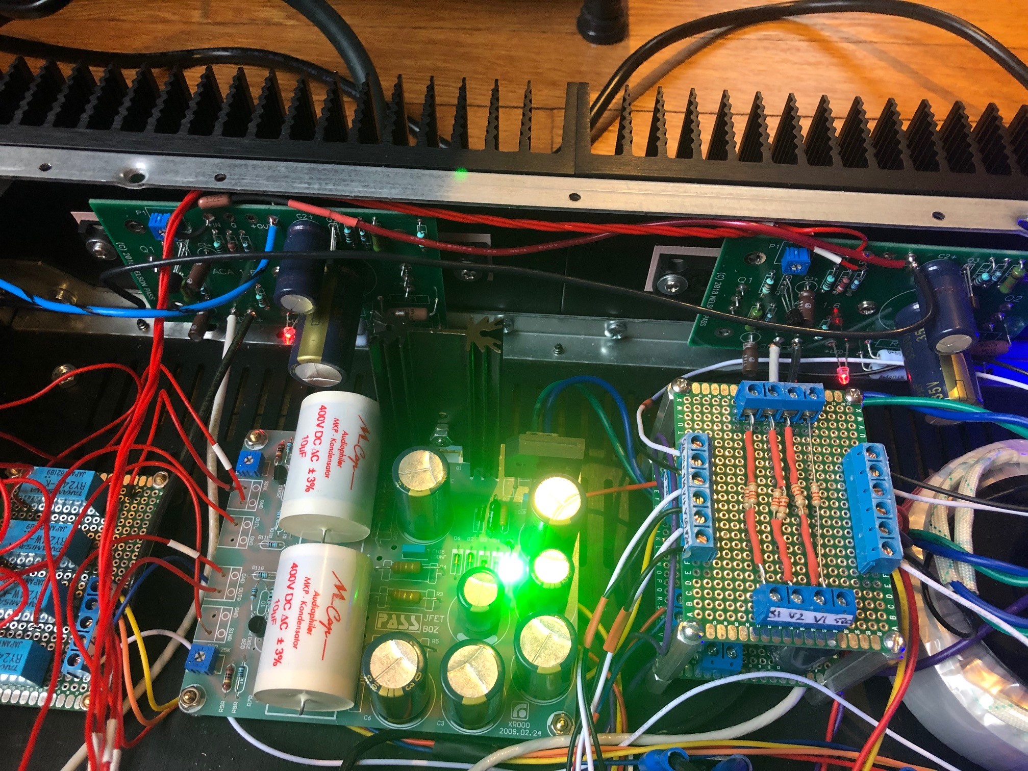

Okay, I remain puzzled. I'm building an integrated amplifier consisting of a Bride of Zen preamp (now working brilliantly) and a single-ended bridged ACA. The bridged ACA sounds distorted. ZM suggested that I test each of the four ACA boards individually, which I've done, and each sounded fine on its own. But when two ACAs are linked together (see attached redrawn diagram) the sound is muddy. Weird.
Any and all wild-*** guesses appreciated.
