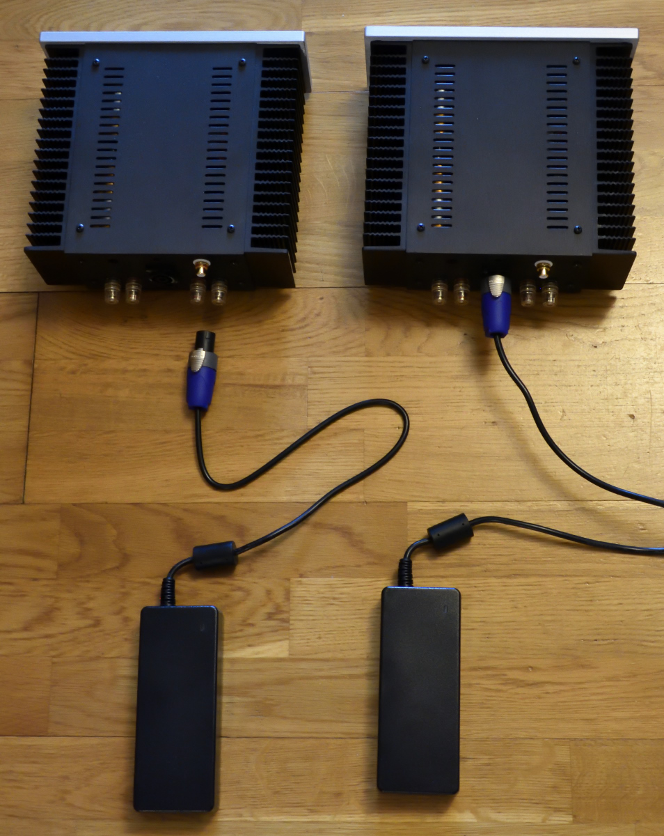

I got 24 VDC Meanwell supplies home for my two ACA mono blocks as an portable alternative to the big LCLC filter supplies. Then it is easier to bring the ACAs to friends etc. so they can try them out. My power interface to the ACAs are Neutrik SpeakOn 2-pole connectors so I changed the standard connectors and also cut down the length of the cables to a more "reasonable" length. Have yet to test the sound using the Meanwell supplies but have tested that they outputs 24 VDC.

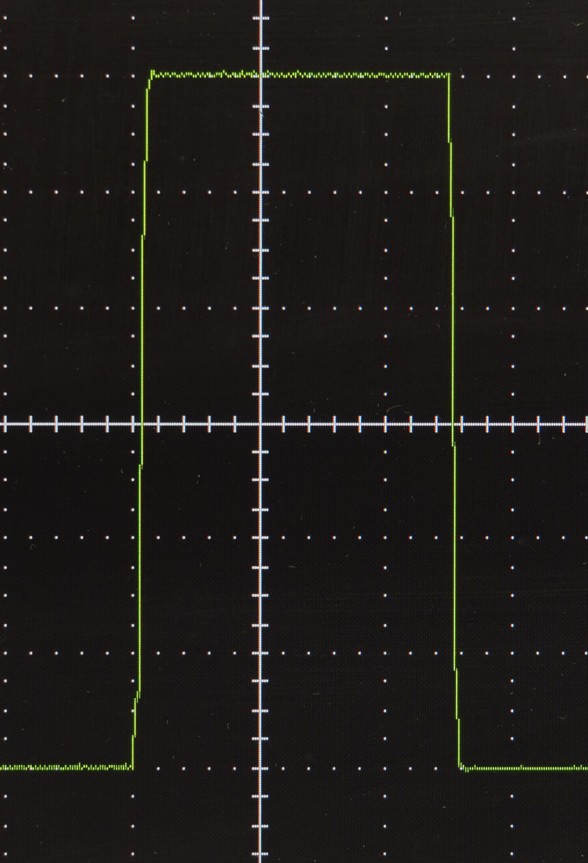

The noise on the top & bottom of this 20 khz square wave is from the very good quality supplied SMPS.
A simple analogue supply appeared marginally quieter in the same test
A cheaper Mean Well SMPS was quite a lot noisier.
I think a well designed regulated analogue supply should sound better
Batteries would be improved I think with a good quality electrolytic close to the ACA boards

Is the PSU responsible for the over and undershoot in first measurement using SMPS?
No - the overshoot differences simply records my ongoing efforts to tame some mild tendency towards resonance.

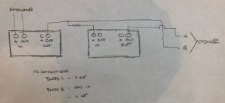

Folks:
Okay, I'm having a problem with a single-ended bridged ACA: it's making music which is weirdly distorted. I hope the problem is as simple as a dumb wiring mistake. I've studied 6L6's diagram in the ACA v1.1 (or 1.6) build guide (Step 54) and can't spot the issue. Can someone please tell me if my wiring is faulty?

Are the input grounds connected correctly? A lot depends on the actual final layout used, leaving the second amp input ground floating means the grounding now relies on the PSU ground route.
What I would do is to check each amp in isolation produces clean audio. That means connecting the speaker to the left amp and checking, then connect it to the right hand amp in your diagram.
If that is OK then you next need to load the left hand amp with a dummy load to get ground currents flowing. You could use another speaker but then it would be harder to gear distortion if one was OK and one not.
mikelm:
You're right and my diagram is in error in that respect; the "Gnd" vias in my diagram should have read "-". That is in fact how my amp is wired: the "-" via on the first board connects to the input of the second board through a 23k resistor as well as to the speaker ground. The "-" via on the second board connects to the speaker "+".
Mooly:
Yeah, you're right. I should check each board individually. I'm not building the amp in the kit; I'm building an integrated amp consisting of a BOZ preamp and bridged ACA in a 2U Dissipante chassis. I'd hoped to avoid having to disassemble the amp to test the individual ACA boards but that would seem to be a prudent approach.
That said, before I do so can anyone confirm that (Gnd vs - notwithstanding) the diagram I posted is correct?
