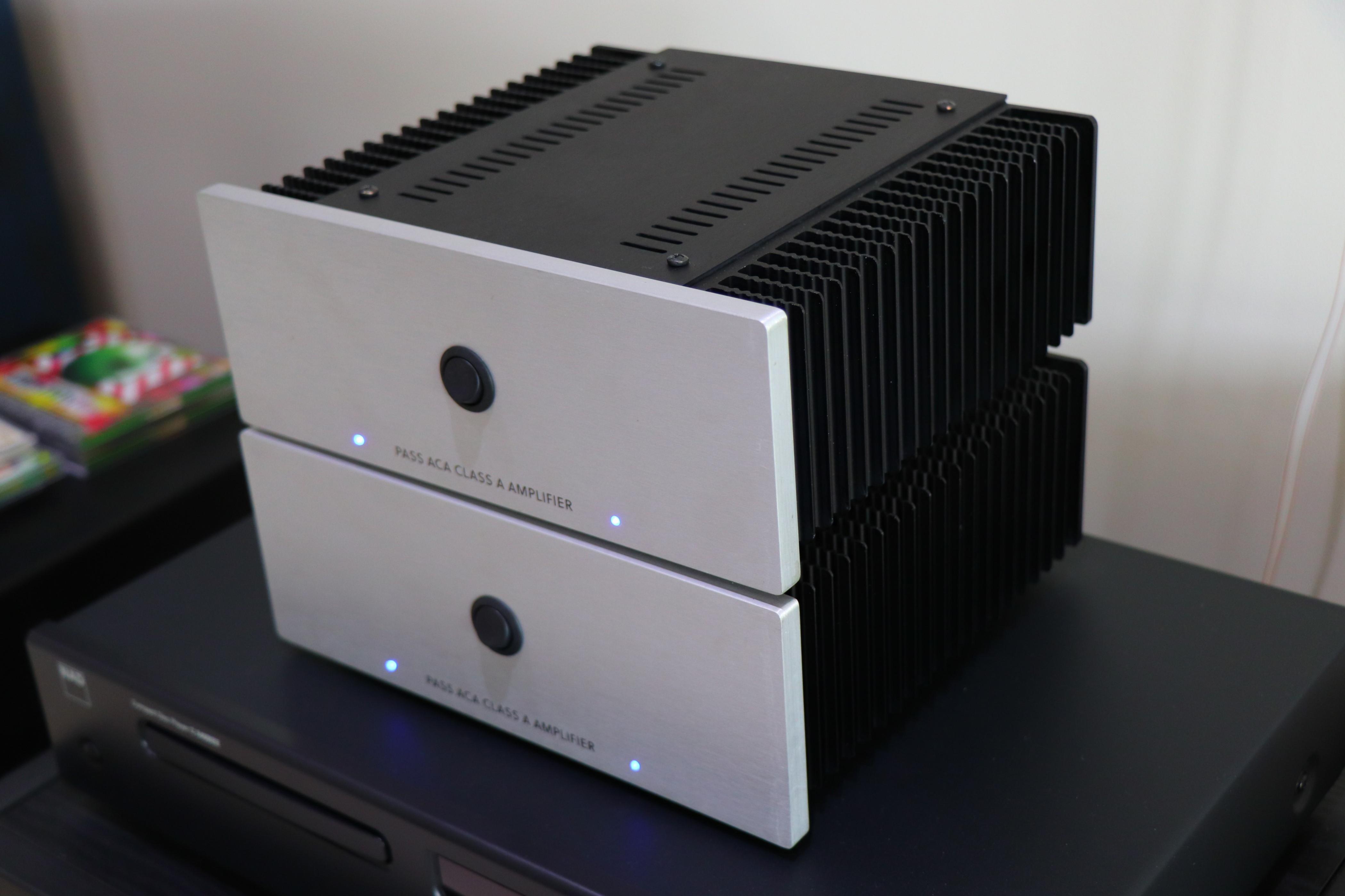

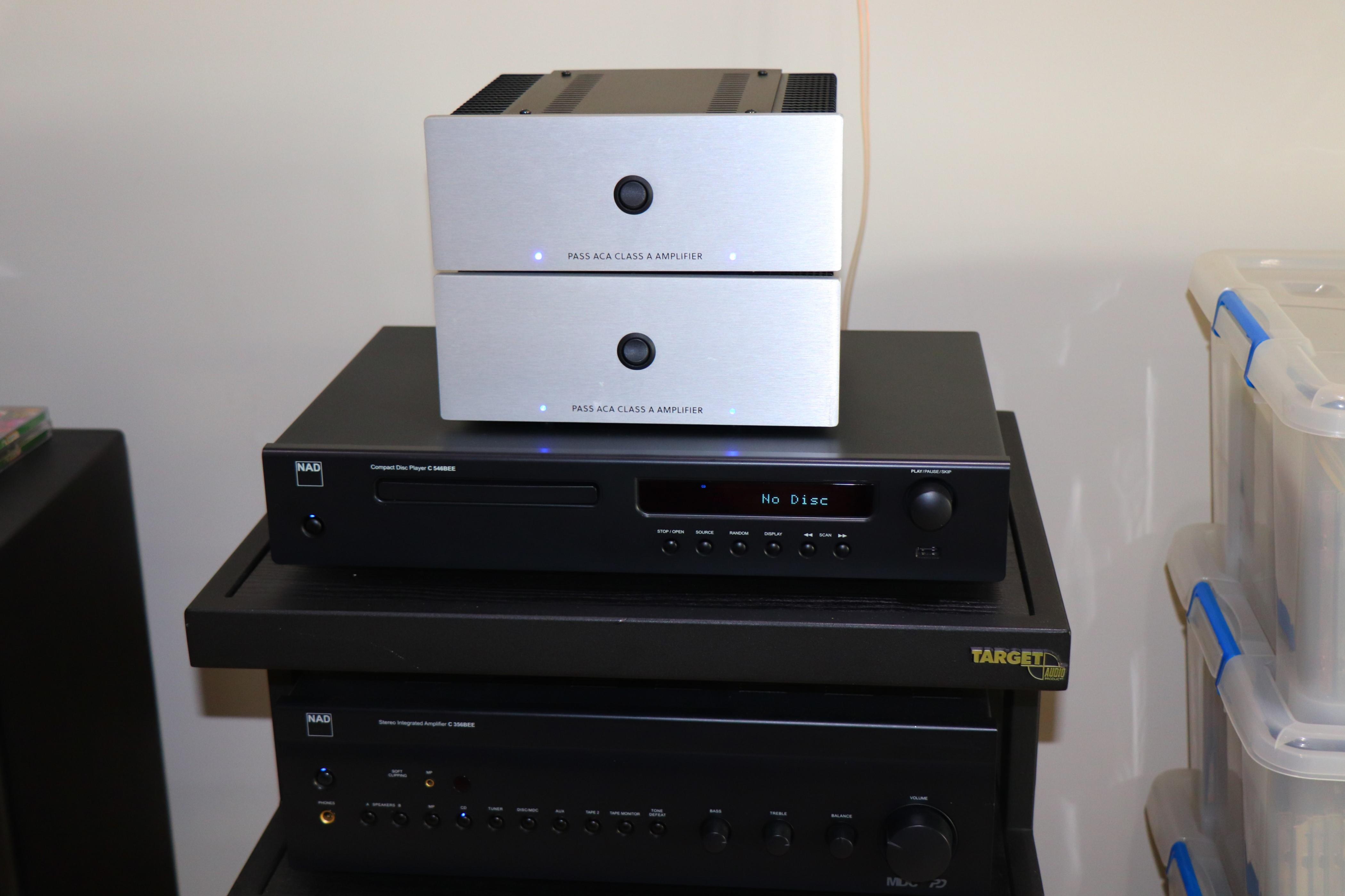

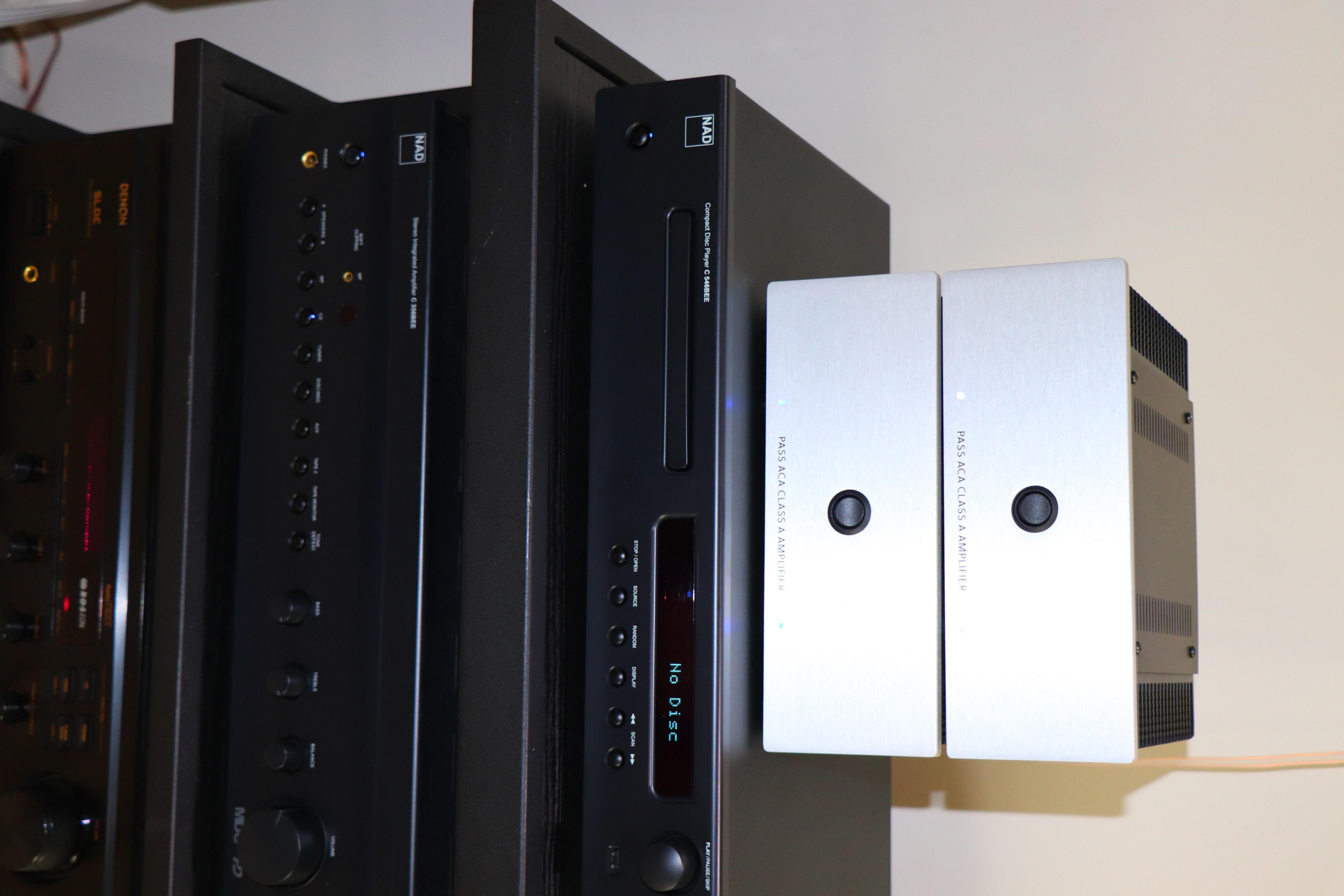

ACA mono blocks: An excellent project with a nice result!
I finished the ACA mono blocks some time ago and listen to them daily through an NAD C546BEE CD player with Wolfson 24-bit DAC and the pre-amp section of an NAD C356BEE integrated amp, and a pair of old Sony SS-B5 ES 3-way 4 ohm speakers and it sounds excellent! I have the NAD pre-amp on not more than one-quarters of the volume and it is loud enough. The blue LEDs fit nicely with those of the ACAs'.
The ACAs are a toasty 53 degrees Centigrade in an ambient 25 degrees.
I just wonder if the bottom ACA does not heat up the top ACA too much if you stack them on top of each other as I do.
